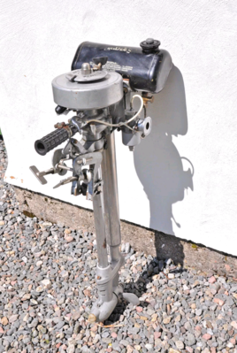

And another fv2923 some later parts fitted shouldn't be to hard to bring back to original these canted tank's really do me in...

These early FVs in my biased opinion are the very best! To find one in running order is unusual.
I also think that these early FVs are best suited to the small round tank.
I am sure you will be able to replace some of the later parts which have been fitted.

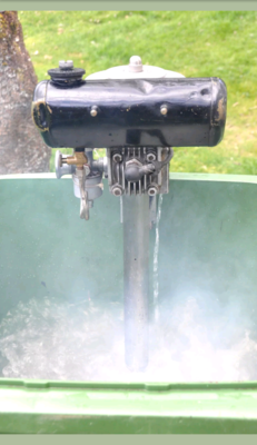

Fv2923 picked up today 380 miles and a short sail on a ferry came home with a S.D destination Italy I must be mental...

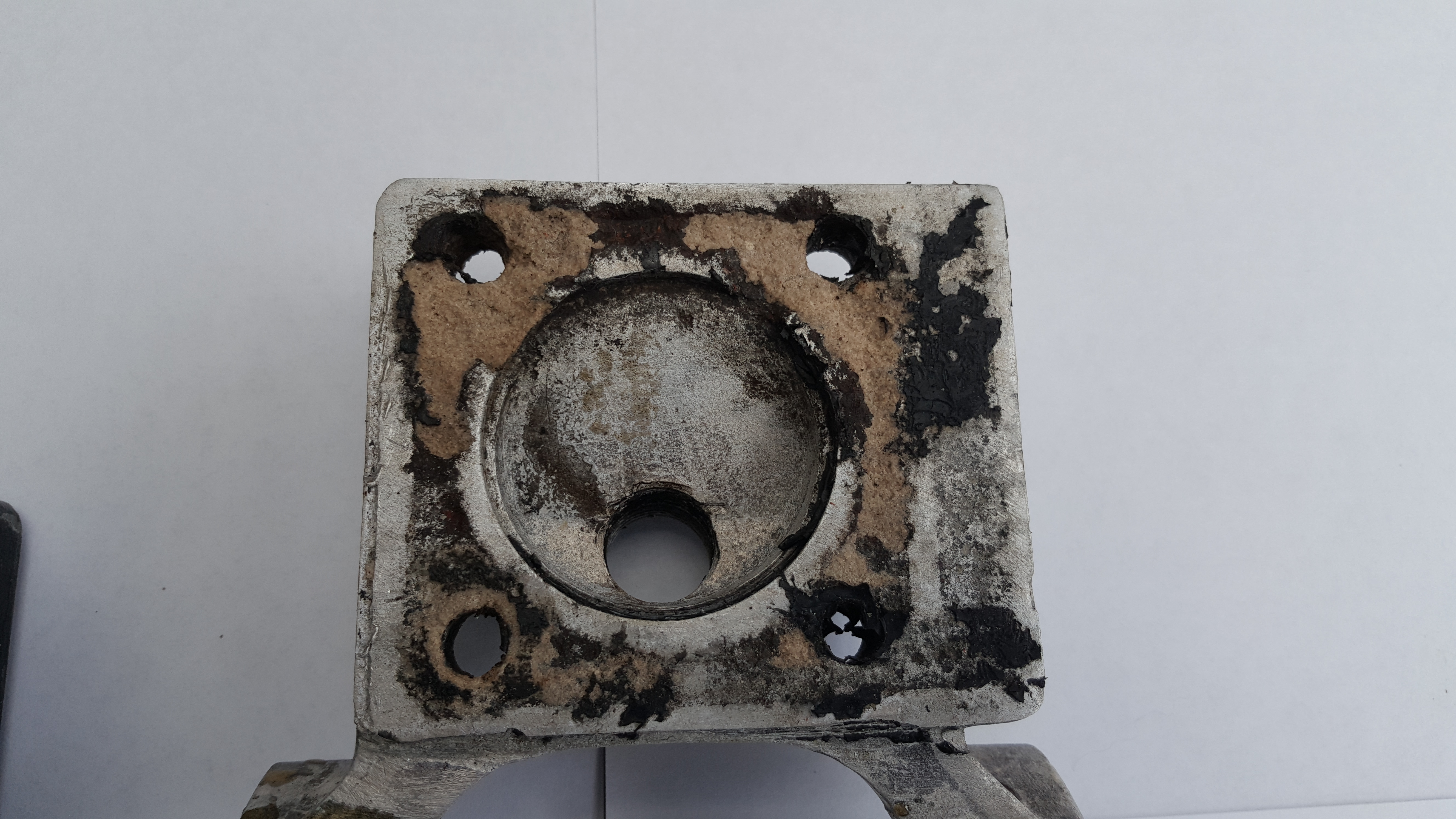

Still have sd in my possession will be shipped out next weekend will leave pic upload for new owner ( other S. O. S member) in the meantime fv2923 is running like a bag of spanners full strip down showing head serious corrosion metal caskets to thick and more later parts fitted (have most available)

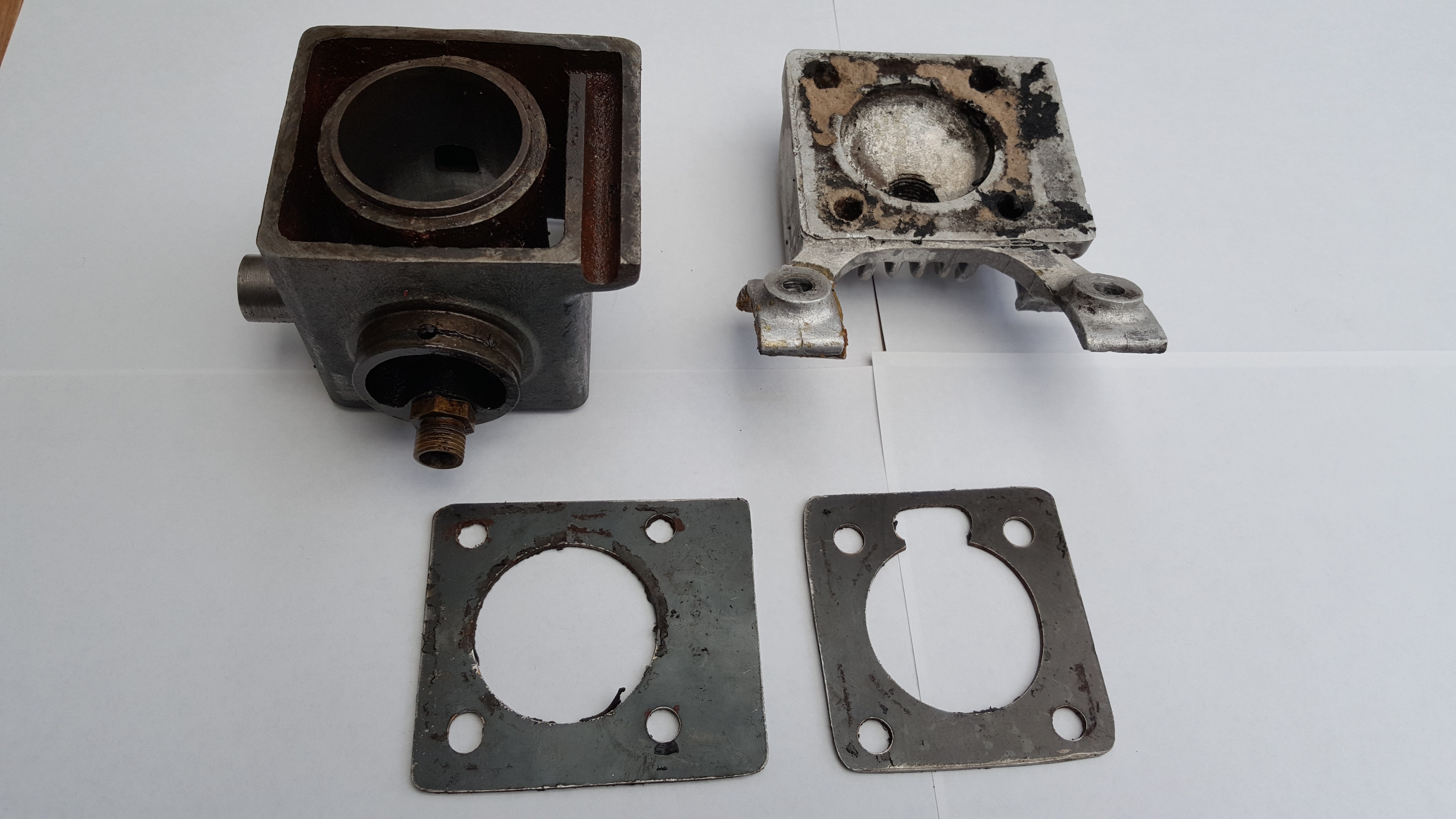

I find it difficult to see how much corrosion the head has. I had a corroded head filled with weld. It was a simple matter to file it flatish and then use wet and dry paper in conjunction with a very flat surface to restore it to a igh degree of flatness. I know that those with machine shops will say machine it, but it is easy to get it very flat in the way have described. Good luck.
Is the crankcase corroded as well ?

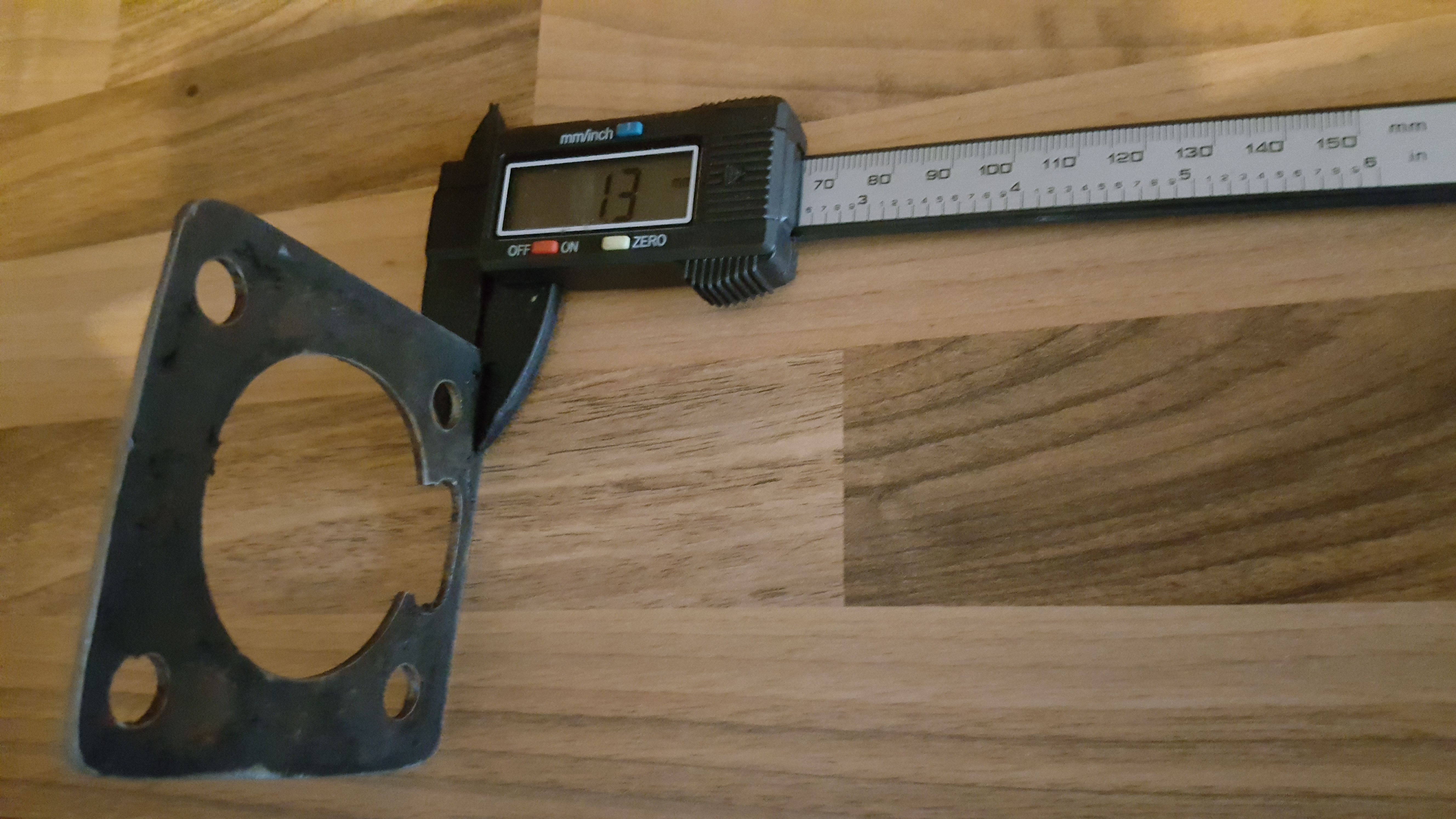

The idea of the steel plates, which were originally completely covered with a black sealant, was to keep water away from the aluminium and thus prevent electrolytic corrosion. I suspect this was not understood by subsequent rebuilders. The plates were not just simple gasgets sealing the cylinder from the water.
Why do you say the plates in FV2923 are too thick?
Big difference in thickness Jeremy whether it makes a difference is another question....

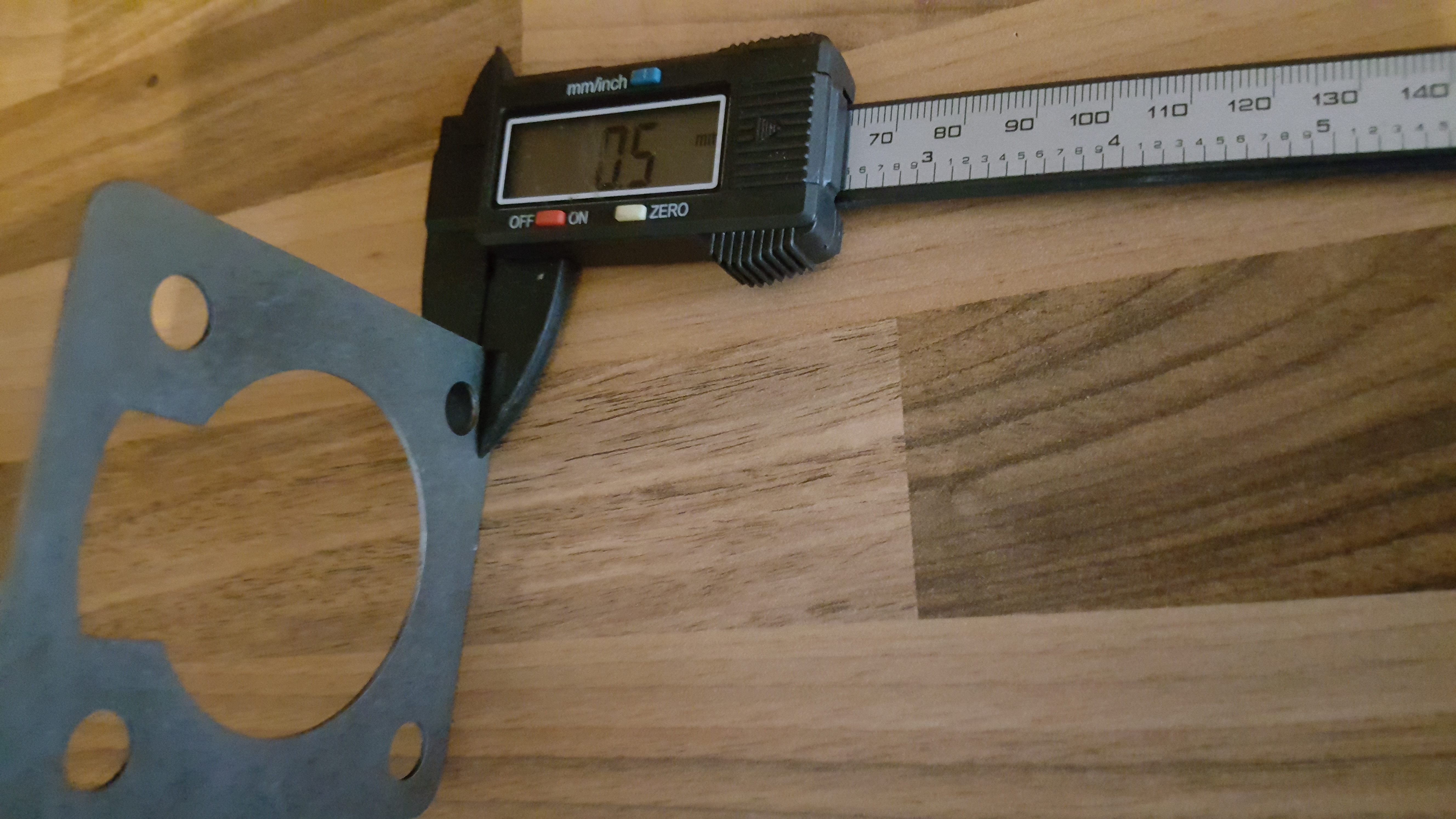

All the original ones I measured Tam were 18 gauge, 0.048" about 1.2mm, but I only measured 4 or 5 that I would bet were original.
You seem to have 2 bottom plates, the top ones didn't have transfer port notches.

Illustration purposes only C have a set cheers

Tam, in response to your question about whether plate thickness is important, I would say probably not as long as they are not too thick. My experience with FVs would suggest that they are often very gutless because of dimensional variations producing poor compression. I measure the clearance between the top of the piston and the cylinder head, using an L shaped piece of plastecene inserted through the plug hole. I think the ideal clearance should be about 4mm, although 5mm is still ok.
The length of the block and the depth of the head in my experience are the main causes of the variation. I have had to modify these parts to achieve a satisfactory compression. Performance, including starting is then very satisfactory.
Charles ,
Yes, I concur with your measurements that 0.048 seems to be the typical thickness of the plates.

Charles ,
