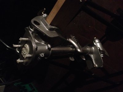

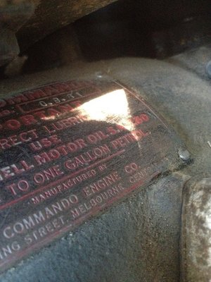

hello All,

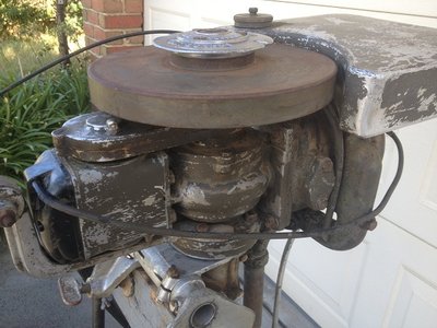

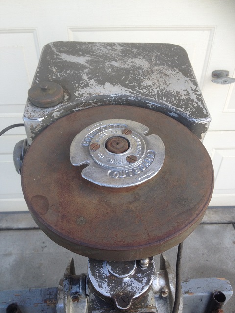

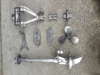

I recently added a Australian Commando Outboard to the collection. Commando was the first outboard produced in Australia, and built specifically for Military application.
Thought you guys might like to see some pics.

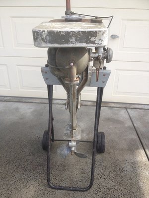

And a few more;

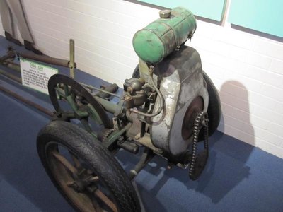

Are you talking 1930's here?

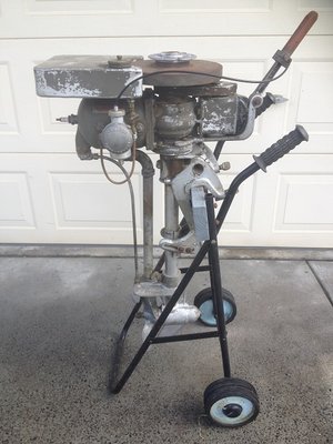

250cc, 3hp, 102 lbs, Lucas (Prince of darkness ignition) looks a little fragile for military use, how do you lift it?

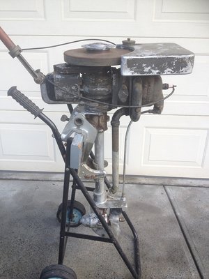

Re: Australian Commando Outboard
Hi Charles,
No, not 1930's. These were built from approx 1944 (during WWII). For further details see my blog here: http://vintageoutboardsaustralia.blogsp ... mando.html. Note the Commando outboard pictured there belongs to Bruce - Collector Inspector. Also, the blog is a work in progress so there are many pages yet to be completed.

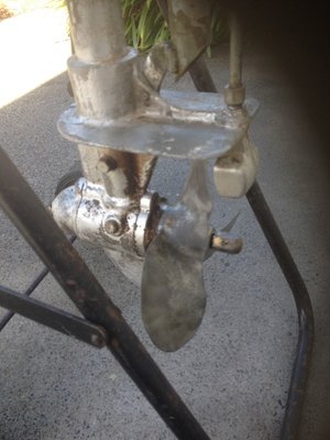

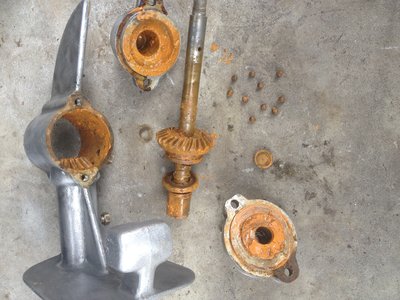

There is no water pump as such. The water pick up as at the trailing edge of the cavitation plate and relies on the boat to be moving forward (and prop spinning) to force the water up the pick up tube ie like on so many other outboards of that era. Sorry for the image quality below.
Hope that helps.

looks like you would need a fork lift to shift it! :shock:
Still a very nice engine. Good find. :P

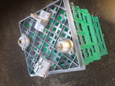

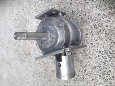

A few progress pics.

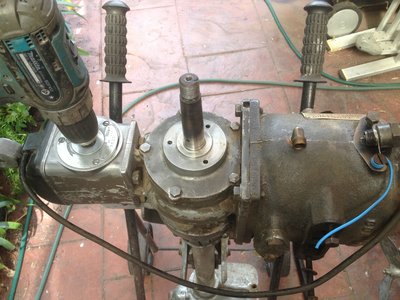

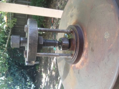

Flywheel was an absolute pain to remove, even after soaking for approx 3 weeks. Heavy duty puller and a few short bursts with the rattle gun is what was needed to get it off.

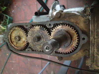

With the flywheel removed, we had access to the gear case. Paint over the screws and a nice snap as each screw released suggests this had not been apart since the first build. A few broken teeth, otherwise all good.
Further disassembly, cleaning and inspecting parts.
Gearbox was a bit of a mess, and shaft was tight to turn. Other than one bearing that needs replacing, all good now.

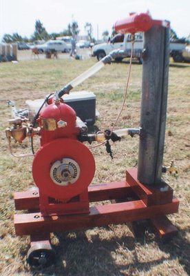

As for the timing, I do not have sufficient knowledge to give an explanation other than this is essentially a low revving water-cooled stationary engine sat atop an outboard leg. The little I know from my stationary engine collector friends is that most fire at TDC, some slightly before and some slightly after. Another collector with a Commando outboard also has his firing slightly after TDC, he says to ensure it does not kick back and proceed to run backwards?

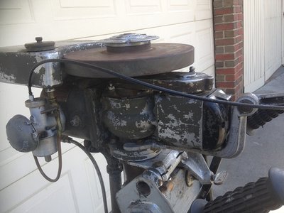

Below, a couple of images of the engine in it's original configuration (red) and an air-cooled model (green). All pics are "borrowed" from the internet.

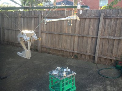

At little bit more progress on the Commando.
Bottom half has been painted and dry assembled for easy storage. Need to replace a bearing and source a few nuts and bolts before finishing this part of the project off.
Magneto is currently in NSW and about to receive a full overhaul. It should be back in a week or so which gives me some time to sort out the paint for the engine and tiller assemblies.
Coming along slower than originally anticipated, but to be expected I guess when there's a few projects on the go.
