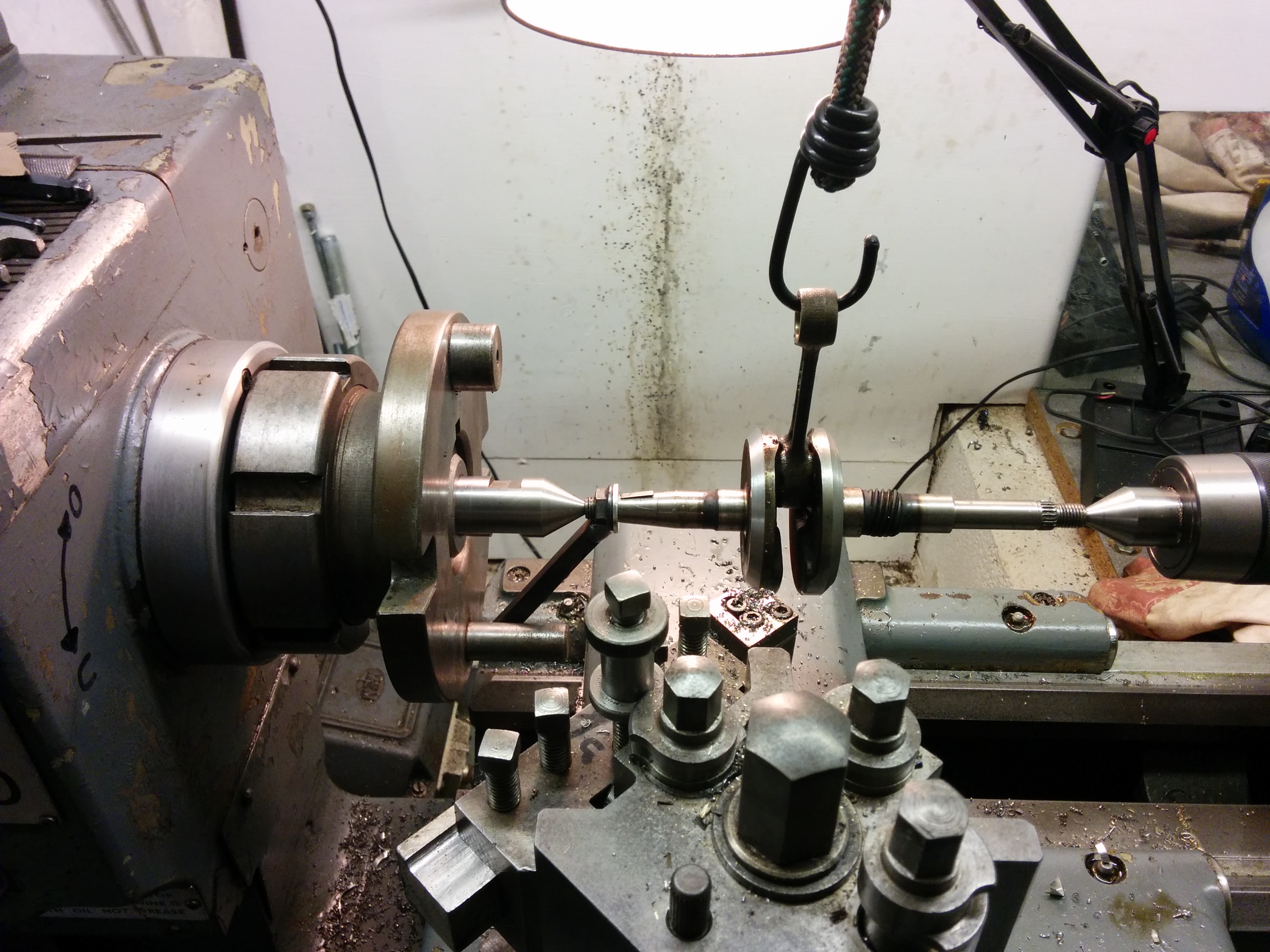

It seemed like there were potentially some that might be shoehornable into the space with the same or a similar stroke to the 102. A few £ on eBay got me a spares honda crank, I think it was from an SA50, PC50 or similar.

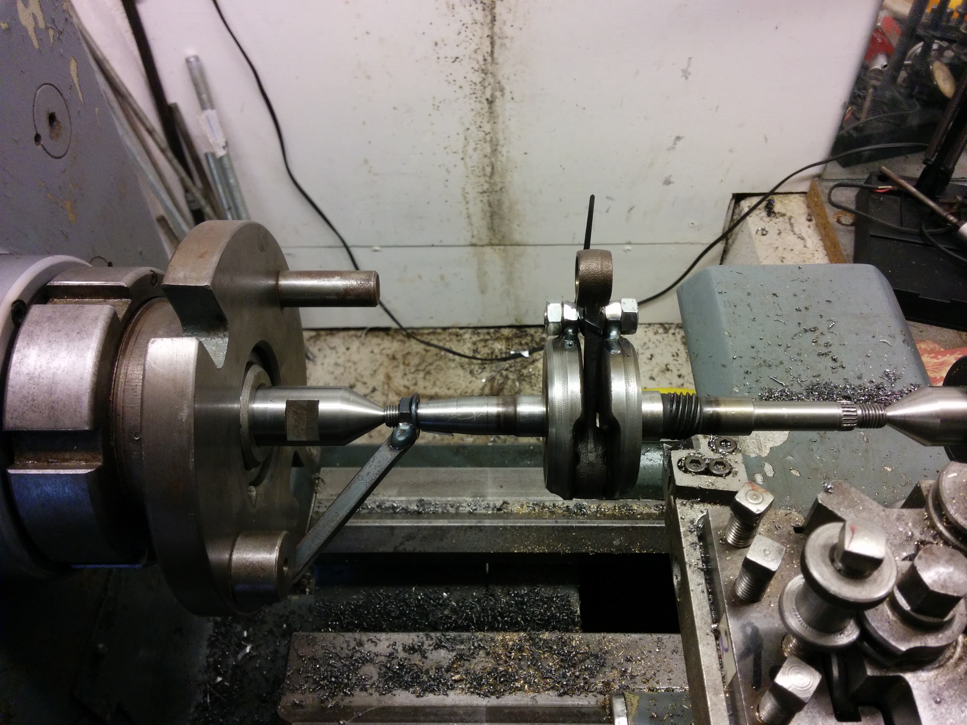

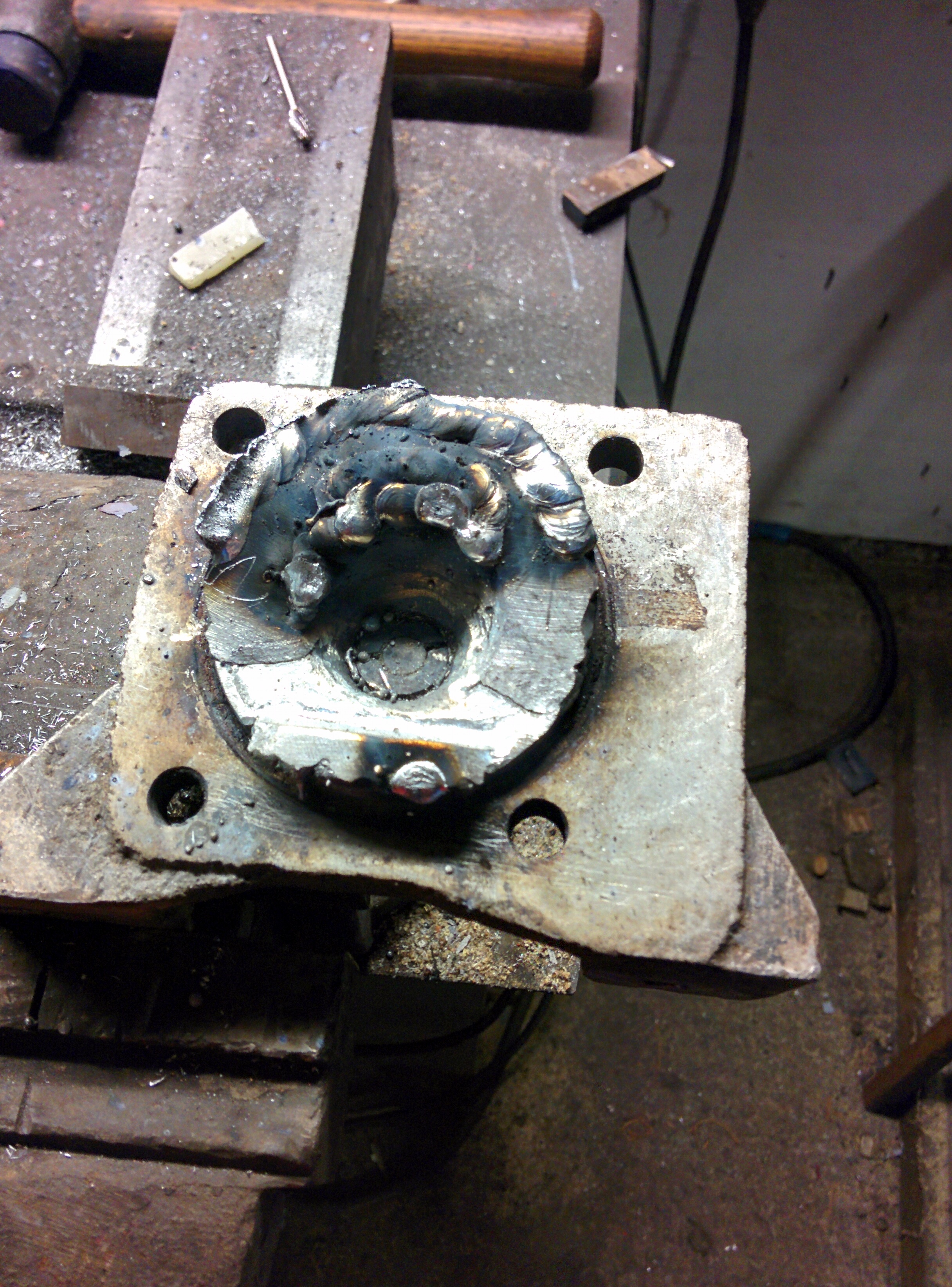

It turned out to have a slightly shorter throw than the 'gull which was a bit annoying as it brought the engine cc back down to ~97cc and also mean some serious skimming of the barrel and head.

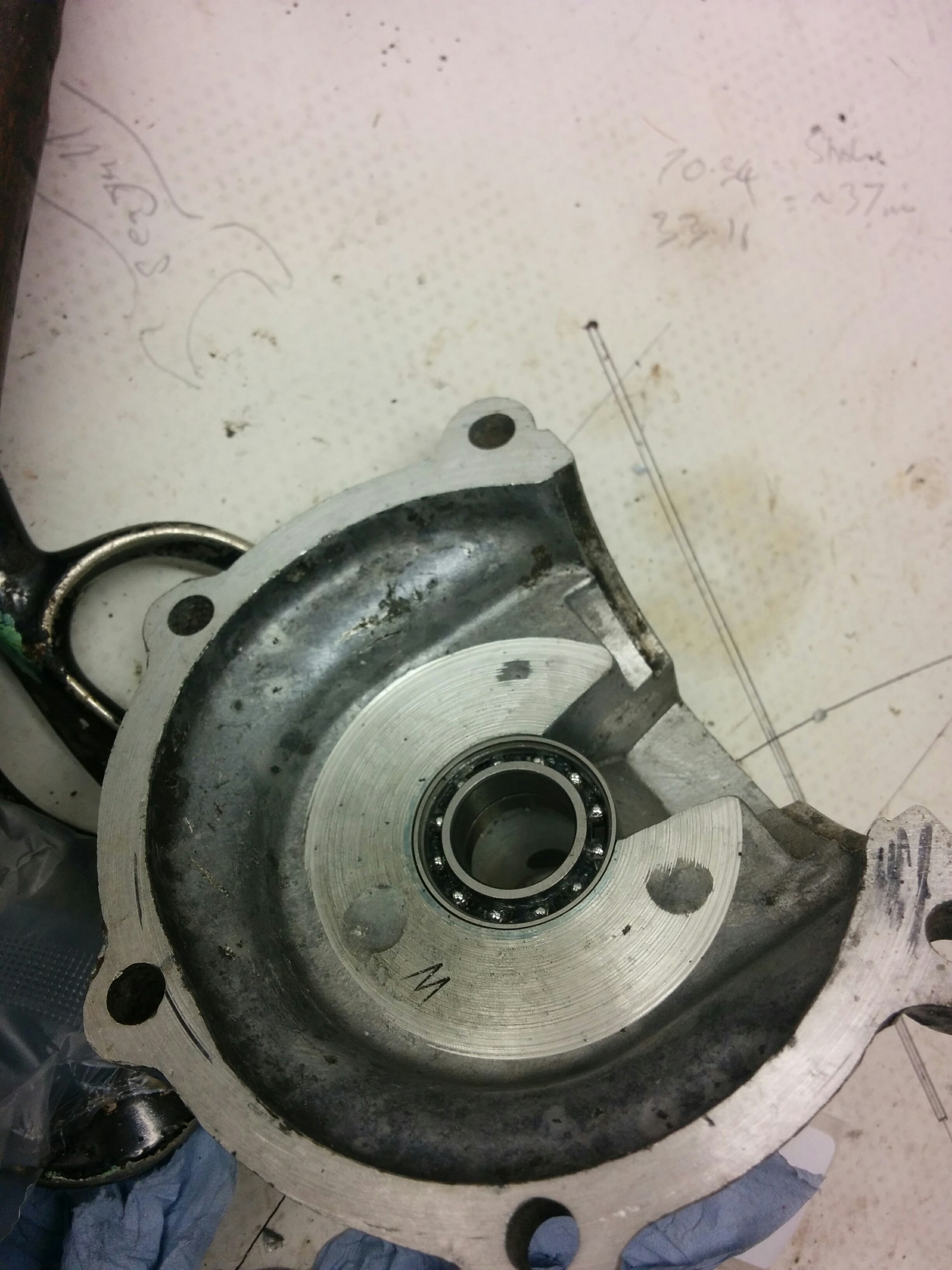

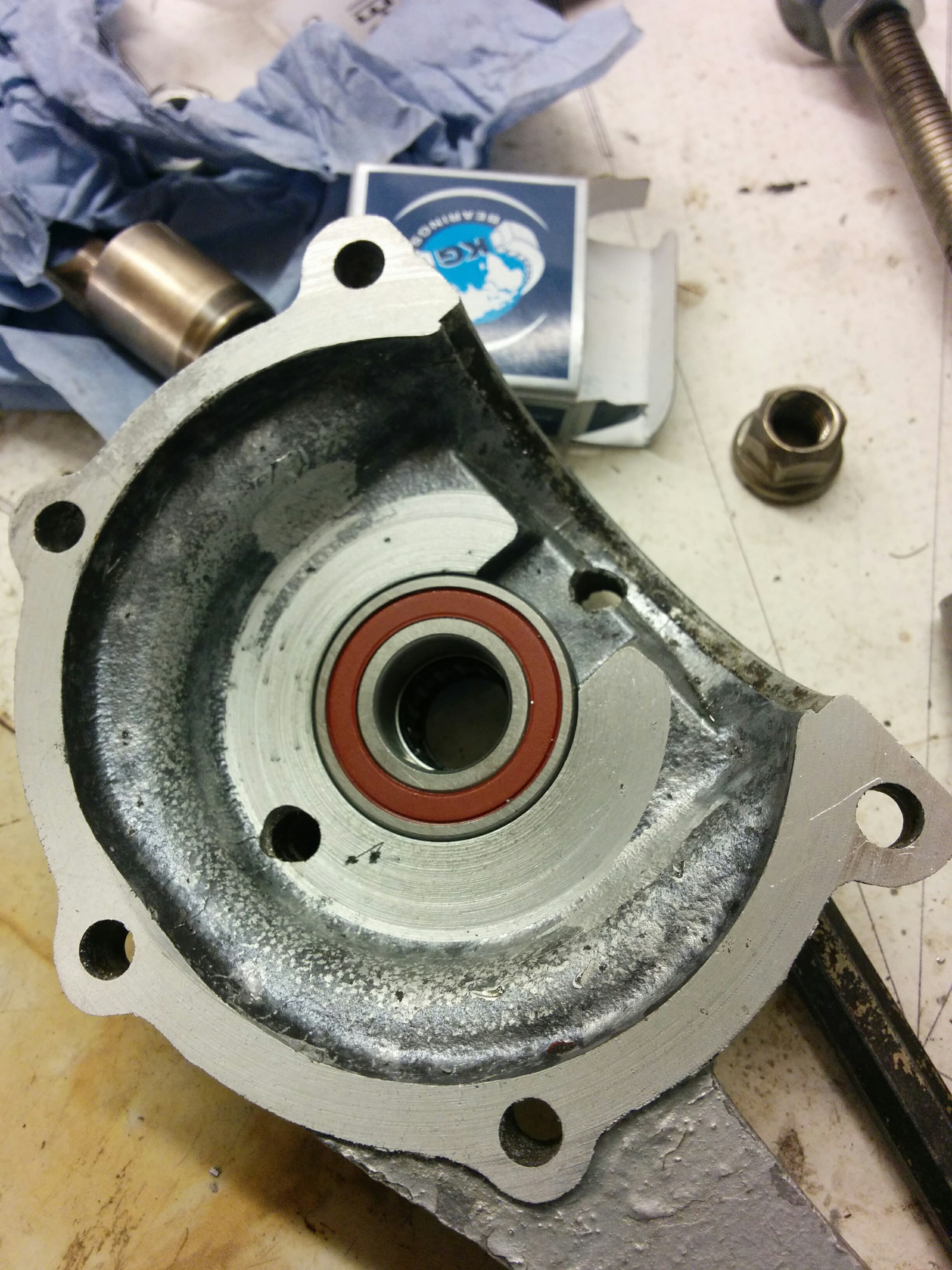

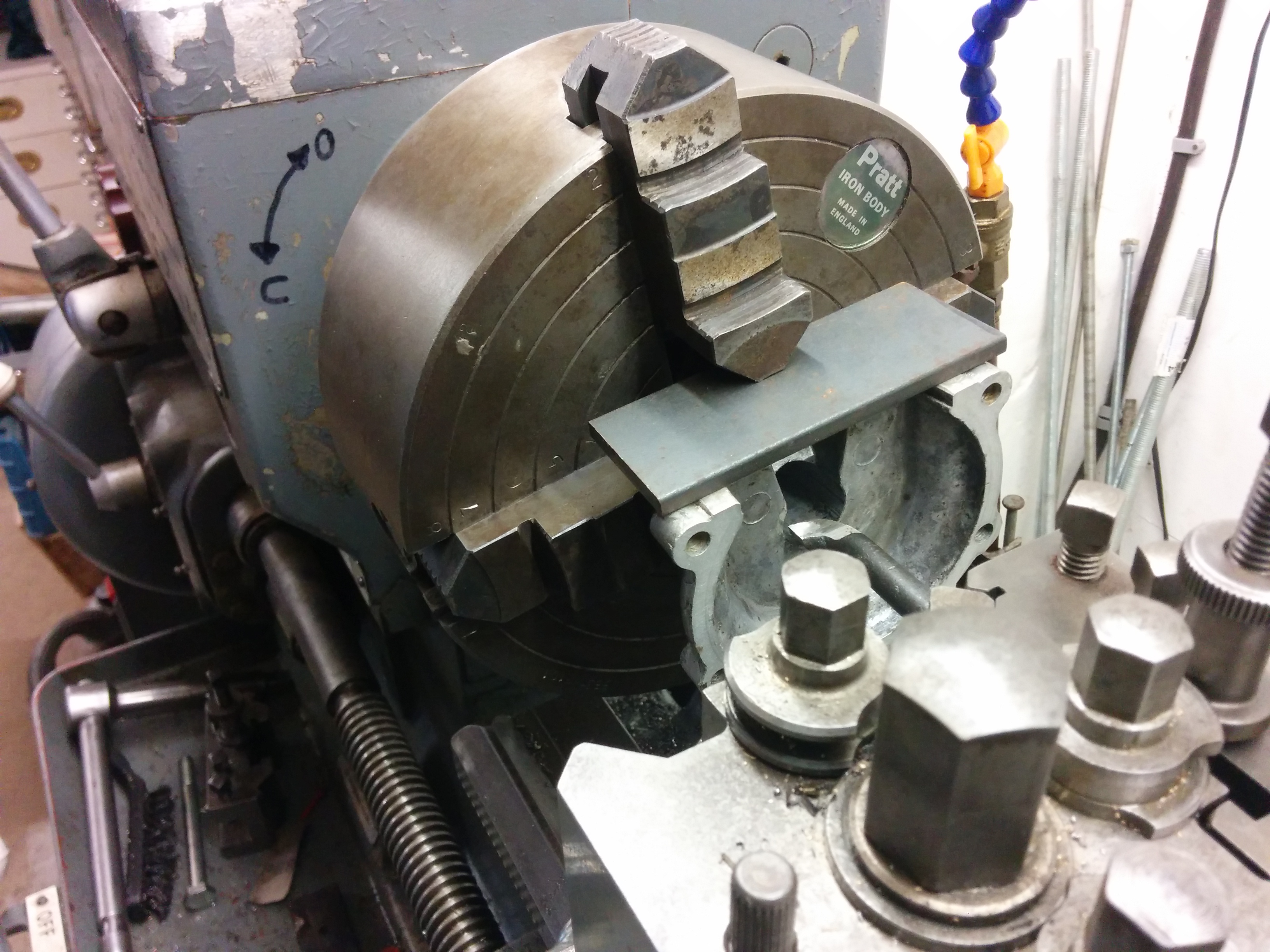

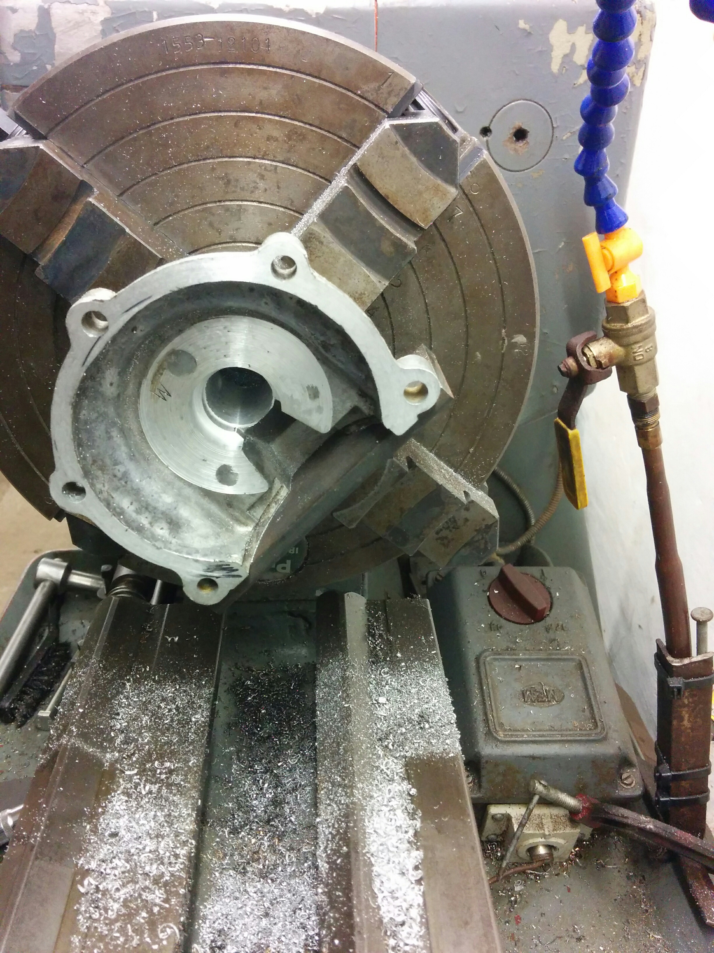

Had to slim down the flywheel a bit and grind some clearance in the crankcases as well as obviously machine recesses for the bearings - who knows how the not fully supported bearing races will fair!

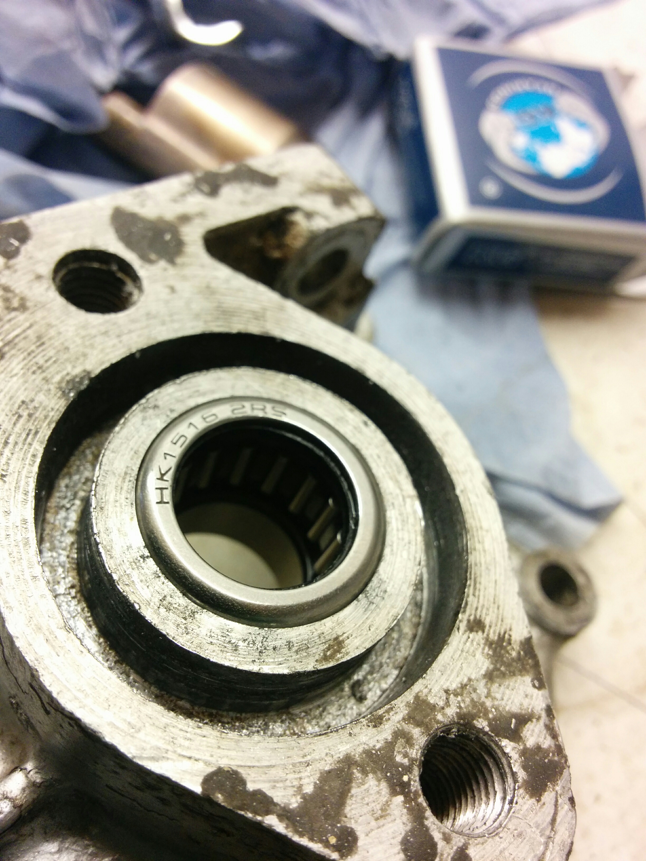

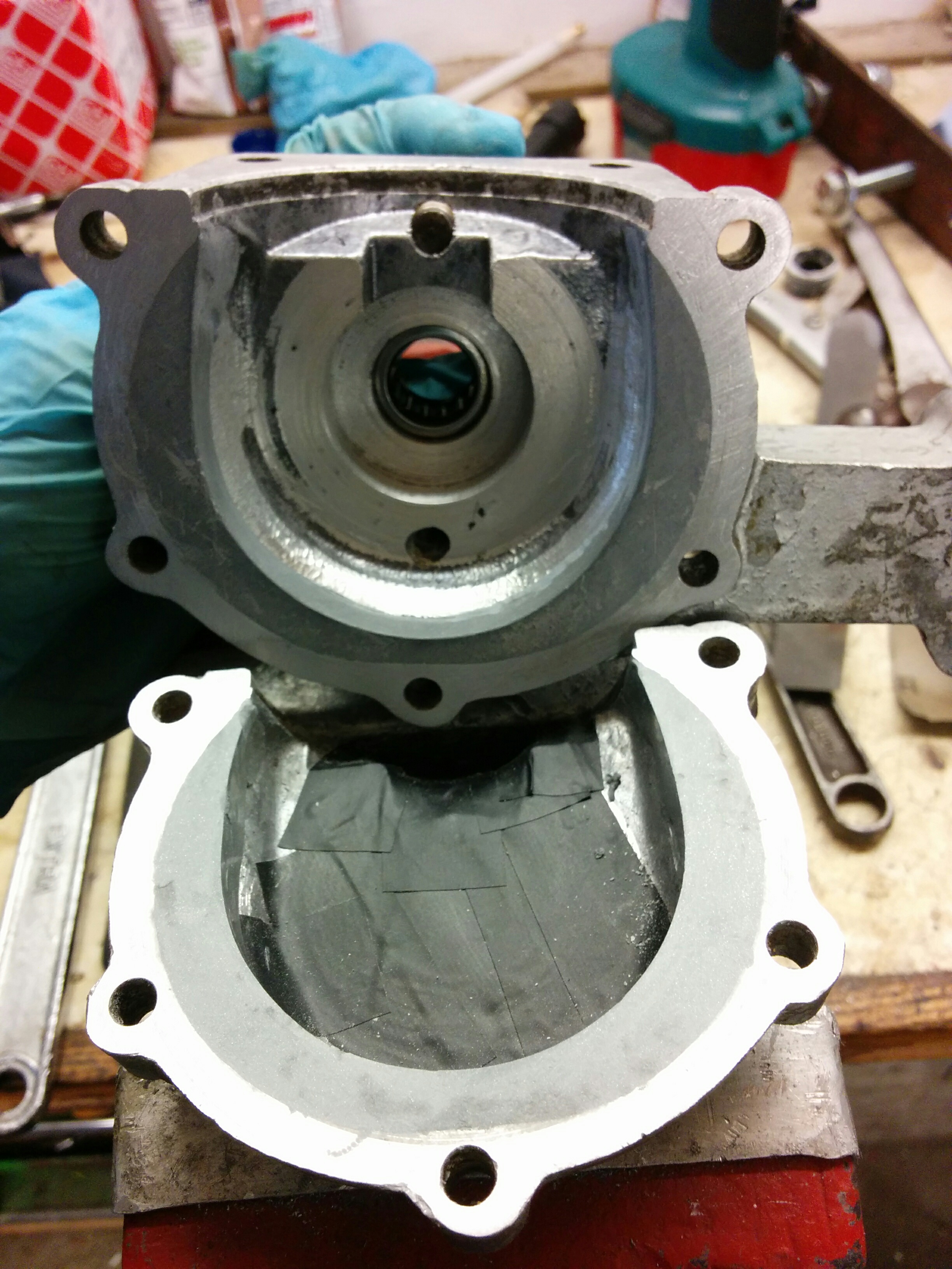

Ended up with one reasonable ball bearing on the beefier lower side and two quite flimsy bearings in the thinner casting at the flywheel end. Above and below the main bearings, I put needle rollers. A comprise, especially as they run directly on the machined, unhardened steel of the honda crank.

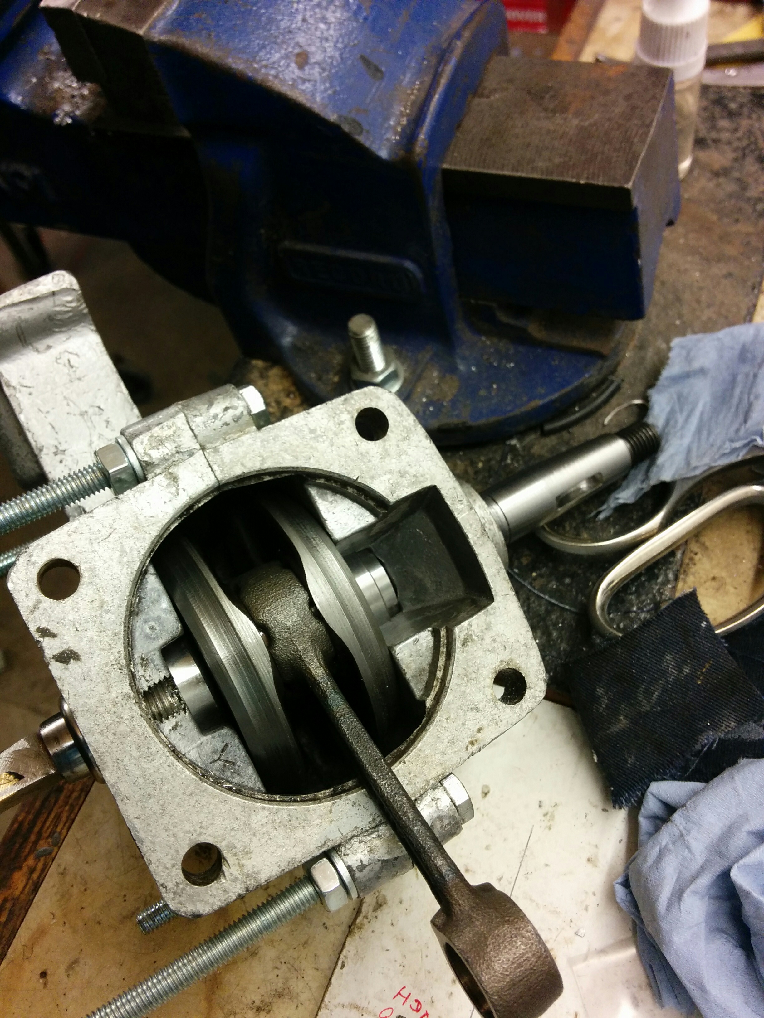

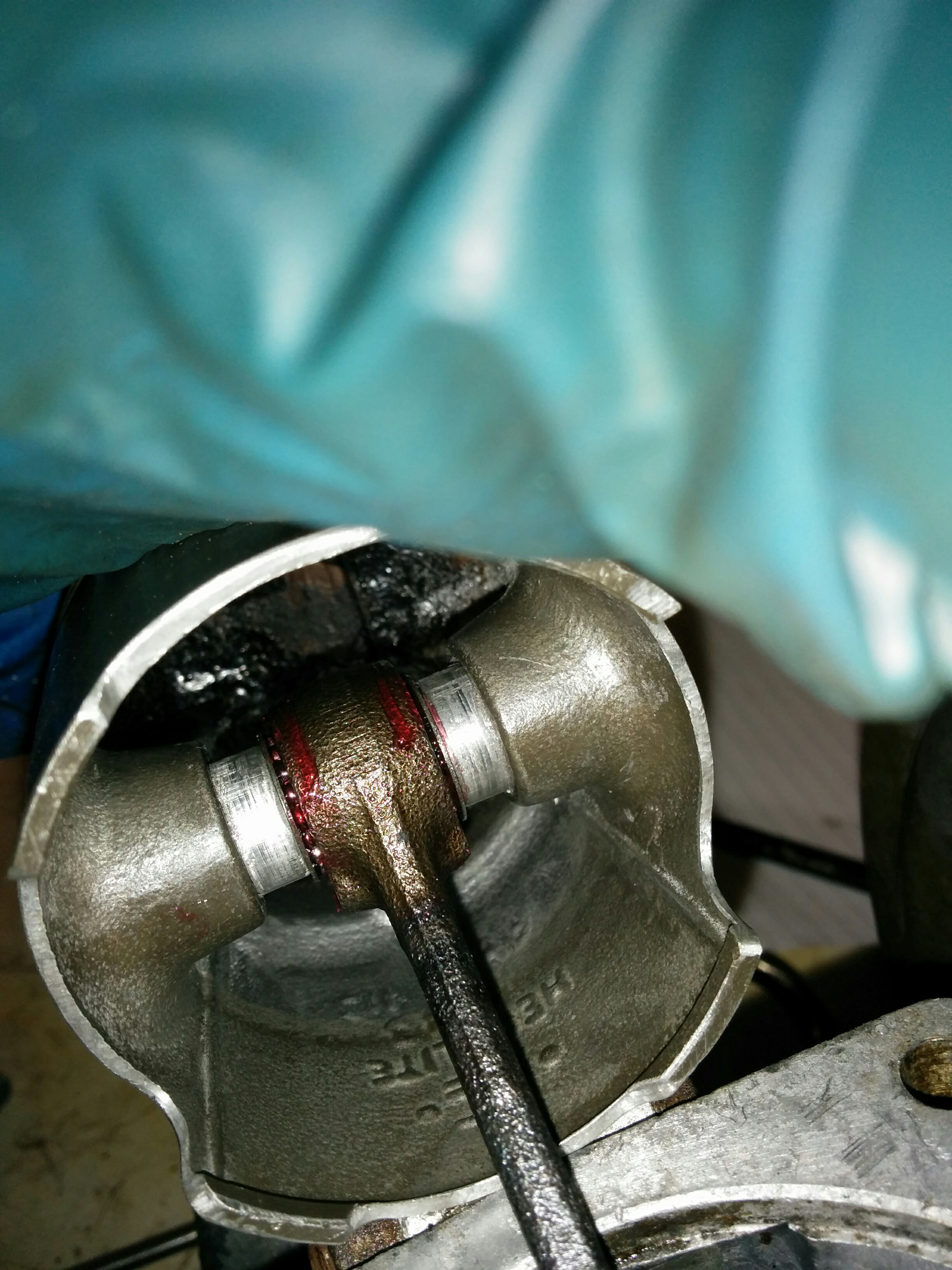

The piston was a bit of a head scratcher, I decided I'd have to use an original piston but mounting it was going to be tricky considering the honda little end was expecting a 10mm gudgeon and needle rollers. In the end I pressed in some spacers and reamed them for the 10mm pin. A lot of weight on the end of con rod considering it was designed to take a 50cc piston!!

Fitting a press together bottom end freed up lots of space in the crankcase which was filled to what I decided, based on some careful measurement, was a sensible degree.

Those needles have rubber seals, if you didn't polish the crank to size it, will damage the seals, causing a loss of primary compression!

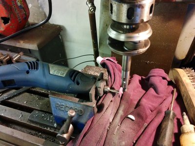

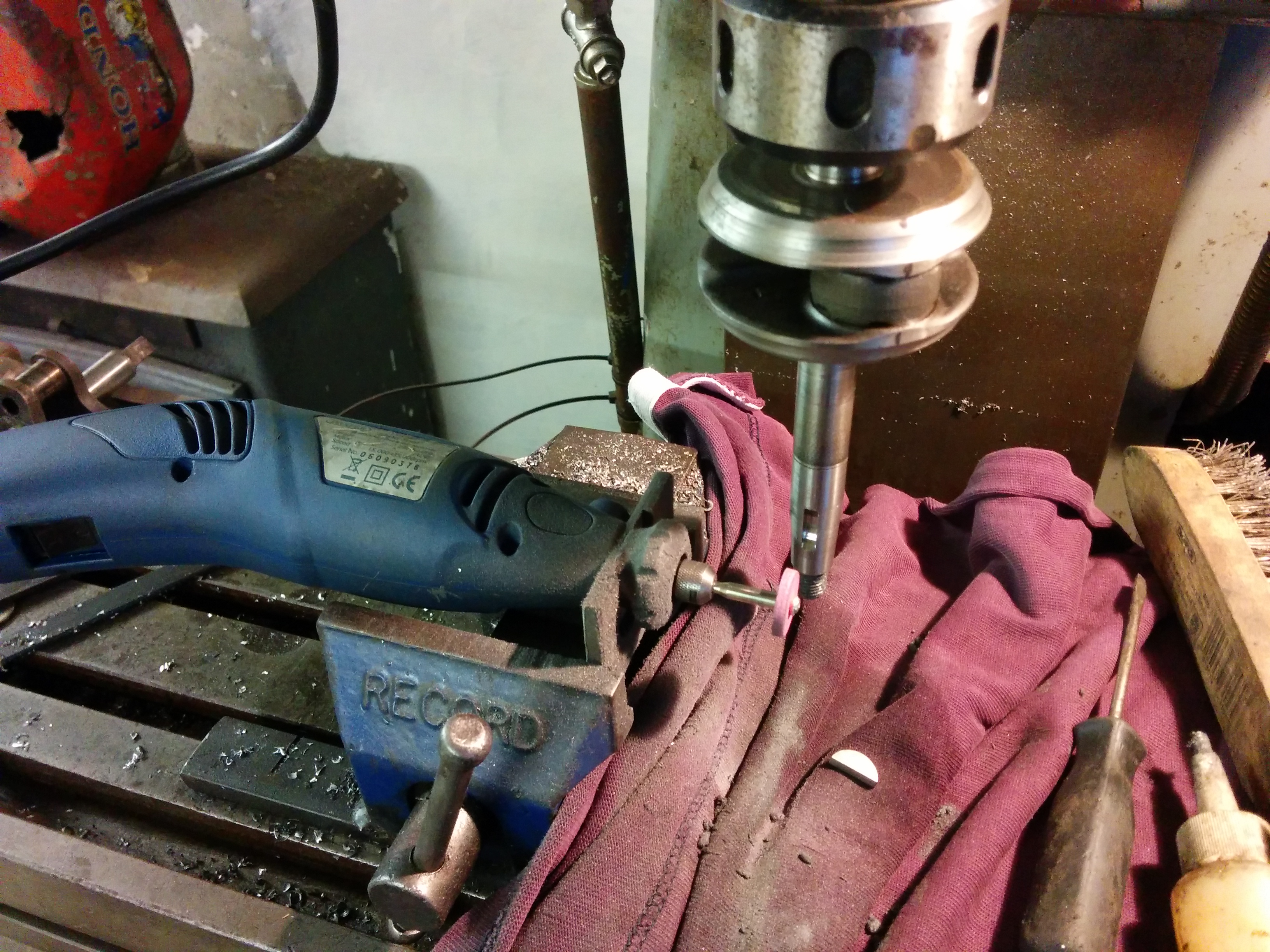

You're right about the rubber seals/shaft. And I am relying on them (and the rear ball bearing seals) to keep the primary compression in. Yes, I polished up the shaft as best possible but it's likely not to last like a proper surface would. I'm not at all sure about the longevity of the needles on there, I'm not the best machinist and they deserve better!

It would have been a lot less trouble to use a Kingfisher needle roller crank with new bronze mains.
But some nice engineering, I'd be concerned about the needles on the mains, they're designed to run on a polished hardened steel shaft, where does their lubrication come from?

Yes, Charles, that is a concern. I was aware of the limitations of rollers on a non hardened, less than perfect shaft. I hope that forces up there will not be excessive and it'll run for long enough to keep me entertained. If I end up needing to replace the rollers, they are very cheap. They are lubricated by the inevitable blowby! But I think I put a little grease in there until it gets washed out.

The Walleroo rod has room for a Pb2 bush in the little end, that would avoid all that piston work.

Maybe that's an idea for another day. To be honest though, while the little end setup I've got there took a bit of planning, actually doing it was straightforward and inexpensive. We'll see if it proves to be sturdy enough or not!
