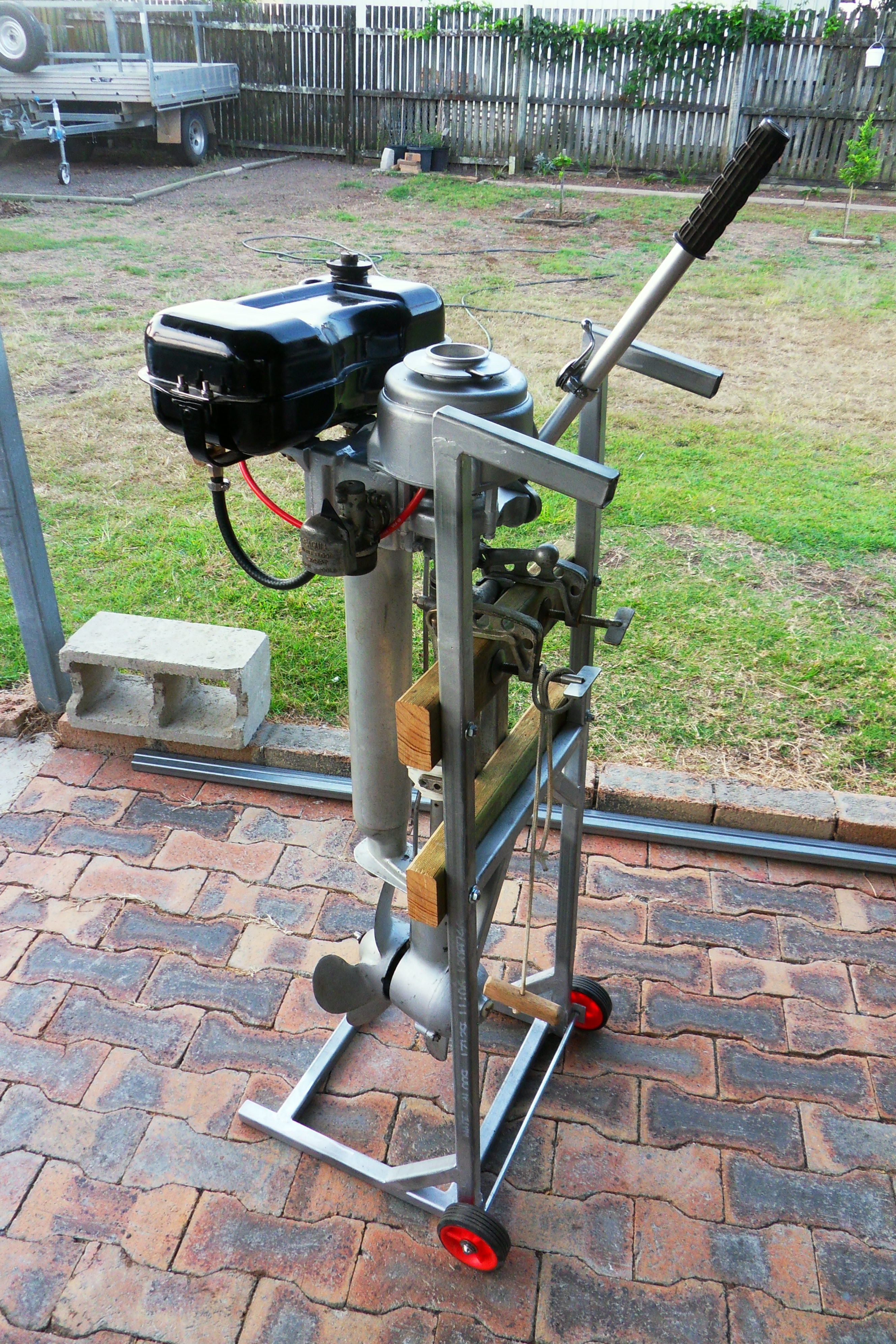

i recently bought a seagull espc 179 ff0 and i'm in the process of doing her up
i want to make a trolley to put the motor on to work on and store also i should be able to put a container of water under the motor so as to run the it
what i need is plans, drawings, photos, anything to give me an idea of how to go about it. i think it needs to be well balanced, that's about all i have
so any help or advice is welcome
thanks peter

hey bnc, mate if i wanted easy i wouldn't have bought a seagull :lol: i made one which cost me the the cost of the wheels and axle the rest of the stuff, i had here. i'd post a pic if i knew how to do it

It came out looking well in the end Peter, Nice to have a one of a kind trolley that you've made yourself.
You just need the plastic end caps for the steel box section to finish it off! My local steel yard sells them, so I presume it is something that most steel yards stock.
I presume given the colour of the HT lead that it has been replaced at some stage. Did you replace it yourself?
How did the connection work out inside the flywheel? I thought it was not possible to replace the ht lead on that particular model. (I could well be mistaken though.)

g'day, yeah, i don't know what happened with the double posting.
thanks on the trolly, i don't know if i can be bothered with the end caps, you can get them at the hardware.
i had to replace the lead because in John's words " it's been got at "
i didn't know you couldn't change the lead, i just took the top off and pulled the old one out and bought a new one the same length and then did some research it turns out that where the lead goes inside there's a little screw gizmo that the lead screws onto.
i had a bit of trouble because the new lead was too big but i got around that, put a bit of silicone around it and screwed it in.
regards, peter
