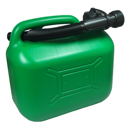

For those of us not racing I don't get the whole need for a bigger tank thing, what's wrong with just throwing a petrol can in the boat and filling up the gull as required?
