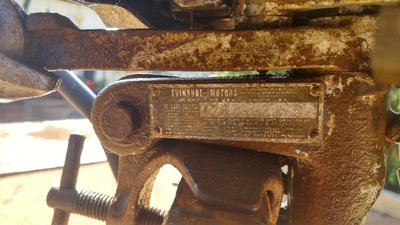

Introducing as of today an Evinrude Sportwin model 4287 1938.
Serial is 02475.
Had to have it at AU$95.
Was stuck but a 6" adjustable on the nut and a thump..................free as a bird.

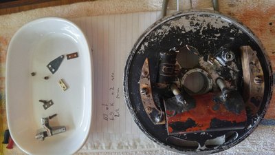

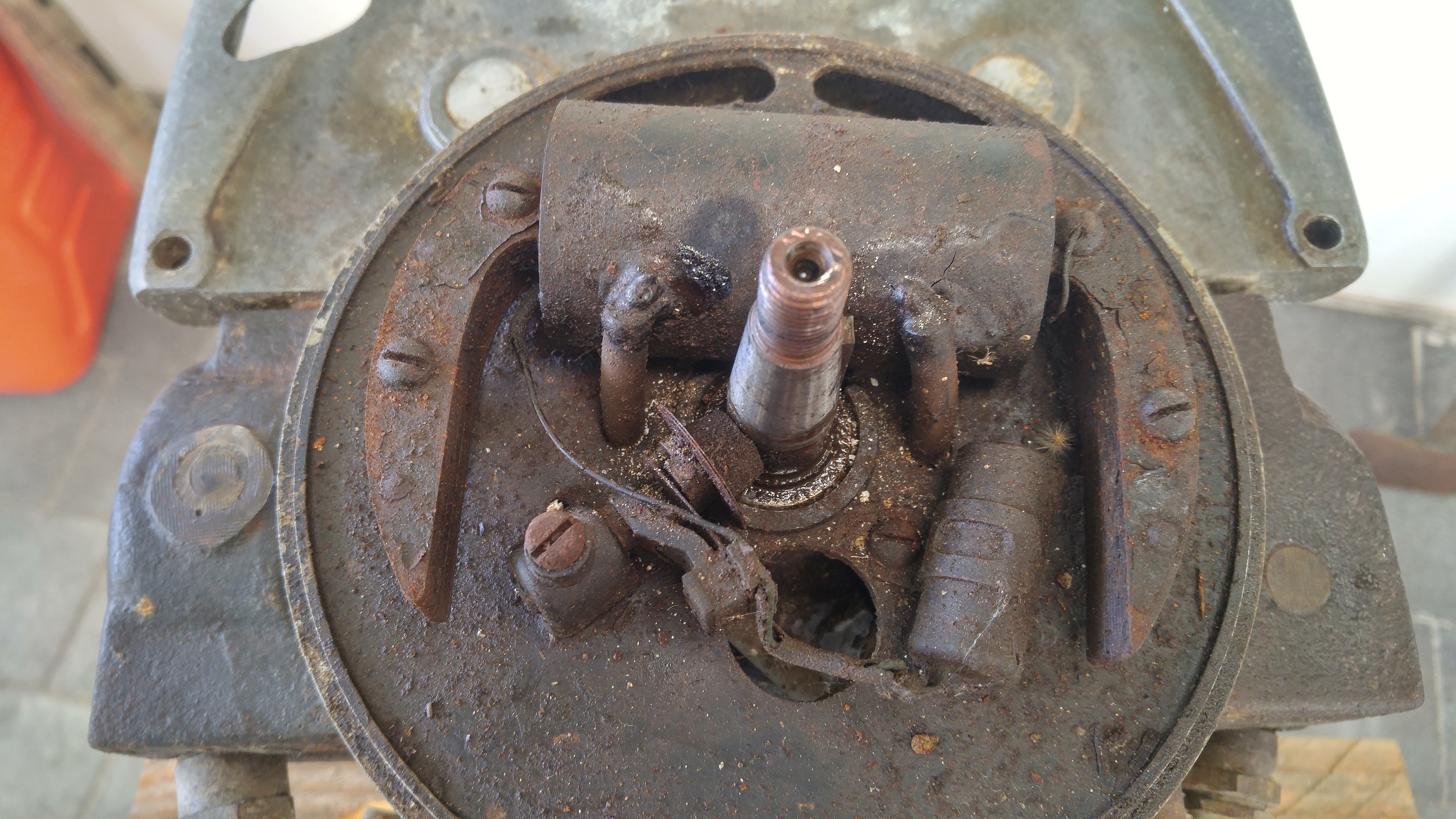

Spark First is always the way to go. Absolute mess but maybe OK. No point gap but the incorrect plugs were actually firing at some stage. Clean up and electrical tested done and dusted.
Coil Primary: 2.5 Ohm
Coils Secondary: 6.9Kohm each.
Cap: 1.59
What a mess with no point gap from get go.
Clean up looks OK
Should be a winner................soon.
Under the plate................no holes or cracks but a lot of years sitting aye..
Pics no order at all............

Dont know what they where thing the paint would do.... Maybe help with a spark
Re: Another Old Dear
Or stops the spark jumping, my ignition is exactly the same.
Black paint is pretty much standard on those early Evinrude/Elto magnetos.
Whilst I can understand why they did it, it's less than ideal IMHO.
Good to see some progress B.

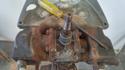

Progress
Spark times two. reliable 5mm. I will get another capacitor later.
Compression both, a whopping 35psi each. Barrels off to check for stuck rings etc before starting it just in case.

It's most probably just a coating that protects the ignition system from water ingress, as the entire system is covered in it once its been built, most motors don't bother.Whilst I can understand why they did it, it's less than ideal IMHO.
- Posts: 4204
Exactly the paint in that it sealed everything from moisture and related marine ingress. Kind of a value add even back then.
Gulls painted the magnets on flywheels, well later Villiers and Wipac certainly did. No magnetic magic suffered.
While I am not a fan of "Black" I am a fan of making sure that any "Magneto" Gull or not, has some protective coating. Some of you may have noticed that I use a clear satin coat on hard yards ignition revamps.
American early mags are all painted black/whatever to seal in the ignition goodness that we love and respect so putting back to black face after getting them to true grits/scratch seems fair enough.

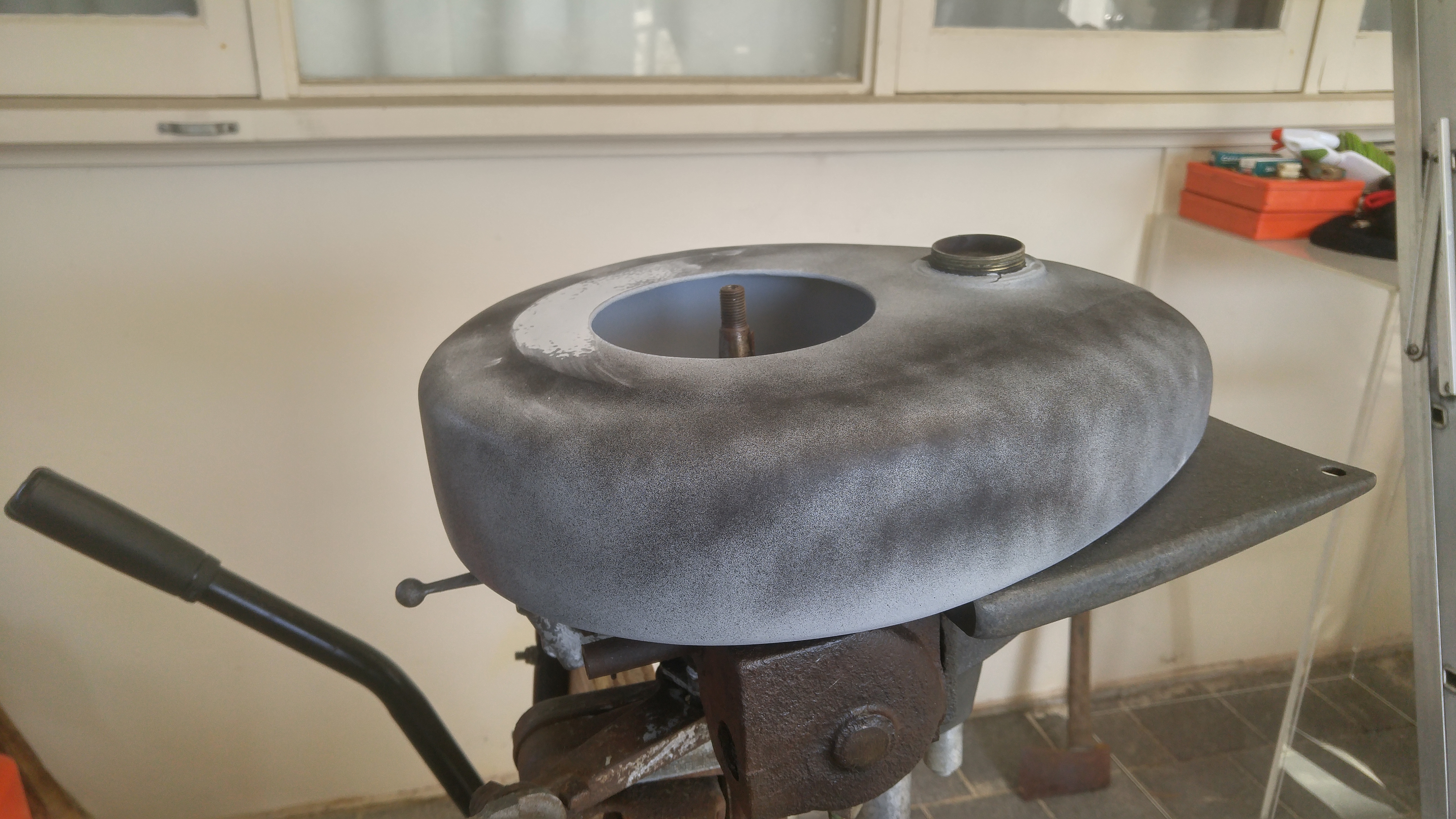

Tank spruced up!
I have no idea.......bloody Cat!
I can paint silver but maybe others have another option.
Bearing in mind this one (and the one of Boyd) were initially wartime no paint aye.
