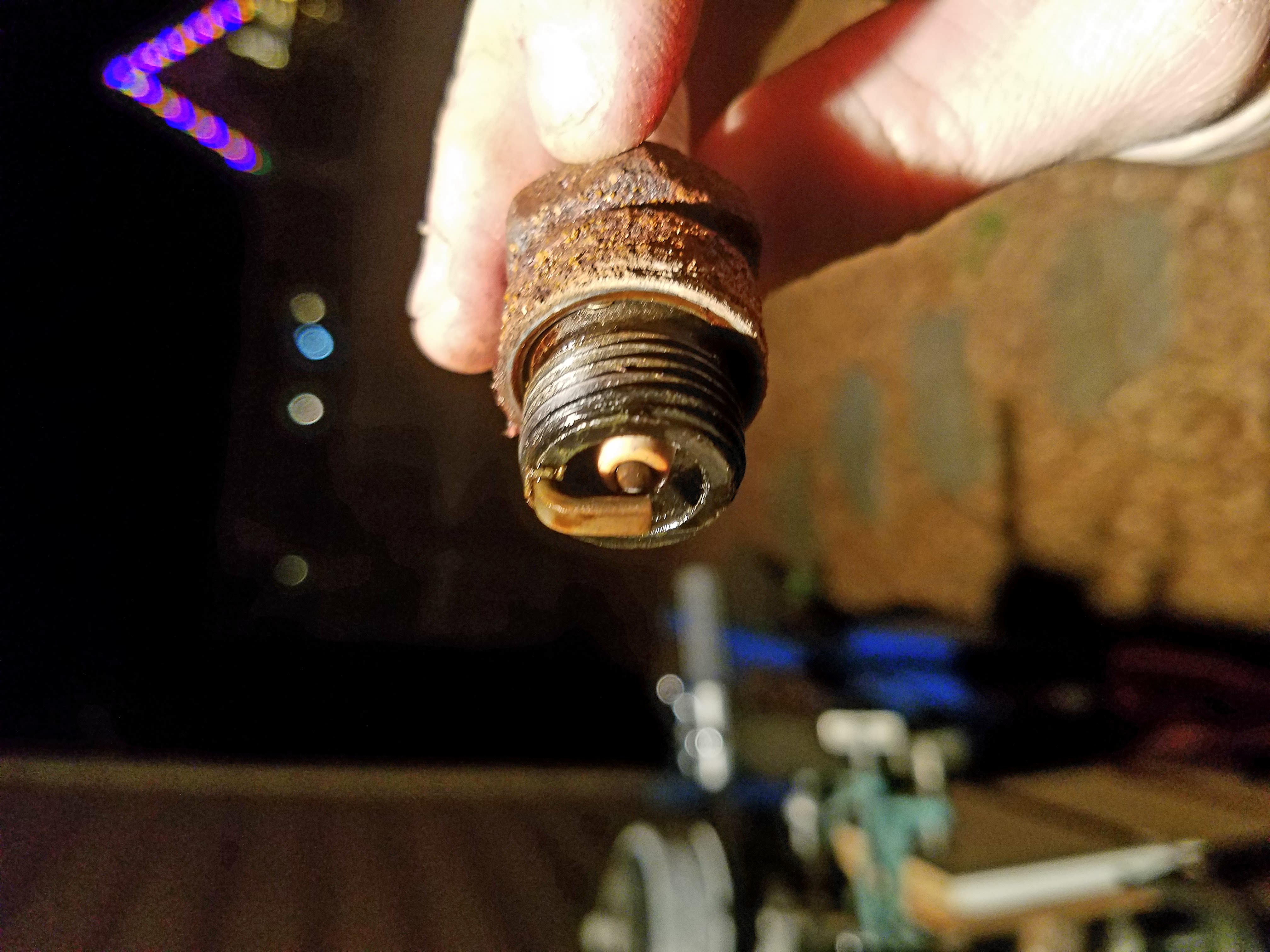

Sorry for the lack of followup. Finally got a chance to totally clean the carb. Don't have carb needle tools though so while i have an Amal carb, i dont know if a previous owner changed needles. It does have an autolite d9 equivalent spark plug...will test a d21 tomorrow which is my spare.
It runs about the same, and better on a super low oil mix (25 to 1). Sure doesnt seem to have any leaks, everything is tightened down well amd hose looks in very good condition.

Looks to me like you are running too rich, perhaps at 25 to 1 without the correct needle. If you want to run at 25-1 get the correct needle from John otherwise run with a correct mix of 8 to 1 which will give correct fuel to air ratio in the combustion chamber. The wet on the plug is not oil, but unatomised fuel. Then give her a good hard run she will thank you for it. I never change the design fuel mix on any of my engines. if you are into racing you will want to try a richer mix, but if not stick with BS recommendations. The fuel to air mass ratio will be correct resulting in good atomisation, the correct air fuel mass ratio is critical best regards, for xmas AJ
