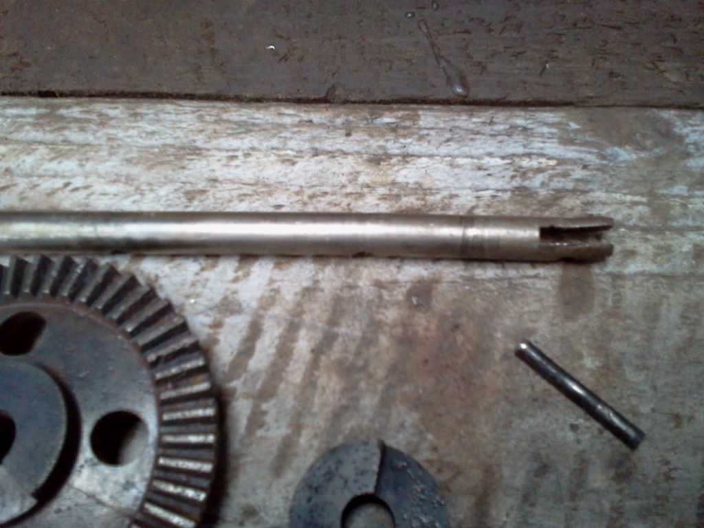

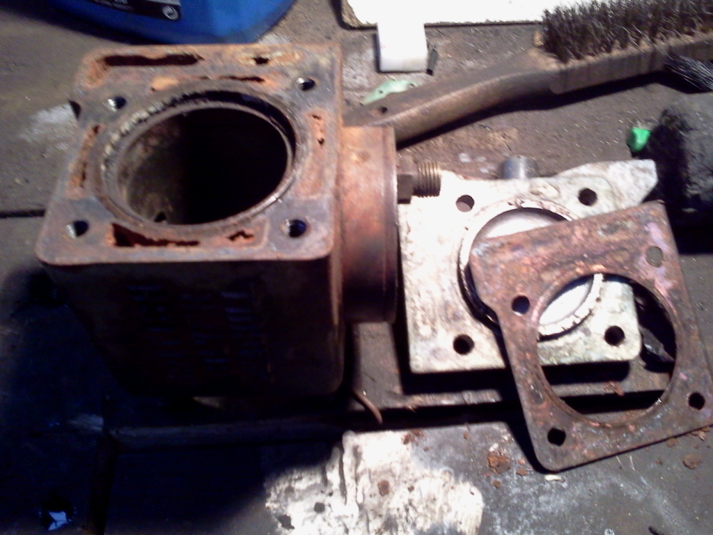

I have a parts manual somewhere but at the moment I can't lay my hands on it. So here's a couple of pics of the prop shaft ,prop and front casing. Apart from the gear box,what's missing?
And judging by the shape of the drive shaft I need a replacement
Re: What's missing?
Front collar that holds the shaft against the gearcase, possibly a thrust washer or two, a new gasket for the end cap.Pumphousing, drivetube, driveshaft, drive spring....

Re: What's missing?
Thanks for the reply.

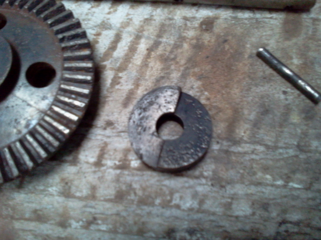

I need the thrust washer and from looking at the parts list,yep found it this morning,and a bronze collar.I have most of the drive unit,I have it soaking in a tank of water,bread soda and hooked up to the battery charger hoping to loosen the rust on it.

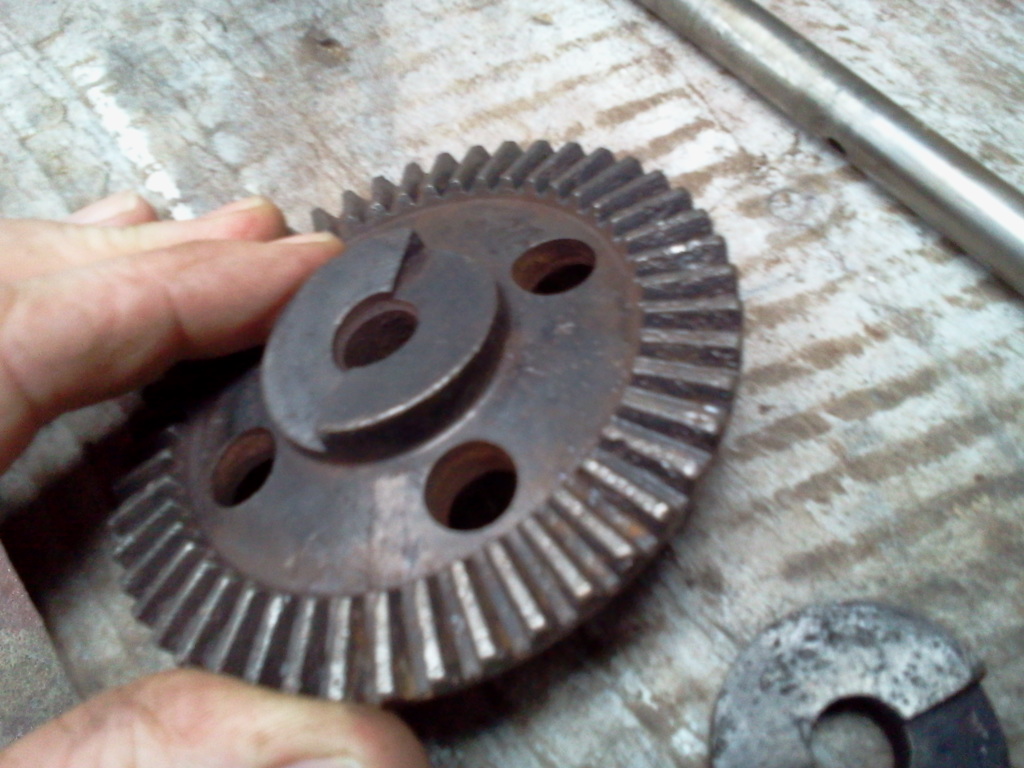

Question,does the crown wheel come off the prop shaft? If so,how? 'Cause I need one of those as well by the look of it.

Re: What's missing?
Yes!
There should be a pin holding it to the shaft.... It will be under all the dirt and rust!

Ok,crown wheel removed,cleaned and prayed for it.It is a 48 toothed wheel and some of them are pretty corroded,so now it looks like shaft and crown,not to mention the prop says CPC5.And I haven't looked at the carburetor or the ignition yet.Ah,the moment of madness

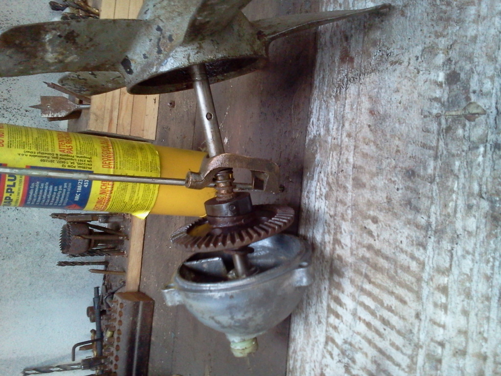

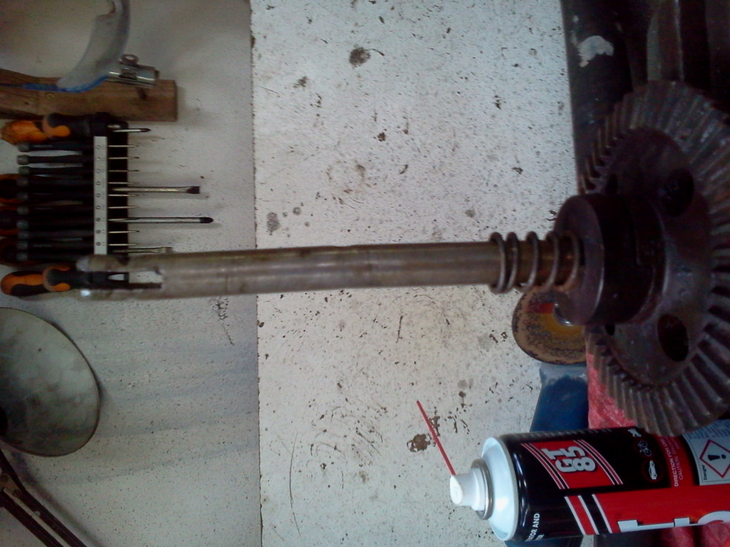

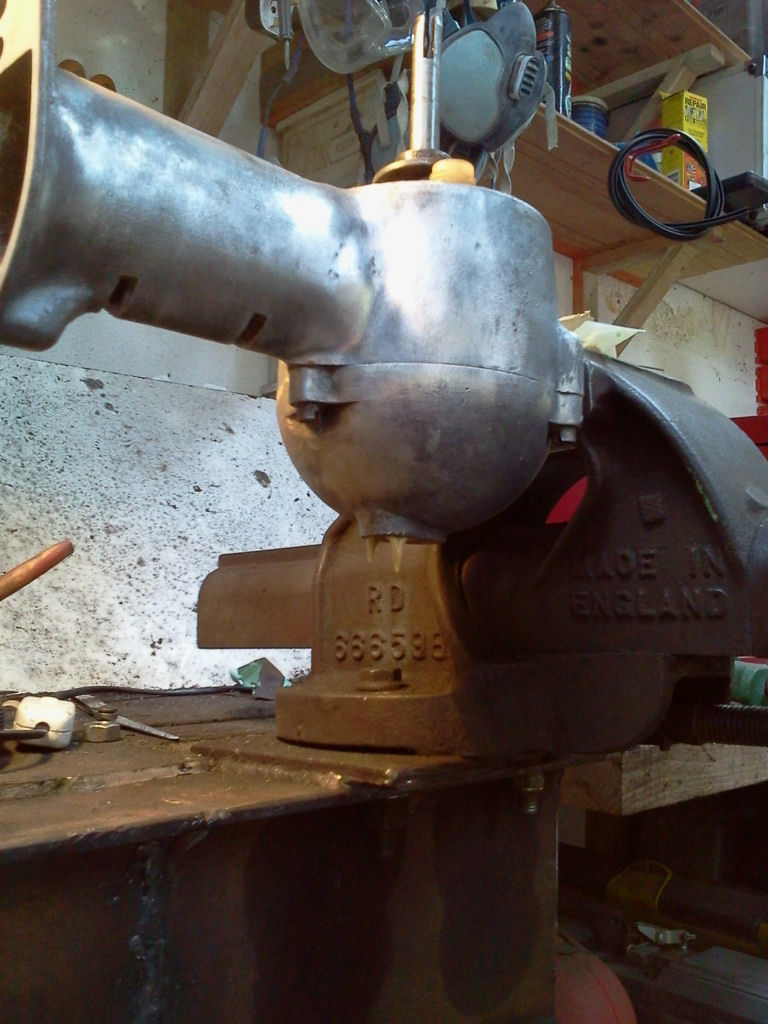

More questions.How in the name of God do I get the square drive out of this gear box? I have heated it,froze it,oiled it,soaked it in diesel,hammered it
,didn't break any more bits,no go.
So if I want to replace the damage gasket,might it be easier to remove the impeller,probably destroying it at the same time,or is there a pin or something I have missed?
Re: What's missing?
Try putting a piece of heavy bar with a hole in it over the drive tube. Then put a G clamp on the end of the drive tube and try and slide hammer it off.
Re: What's missing?
Or take out the split pin through water intake slots or you'll still be hammering next week china

To remove the pinion from the gearbox is a swine of a job at the best of times. Before you try and do this, see if there's any play fore/aft actually within the shaft itself. If it's good, leave it alone. Trust me, you'll only end up breaking something if you try and go deeper without the correct methods or tools.
If on the other hand it is too far gone, why bother going to all the hassle of rebuilding a tired old gearbox. There's plenty of these around on ebay or elsewhere.
(or somewhere else wink).
But you're right. The crown wheel is a gonner
On another note
How i remove the drive shaft is like this.
With the pump housing removed i then clamp the square drive shaft into a vice, good and tight. (probably a good time to order a new impeller for the next bit)
Heat the bugger up around the base of the driveshaft (you'll probably end up melting the impeller as you do this but don't worry, these are easy enough to replace later on)
Then with a rubber or copper/hide mallet and a lump of hardwood, belt the bejeezus out of the top of the gearcase (not too heavy though as you can crack the casting if you're not careful)) and it should start to come off slowly. It might take several attempts to get it to move, but stick with it and it will go. Please DO NOT strike directly onto the cast aluminium with a hammer, use a lump of hardwood.
And if you're really lucky (provided you've removed all the bolts before hand) the impeller shaft might come out at the same time.
Heat, and LOTS OF IT. Don't be scared

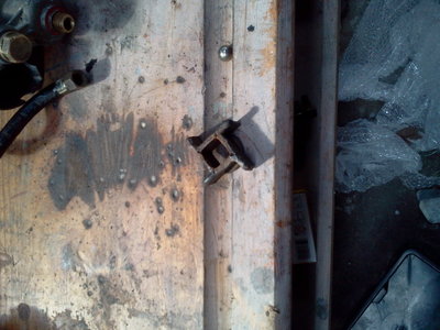

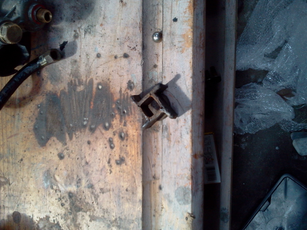

Follow Jons instructions on holding & if you only want to remove the drive shaft & not the pinion bearing, use a long 1/4" bar & a medium hammer after ensuring the bar is touching the top of the square pinion shaft, sometimes there is a cushion of rust & oil preventing them coming into contact, this will need cleaning away, just use the bar to knock the pinion out of the drive shaft.
Excessive heat on later drive shafts often will remove the hardening on the ends of the drive shafts & pinion shafts, not a good policy on a clutched motors, especially when drive shafts are no longer available new, as the correct size box section is no longer available.

Re: What's missing?
We are moving forward,without too much damage

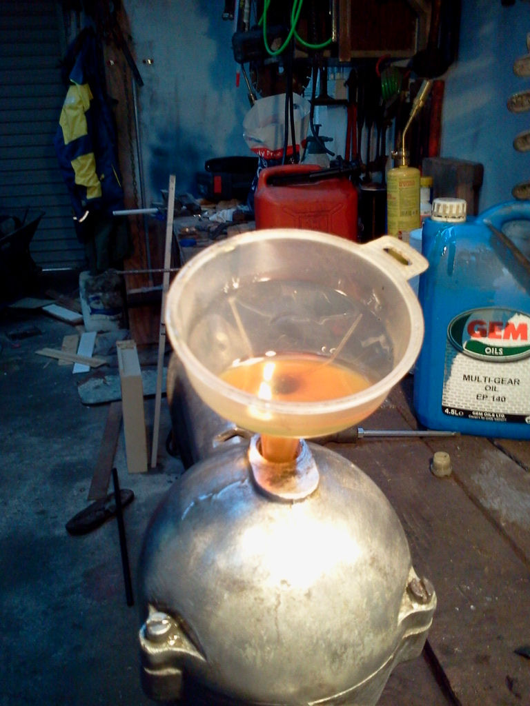

Gear box drained and refilled,thanks Tam,then let drain until it was level with with filler opening,just in case anyone was wondering
,block opened and cleaned,thanks Tam.New rings on piston,thanks Charles UK.

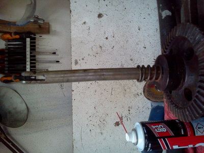

Removed the drive shaft as I needed it for replacement gear box,need new impeller

That will still work! Just not as good as it should!!Definitely need new impeller
