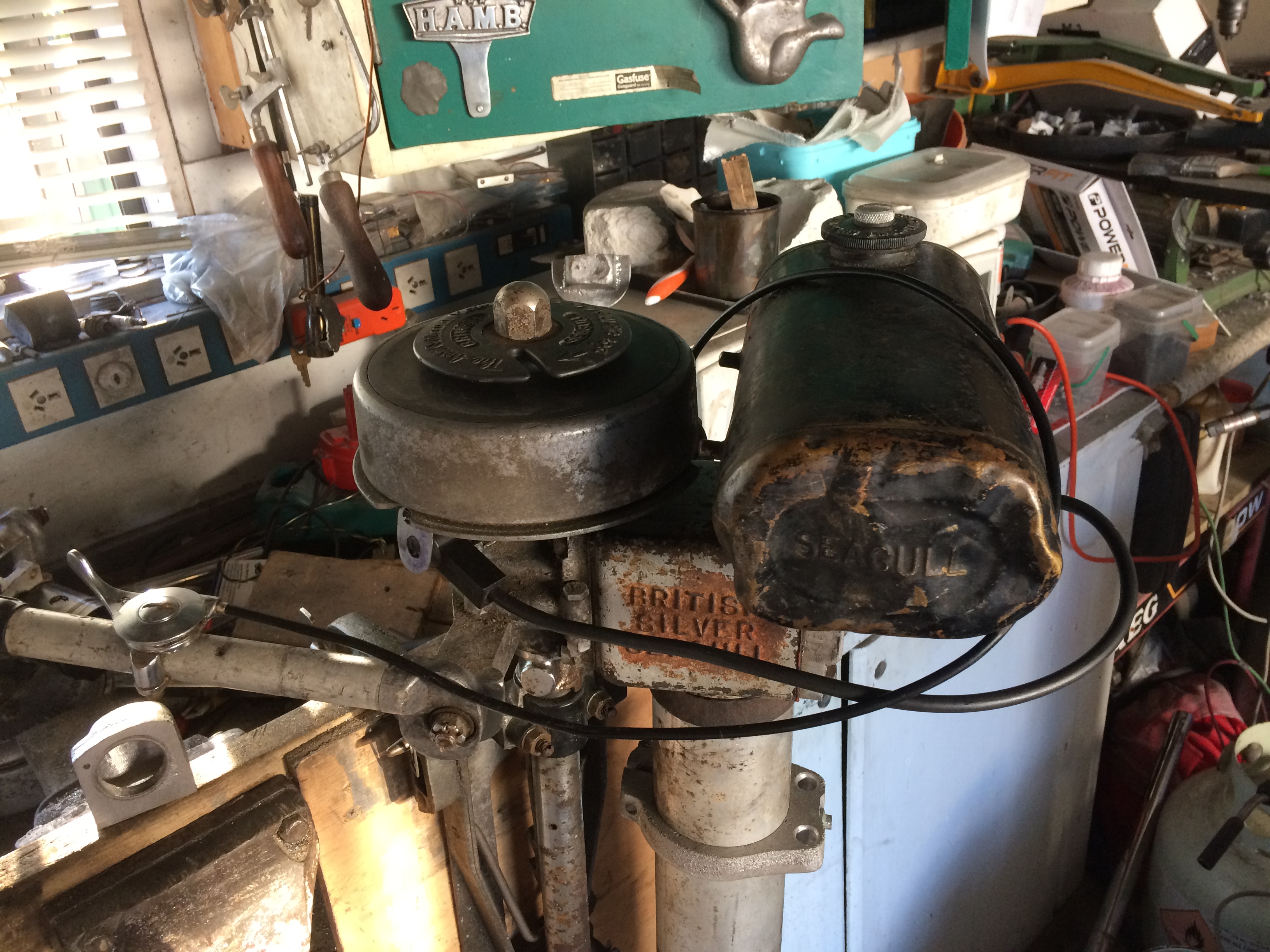

Am running Amal 416 on my bodgered CPCL and it runs quite well. BUT, the tiller and carburetor are on opposite sides of the block. Thus the throttle cable is in severe danger of encountering the flywheel. Any suggestions?

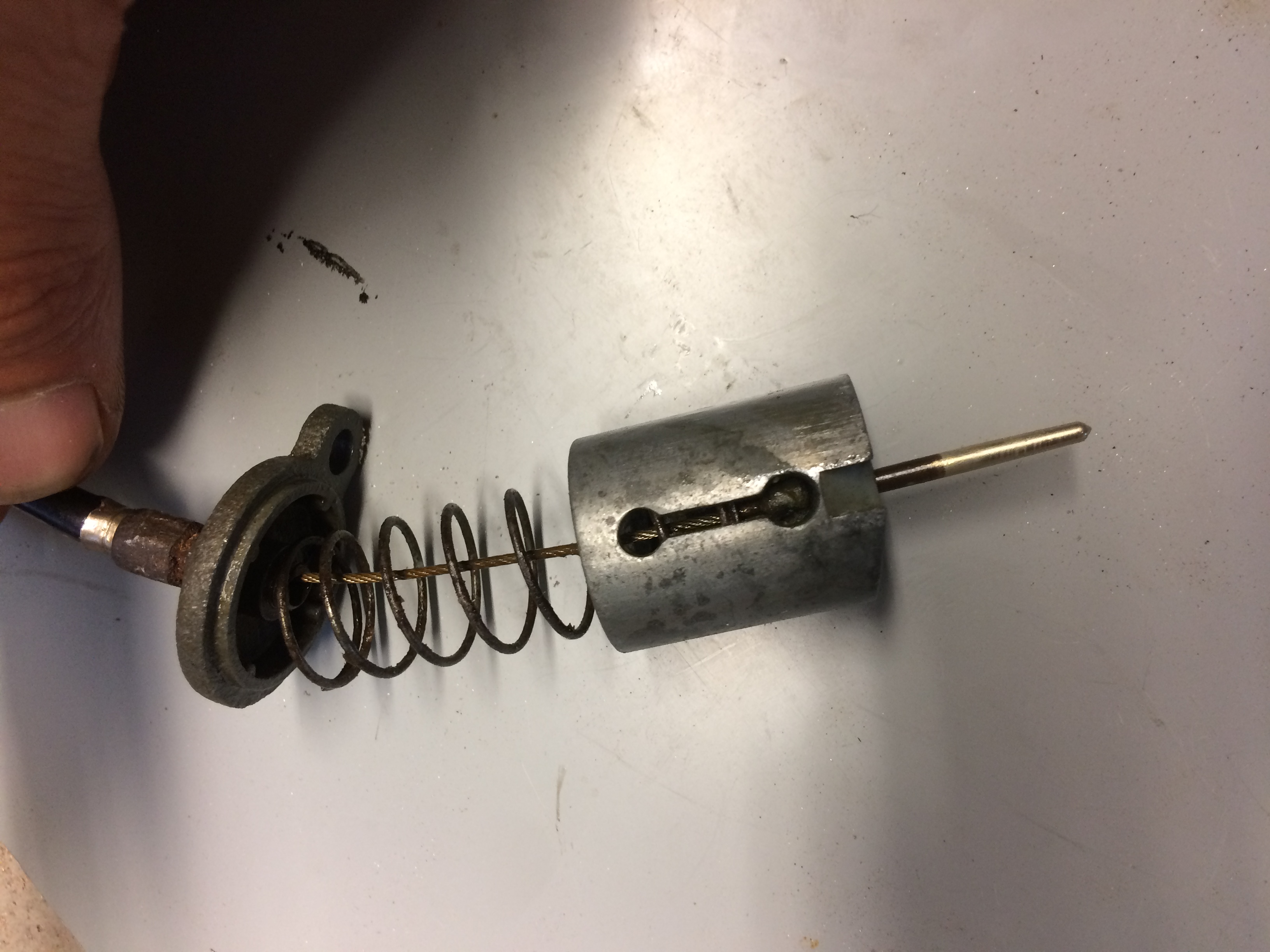

The cable is located in the side of the carburettor slide (valve piston), remove slide from the carburettor, hold top of carb and cable, push the slide against the spring to push the cable out of the bottom of the slide.
Remove the cable adjuster from the top of the carb, this will let you remove the cable completely.

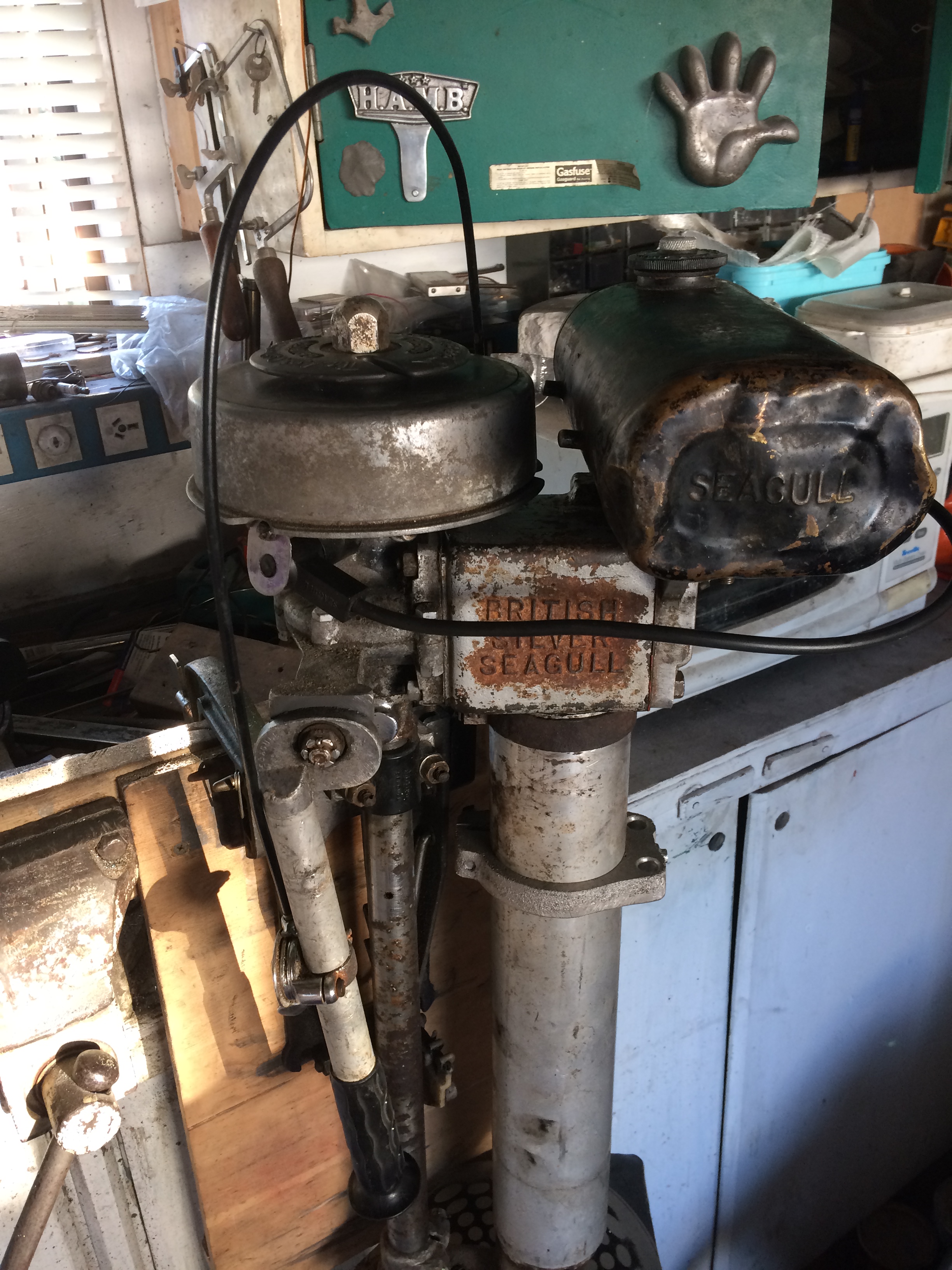

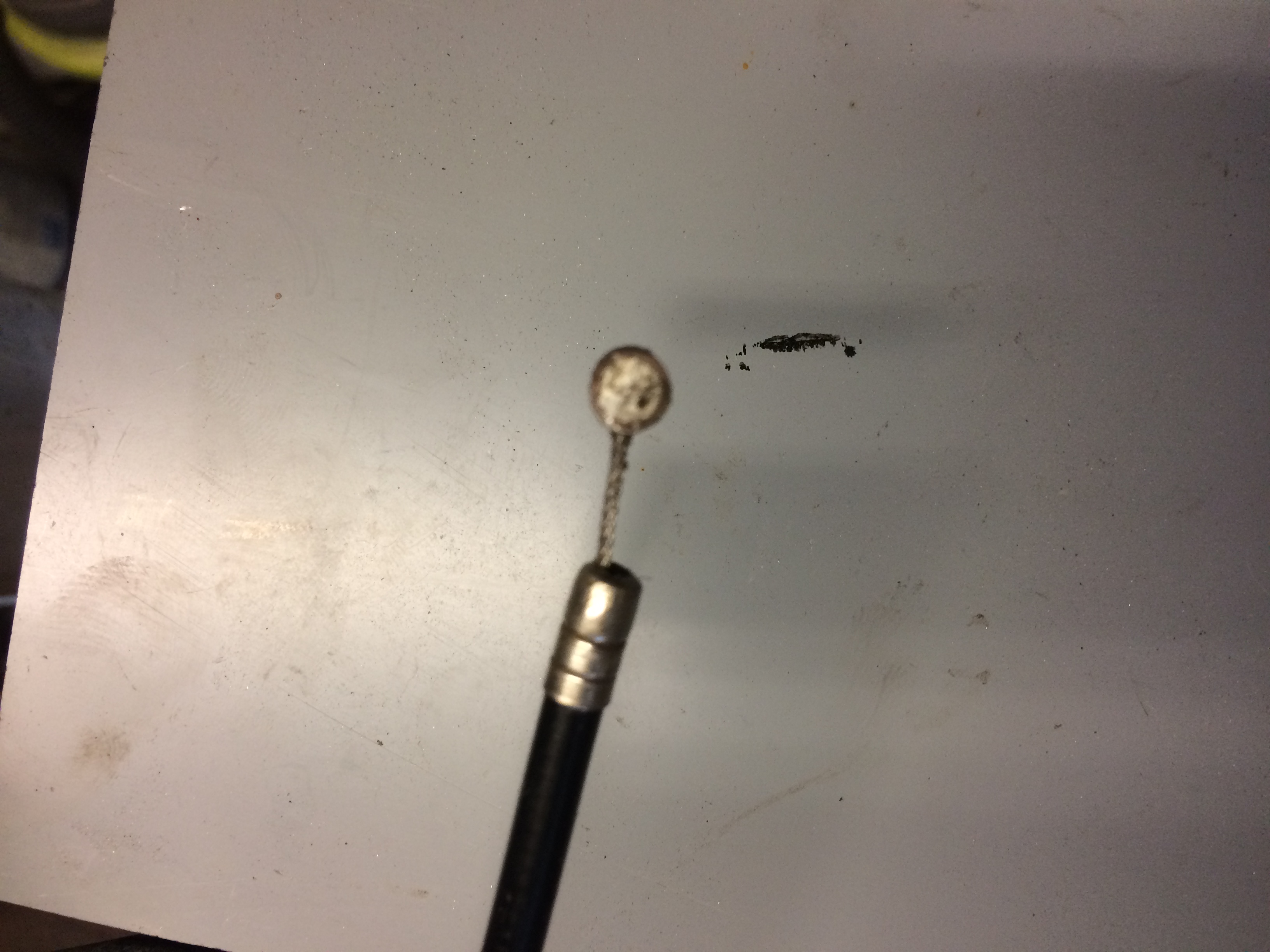

A few pics and sizes.

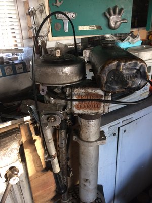

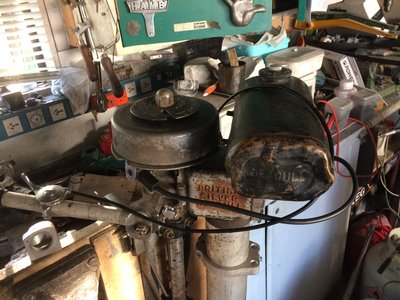

I make the cable quite long for two reasons, 1 it keeps the cable away from the flywheel, 2 I need it longer than normal so it can be hooked into the remote throtle on my 20 footer. even if the tiller is tilted up or down the cable can't touch the flywheel. the first thing you need to do is work out how long you want the outer and where you want it to sit.

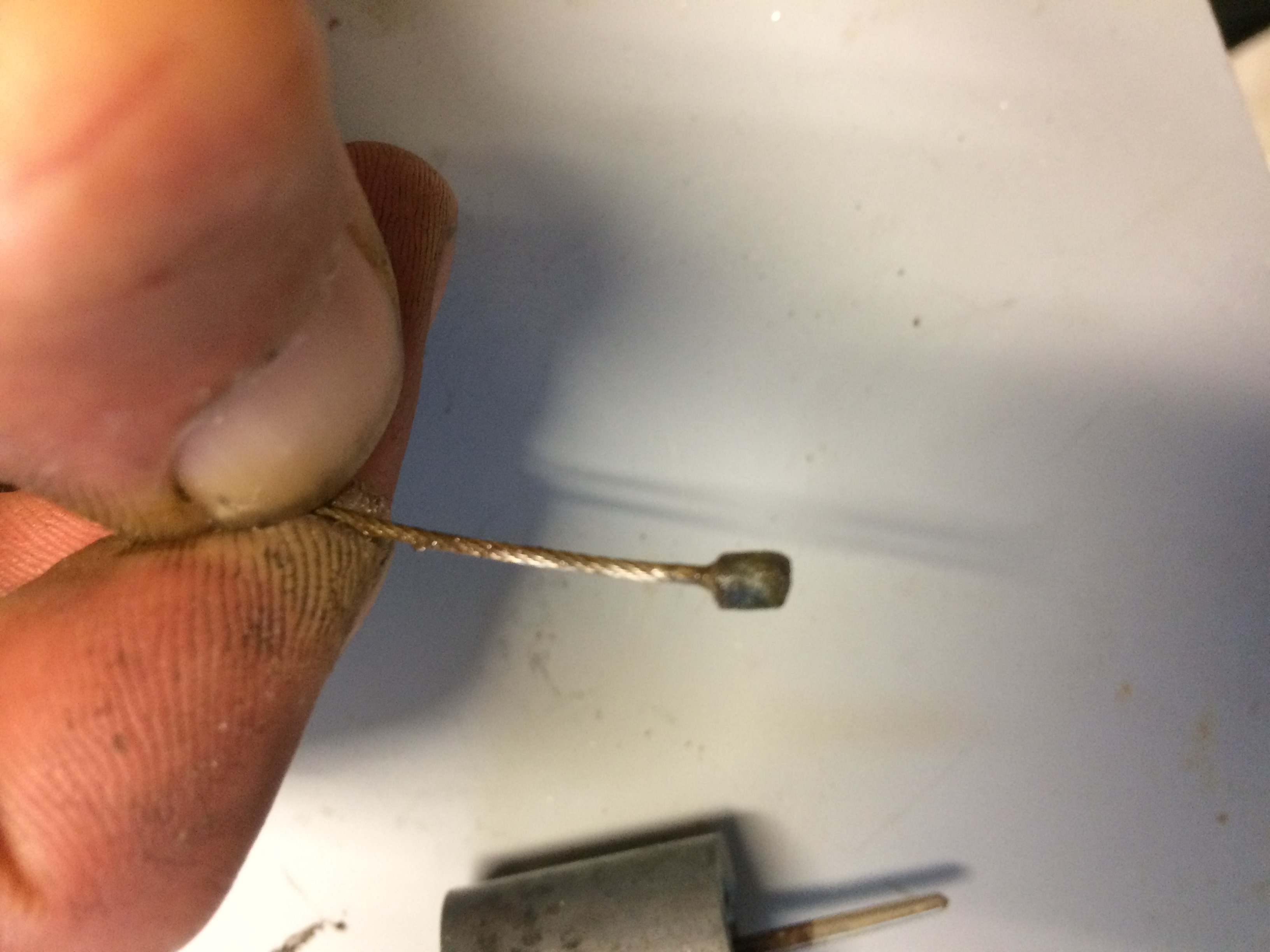

The cross drilled copper pipe soldered on the end of the cable The copper tube needs to be 6mm dia (I start with 1/4" and fileit smaller) and 3mm in height
The other end needs to be able to fit air slider so make that end 3mm dia and 4mm long

As long as the small end fits into the hole and lokes in place that is all that matters

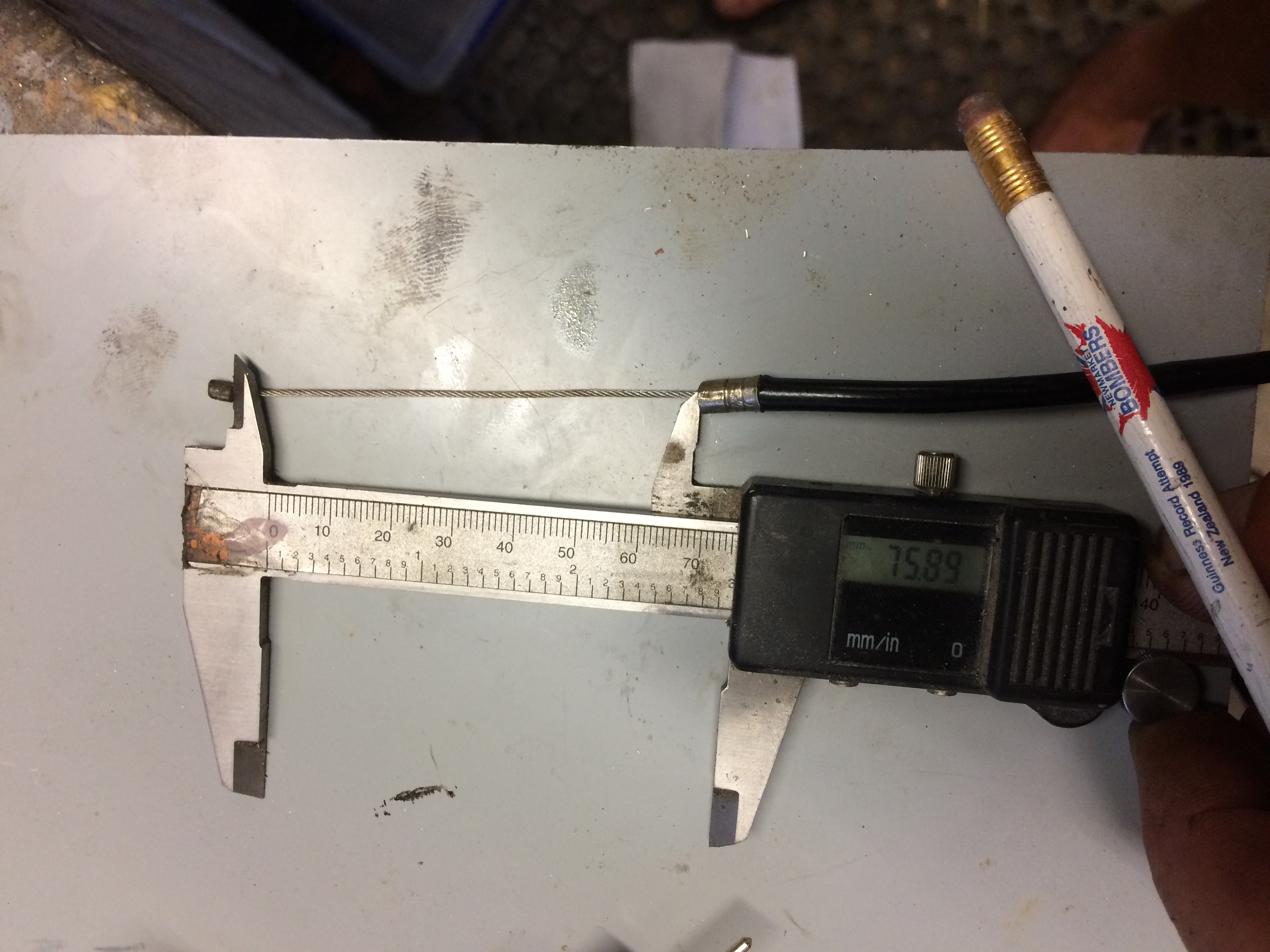

Make the inner cable 76mm longer than the outer.

HOWEVER, I am using bicycle cable and sheath with bicycle gear shift lever. Will this affect the 76mm (3inches?) difference in length? Is this measured from end to end of both cable and sheath, or does the shift lever affect this?

With the cable setup in the gear shift lever, you will need 47.5mm of cable (measured the same as in the other pic above) Have the lever set to slow when taking measurements!
