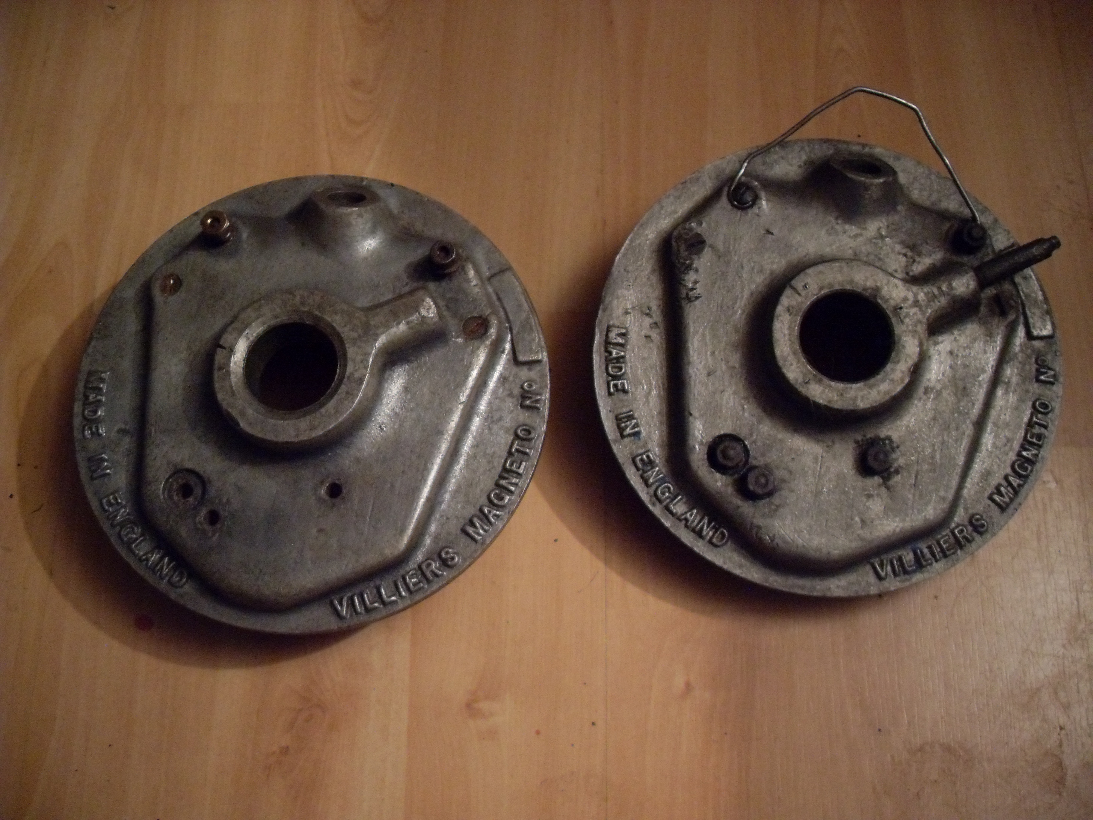

I'm after a working baseplate for AC13705.
This particular 102 came to me with the wrong baseplate fitted, and to add insult to injury it no longer makes any kind of spark. The flywheel has the correct age related date numbers so i can re-use this no probs.
If anyone has either a replacement coil from another POST WAR villers ignition, or a complete "flat top" baseplate in working condition i'd love to hear from you. Ideally these normally have either a brass or an aluminium points box, but more importantly the points are adjusted by tiny little lock nuts and NOT a screw as it would be for a later ignition.
Here's hoping...
Take a look at the pics below for identification purposes as these are quite specific for certain years on these older 102's.
Here's hoping...

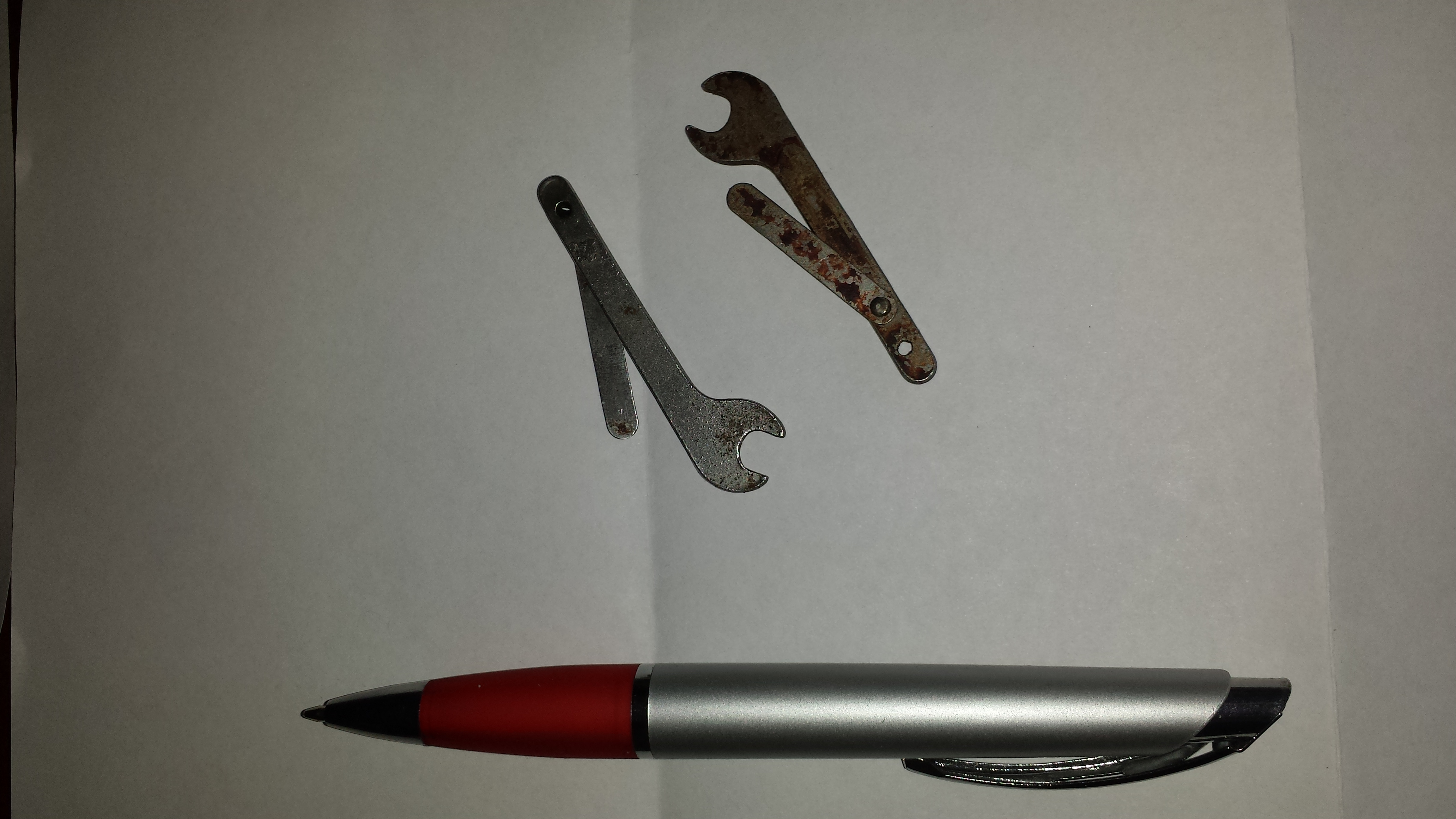

I thought only the JM mags have the stud/nut adjuster system. Most have been converted to the slide or are they on the later JM's?
You will need the adjuster spanners with feeler gauge:

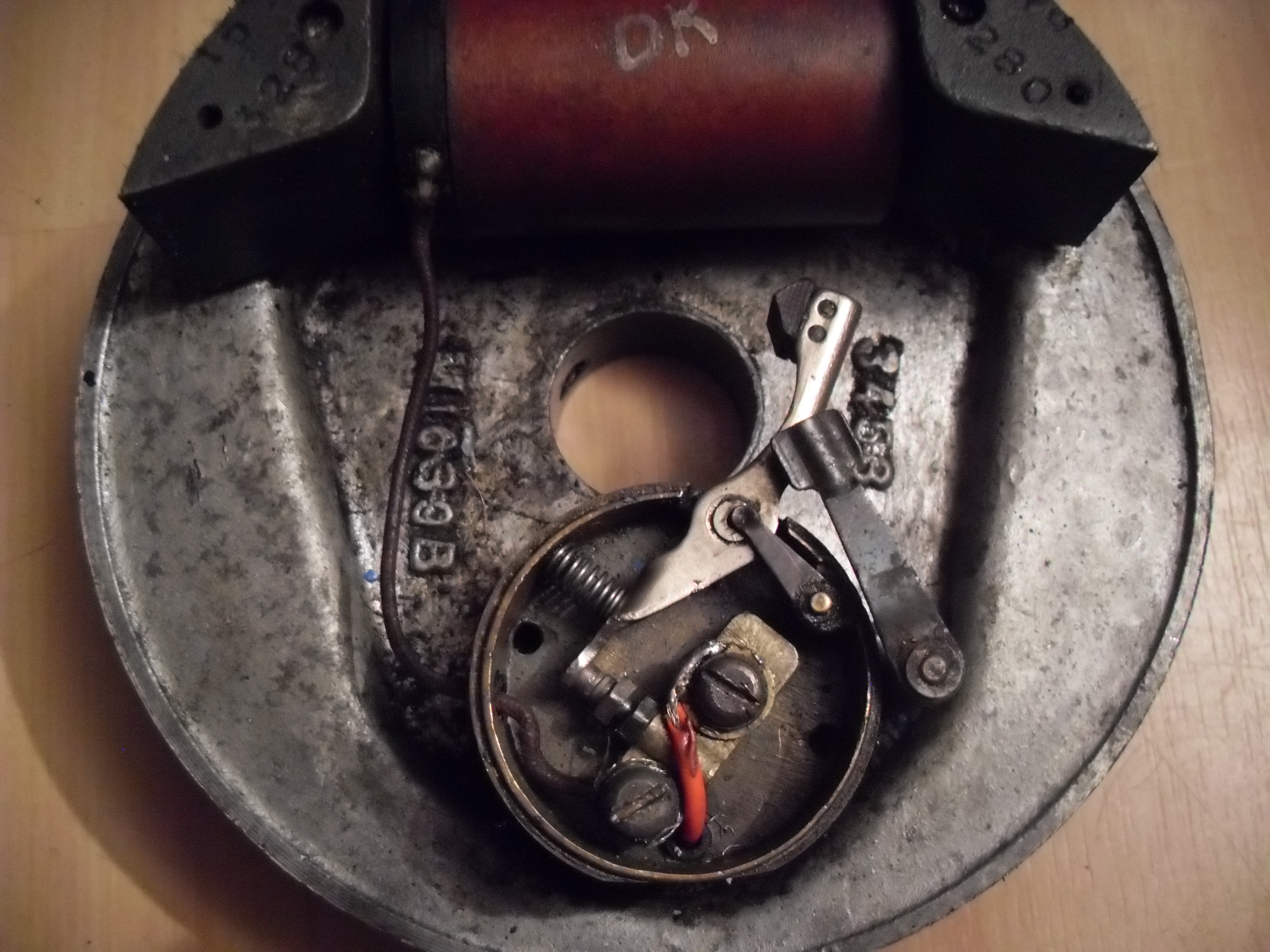

For Adrian's benefit, (and perhaps others too) here's a quick pic of lock nuts on points inside a brass points box just so there's no confusion as to what it is i'm after.
Not your average villiers baseplate as i've tried to explain, but something a bit more unusual. (and perhaps a lot more scarce than your typical villiers mag)
Enjoy

I have a pair of those spanners specifically for this type of villiers ignition. (teeny weeny ickle things aren't they) All good
.I'm not entirely 100% with the feeler gauges on 'em though. I prefer to use a different set of feeler gauges when setting up the points.

They're only in what i term the "flat top" magnetos and of course the coolie mags.
Everything made after these became a lot more conventional (more what everybody's used to seeing)

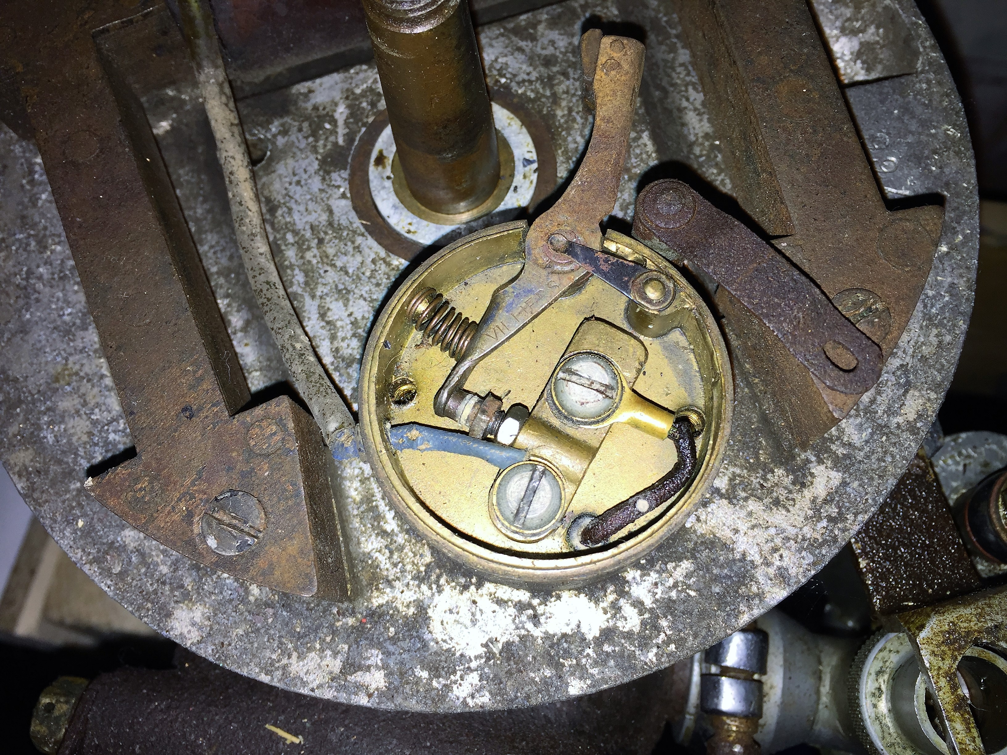

I know exactly what you are on about. Villiers parts have the points listed on their website, but low on stock. I'd give George a call quick.For Adrian's benefit, (and perhaps others too) here's a quick pic of lock nuts on points inside a brass points box just so there's no confusion as to what it is i'm after.
The brass points box is the same as fitted to SD and prewar Marstons, then subsequently fitted to the early post war flat top baseplates.

Just had another look in the shed, an early AC with brass points box, I never knew that.

Yes, mine has a brass point box too.
Oops, I gave George at Villiers a hard time for sending me a brass box years ago for an SD, mind you I did particularly ask for stud points and he sent me the modern slider ones. When I questioned that, his response was to the affect "what's your problem, it works doesn't it". So much for authenticity or was I being an emo?
