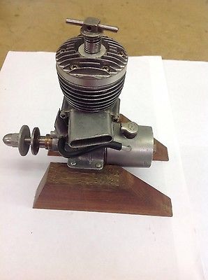

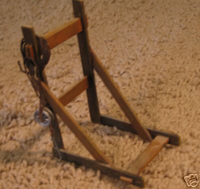

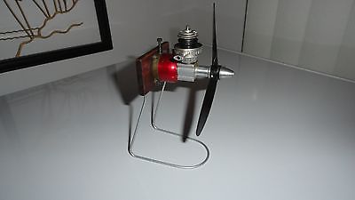

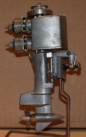

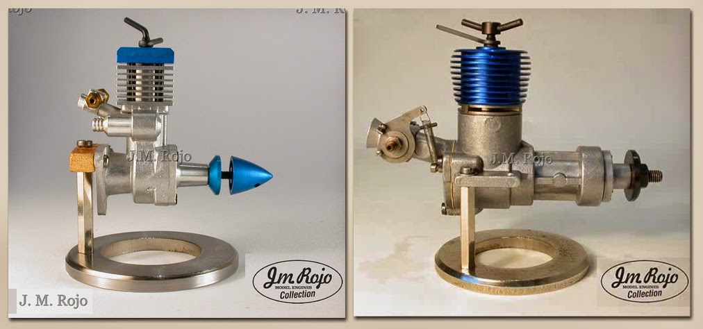

Just thinking that there must be many ways of mounting said collectables for a display cabinet or similar.
As I said last post, I have a LOT of them and it is time to get them out of cardboard boxes in a cupboard and out for dusting if not in a cabinet.
Aircraft engines, marine engines both outboard and inboard, large and small. Some with Propellers and some without.
Attached some stuff as ideas from the net.
Open to any easy Ideas aye?

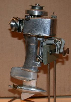

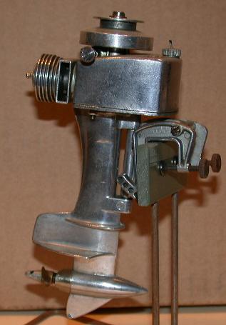

More
Allyn Stand.JPG (24.31 KiB) Viewed 5038 times
Allyn Display.JPG (2.34 KiB) Viewed 5038 times

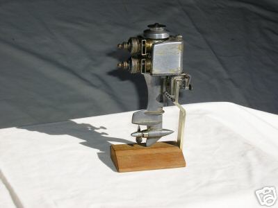

And then the plexy..........
Kind of thing............

Second batch much better more realistic looking and super sexy. ...

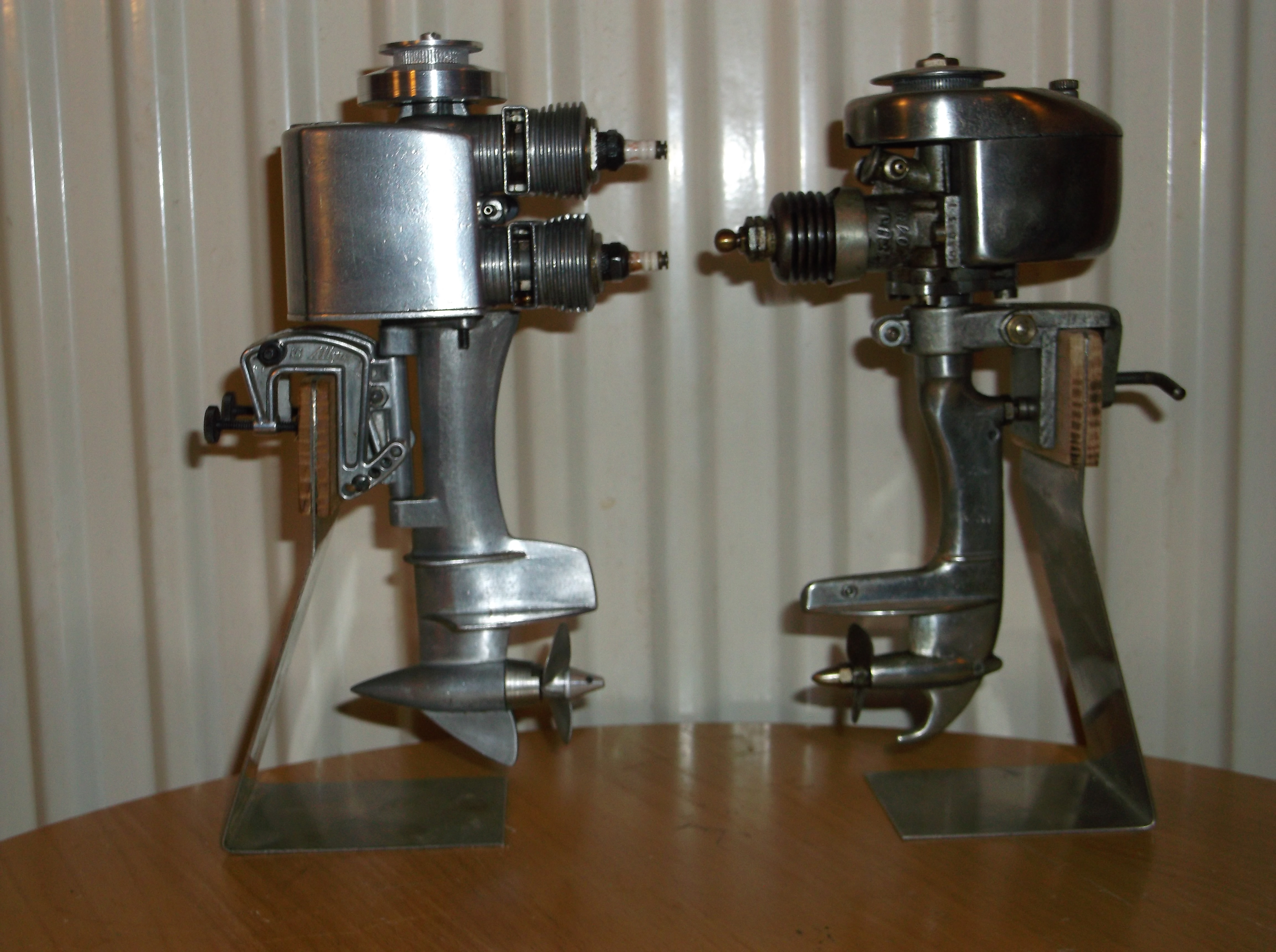

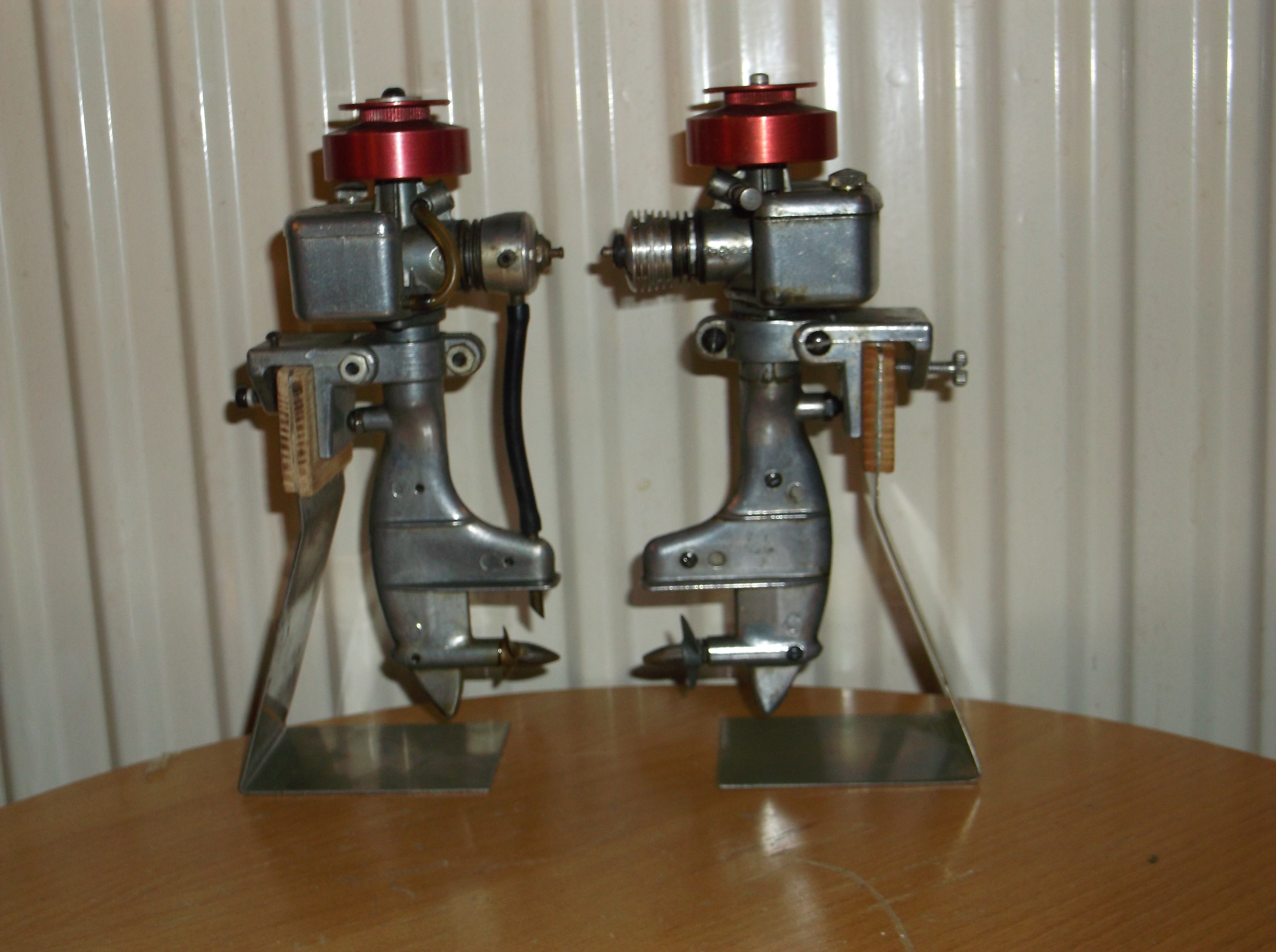

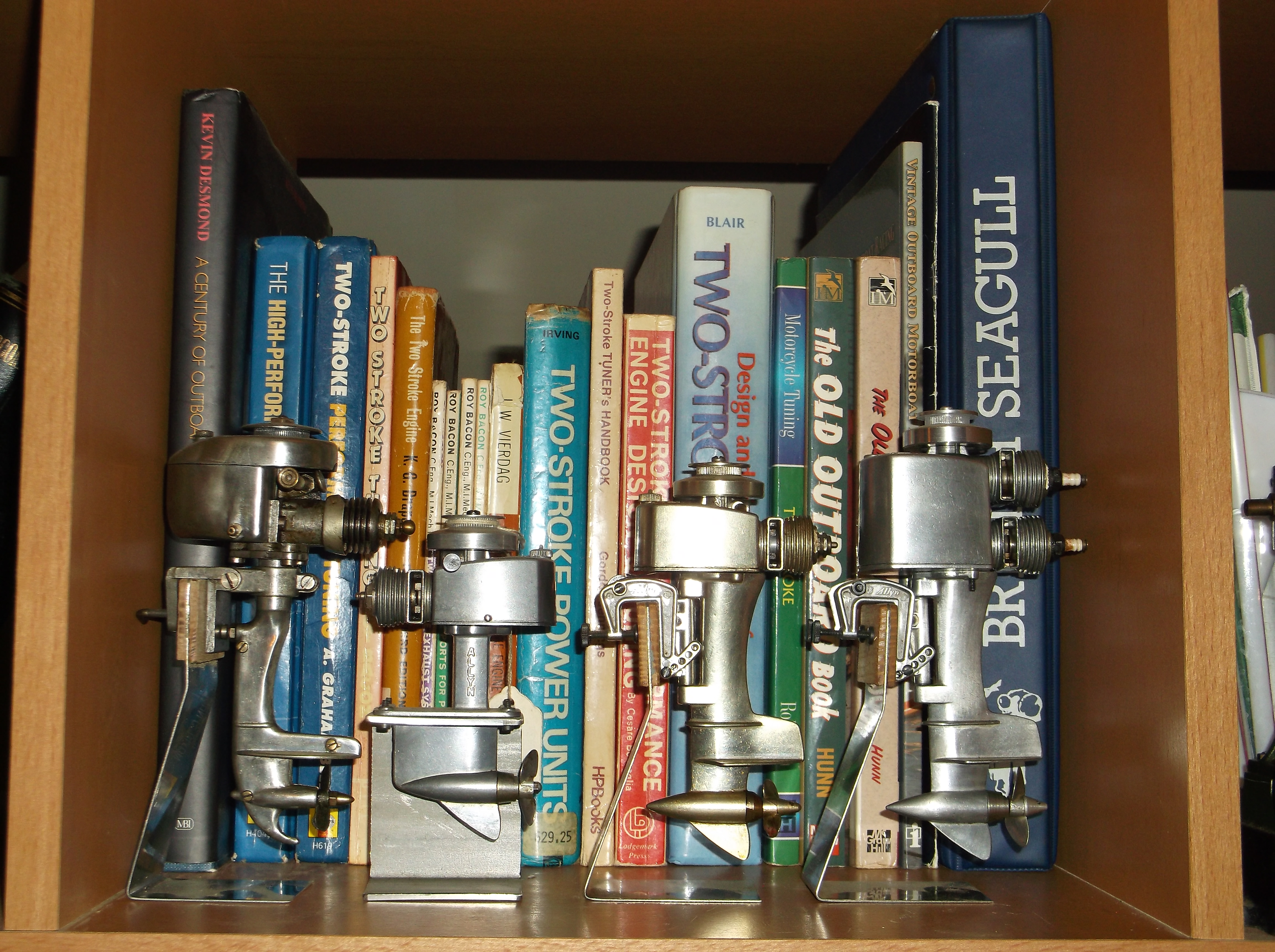

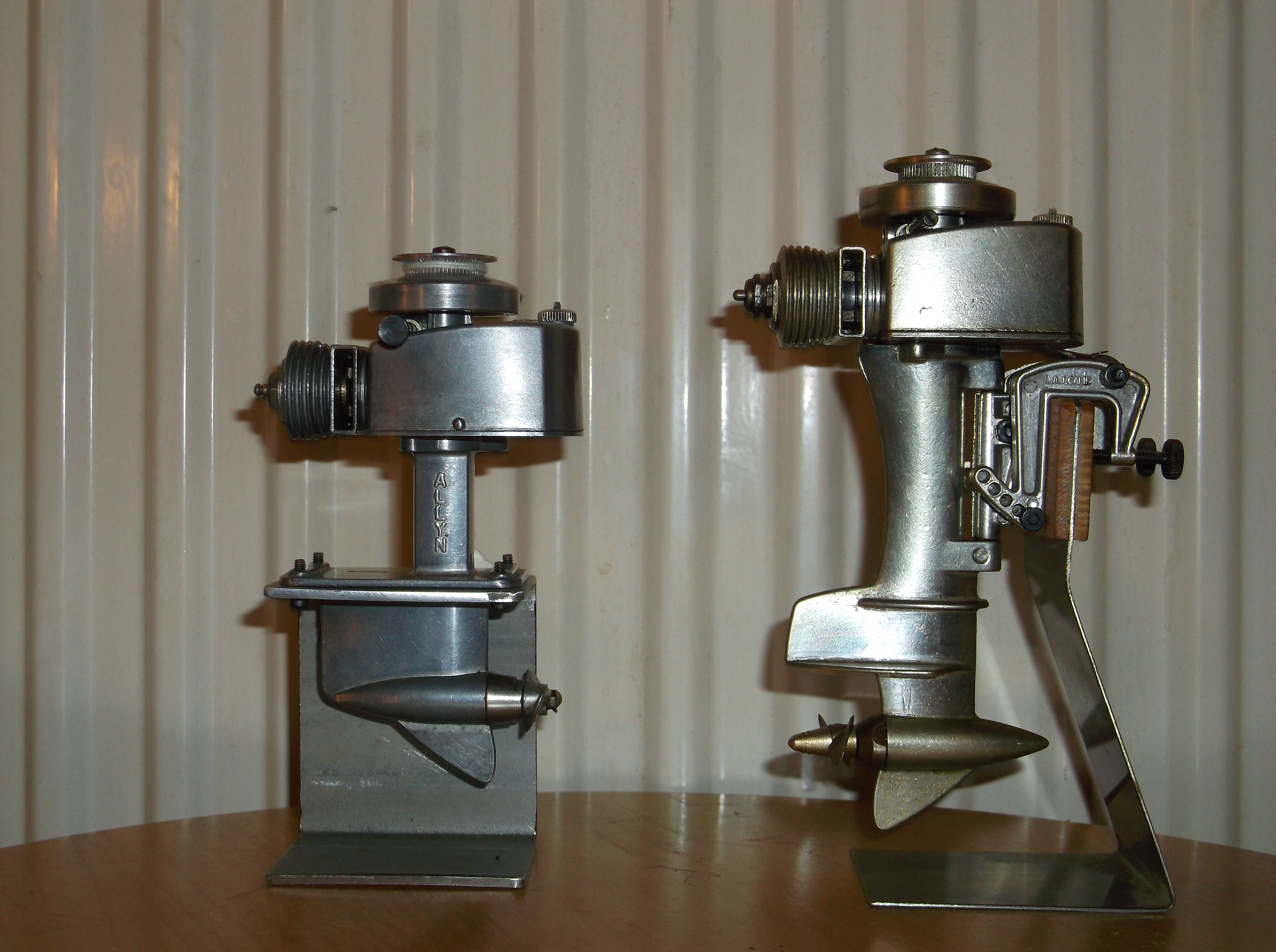

Folded stainless steel works alright & it's cheap & easy.

Nice very nice and super sexy. ....

Interesting book collection Charles. Do the secret of racing seagulls lie within those sacred tomes?

Nice and easy as you say Charles.
They look great too!

Hugo, there's more on those shelves, if your going to study something, you have to do the job properly & if that involves reading every book you can find about the subject, then that's what you have to do!
If anyone can recommend any publications on two stroke performance tuning, please let me know.

Nice one Keith and nice one Charles as the bent steel concept is a winner with me.
Re: Miniature Engine Display
They started off as a piece of stainless sheet, 42 x 165 x 0.9 mm (20 gauge) with 2 slivers of English oak 42 x 28.5 x 2.8 mm epoxied on to provide a cushion for the transom bracket, it takes longer to de burr them than anything else.
They work for everything apart from the Sea Fury through the hull, & might not be quite man enough for a big Fuji.
