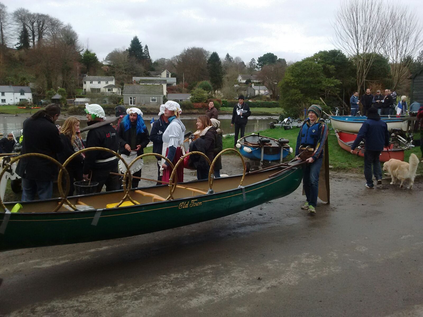

"Five gold rings!"

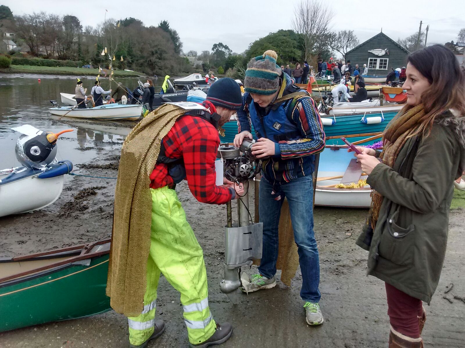

last minute, preflight checks

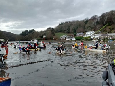

paddle out to the silent start

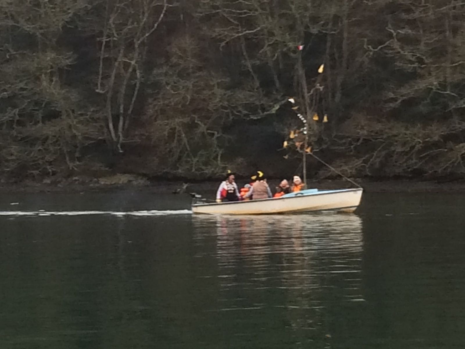

"a partridge in a pear tree"

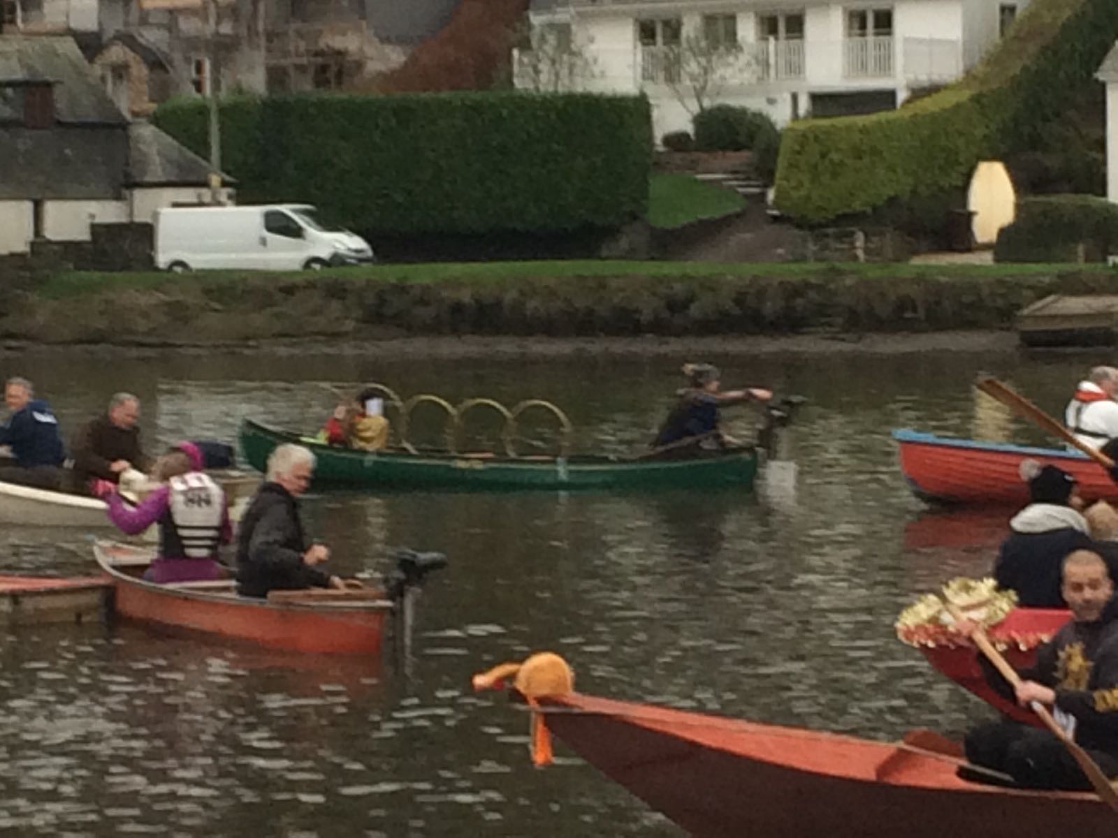

start your engines!

Our outfit consisted of a 17' Canadian canoe and a hotchpotch engine. Longshaft, 102cc, maybe a silver seagull?, Amal carb off some old motorbike, 2:1 gearbox and an alternative propeller. I'd had a not very well thought out tinker inside the engine, played with smoothing and widening bits here and there and adding bits elsewhere.

Just a suggestion, ditch that carb that's fitted onto your 102, and find yourself a good 46n replacement.
Secondly, don't be afraid to get stuck in and clean out that waterjacket in your cylinder. I bet it's full of crud inside which won't help things too much with the cooling. And did the shroud around the gearbox actually help with streamlining at all?
BTW, what type of prop is that i can see in the pics? Curious that's all...

Thanks Jon,
I have an old amal seagull carb but it's pretty scummy. I chose this old bike one as I have heaps of jets lying around for it so had a go at jetting it. The carb doesn't need to do a very refined job, so long as it starts and the mix is not lean at full throttle it's satisfactory for this job.
Water jacket is mint, fully cleaned out just before. When it's pumping, it pushes a lot of water through, I think it was just a case of being slightly too high in the water.
Re. Cowl, who knows, looks the part though! And doesn't weigh much at all.
Re. Prop, don't know exactly, it was an eBay buy. Came off something Japanese or American I think. When I bought it, it seemed to make sense in terms or diameter and pitch for my boat/engine/gearbox combo. But maybe something a little "harder work" would help lower the revs a tad.
