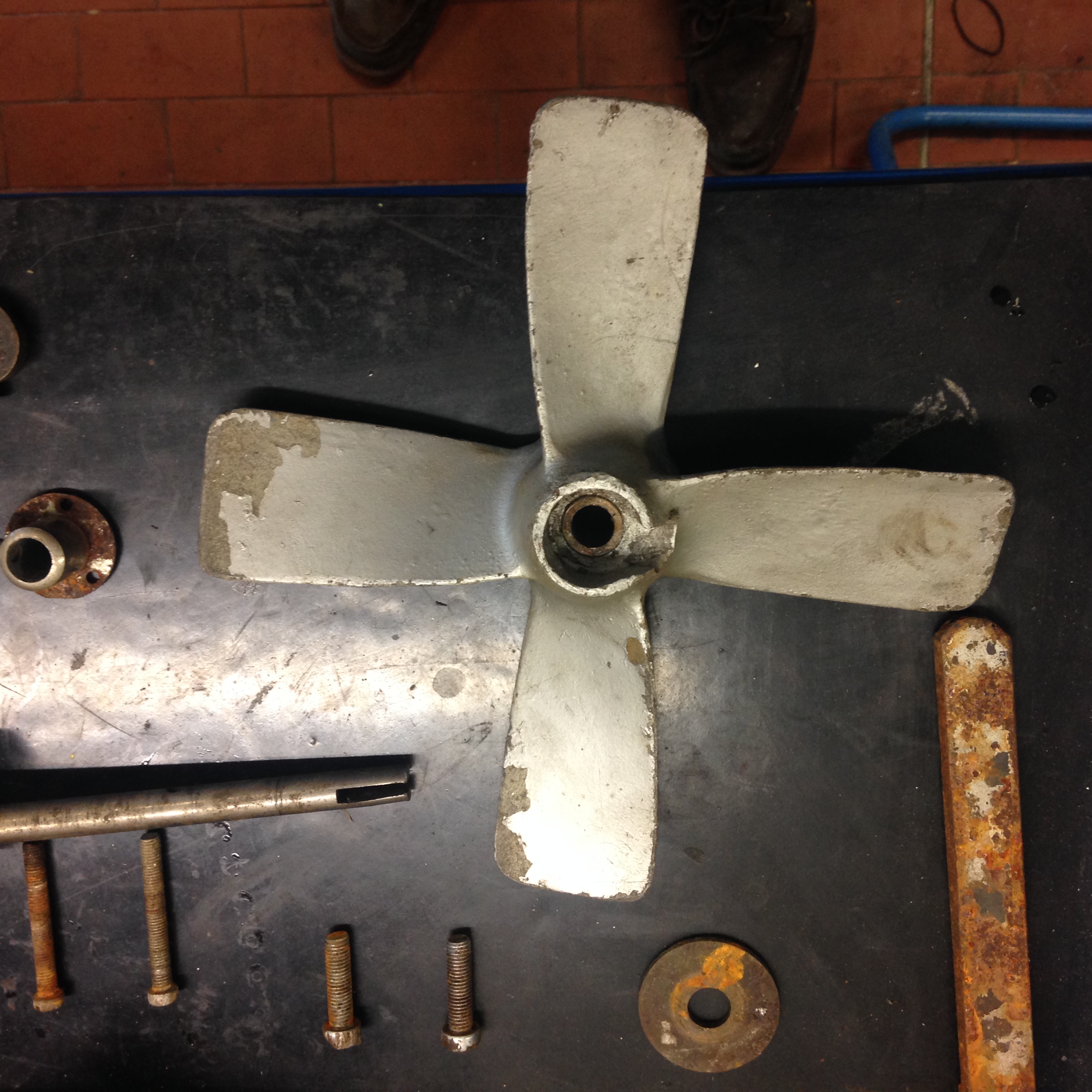

Also do you have the correct prop? If the prop is incorrect you might be trying to drive a prop that is too coarse pitched.

Engine is 102 TC80928L, with Amal Twin jet, the propeller is in the picture attached. Fuel tap and fuel line are not original,I'm waiting for the parts I bought to replace them. Is it possible to remove the jets without the proper tool?

the prop shouldn't be the problem.

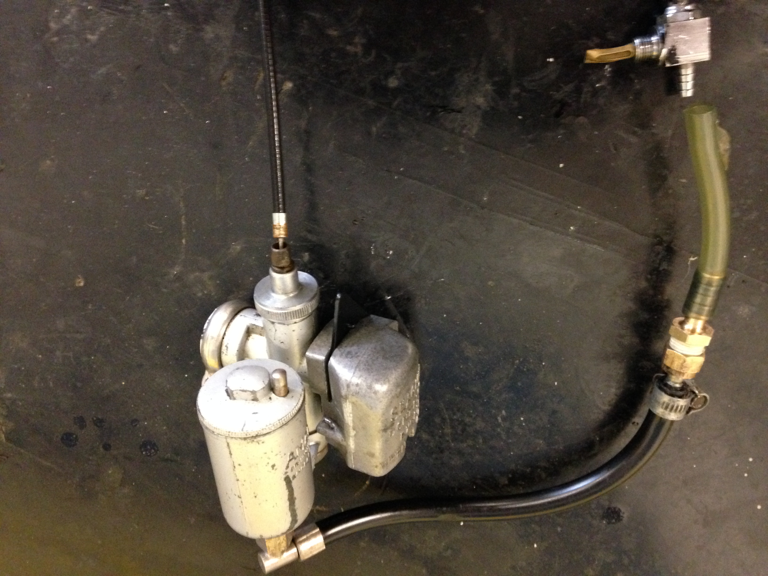

I've cleaned the jets and filter, also the original fuel tap arrived, but it doesn't match with my fuel line connector, the fuel tap is 11 mm male and the fuel line has got 13 mm female connector. Any suggestion? Is the original fuel line 13 mm (1/2 inch) at the carburetor link and 11 mm at the fuel tap link?

Sounds like somebody has fitted odd sized fuel tap and pipe to your engine. we all like pictures by the way.

Yep
Have a go at getting some pics on here so we can see what the problem is.
Oyster's right, we REALLY like pics on here. (we're a strange lot aren't we?)

For me it's enough to know if you remember if the original fuel line has got a connector to tap smaller than to the carb one, because mine which have been modify has got the same size on both sides.

What does it say on the propeller hub?

Charles uk wrote:What does it say on the propeller hub?
sorry I don't understand the meaning
Re: 102 doesn't accelerate over half throttle.
You need to make sure you have the correct prop fitted, they are usually stamped, to show what engine they are for. If you have a prop designed for a different gearbox, then your engine may not have the power to drive it.

Finally I got pictures, here is my actual set up which has got a not original fuel tap, than I purchased in UK a used original fuel tap which doesn't match the fuel line connector.
