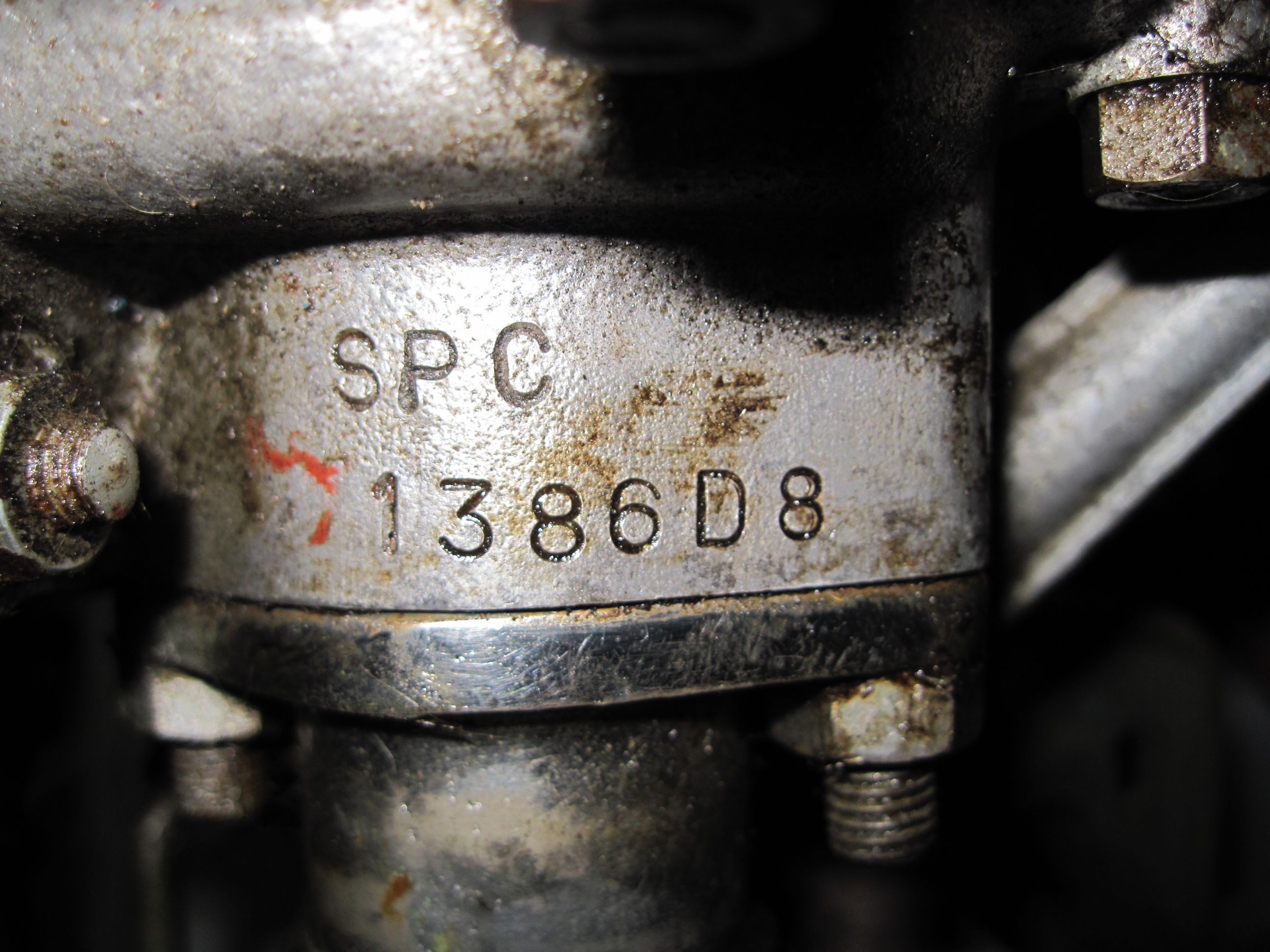

And now a couple of the Silver century plus in question. Sorry they're not very good & that I can't get the first to rotate, it's fine on my PC !
It appears I don't have many photo's of it, I'll try to get some better ones in due course.

Hello Tim
From your seagull pics it looks like your motor had been 'shortened'!
You might have a perfect compromise with the motor and the boat as a result.

Definitely shorter, about three or four inches shortened, even better for what you are doing.

That's interesting, I'd never really compared it to another or looked at what the overall length should be. I now see that as a std shaft century + it should be 41.5", mine measures 37.5", same as a std century or 40+ should be.
Could it be a mongrel ? or could someone simply have done a cut & shut job ? It's been done well if that's the case. Is this kind of thing common ?
I don't know any history, I actually purchased it at a local village auction about 8 years ago, it wasn't something I even had a use for at the time but there wasn't much interest in it, & it looked like it may go to a local scrap dealer, so I decided to save it. I'm a bit soft like that :oops:, anything old, especially if it has an infernal combustion engine pricks my interest. Now it turns out that it's just that little bit more special :lol:

Hi Tim
Here in Australia, I have seen a number of Seagulls that have been modified in that way, but the ones I've seen have all been 102 models.
Definitely a home-made job, Seagull never offered an extra-short-shaft model.
Have you had it running yet?

Yes, I knew they only offered 'standard' or 'long' shaft, but hadn't realised the plus should be 4" longer than a std century, which made me wonder if someone had used parts from a std to shorten my plus. What length should the torque tube, exhaust etc be on a std century ?
