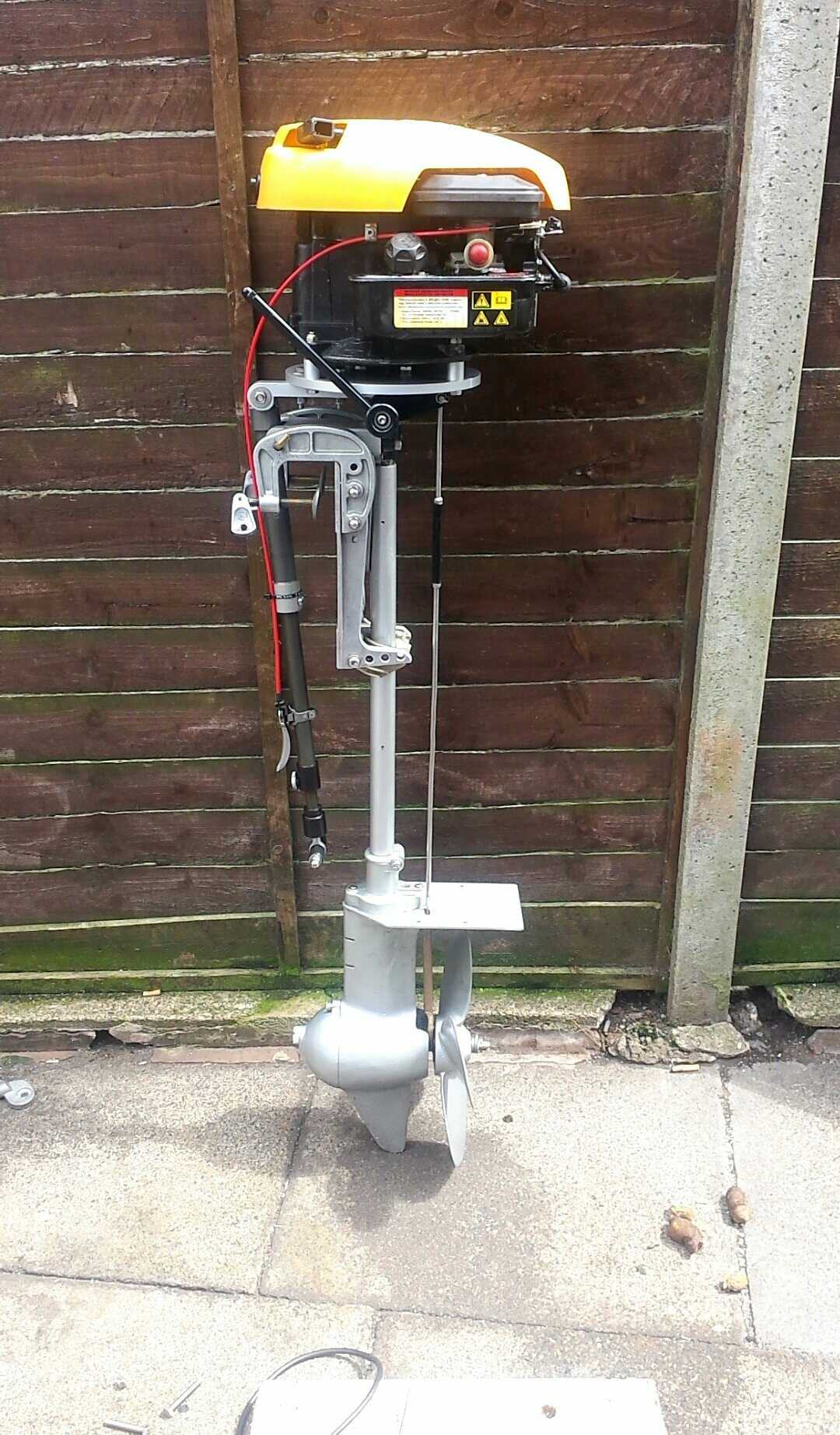

Cheers for the welcome. Nice to be among like minded folks. Just a little creation as was bored. Have a good number of seagulls( featherweights up to 102s) but its not often you have a spare gearbox/leg, a lawnmower engine and a man cave. Sorry to offend the purist but I get bored sometimes.......

Hi,
Coming from motorcycle modding world I always think "I wonder if these bits go together?" Being a 4 stroke Briggs and Stratton 4.5hp it has more torque than the Seagull head. Similar max revs as the gull and an absolute breeze to start. Not sure what all the gull bits are off although the box is I believe a late 70s 102. Transom bracket is a gull one I had lying about. Bit of faffing setting the carb to run the full rev range as opposed to being governed to about 1750 rpm. Tiller (a redundant strut from a well known attack helicopter) is extendable so can sit forward in the boat and run better on the water. It runs up lovely in the wheelie bin all the way through the revs. Yet to try on the water but fingers crossed eh? The cavitation plate thingy is so I can bolt a couple of hydrofoil things to as I've wanted to try some for ages to get the boat more on the level.

Collector Inspecter, I wouldn't actually call this a Re-gull but more of a Briggish Seagull. Lol. Best of both worlds, no water works to worry about and it makes one hell of a strimmer....... :lol:
