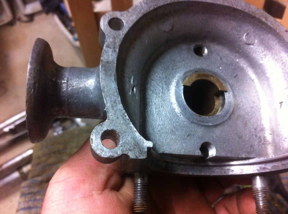

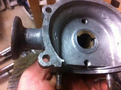

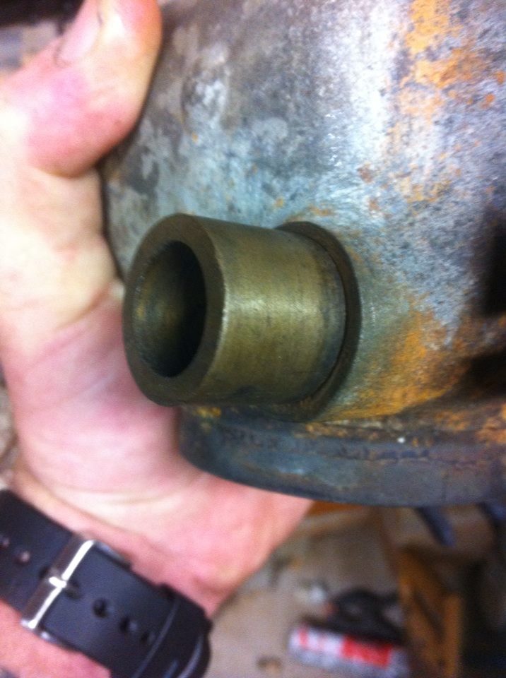

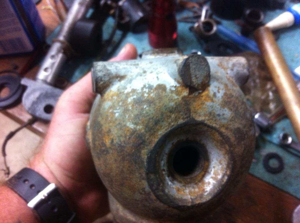

Brass inlet stub - factory or fix? The inlet port looks well cast & well machined at the point where it accepts the stub inside the port, though
Odd stub & incorrect bearings fitted in the crankcase, top & bottom. The SD's going to be a lot more fun to get back to spec..

Incorrect bearings even ...what a purist!

Re: SDP progress & curious SD finds
Yes, definitely pulling those out as soon as I'm able to machine a set to spec.

Impressive brass transom bracket!

If I may ask the obvious here.......
What is incorrect about bearings please?
Original style may have been replaced with other sometime in the Old Dear's Life.
And the serial number is?
Interested is all.
Interested is all.
SD 5366L3 (short shaft, clutch, ministry stamp, no JM# on baseplate)
Odd casting features around the spark plug hole of the cylinder & brass inlet stub aside - yes, bearings have been replaced at some point with newer model ones. Well worn now.

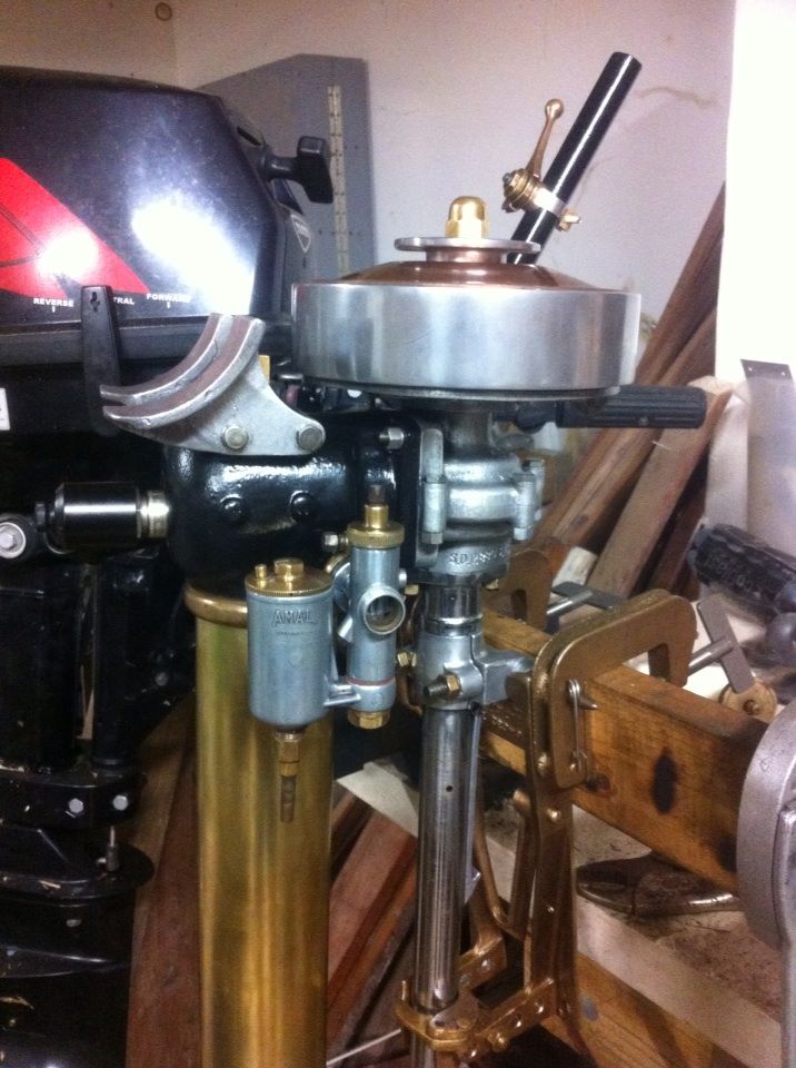

Also SDs have the float bowl to the left, with the copper petrol pipe bent in 3D close to the exhaust. SDP has the bowl to the right with a straight plated fuel tube.
SDP is looking nice, I've never seen one with coolie hat and copper lid. What's the number?

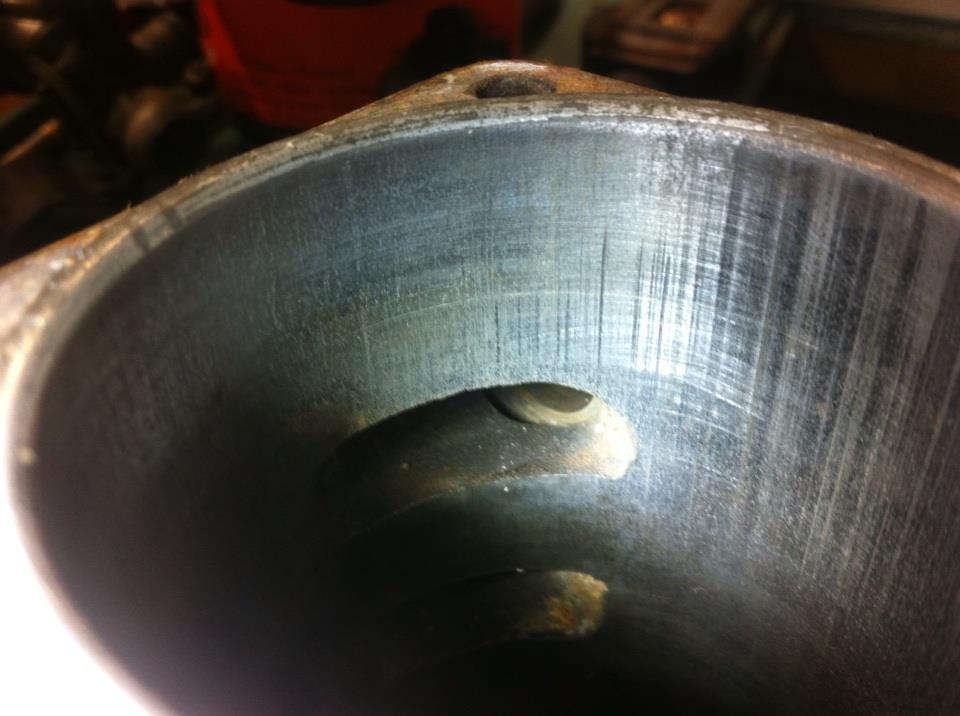

The cylinders were cast and some sort of zinc dip applied, you can see the remains on your cylinder. The drive shaft tube were the same on SDs too, the finish is a bit like galvanised sheet.
Oyster,
Thanks, yes - "Many SDs seem to have been cut down to the same length as later post war standard shaft 102s" - that's why I called it a 'short shaft'. But I take your point - I'll keep to proper terminology to avoid confusion.
SDP 8806LX
Flywheel # - JM 121697 (like the SD, no baseplate 'JM#' stamp - likely replaced at some point as there's no inner clamping ring either)
Both came quite incomplete (1 seized). The SDP did come with an ali hat but I haven't cleaned it up yet. Also much prefer the look of the copper, so may keep it for show. 1 I'd like to keep as close to original as I'm able and the other I'm looking to 'tune'. Haven't quite decided which yet.
Haven't quite decided what to do with the driveshafts yet (the one in the pic is just in place while I worked on cleaning & rebuilding the powerhead) - the one electroplater here unfortunately doesn't do Zinc plating. Although not 'original' I'm thinking chroming might be the best locally available option for long term protection, at least for the one I'm fixing up to use.
Likewise, I tend to replace all steel bolts/nuts/screws that I can with stainless - (made a new stainless strap for the throttle lever, too). And there's quite a few good products out there to help prevent the dissimilar metal issue. Otherwise it's just a constant losing battle with rust & corrosion in our climate.
Thanks for the tip re: float bowl locations & the vid.
I quite agree with shaft lengths.
Standard or long was all there was, unless some well meaning previous owner has had the angle grinder out at some point in it's life. (i do see the ODD 1 or 2 every now and then, not just with the "wartime" motors, but the later long waterjacket 102's too) Odd how some of these get "modified" over the years.
Slightly off topic here, i'm currently re-doing my own SDP and the mention of fuel lines came up. I've made up a copper fuel line bent to shape to closely resemble a later plated variant, float bowl on the right, but still in keeping with it's SD brethren it's polished. (i like it any way). We'll see how it goes later this year on the "canal run".

I have a nickel fuel tube half made at home if you want it Jon, to suit the right hand float bowl. it's nickel or similar so looks right...

Oyster where did you see the info that the SDP had a different fuel pipe & float bowl location, as CharlesP's & my researches never found any evidence for that being the case, & when used on a wartime bracket would restrict it's steering ability
I think Naughty's point was that his cylinder had that strange cast in circular boss just above the spark plug, hot dip galvanising like Naughty's was evident in about 50% of SD cylinders & might be a quick way of stress relieving the casting prior to machining rather than leaving outside to weather for 6 months, though his shows signs of it in the finished bore.
Perhaps Jon's database should contain the zinc coated question data.
I would agree with your shaft length comments with regard the SD & SDP's but the HSD because of it's longer lower unit giving a larger distance between the bracket & the prop shaft.
