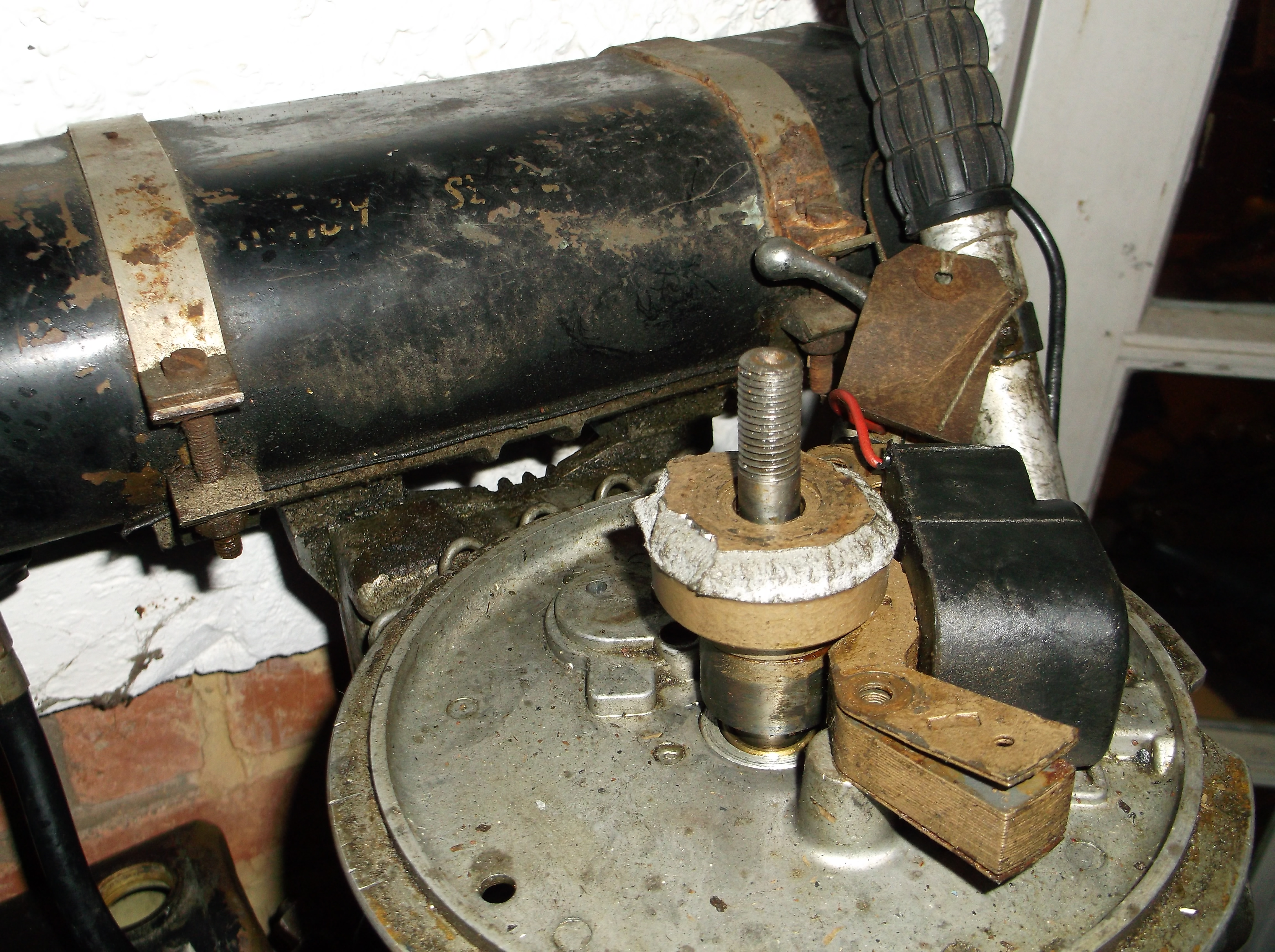

Hi has anyone found a engine that the previous owner had inserted a larger than required woodruf key ,and now the time has come to remove the ,flywheel (wipac flywheel)
I have tried heat ,penetrating oil ,a good heavy blow to the crank ,nothing will budge
A cobolt drill bit extra long ,failed to make any impact on the woodruf key
Any one else had similar problem ,where the incorrect oversize woodruf key has been used and ,now when you need to remove the flywheel you encounter this situation

Perhaps I should explain why Seagull's recommended flywheel removal method works so well, but first some history.
Seagull's first flywheel, the coolie hat one that was used from late 1931 to circa 1946 was cast using a malleable aluminium alloy not really suitable for Seagull's hold & hammer method, this might be why is has an internal thread provision so an extraction tool can be used. I've seen several that have been badly distorted by the "hold & hammer".
The Villiers mk 1 flywheel was cast from a harder aluminium alloy (believed to contain zinc) so wasn't prone to distortion & hammers off very well.
All the Wipac flywheels contain a high percentage of zinc, so are harder but more brittle & can be wrecked by not having a friend to hold, (Above is a motor I picked up before xmas for John which illustrates this perfectly ).
The Seagull removal method, having a friend support the motor by the flywheel, means that the initial impact from the hammer on the end of the crankshaft tends to drive the crank from the flywheel taper, failing that, the friends arms then give, allowing the motor to move & not forcing the flywheel to absorb the full force of the hammer blow.
