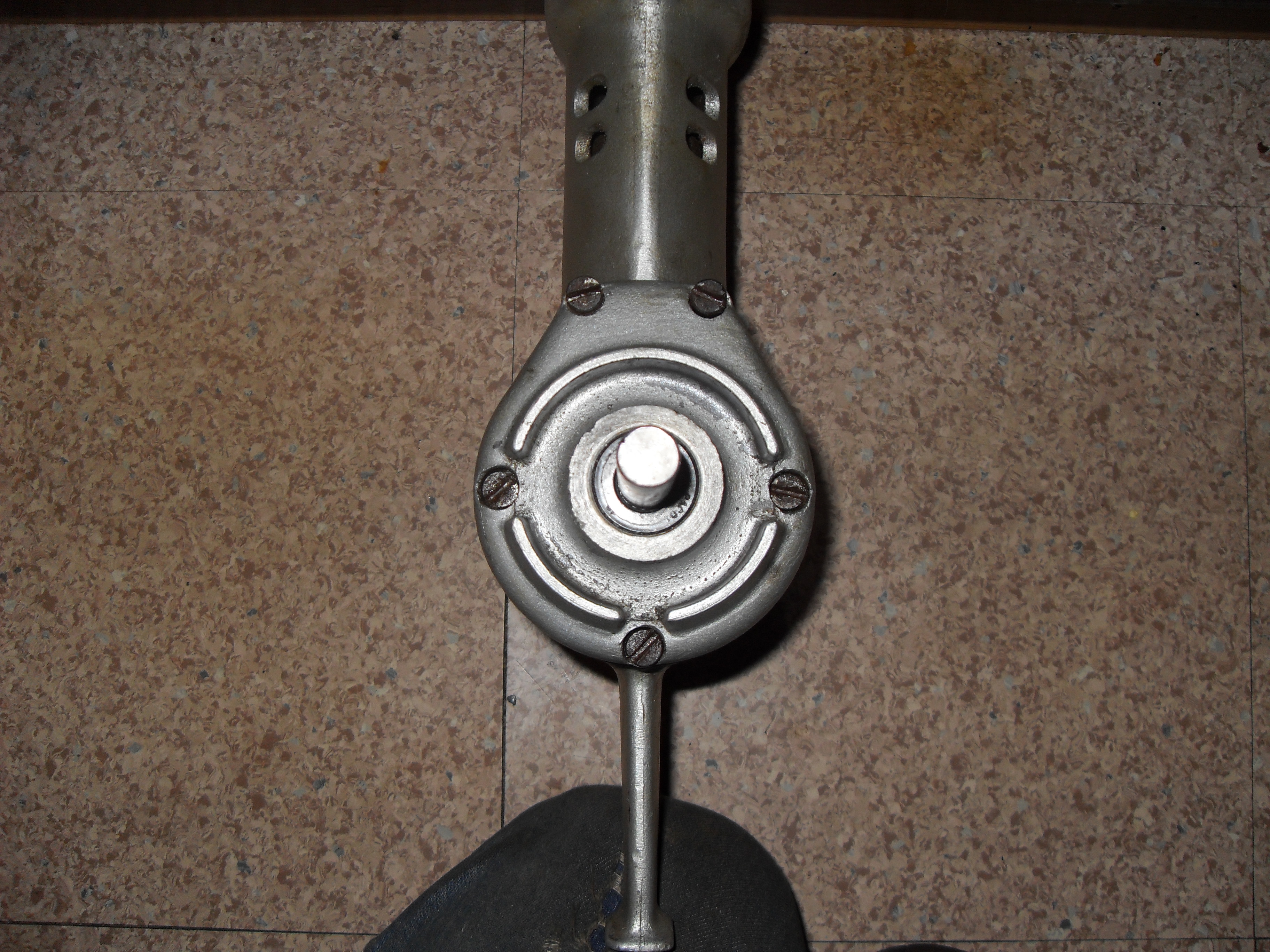

this cover needs to come off

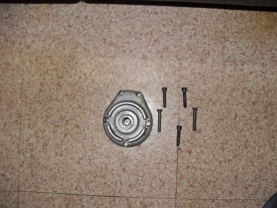

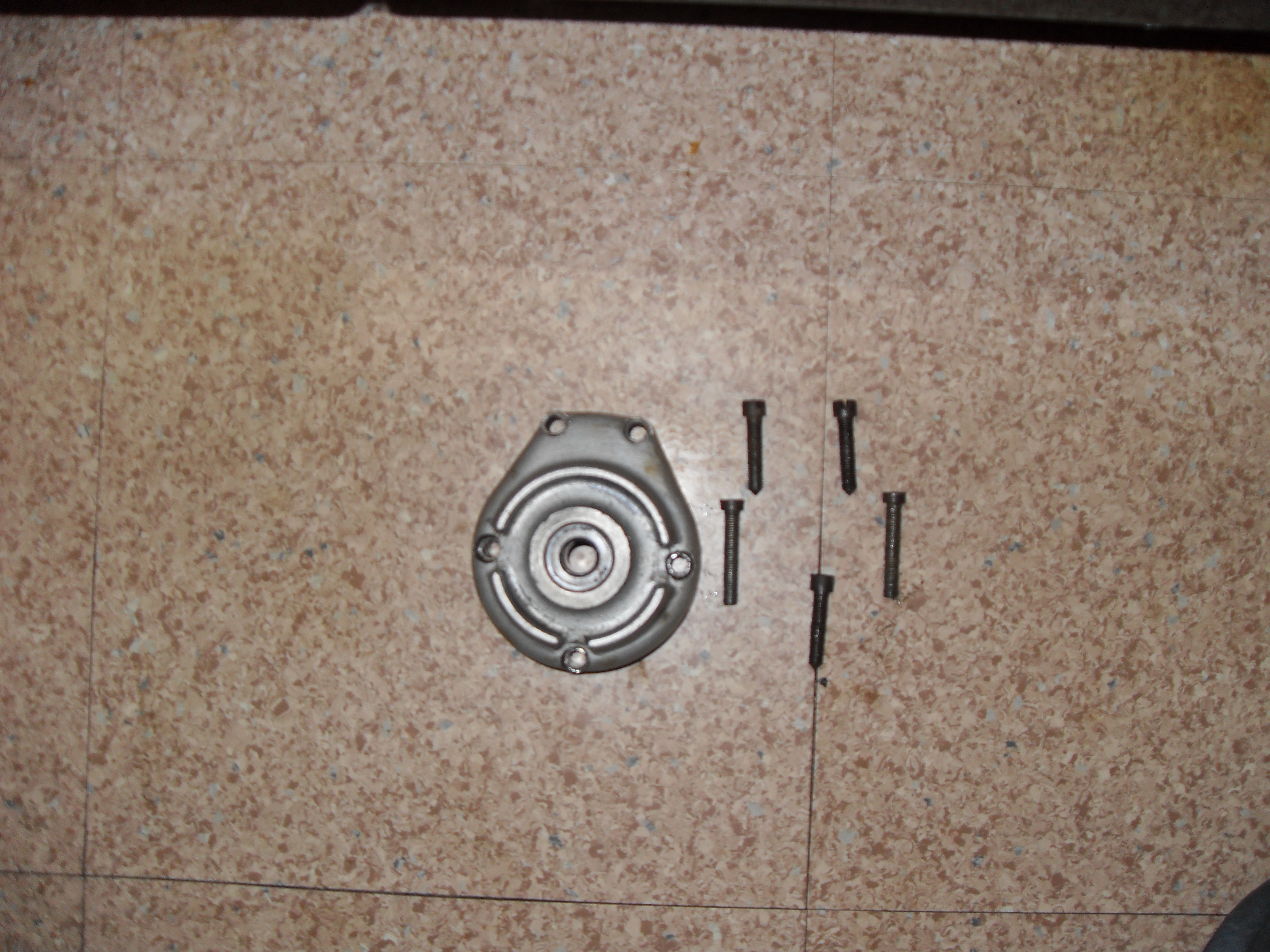

dont loose the screws and make sure they go back where they came from, they're not all the same size

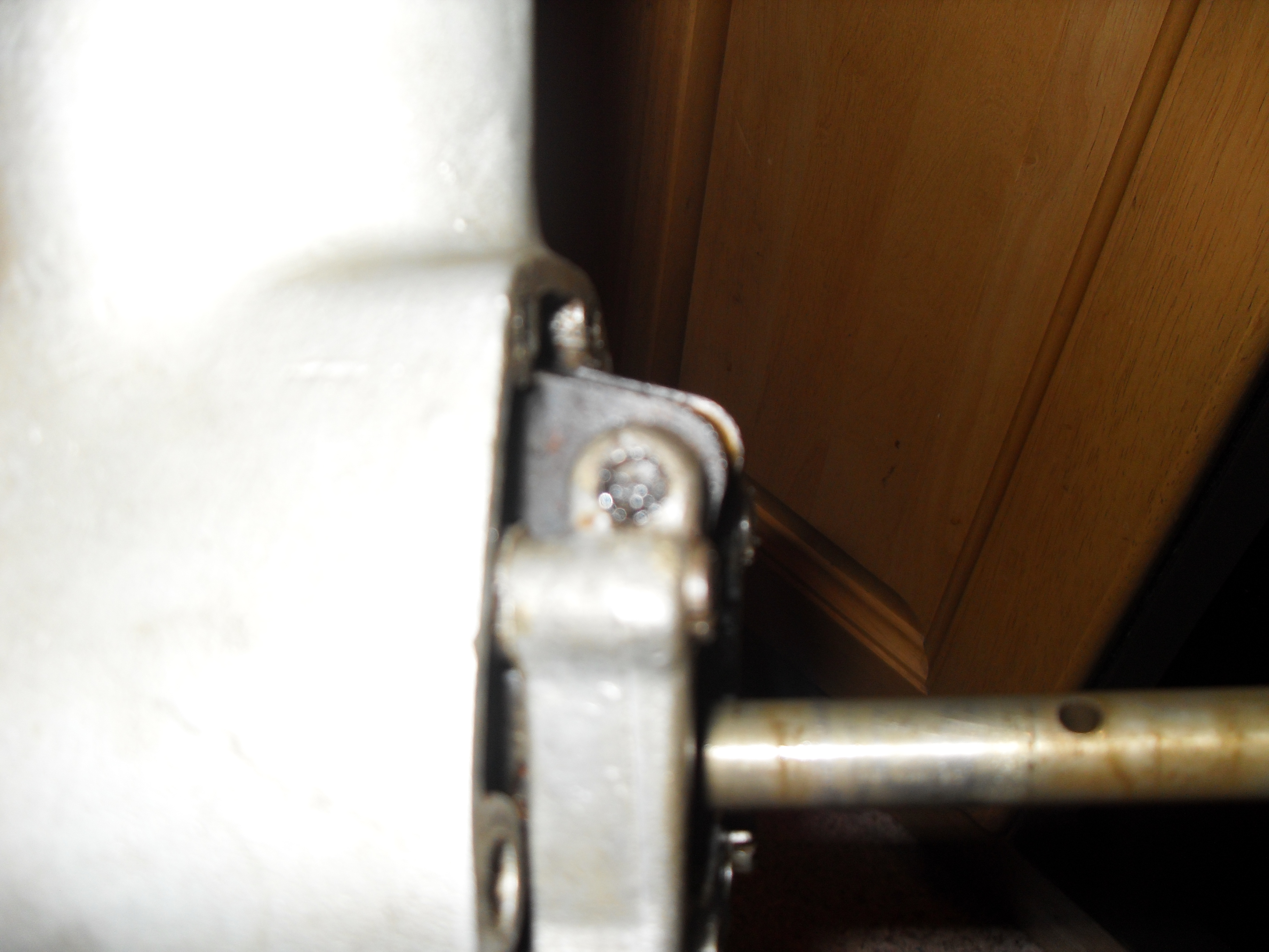

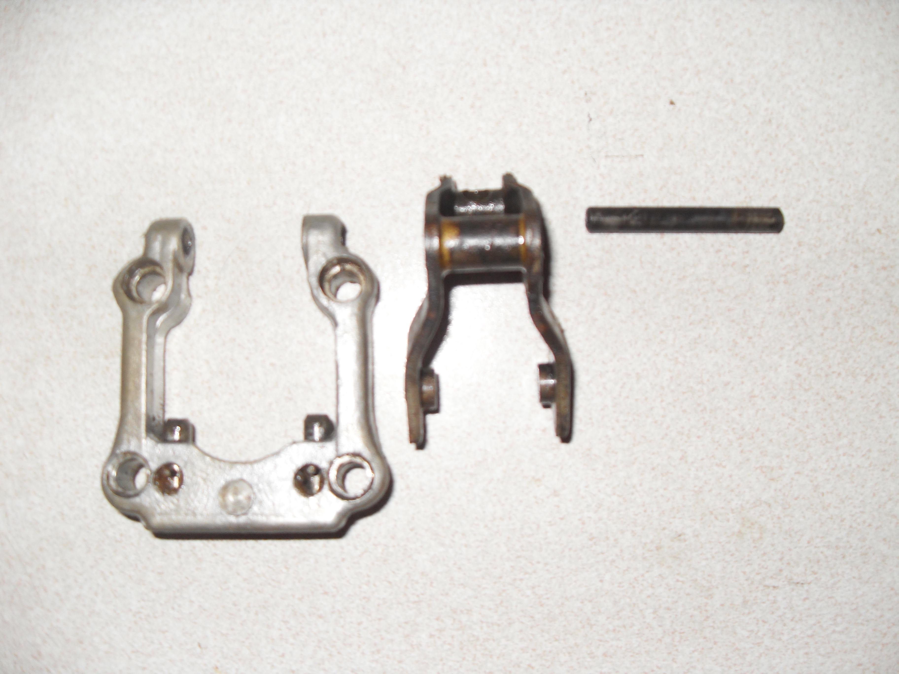

there's a roll pin at the top which must be removed first before the pivot then the bracket
at the bottom of the U shaped bracket are 2 plungers. I bet your's are stiff/stuck?

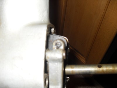

Thanks for that. You are right, one of the plungers was stuck. A bit of gentle persuasion a some wd40 has freed it. Any chance of photos of the fronr end of the shaft ? :roll:
Re: Century 90
Let's have a look...
Anything else you need :P

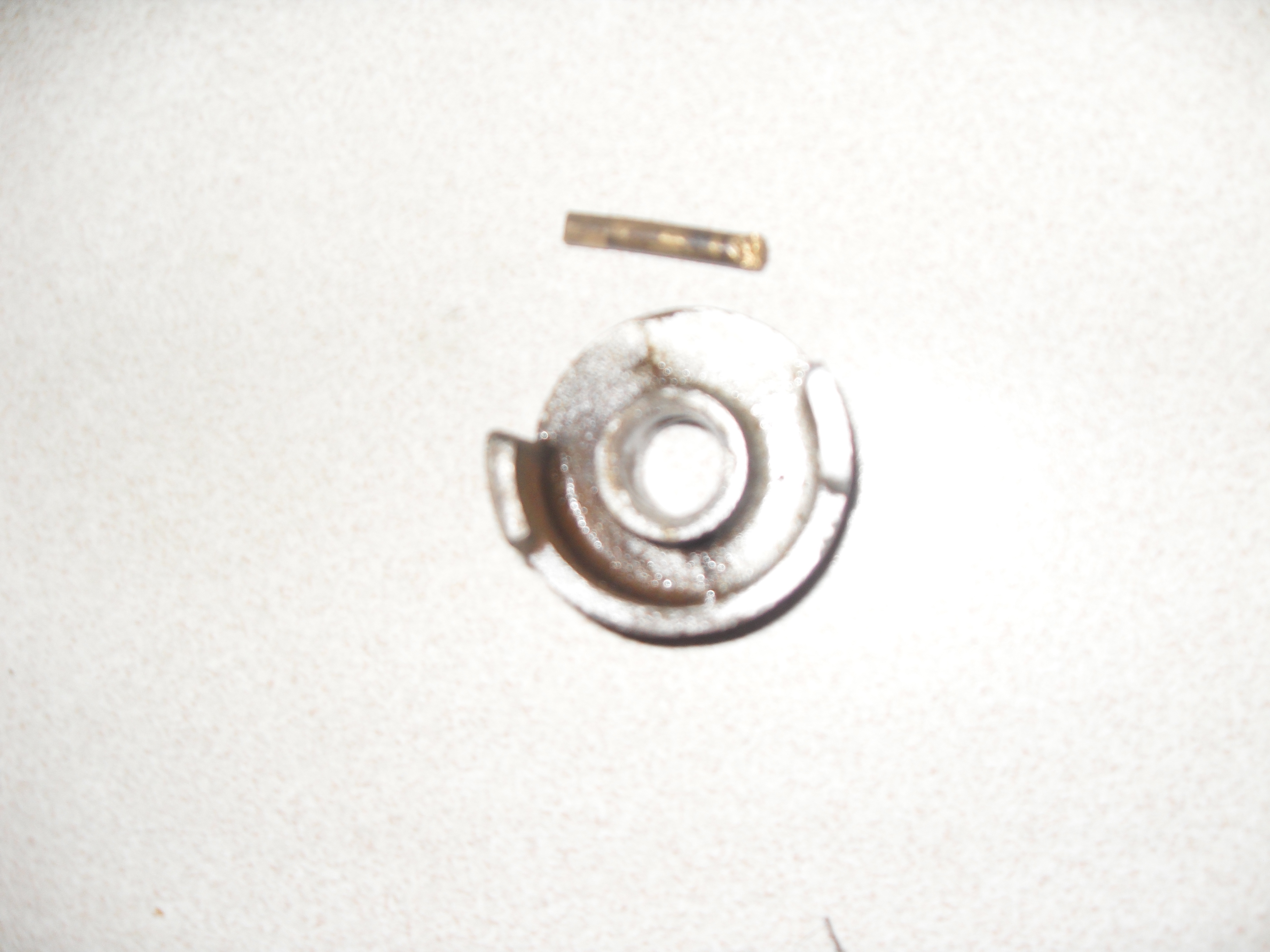

this gets re-fitted after the cover. the drive spring locates into this.

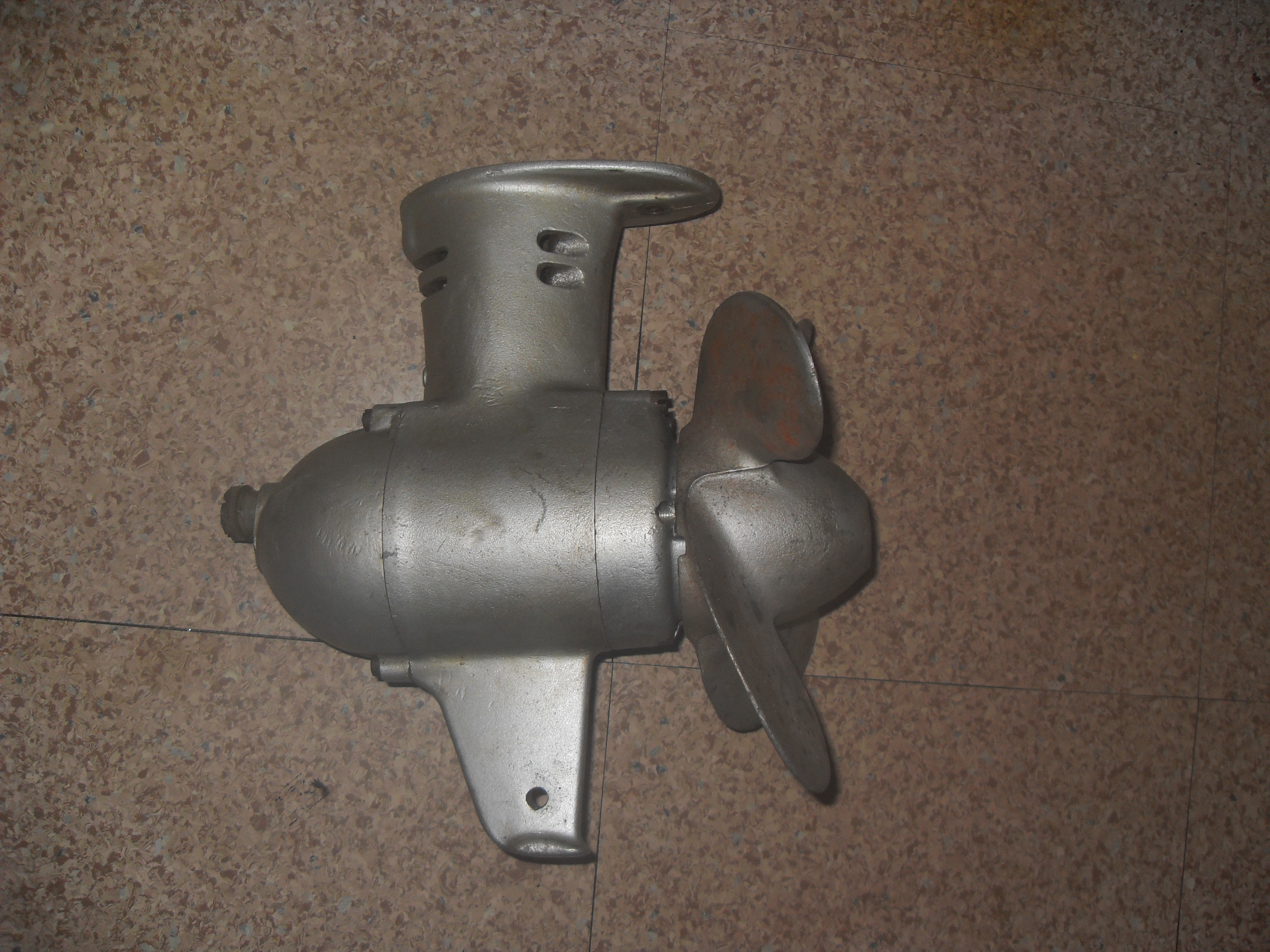

prop and retaining collar fitted. the drive spring gets held into the back of the prop by 2 lugs cast in the back of the prop.
