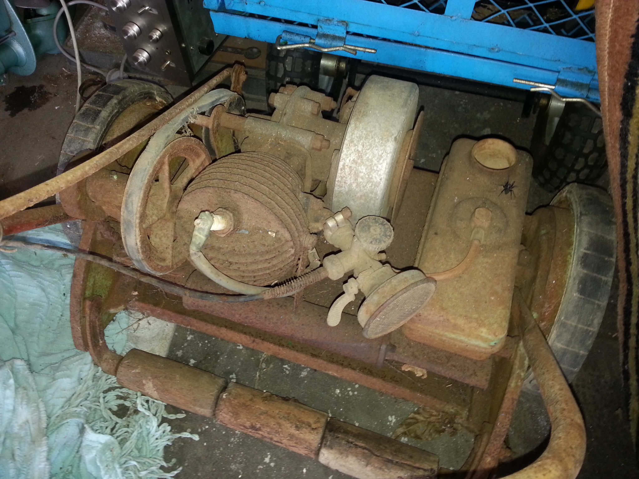

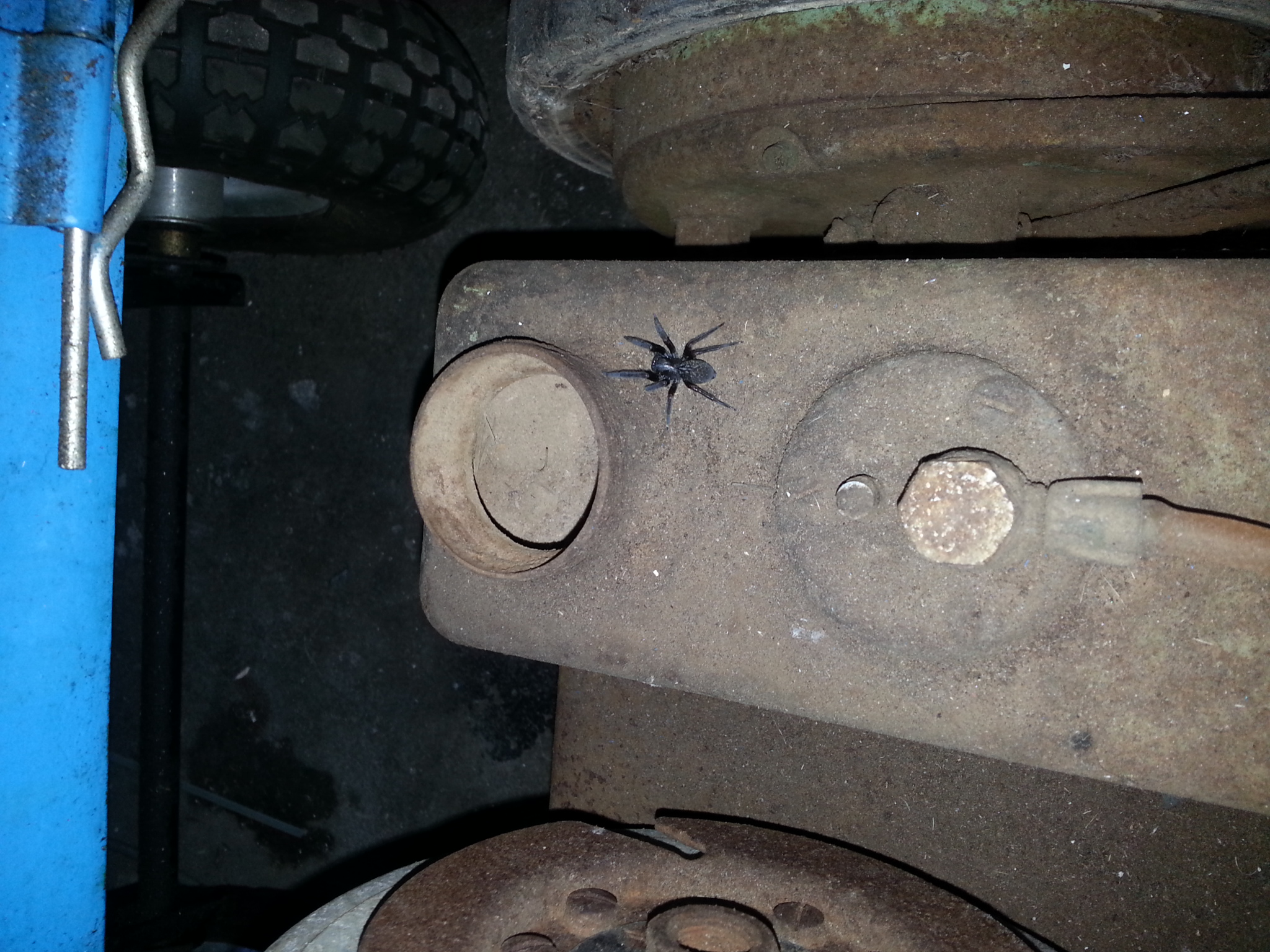

Hi all, yep need a fuel cap.
I have no need of any more spiders..........funny but I did not see it until checking pics....sneaky blighters aye.
Late 50s Mower I think...

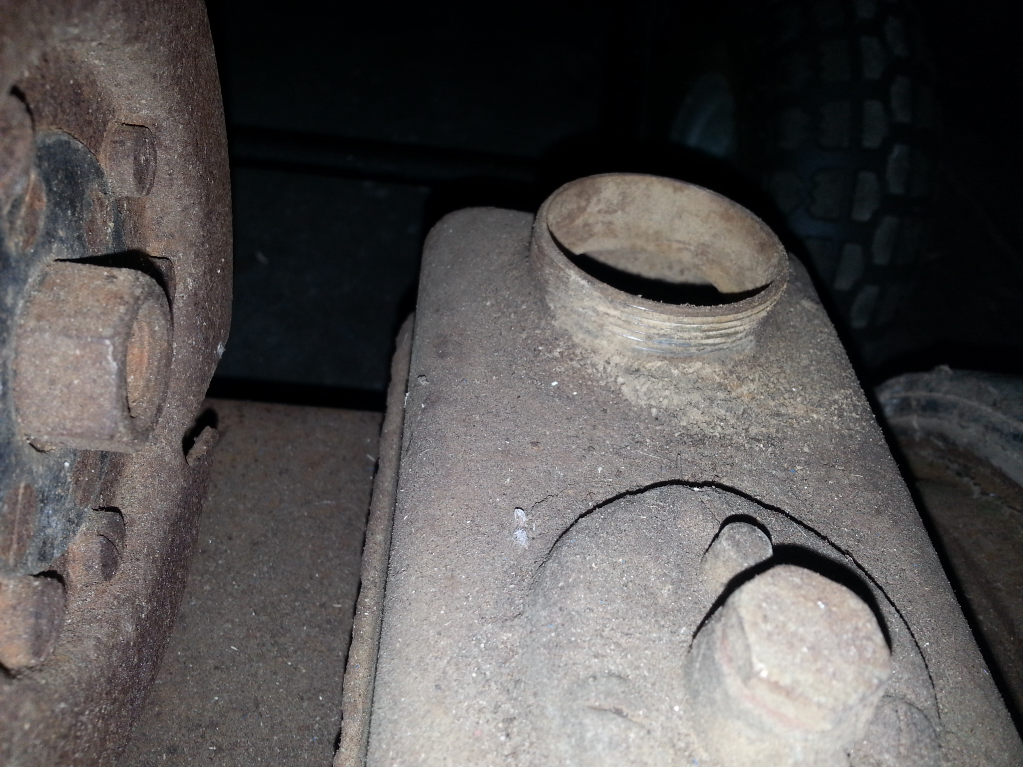

Any idea on the thread?
If you cant find one.... I could cast one for you.
Re: QualCast Mower Fuel Cap
Not a thread, Q50 Bayonet fitting for SD's.
Looks like a screw thread to me Chas.???
not bayonet fitting
have you tried some of the motorcycle caps B?
not bayonet fitting

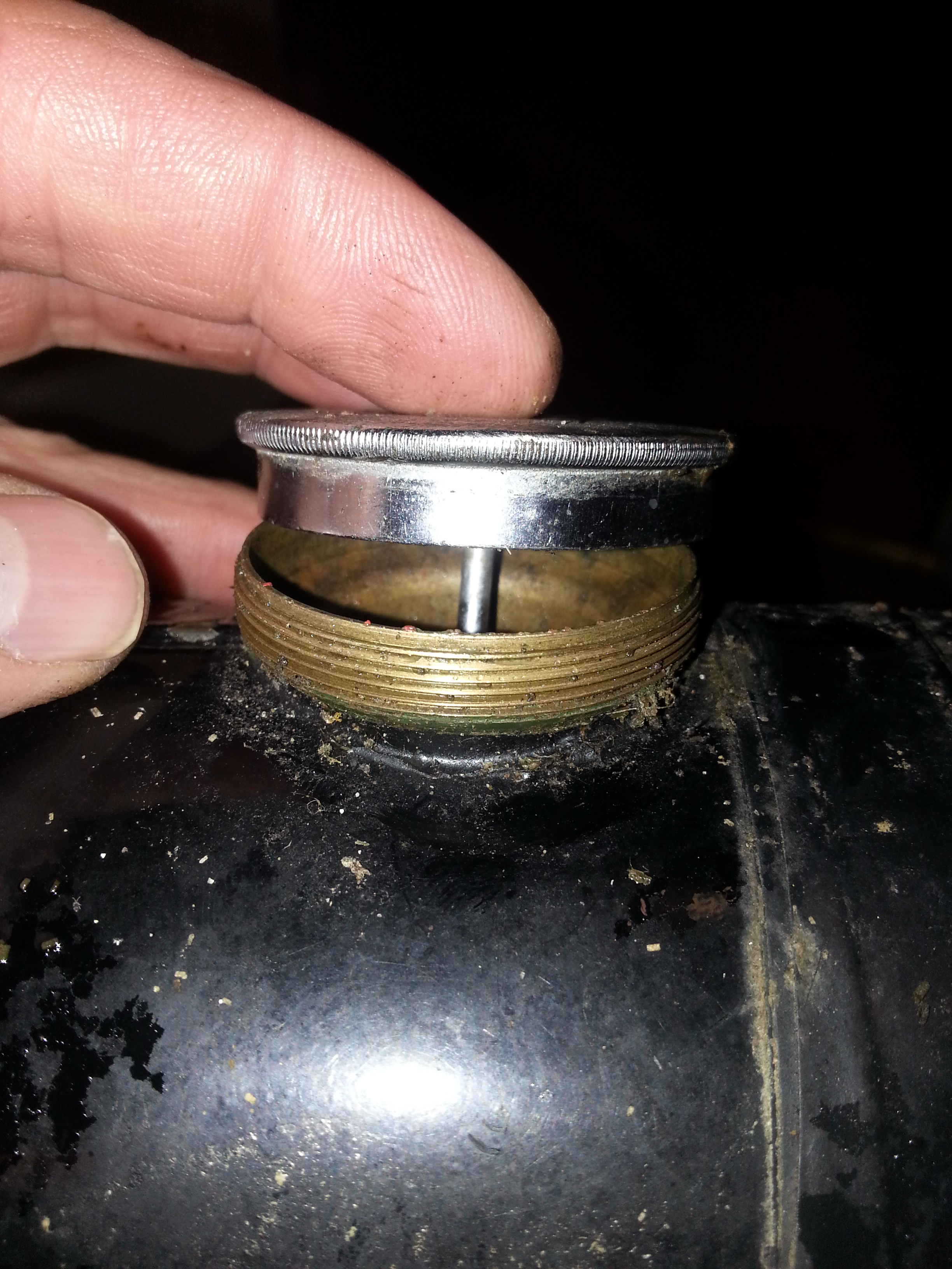

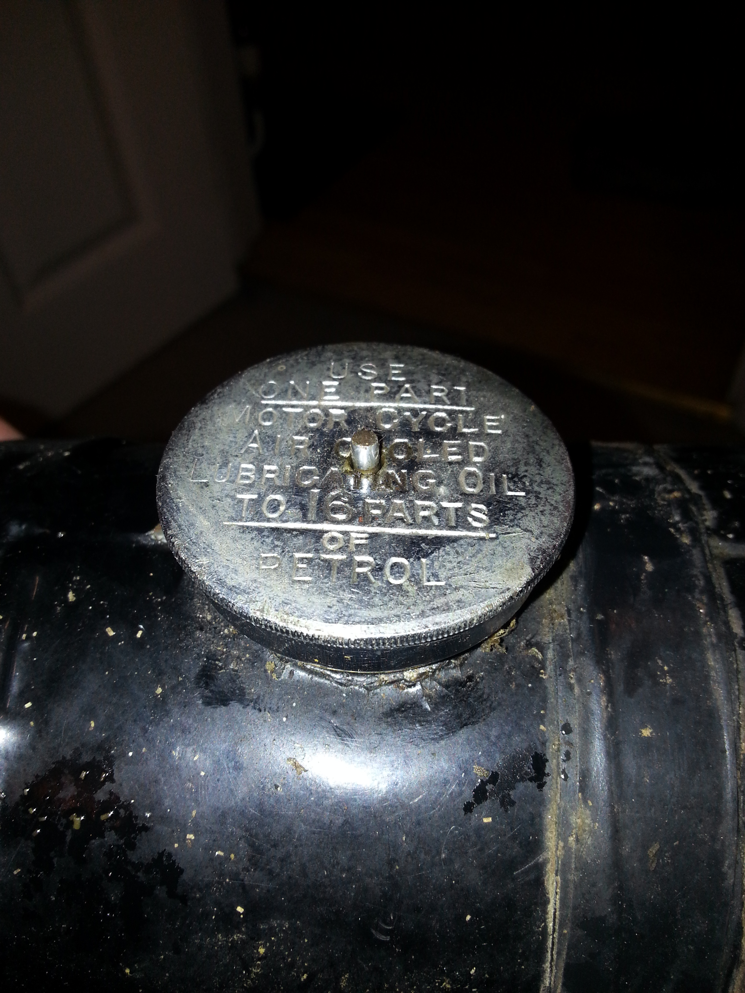

Tank thread external diameter 1.59", thread 26 tpiHorsley-Anarak wrote:I have one Bruce, will measure it tomorrow.
H A
Could be Atco, P.M. me Bruce if it is of any use, free just pay postage.
Thanks Guys.
I just measured it.
1.86" x 18tpi
I just measured it.
1.86" x 18tpi
Do you know if it is a 55deg thread or 60deg?
Keep looking for a bit. If you cant find one I will make it for you.
