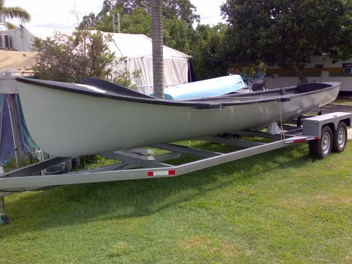

DKG LATE MODEL SURF BOAT 8M
Any thoughts from anyone, would you build a motor well, or mount it on the stern.
You would need a 12 foot tiller extension, and the trailer would be a pain.

There are a lot of Seagull racers that would love that & who would put out a contract on you if you cut a "motor well" in it!
What does it weigh? approx.

Its a stripped out hull, so it would weigh about 180kg.

Re the surf boat do you have any measurement other than the overall length? I have seen them competing off Sydney on the TV and wonder how stable they are, in the competitions they seem to spend more time capsized than the right way up! At 8 meter (26ft) it would give a hull speed of close to 8knots but stability? what is their beam, draft and freeboard, Can you post some more pictures please if you have any.
I guess you know where I am going with this!

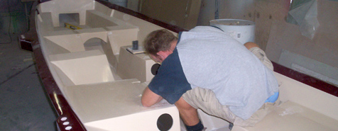

These are excellent boat for what they are designed to do, but nothing else.
They are of vacuum bag foam and glass construction, and made in two parts, the hull and the deck.
So if you were to seagullise one, though it would never sink, it would require a new glass deck to be built and bonded to the hull.
The deck has four raised seat towers for the strokes that take up most of the boat.
The well you can see at the top of the picture is were the seep stands.

I am of the opinion that this type of hull is generally of single purpose.
Not something to be "At Sea" in.
Watch a surf carnival one day. They Twist and rebound alarmingly.
500m off shore aye...nothing more as to your thoughts.
Just Saying is all.
Re: An intresting boat for a seagull?
Interesting you say that Bruce I've been having a conversation with a few Bermudians over the last couple of years about building a hull based on these for the RISR (Round the Island Seagull Race), no rocker, lightish when without the internal skin & designed for big water.
The cost of the mould & the bow buoyancy was the slow down factor, an 80lb hull with a 50lb propulsion unit 5hp 5R, 30lbs of fuel 300lbs of crew sitting on the floor & a centre of gravity on or below the waterline, sounds a lot better better than a 180lb hull with 800lb propulsion unit producing just about 2 hp & a centre of gravity 250mm or more above the waterline.
As for the Bass Straight I think it might be a lot more comfortable than a half ton estuary clinker & quite a bit quicker, but just as wet.
As for the carnival performance it's their job to make them look sexy! it's the dare devils that pull the ladies.
Has anyone tried one with a less than 5hp motor?
