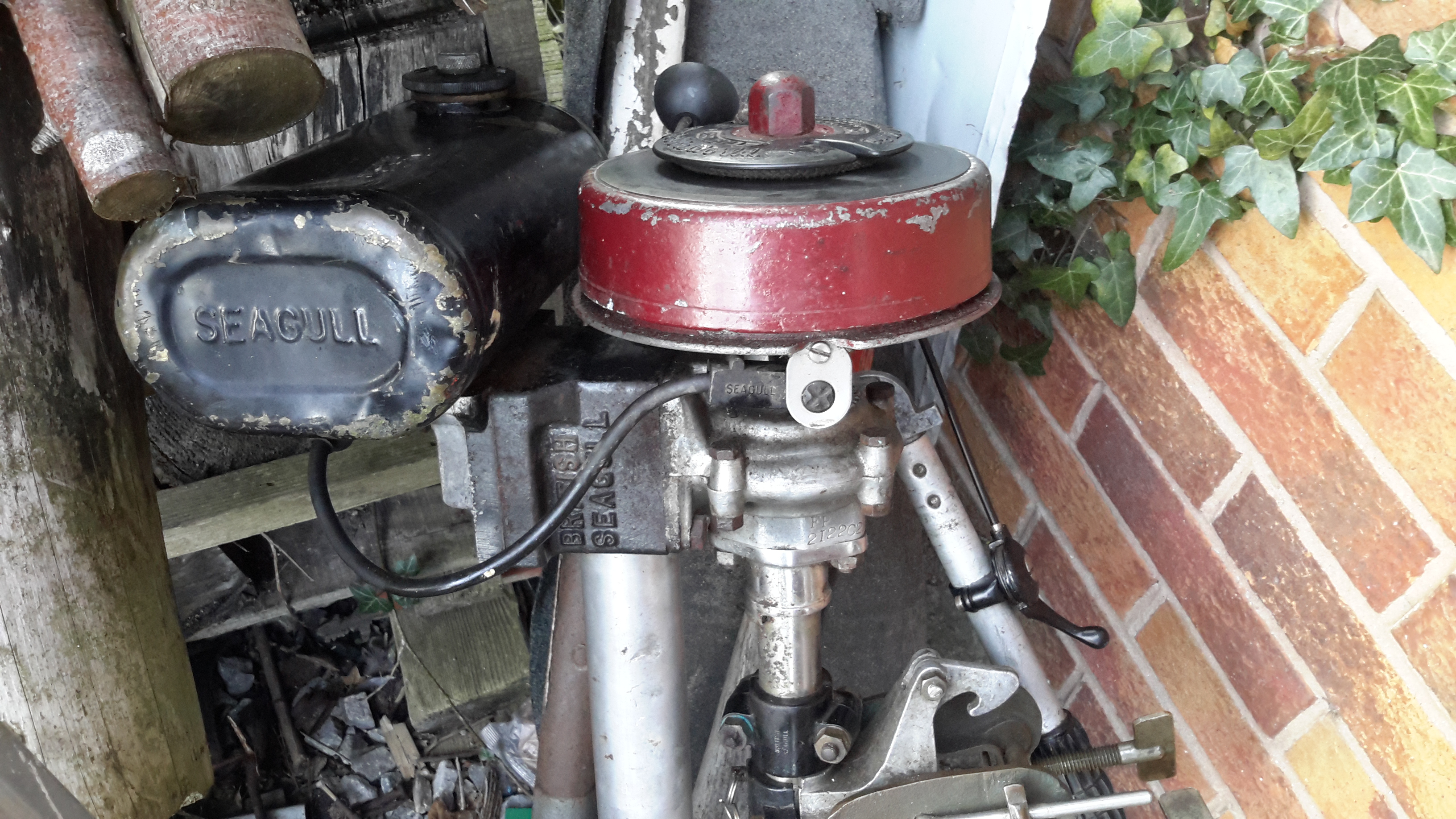

Just purchased a small Seagull which appears to be in reasonable condition....see attachment

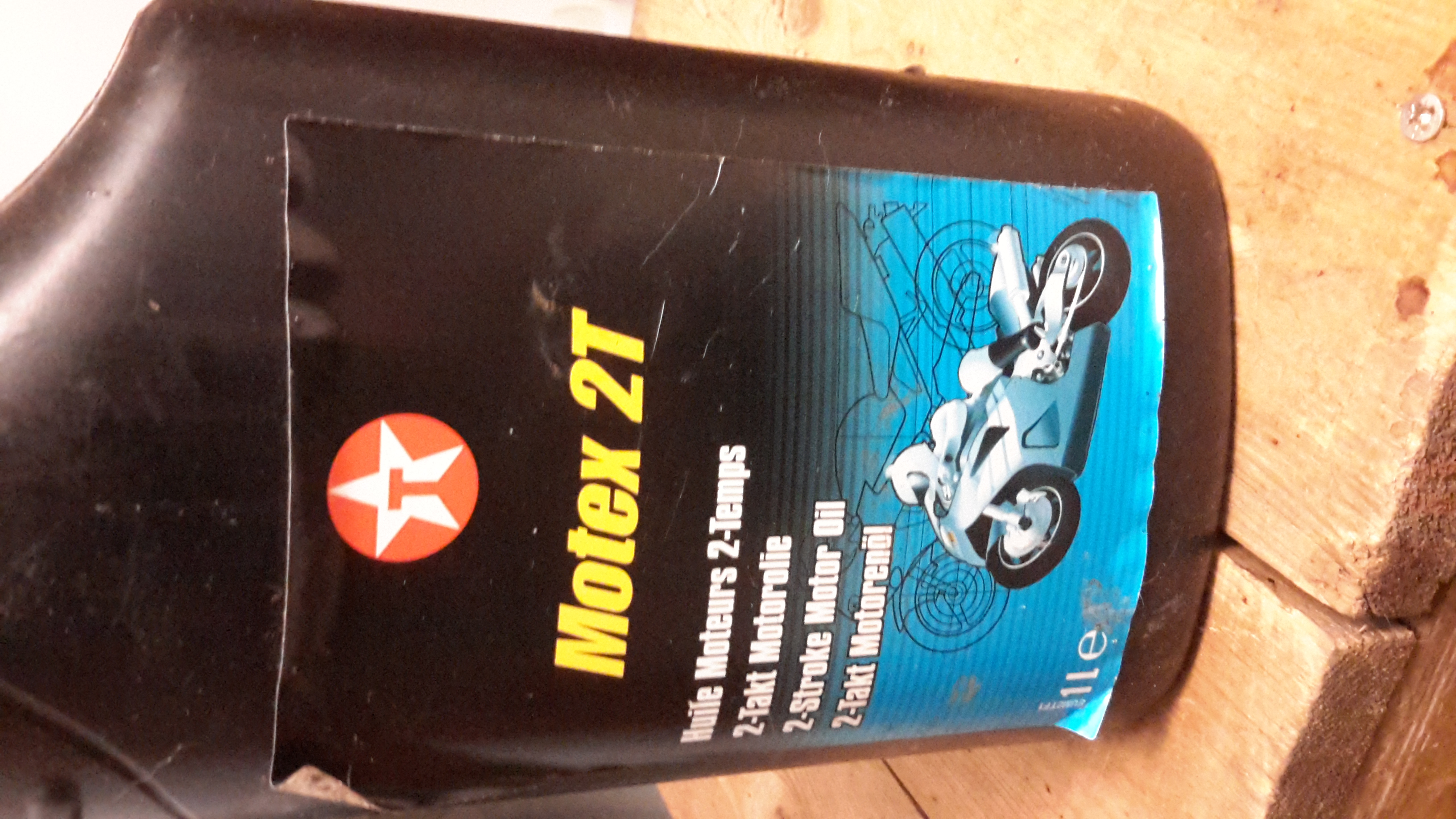

Cleaned the carb and tank and using a drop of 2 stroke the engine does run and appear to pump water. Going to check gearbox oil and then hope to put it on the 8 ft boat and go for a run. According to the the serial number the engine was built around 1972 and appears to be fitted with a bing carb. Just wondering if someone can put me straight on the 2 stroke fuel as i don't want to ruin the engine, i have read that you can use 10.40 engine oil with a mix of around 15.1 is this correct. I do have some commer Mineral oil which states it is dual temperature, would this be suitable AT 25.1? Just found a bottle of Motex pictured, suitable?
Engine serial number....FP2122C2
Any advice appreciated.

Still 10:1 until about 78, try and keep it at about 10:1, unless you convert it to 25:1

if it has the bing carb you can run it on 25/1

I ran a check on the engine number.........year came up but no details other.
I would run 10:1 as Bings will do nicely until trying 25:1 that Bings do nicely as well for the short term.
Main crank bearings is the thing.
You say appears to be a bing carb........is that just from research or is it what the motor has clagged on the side now.
10:1 until someone can confirm other than my recent search.
Not that oil!

Thanks for your replies, i'll take a look around and see if i can pick up some tcw3 2 stroke oil, canal is at bottom of garden so thought while weather was still holding might be nice for a run, but will wait until i pick up correct oil. I'll post a picture of the carb, from the breakdown does look like a bing.

Why not that oil Bruce, what's wrong with it?
Re: Just Purchased A Seagull, Loooking for Advice.
Not my cup of tea for Old Dears is all Charles.
I encourage better via my input most times regardless.
Most times a poster gets something better after is all.

Your Motex 2T fits all your Seagulls requirements, mix the first tank full at 15 : 1 as it's not been run for a while, then 20 : 1 as you don't know if it's had an easy or hard life.

Motex is TCW 3 look it up.

NO Charles!
The Oil as above is incorrect.............
http://www.texacobaltic.eu/en/products/ ... ex-2t.html
Yes they make a marine oil but why be so blunt in a reply so straight up?
Completely different including packaging?
http://www.texacobaltic.eu/en/products/ ... board.html
This is how visitors can do better.
Cheers I think.....

It's TCW 3 & that's what Seagull specs require, if it's only for air cooled motors it will have a little higher viscosity but as Seagull's were designed to use 30 grade motor oil it should be no problem.
Sorry if I offended you with a blunt reply, but you offered no reason why an oil that fitted all the technical specs was not suitable to a newby who just needed a straight forward answer, I would run that stuff in any of my motors from a Marston to an Anzani B racer.
