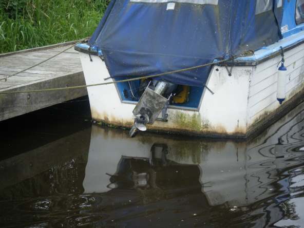

Here's a pic of one I saw in the Union Canal near Ratho. I can only imagine that it was from a design in the Southern Hemisphere.
[attachment=0]DSCF2567a.jpg[/attachment]
