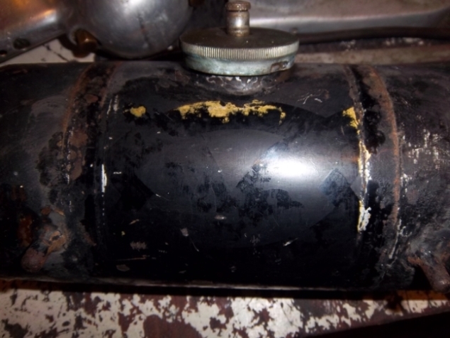

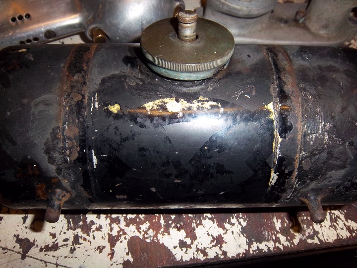

I have been overhauling/repairing an OA and am pleased to report that the power head is now completed and has been bench tested after a complete strip down and rebuild. Gear box is a nightmare but that's another story.
However in a rare sunny day in Tasmania I noticed, in the bright light, that the decals on the tank were still just visible through a top layer of roughly applied matt paint; not only are they visible in the correct light but also appear to be complete.
Now the question: how to remove the pain with out damaging the decals? A small test section, well away for the decals, using paint stripper has revealed that the original black paint remains on what looks like 80% of the tank. But I loath to tackle the section covering the decals.

Re: Restoration
I would use paint stripper on a test area of the tank, perhaps 1 inch square to see if the top layer comes off. Leave it for 30 seconds first to see what happens and wash it off. Keep repeating to learn the effect.
I managed to do this on my ON tank and eventually could see the outline of an old transfer below that looked like it had been wet and dryed. Very rewarding to see "Marston Seagull" appear when held to the light
Patience is the key!

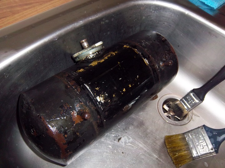

Here are some photos of my ON tank. It had been rubbed down and brush painted at some point in the past. I carefully applied paint stripper for 10 seconds at a time, and after repeating this a few times I was able to take the layer of brush painted paint off, leaving the rubbed down remains behind. I used a brush that had had the hairs cut back to make it more like a stippling brush, this pursueded the softened paint to come away, without damaging what lay below.
As you can see the remains of the decal could then be viewed, and you can just pick out "Marston Seagull" when viewed in the right light.
This worked fine for me, and this tank will be completely refurbished when I get around to it.

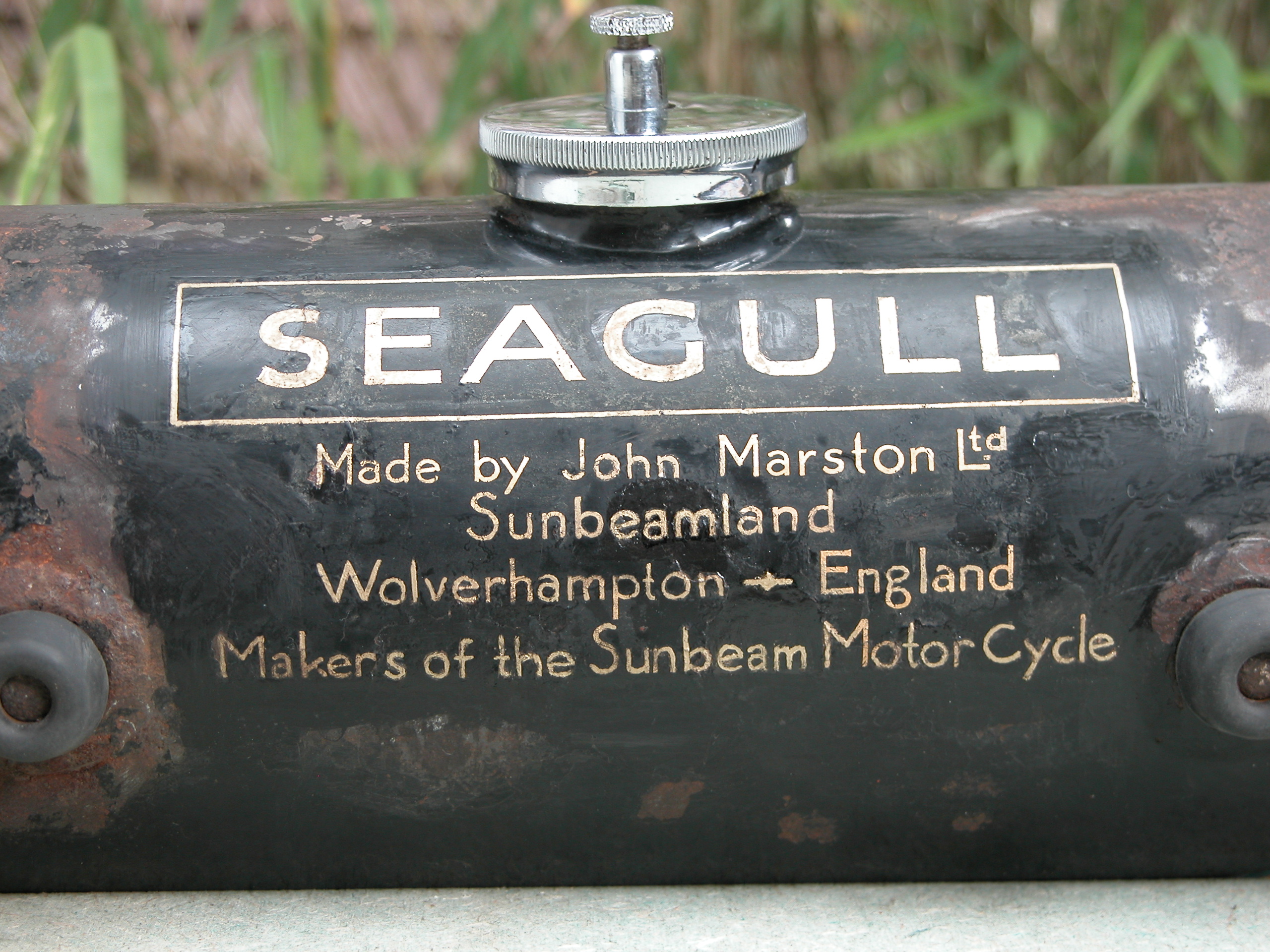

I did not think I was "messing around" with my OA tanks Jon.headdownarseup wrote:H-A might just be the man to talk to.
He's had a bit of experience with "messing around" on old tanks such as these.
To remove the newer paint I would try some strong detergent, such as truck cleaner.
This may soften the paint enough that you will be able to scrape it off with a finger nail.
Use a cotton bud and try is carefully, the decal is very fragile has no backing or coating over it.
The original paint is very tough, but the decal can be rubbed off, that is why so few survived.

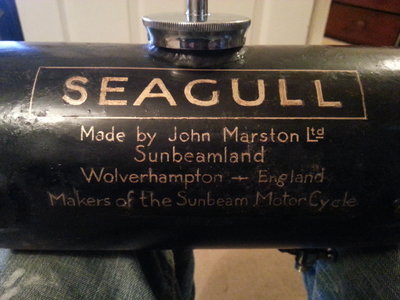

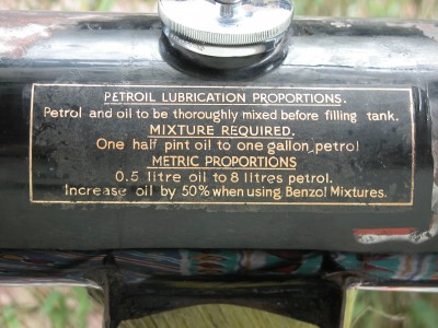

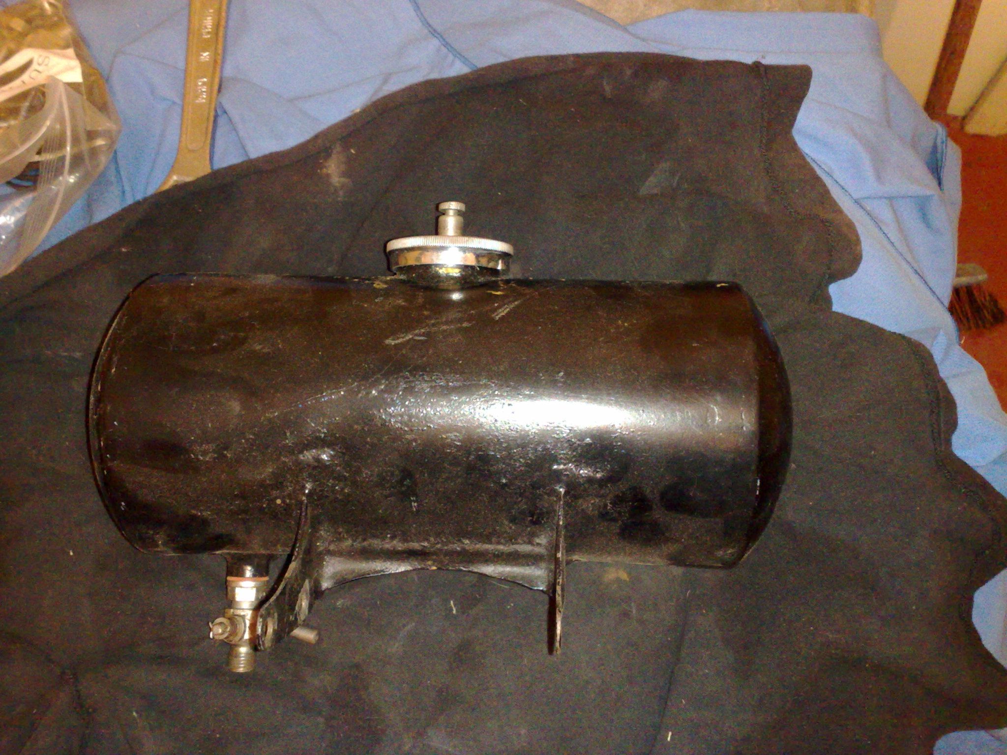

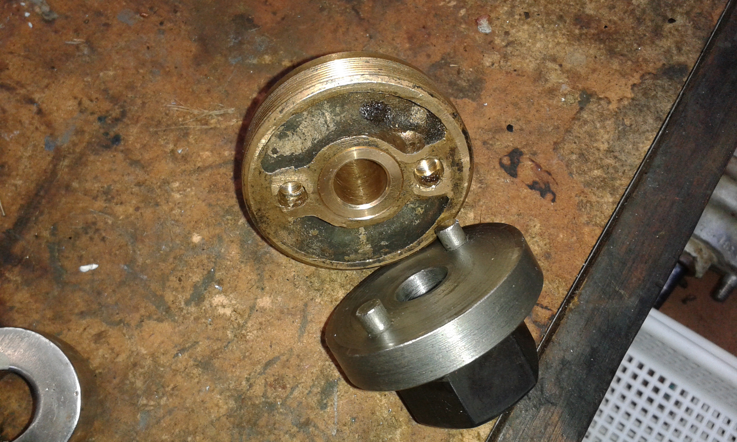

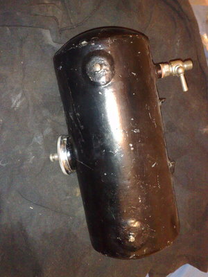

no shortage of advice then. Using paint stripper on a small section well away from the transfer the top coat came off and under it is what appears to be a very hard black enamel that was unaffected. but I will ponder a bit more; Maybe try the hot water first. I have a feeling that as the top coat comes off the transfer will disappear.
Of the two the side with the fuel instructions is completely readable in the correct light just as H-A photo.. really don't want to lose it.

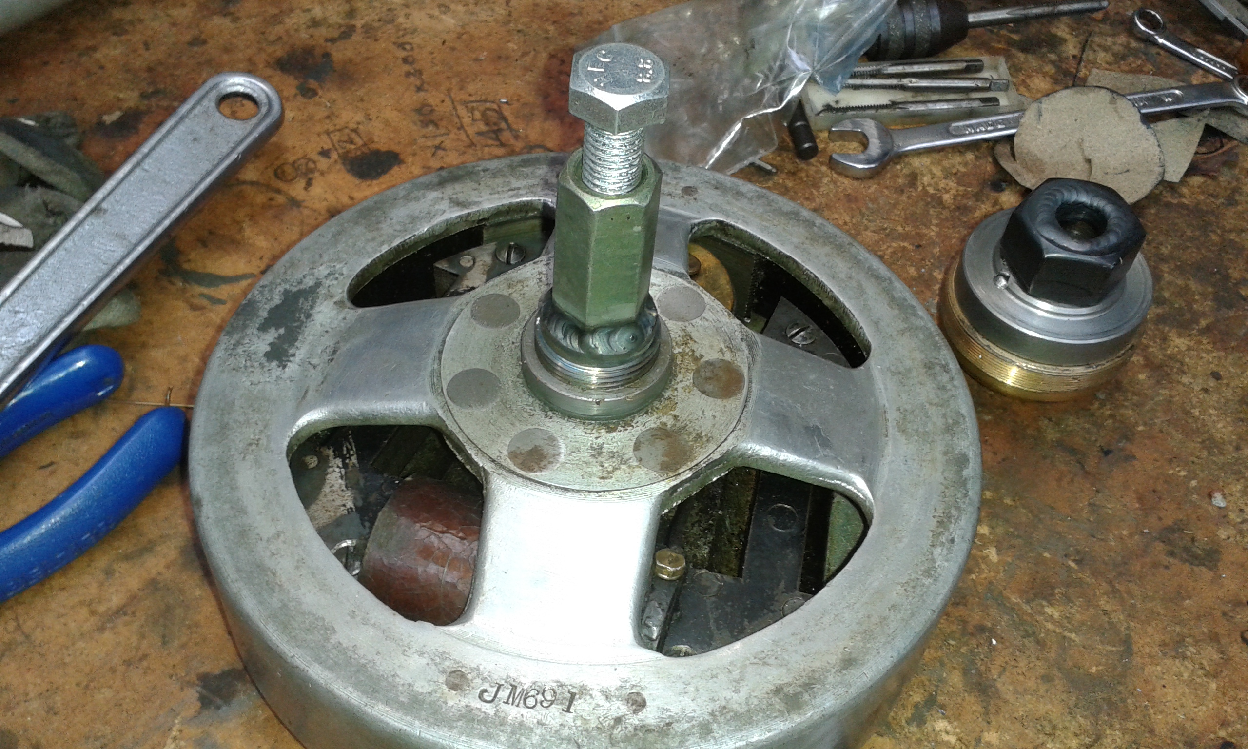

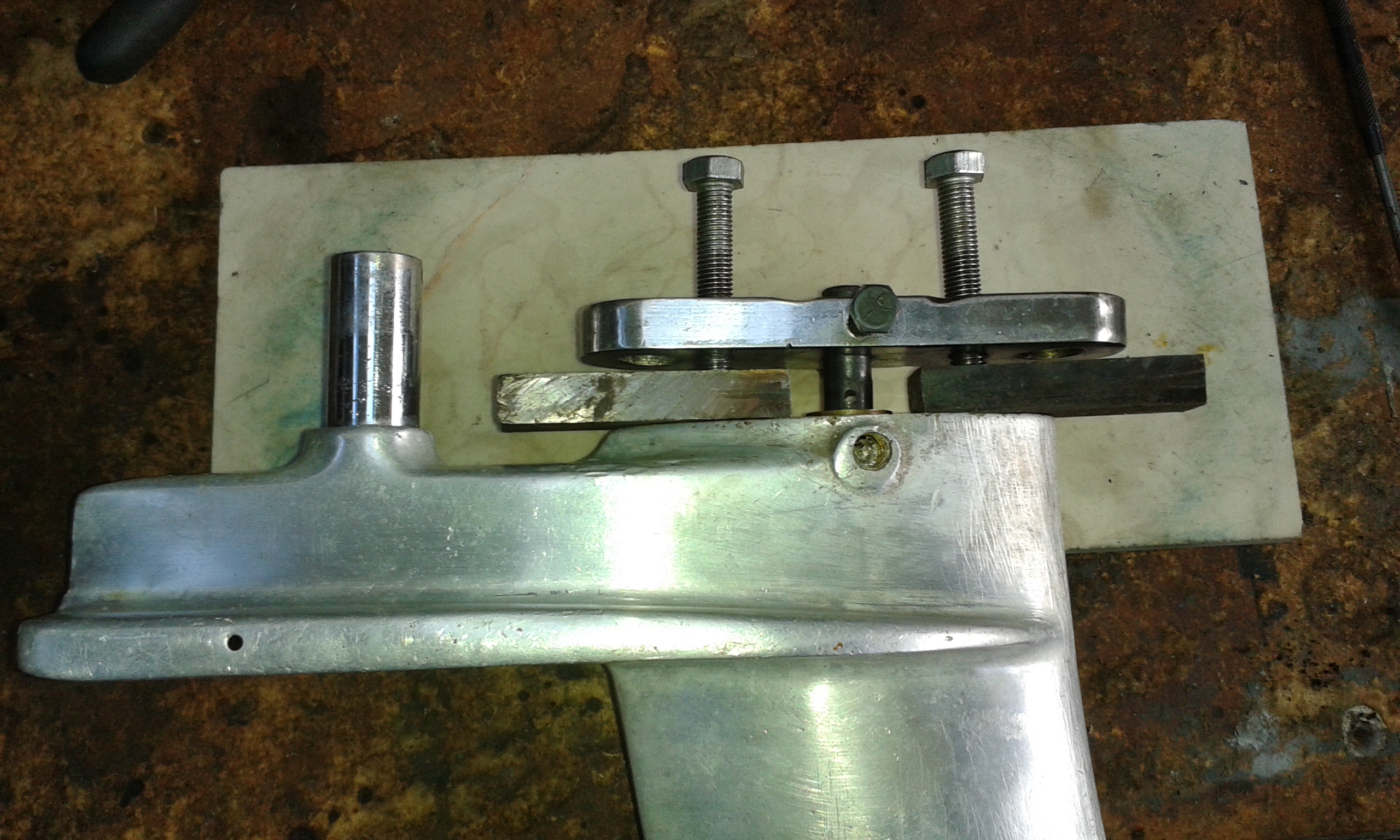

In the mean time the gearbox has been reassembled with new bearings and the bearing carrier re-bushed. The inside of the gearbox casing has been coated with Dovecon which has sealed the pin holes resulting form internal corrosion. The gearbox has been bench tested on a drill press and disassembled for inspection and gear tooth contact.
Attached are photos of the set of tools that I had fabricated at Dynamic Welding, Hobart to disassemble the AO
