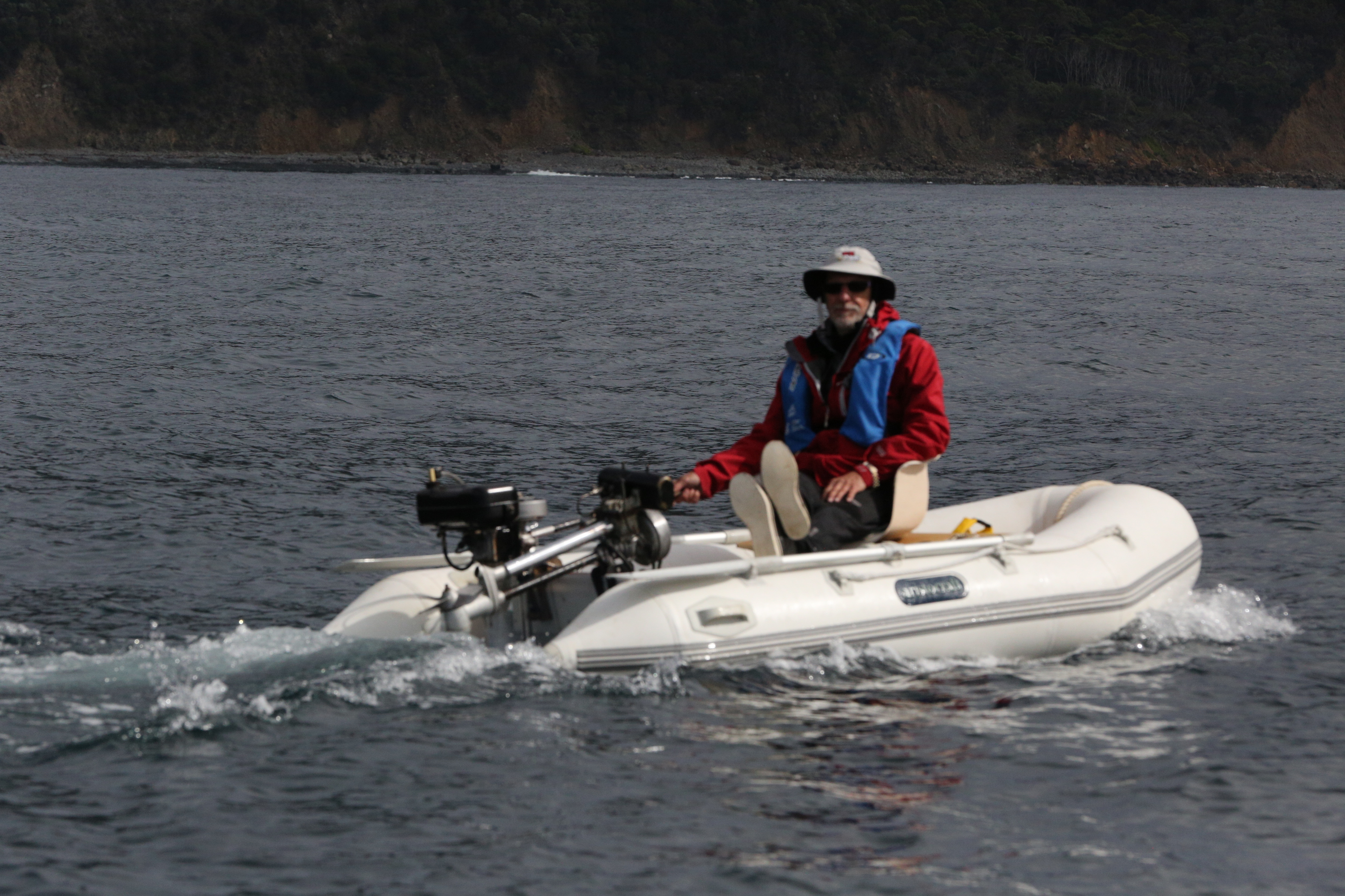

My inflatable is 3.5 and that is a match for a century .
Photo shows it with a century under power with backup LS. achieves about 4 knots +_ same speed for both engines.

Daft question..........with having both outboards on your transom and the engine not being central does the boat try and turn itself round in circles if you let it or doesn't it make that much difference?Adrian Dale wrote:an LS and a century on a 3mt
