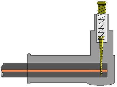

This might help with the HT Lead.
Don't know were the picture came from.
If its yours Sorry or Thanks.

Bear in mind the screw is brass - and the slot is quite lean in depth. Make sure your small screwdriver is really sweet, flat and square - so its gets a good purchase on the srew slot.
The springs are awkward to replicate - so look after them.
Remove the brass ht pip - don't be tempted to extend the spring to put the driver through the coils !( can be done but tends ro distort the spring )
The screw is an odd size that I think is no longer made ( may be wrong there ) It is quite long for its diameter. You can easily replace it with modern brass screw - but the heads are wider and need filing smaller to go down the hole.
With the new ht lead - it helps to spike the lead with a sharp point to allow the screw to get going and bury itself into the core of the lead.
Often the original screws are pretty corroded and worn on the threads - and sometimes have to be replaced as they just won't hold in the lead.

I have the Ht lead sorted! The Steel screw had rusted to the point where the tip of it was on longer in contact with the wire. I made up a steel screw to replace the old one now I can get a nice blue spark with just a flip of the flywheel.
Should the screw be brass? Or would it be better made from stainless steel?
