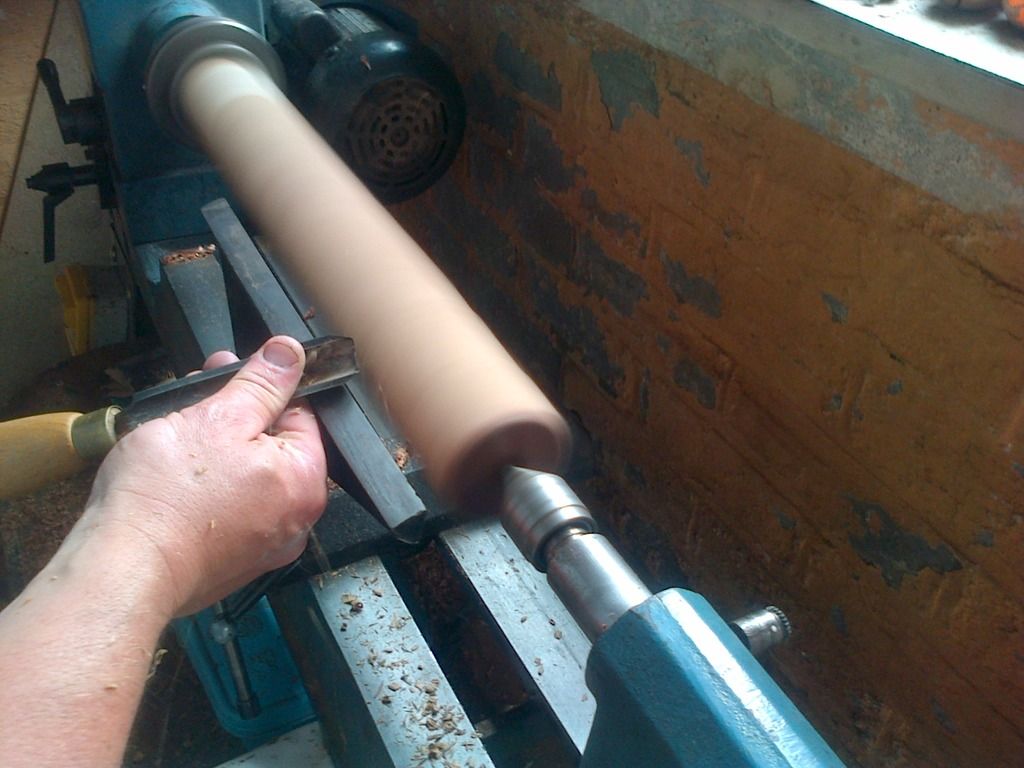

Firstly i raided my off-cut wood bin and found a lovely piece of Hard Pear and began truing this between centres.

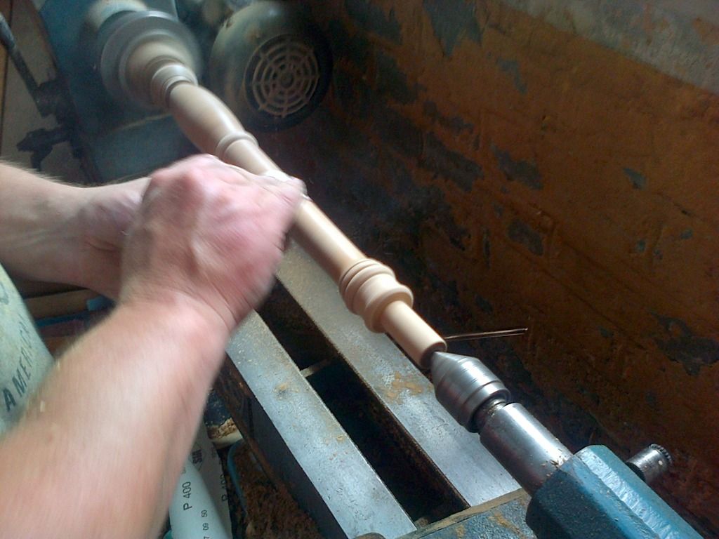

Then it was given a shape of both function and hopefully something pleasing on the eye.

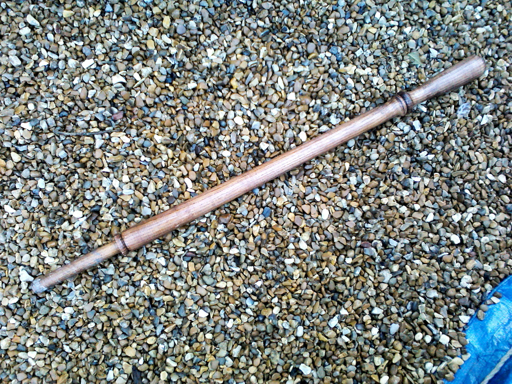

I sanded this up to 400grit and gave it a soft sheen finish with a very hard wearing friction polish. Here it is.
This is a simple push fit into the original tiller arm and gives me the chance to face forward as i punt along up the river whilst still remaining in control of the dinghy.

Most Seagull racers use tiller arm extentions, there is only one problem with them.
To illustrate this fit yours in your Seagull boat & motor into a good clear area of water, set the throttle to warp 9 & sit not on the seat but on the floor, now let the extention slide out of the tiller arm, if you'd been sat on the seat there's a good chance you would be on your back on the floor on full lock going around in circles, with one gunnel almost under water.
This only needs happen once, before you decide a retaining device is the order of the day.

Problem no2. if the extension arm is too tight a fit and your sitting on the stern seat by the transom nice and comfy like with the extension over your leg, you can only turn one way. If you need to turn in a hurry the way your body is stopping the tiller your also in trouble. Dont think i will be sitting on the centre seat as i will be sitting in much the same way as i do now, with my arm behind me making it painful on my shoulder.
