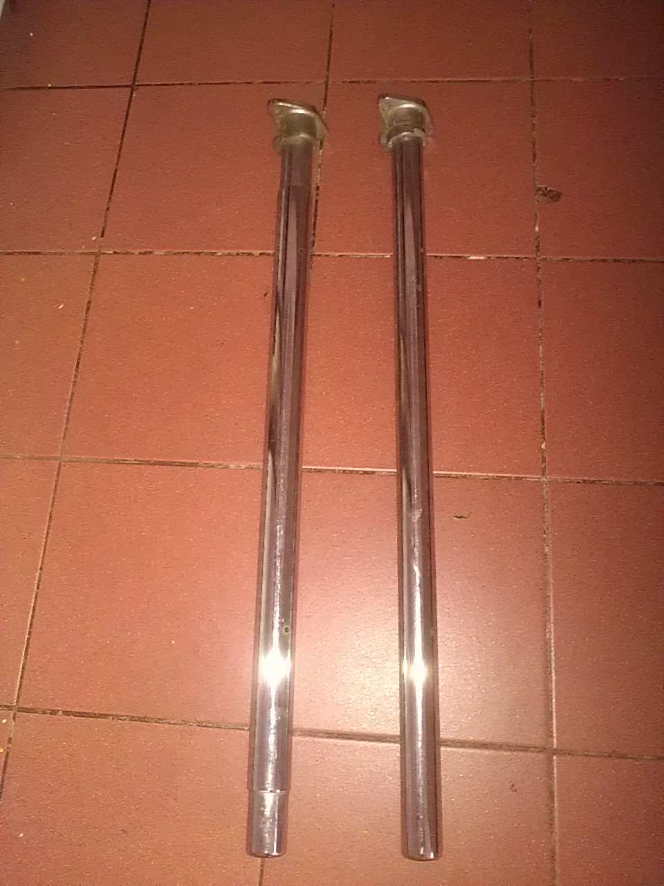

This has been an age old problem for some time. With early long shafts it was easy with the torque shaft being the same diameter from top to bottom and just a matter of a height adjuster or hose clamp to set height.
Solutions perhaps:
1. Mount an auxiliary outboard bracket that has different height adjustment. Not sure if there is such a thing on the market but shouldn't be too hard to fabricate.
2. Bolt a removable board on to the back of the transom to raise height for long shafts. Creates unsightly holes though.
3. Replace torque tube with an early same diameter one. Becomes non original and wont work on EFNR's due to their lockable wide diameter thrust block.
4. Cast up a generic engine mount lug that will fit the larger torque tube. This idea I believe has merit, it solves all of the above problems apart from the more powerful motors bending the shaft. A rare occurrence I would imagine.
I guess BS didn't consider there would be nuts like us that would collect a variety of their motors and assumed we would acquire the correct shaft motor for the boat.
ps I've forgotten what the Alli transom bracket has for the engine mount... not to worry a std one for the occasion. Both my EFNRL and EDL have this problem, the rest of my longshafts are 40/50's with no problem

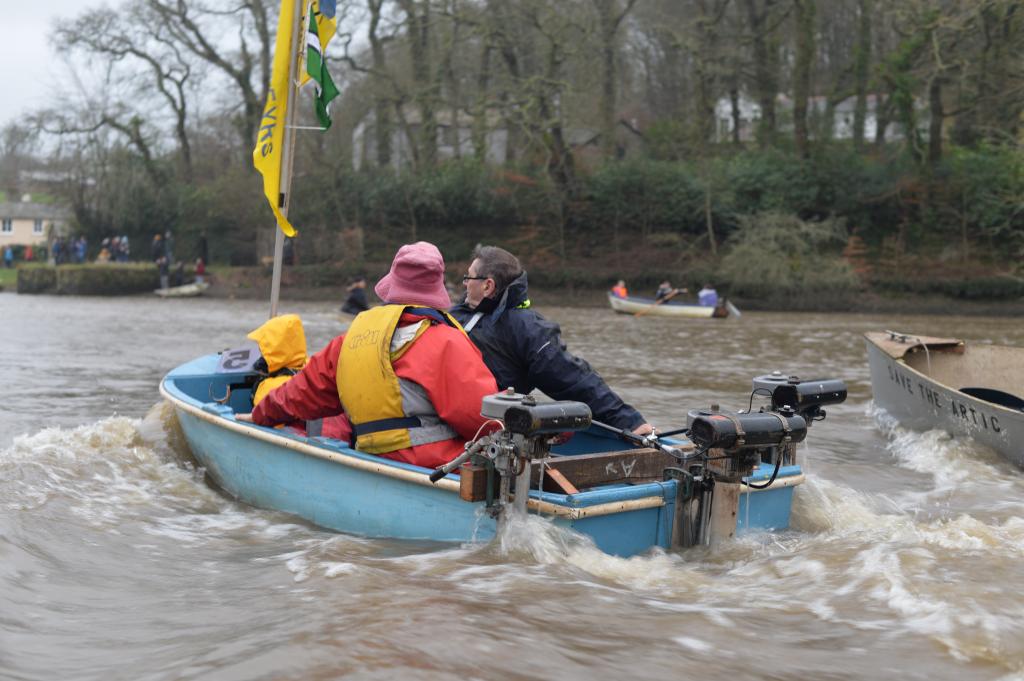

one of my favourite photos! note the adjustable motor mount!! a boat at absolute maximum hull speed Great Stuff don't know the participants but my guess it was taken in the UK somewhere anyone know where and who?
Re: Magic Transom.
Adrian Dale wrote:one of my favourite photos! note the adjustable motor mount!! a boat at absolute maximum hull speed Great Stuff don't know the participants but my guess it was taken in the UK somewhere anyone know where and who?
That was the Lerryn race this year.
http://www.lerryn.net/gallery?os=0&pid=3082#pic3082
P.S. I did see them briefly when I lapped them :lol:
