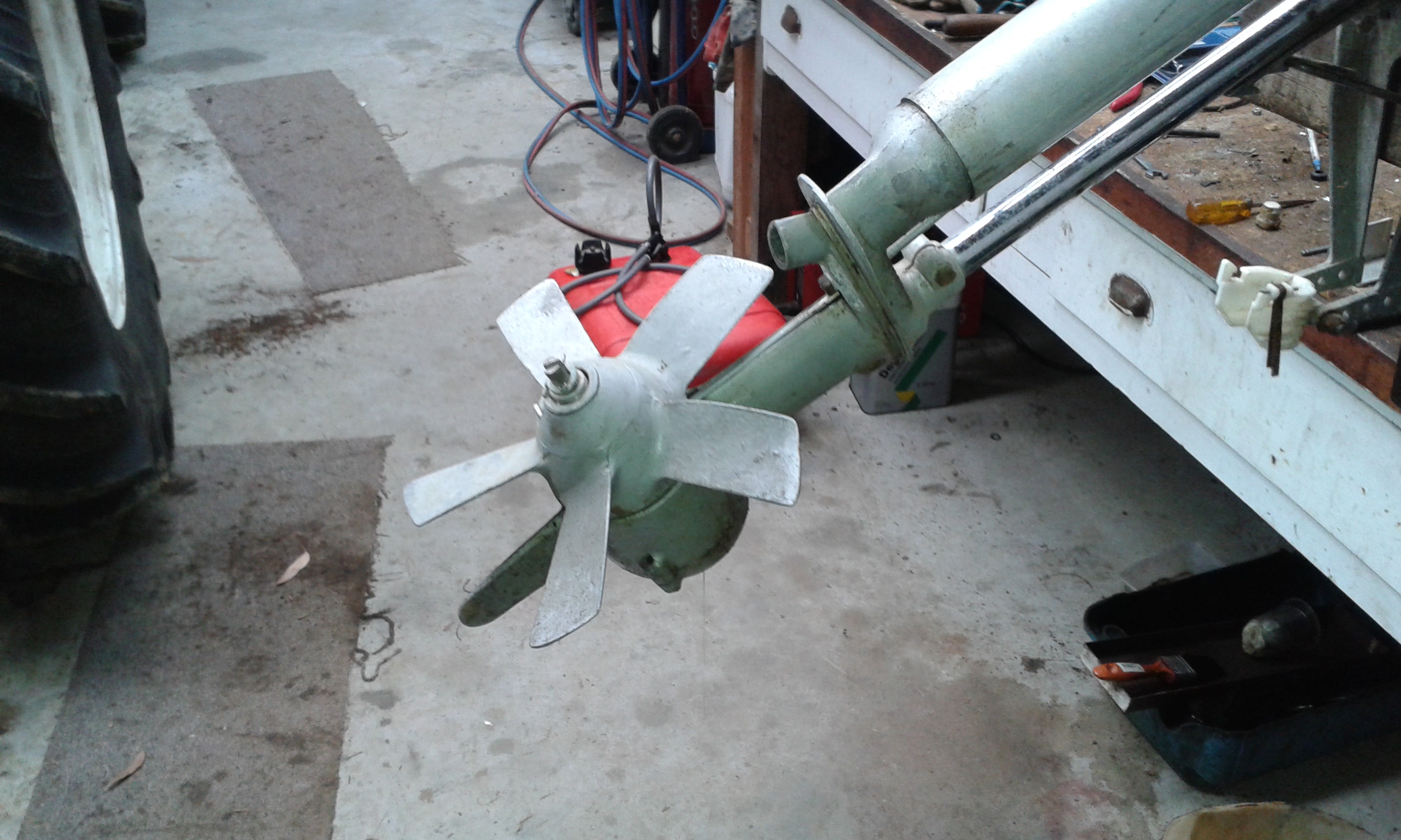

Which is the correct propeller for a WSPCL, 4 or 5 blade?

5 blade 11" dia.

Post by Adrian Dale »
Photo of the correct Porp.
Note the split pin in the thrust block. Don't fit an unbreakable link in the thrust block, guaranteed you will end up with a broken thrust block. This pin had been fitted by the previous owner; the photo shows the original condition of the WSPC before rebuild.
