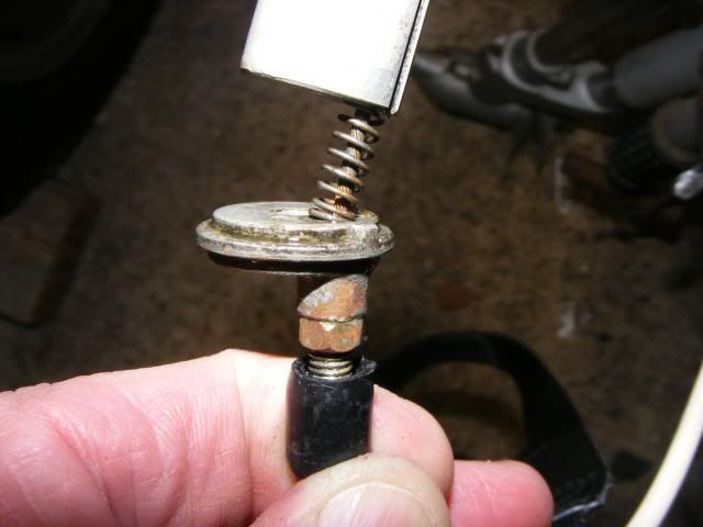

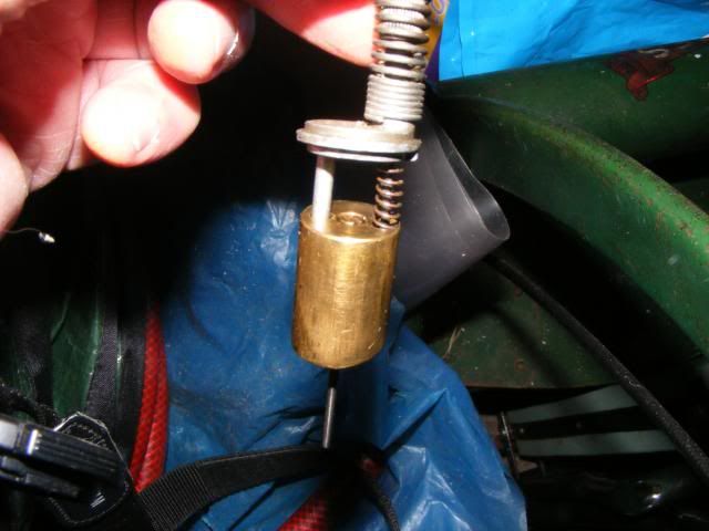

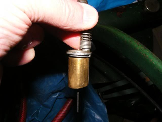

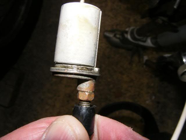

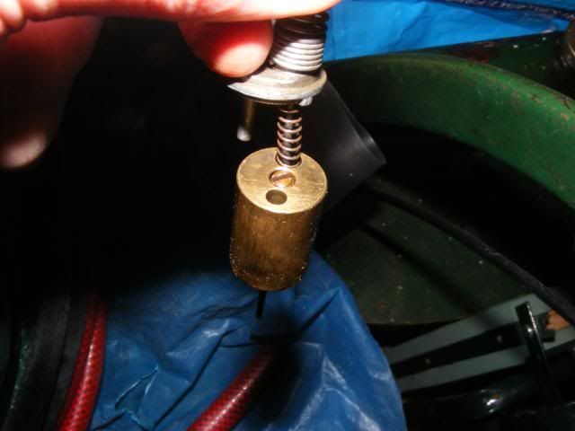

You dont mean the little peg that locates the top correctly (1974 Featherweight)
cos that doesn't
You mean something more like this ( on a ca 1950 Villers engine)
That does not either
because it slides into this hole
