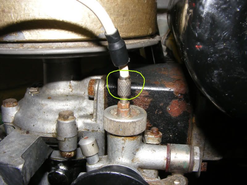

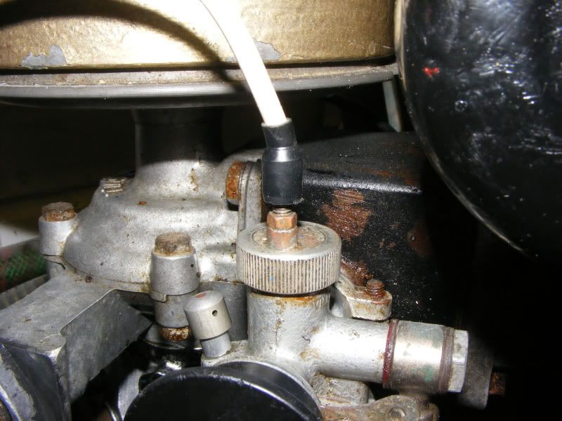

The idling speed can be adjusted with the adjuster on the top of the carb
Slide the cover up and slacken the locknut:
Adjust the speed to what you require with the knurled adjuster:
re-tighten the locknut and slide the cover back into position.
Re: idling???
Shows what I know, I thought it was to take the play out of the cable.
If this is how you adjust the tick over, how do you stop the motor?

Re: idling???
Post by Vic »
Keith.P wrote:Shows what I know, I thought it was to take the play out of the cable.
You can adjust the above so that when the throttle control is turned to its minimum position the engine stops.. That can be a nuisance
You can adjust it so that it continues to idle. That is Ok if you have a clutch. You then stop the engine by turning off the fuel and waiting until it runs out of fuel.
If you don't have a clutch you can try to judge when to turn off the fuel so that the engine stops at the right moment. You might end up rowing few yards, or you might crunch the boat onto the slipway, if you misjudge it.
BUT the clever thing to do is adjust the idle speed so that it continues to idle while the tiller is kept horizontal but stops if the tiller is lowered.
It wont do that you cry ... But it will, and that is how I adjust the Featherweight I use on my tender.
