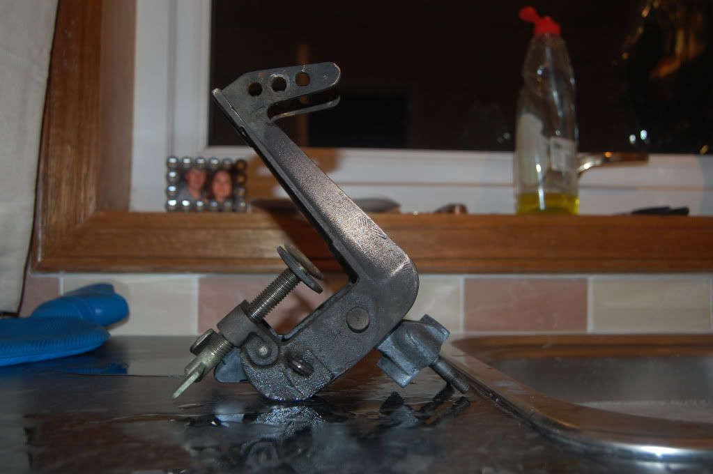

Im at home every night working on my Seagull and i was wondering does anybody have any hints on getting 20+years of baked on dirt and grease? i have tried caustic soda on the Brass bracket (photos below) but still took a wire brush and a few hours to remove it. the engine is going to be harder because of the shape. any ideas?

Don't use caustic soda on the alumnium parts - the ally will etch badly and start to disappear if the solution is too strong!
Paraffin would be good, or use a proprietary engine cleaner such as Gunk. At least the oil may have stopped corrosion/ rust that might otherwise have occurred.
