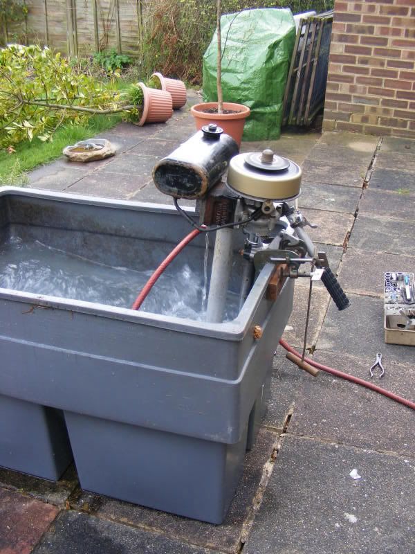

3) On tick-over, no water circulates. On half throttle, water does circulate, but the water coming out is quite hot - I can just bear to hold my finger under it. Is this normal or is this too hot? (This is in a bucket of water on a workmate, not on a boat in open water).

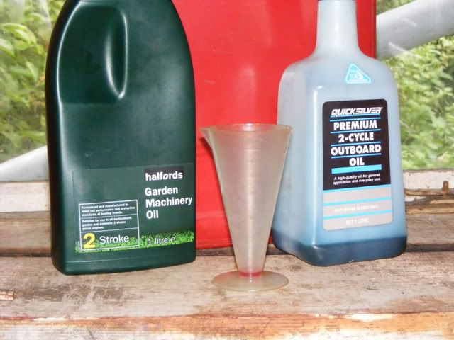

Measure the oil in what ever way suits you. Some people have a little bottle marked with the correct amount for say 1 litre. You can buy mixing bottles already calibrated I believe.
I know its over the top but I use a plastic conical laboratory measure for the oil and a calibrated plastic jug for the petrol. convenient because I need different mixes for different things (50:1 for the main engine, 16;1 for the mower and 25:1 for the Seagull)
Putting the oil in the tank first then sloshing in the petrol gets it fairly well mixed but putting the petrol in first and adding the oil doesn't do so well.
Often don't pump well in a bucket but do in a larger tank. Even the Featherweight I use on my tender barely pumps at tick over.
A bit faster than tick over here
A wheelie bin is better than a bucket but tip out the garden rubbish first
