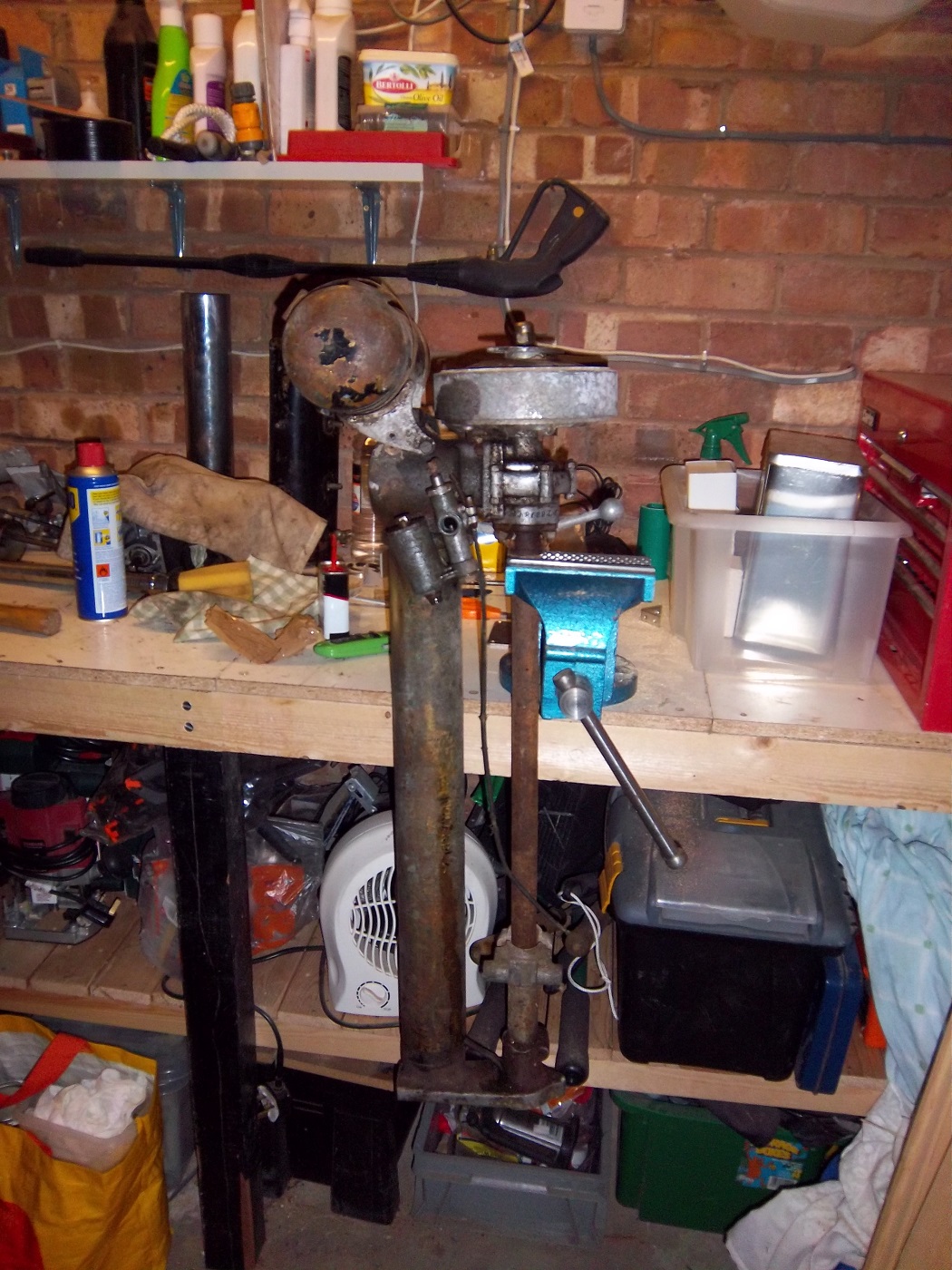

Thanks :P That engine is the one that got me into the world of vintage outboards in 2010. Quite a few have come along, and been moved on. This one is a keeper for me, as it was my first 8)
I only use it a few times per year, but it is always fun, and it polishes up well. One of the best seagulls to own, a copper top SD. I'd encourage anybody to get one.
This is what it looked like when I got it for £25 in 2010 :lol:
