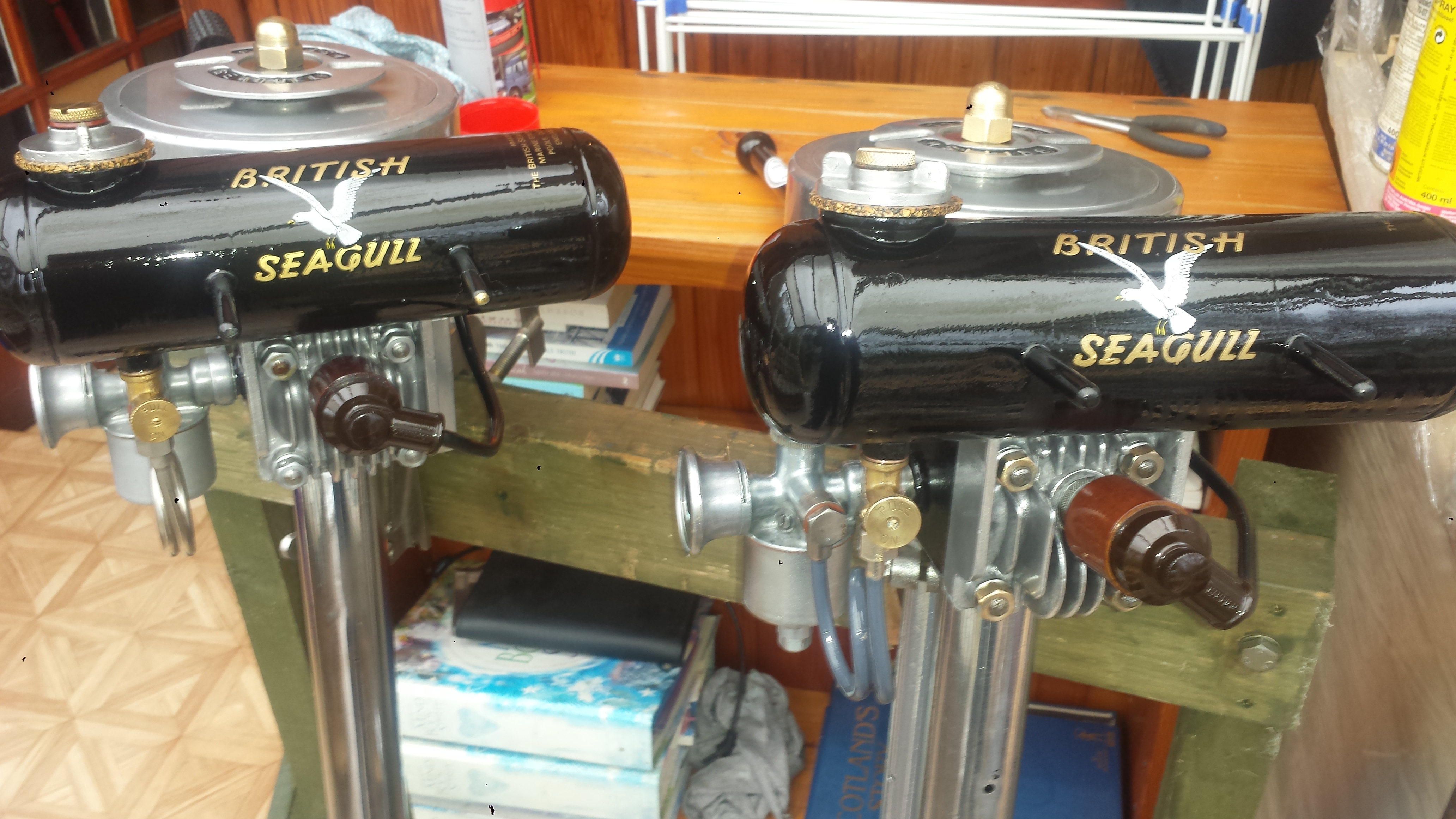

No in the world cover Tam
None of my fvp,s have lettered covers ????? does that make them wrong i know for sure that one is completely original....china
Both 1951
Both 1951
Posts: 3319
Re: fvp7089
The lettered cover came along during the production run, but earlier ones were blank. I think Jeremy has this change point tracked down fairly close. The stuff he has on the main SOS site might well tell you.

From the data that I have collected,the flywheel cover almost certainly was being fitted with 'in the world' by serial number 15000. It might have started by S/No 14000 or possibly by S/No 13000. Evidence suggests that all engines prior to approx 13000 would have had plain covers.
That means that all FVPs would have had plain covers.

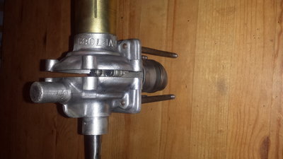

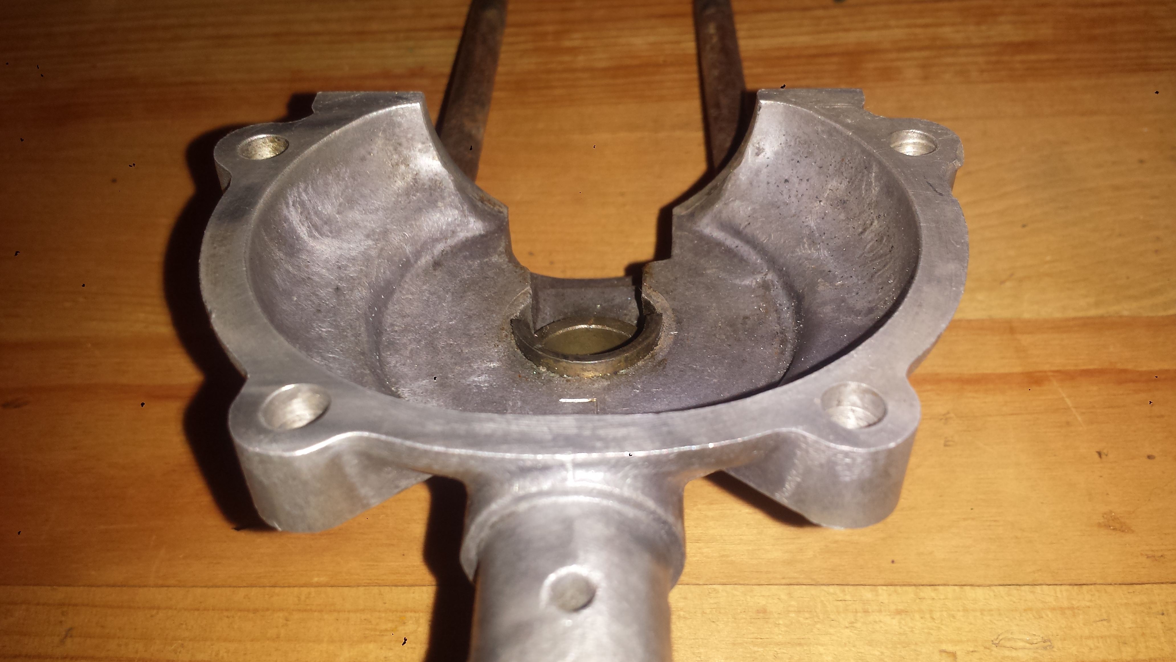

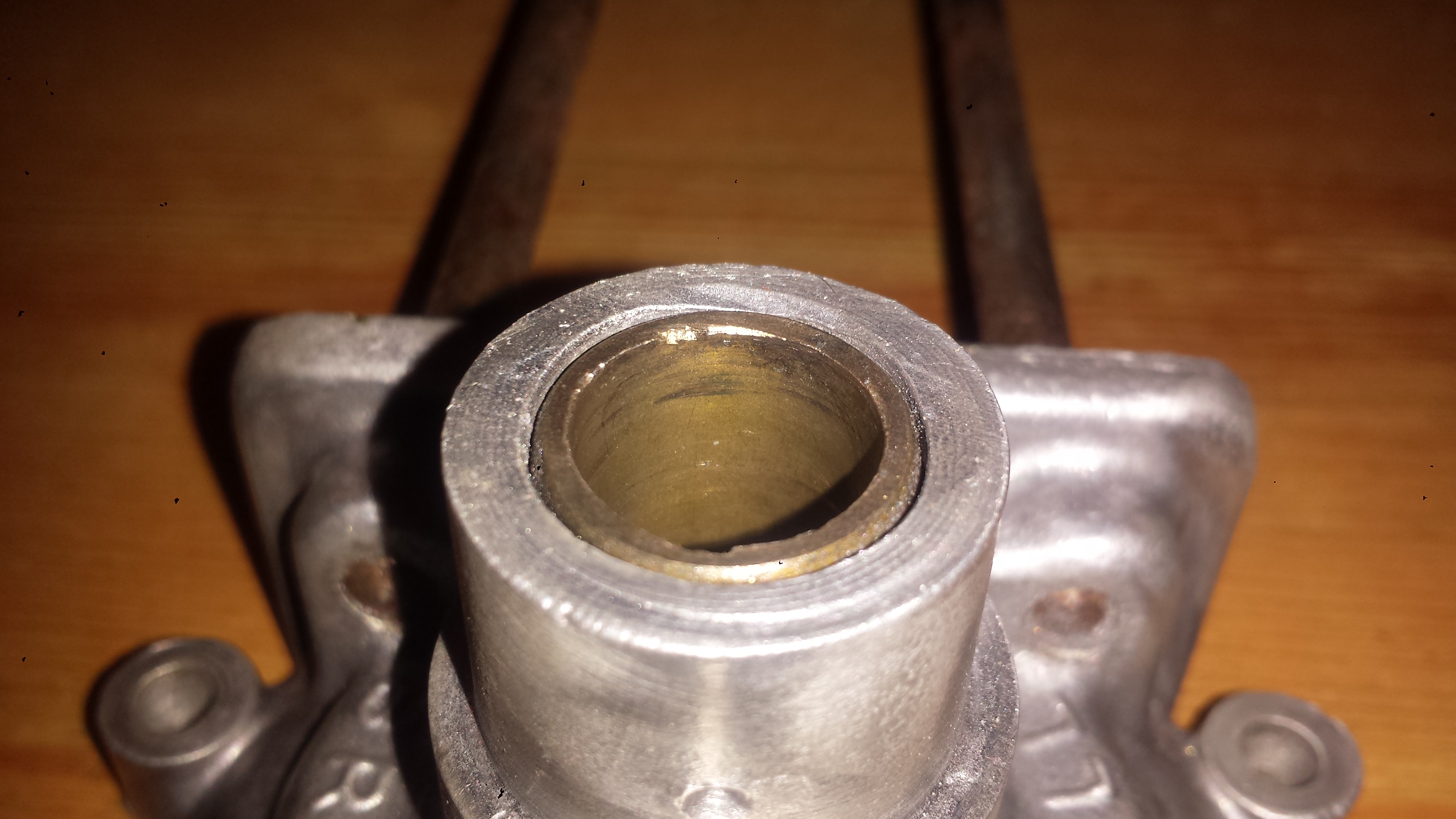

What have i done is it possible that the top crankcase bush has moved when i removed the flywheel after giving it the usual whack with the hammer bottom half is fine i gave the crank shaft a few taps with a rubber hammer and its only making it tighter over to the experts
Re: fvp7089
I read this, So now I have got my breath back.
Tam most if not all little models have a silly amount of end float, a good quarter inch.......
Re: fvp7089
I think i might have been misleading the crankcase s are not coming together get my drift china
Re: fvp7089
Aha, What have you changed ?
