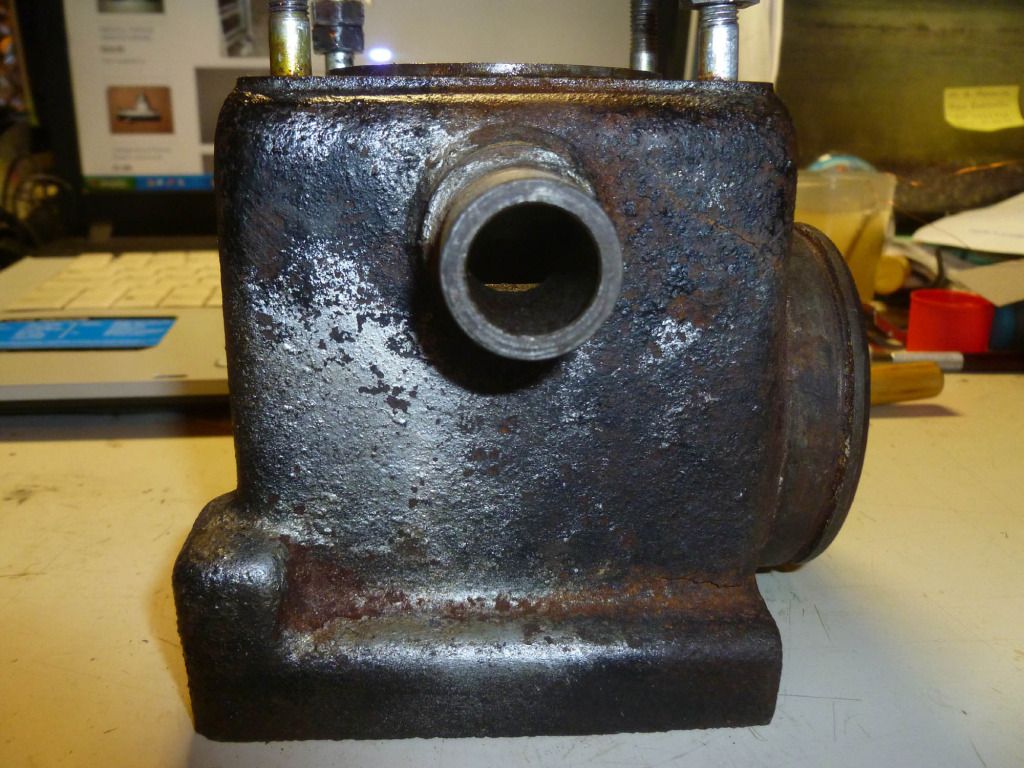

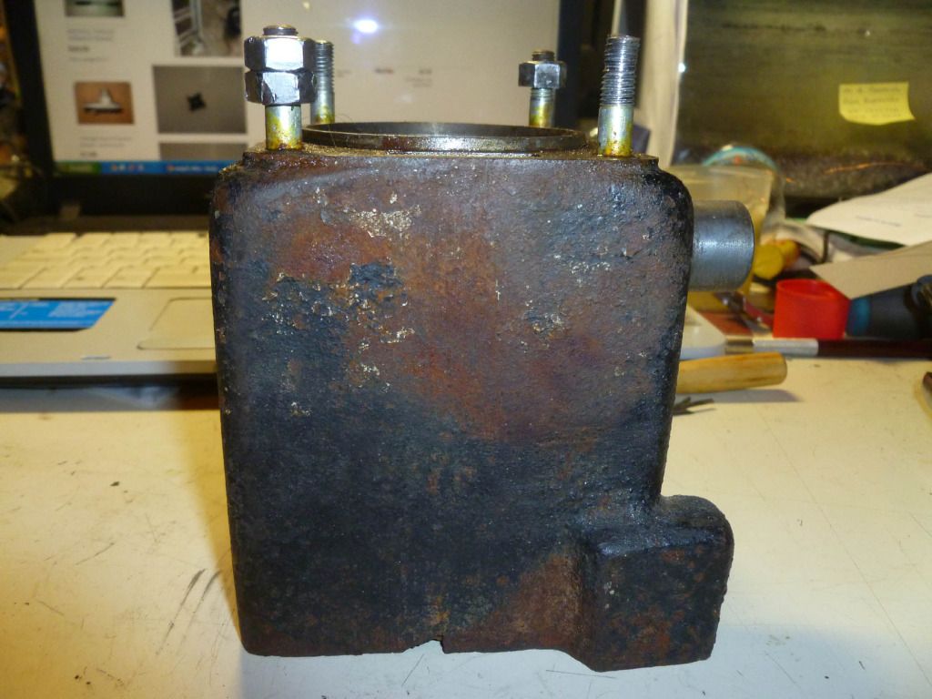

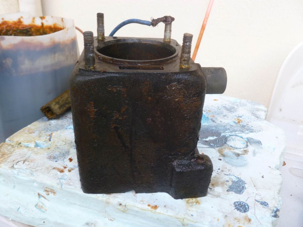

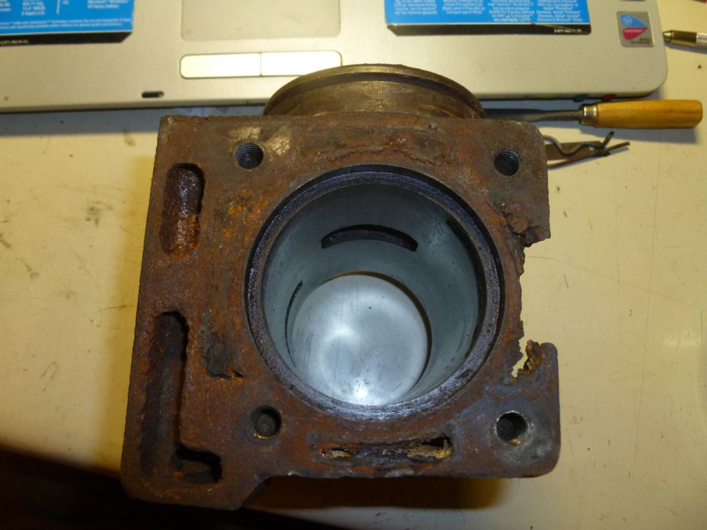

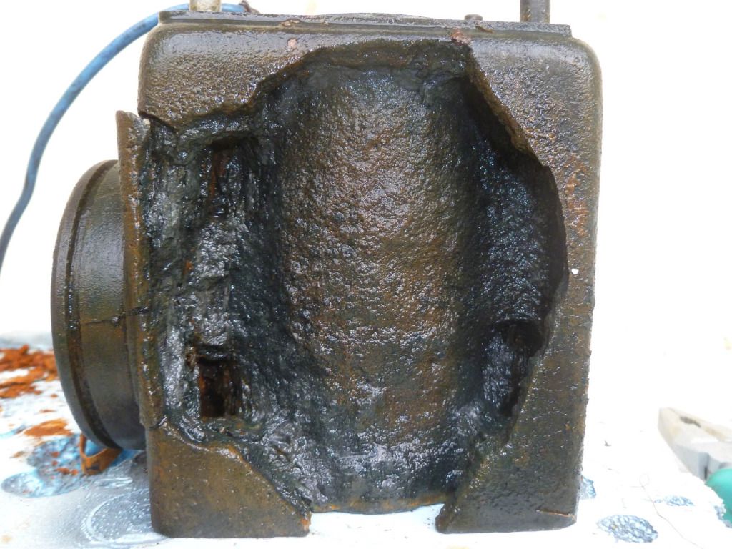

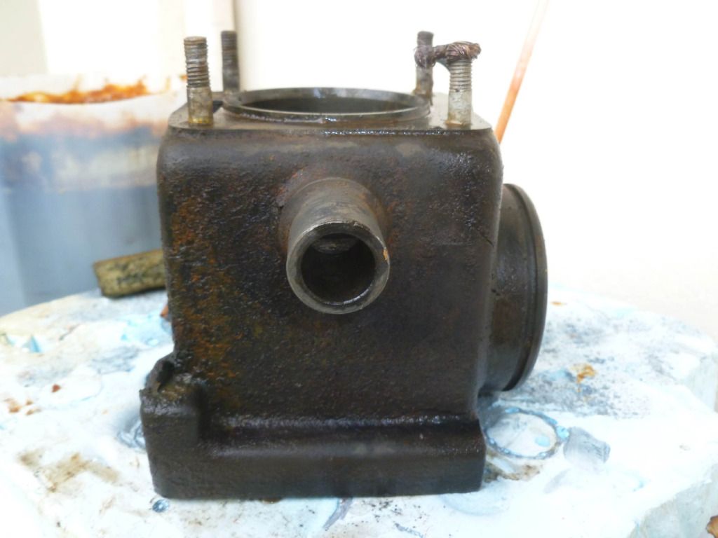

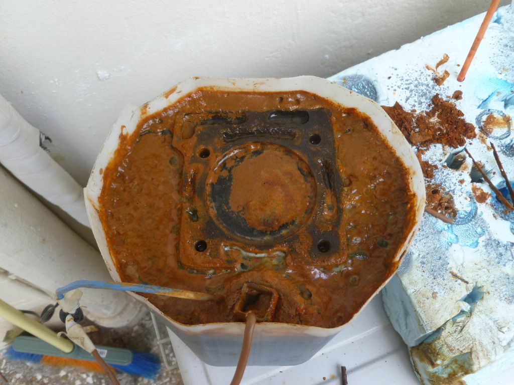

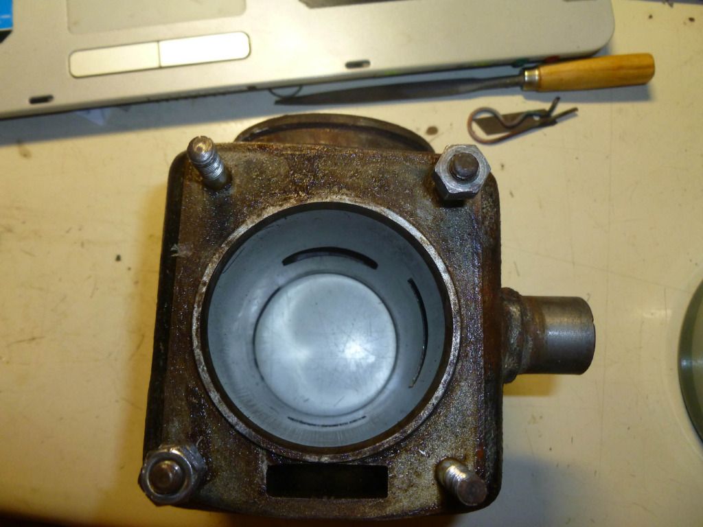

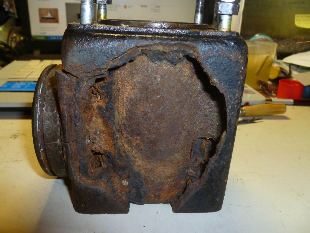

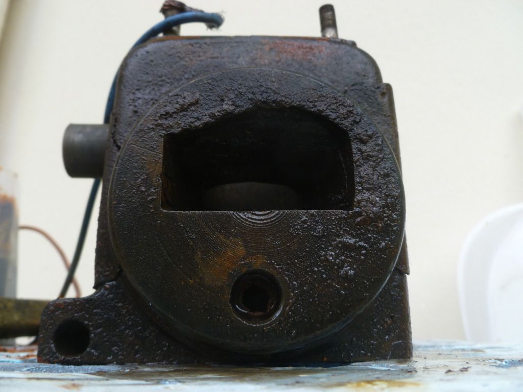

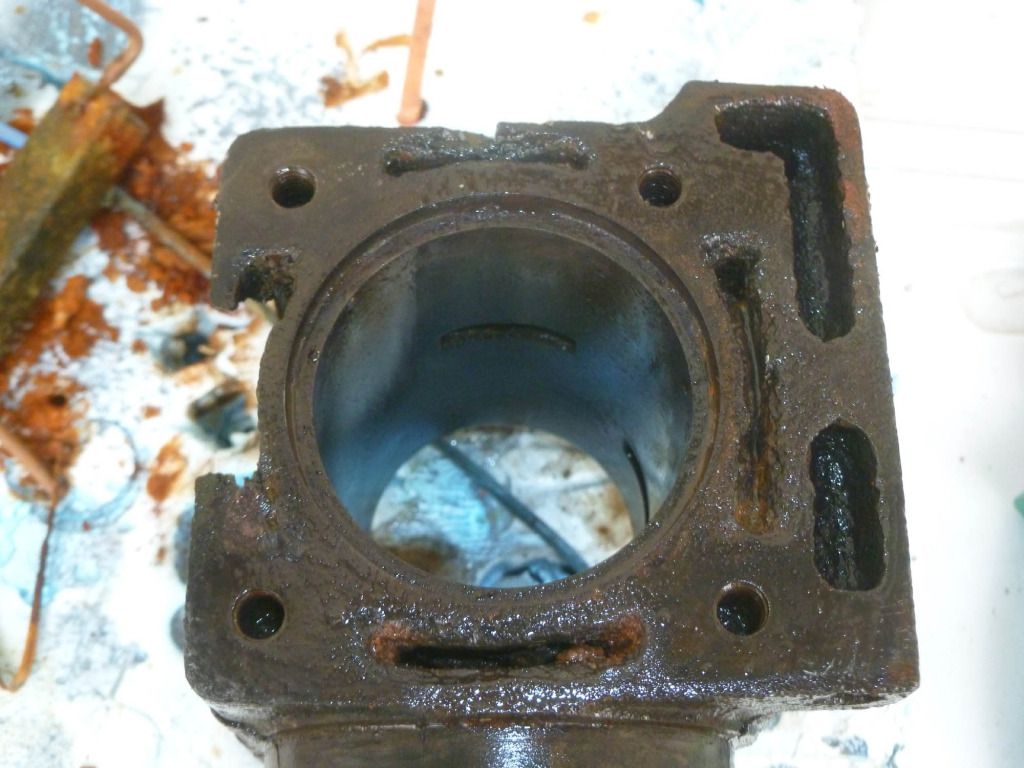

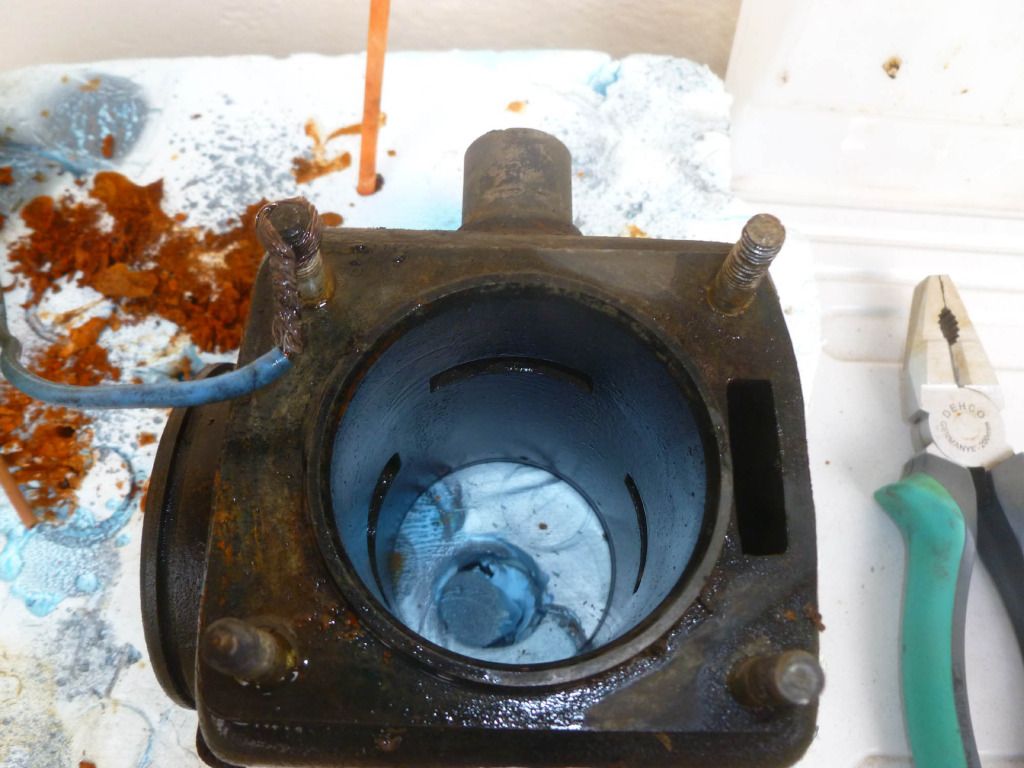

Here comes the pictures. This is before.
And this is after.
This is rust floating. I have changed the solution 3-4 times removing such amounts of rust but according to the visible results the procedure has to continue for many more days.
One sacrificial electrode.
Seems to be working but it needs much more time than a couple of days. It certainly would be beneficial to use a round electrode which creates a cylinder and in the middle would be the block. High temperature increases the speed of the reaction, a lot of baking soda increases the temperature. I don't know exactly why, maybe because of making the solution more conductive.
Now staring at the pictures I think that this block must have left to soak well in salt water..!
And this is after.

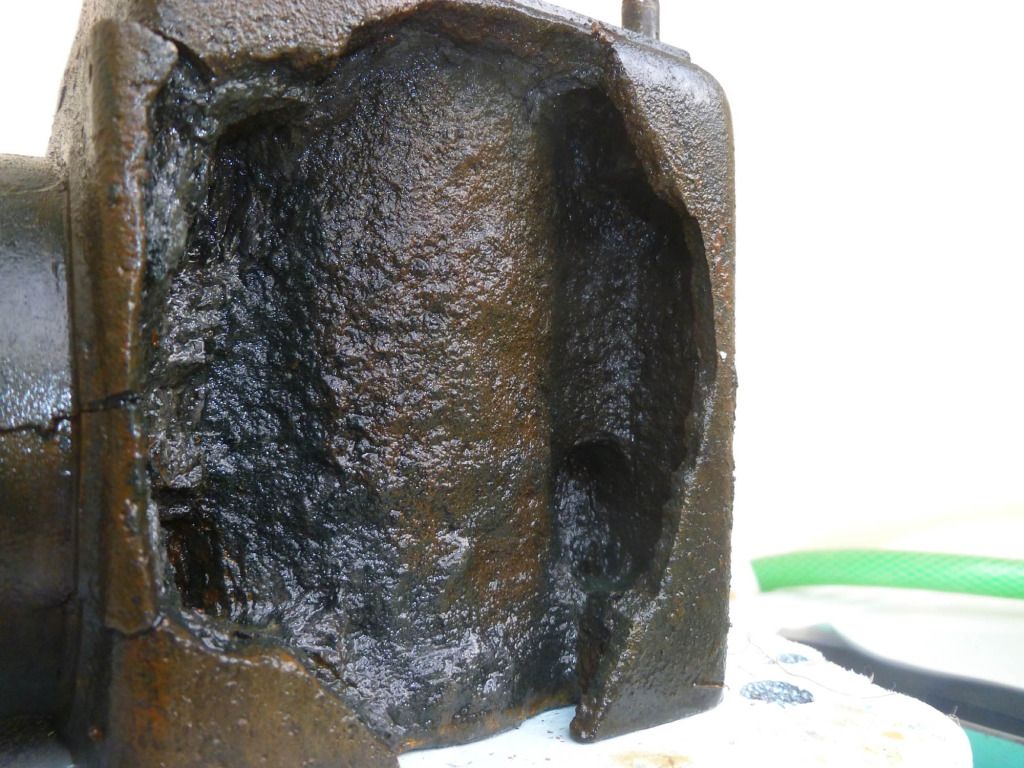

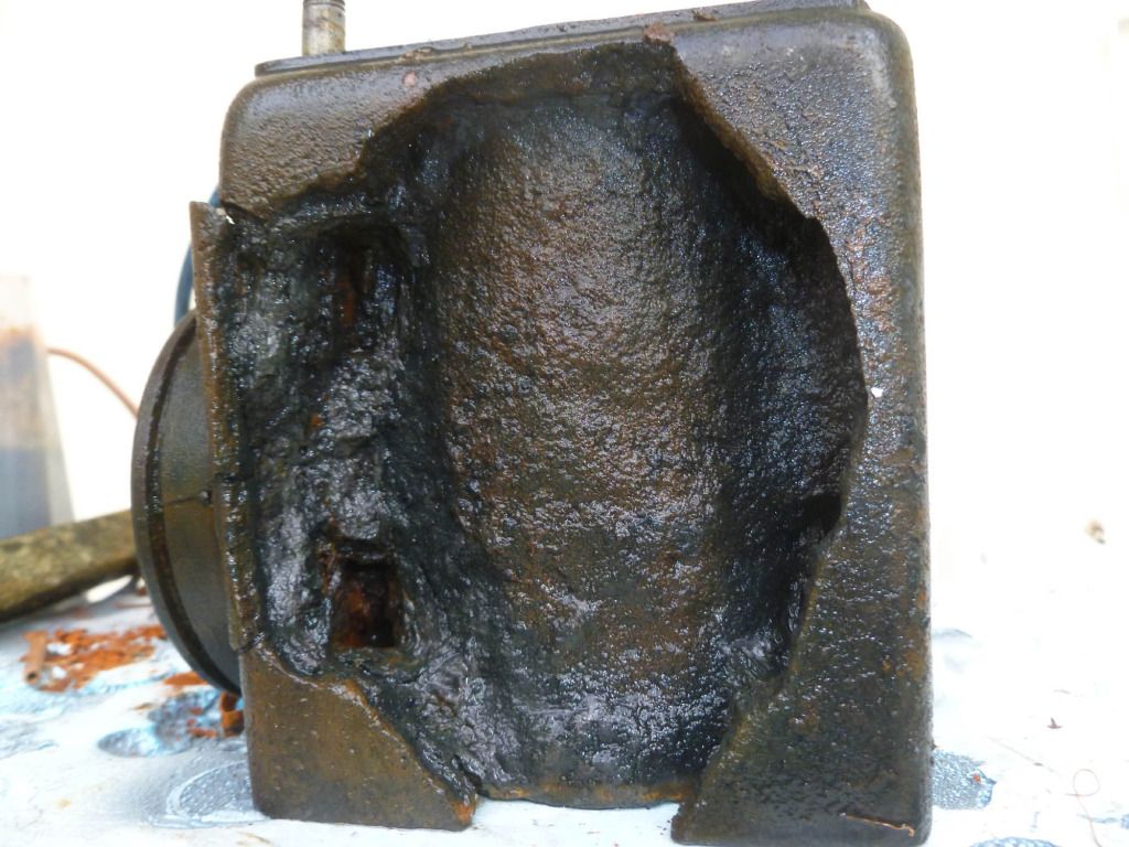

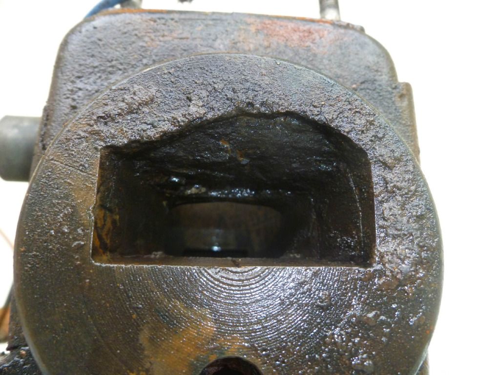

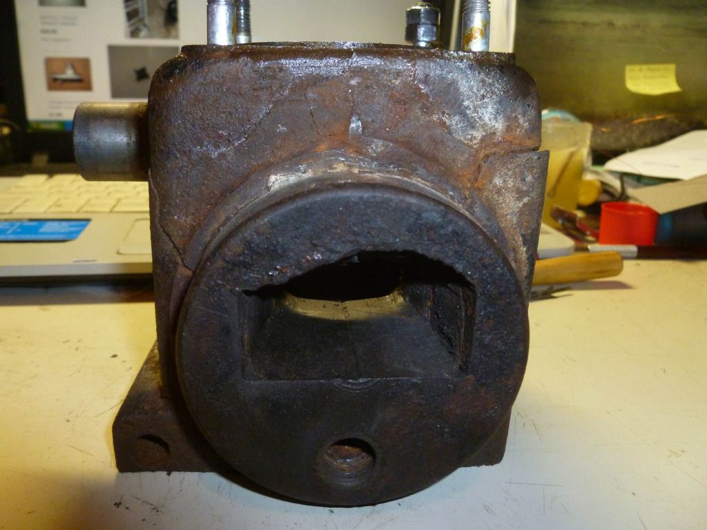

I have but one square block 102 and of course it is cracked.
Looks different to the ones in this topic. Why?
I will drill some holes and have a look later. Would it have the same little pockets as the sectioned photos show earlier?
