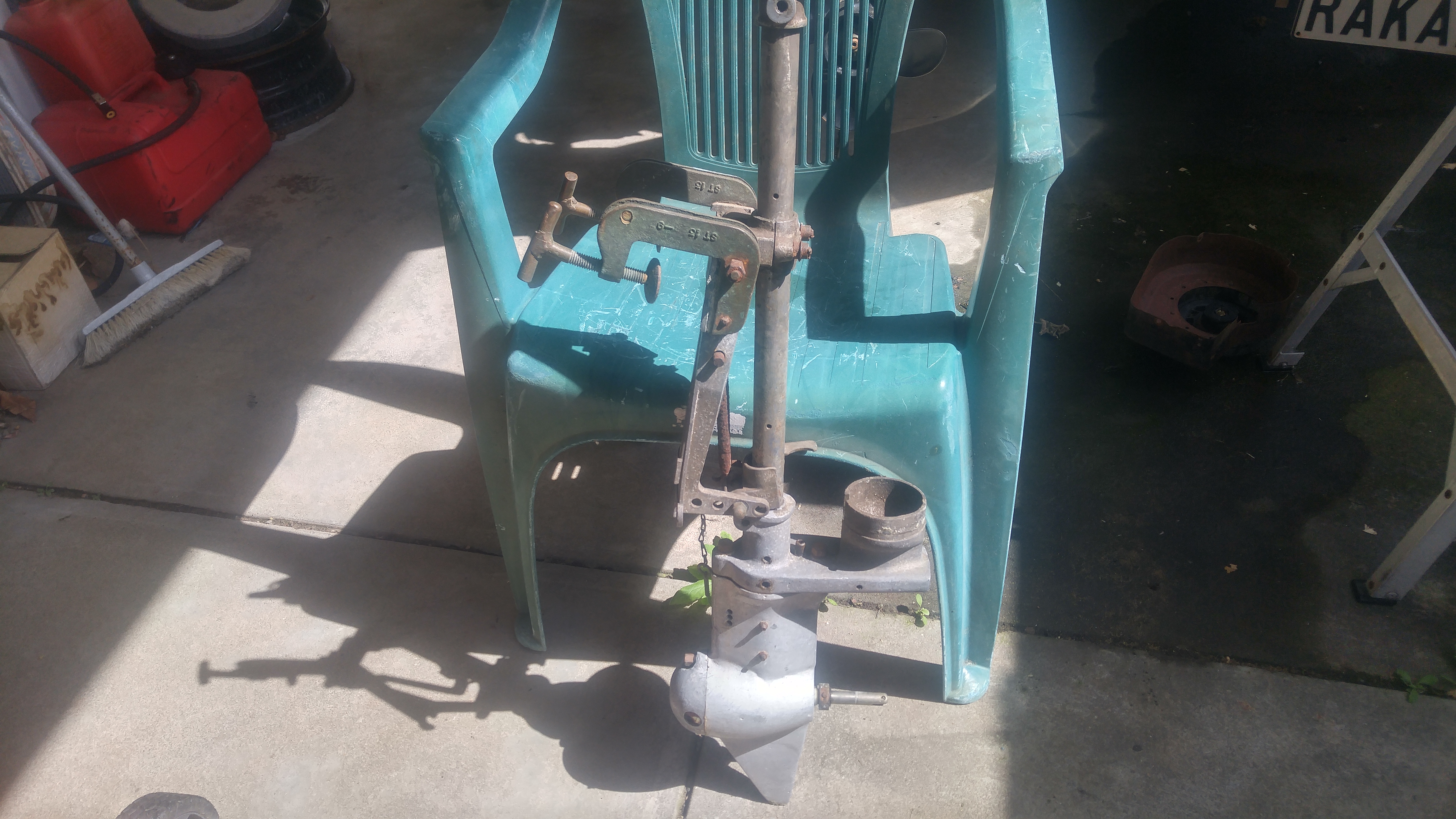

Re: AD2710

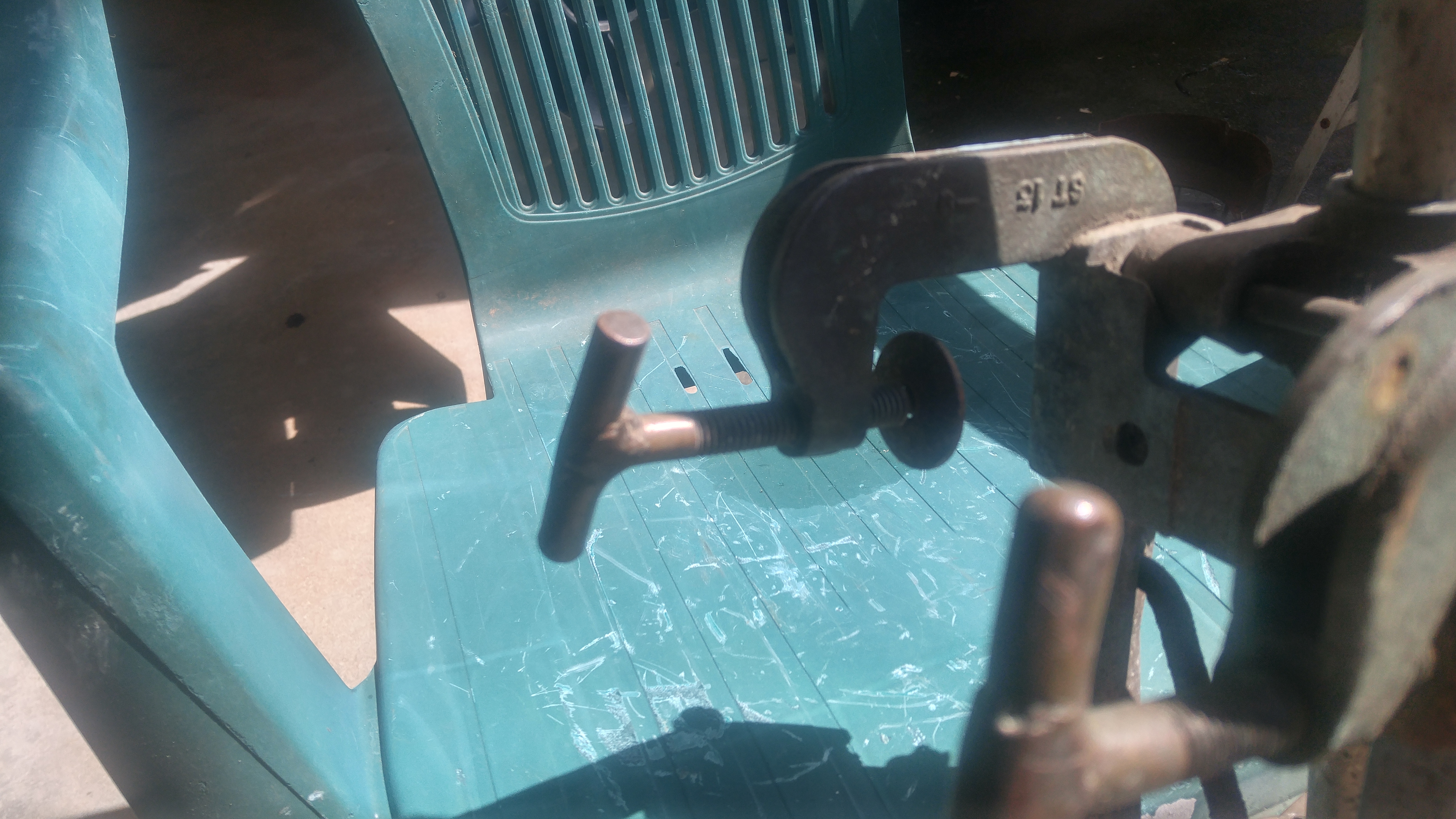

Ok
The hard bits about to be attended to. Wash down with ATF and kerosene. then a couple of towels soaked in same and into a black plastic Sulo Bin liner.
Leave in increasing sunshine for a week, maybe two, and apart it will be.
The transom clamps will be brought back to dogleg with some reverse brazing after that.

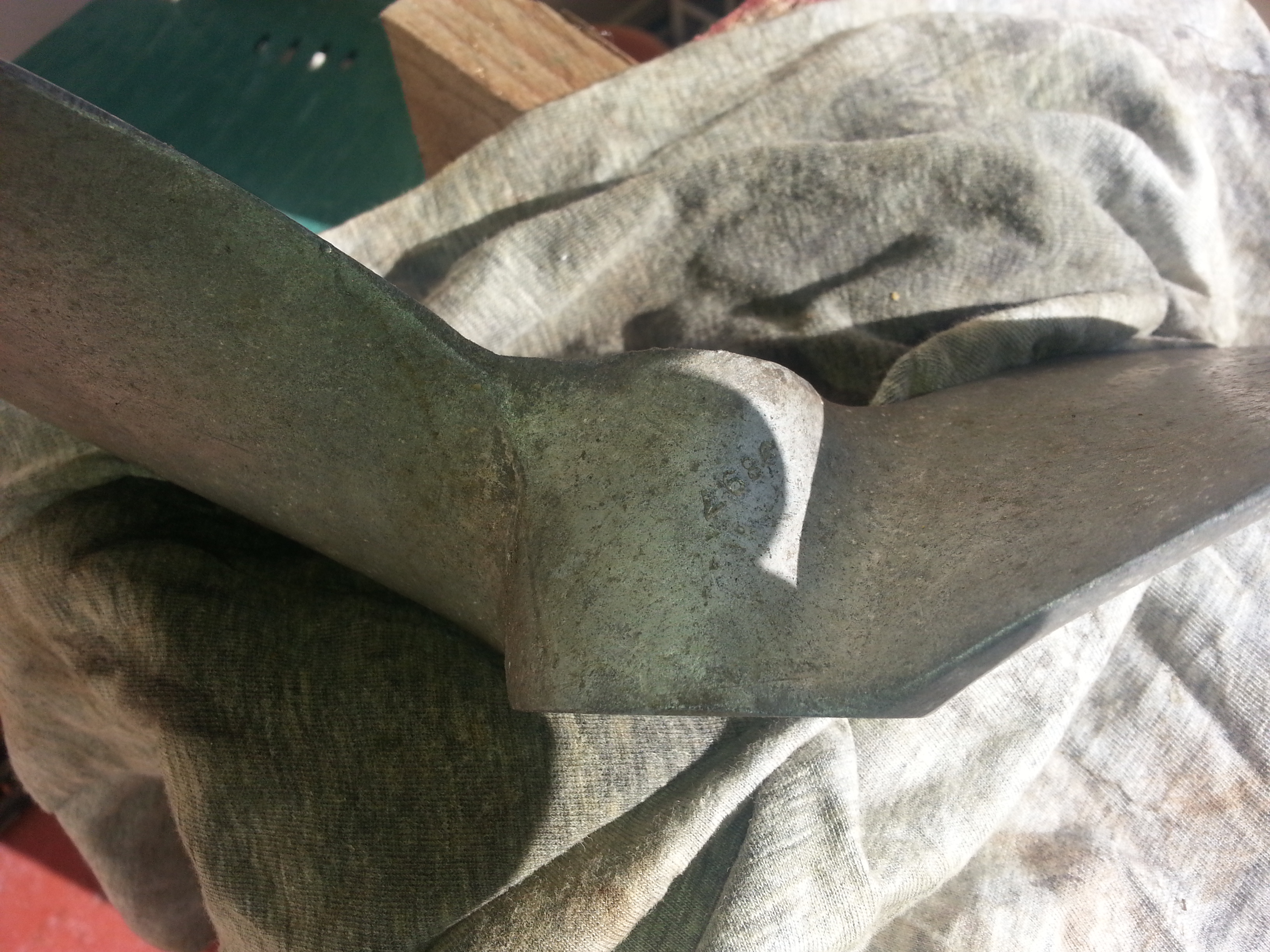

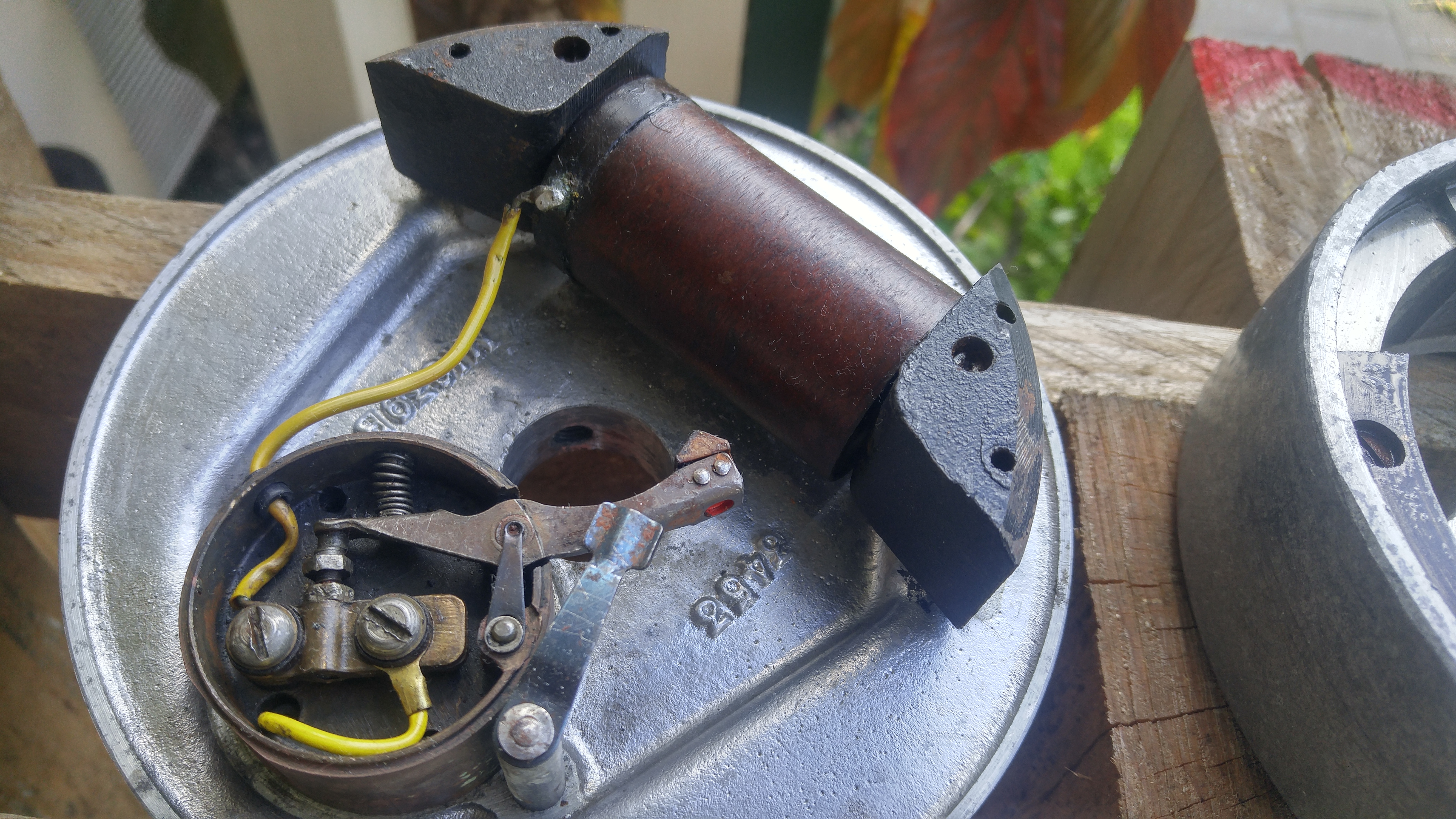

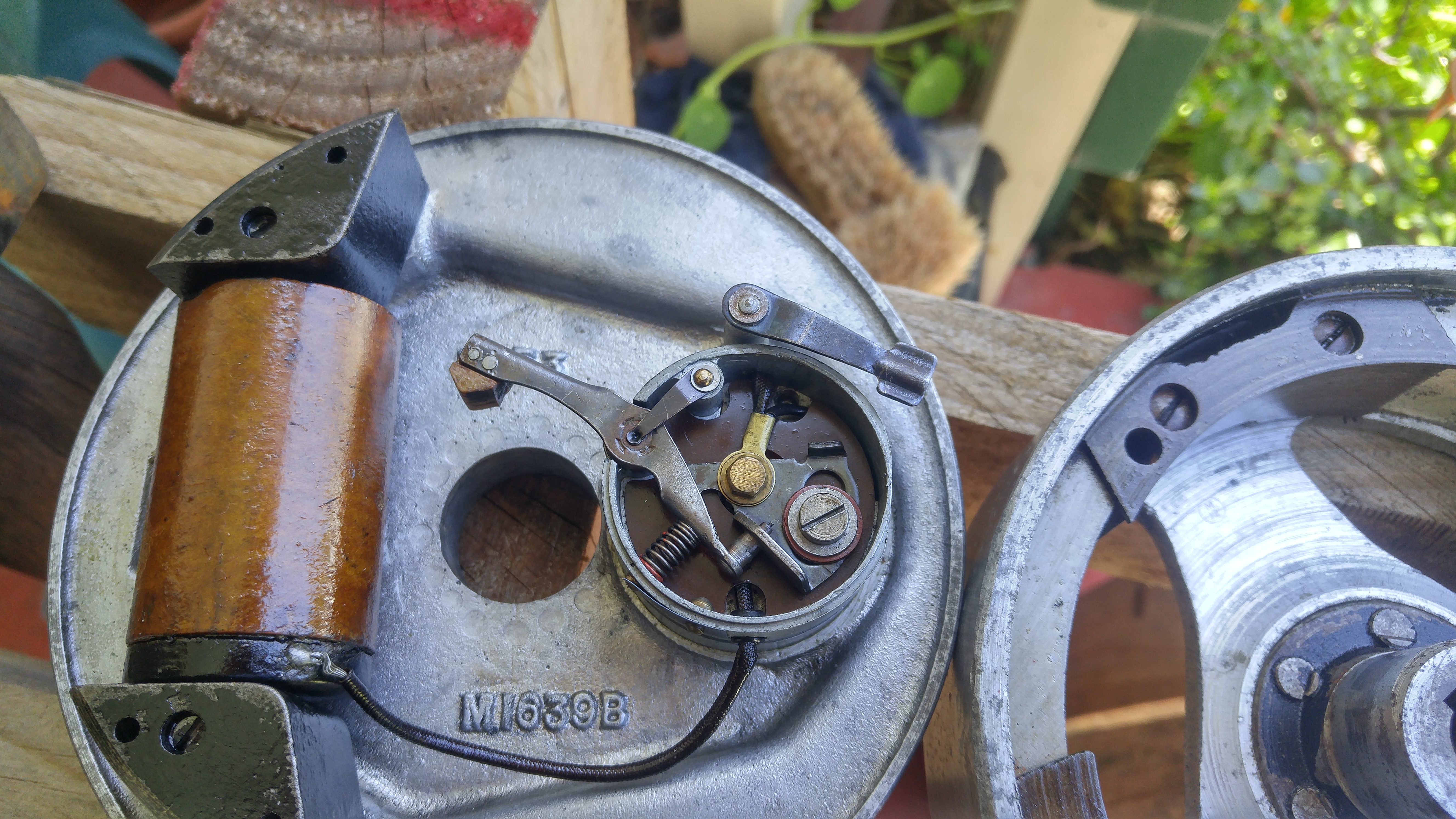

Changed a couple of things.
Now tests "Rock Solid"

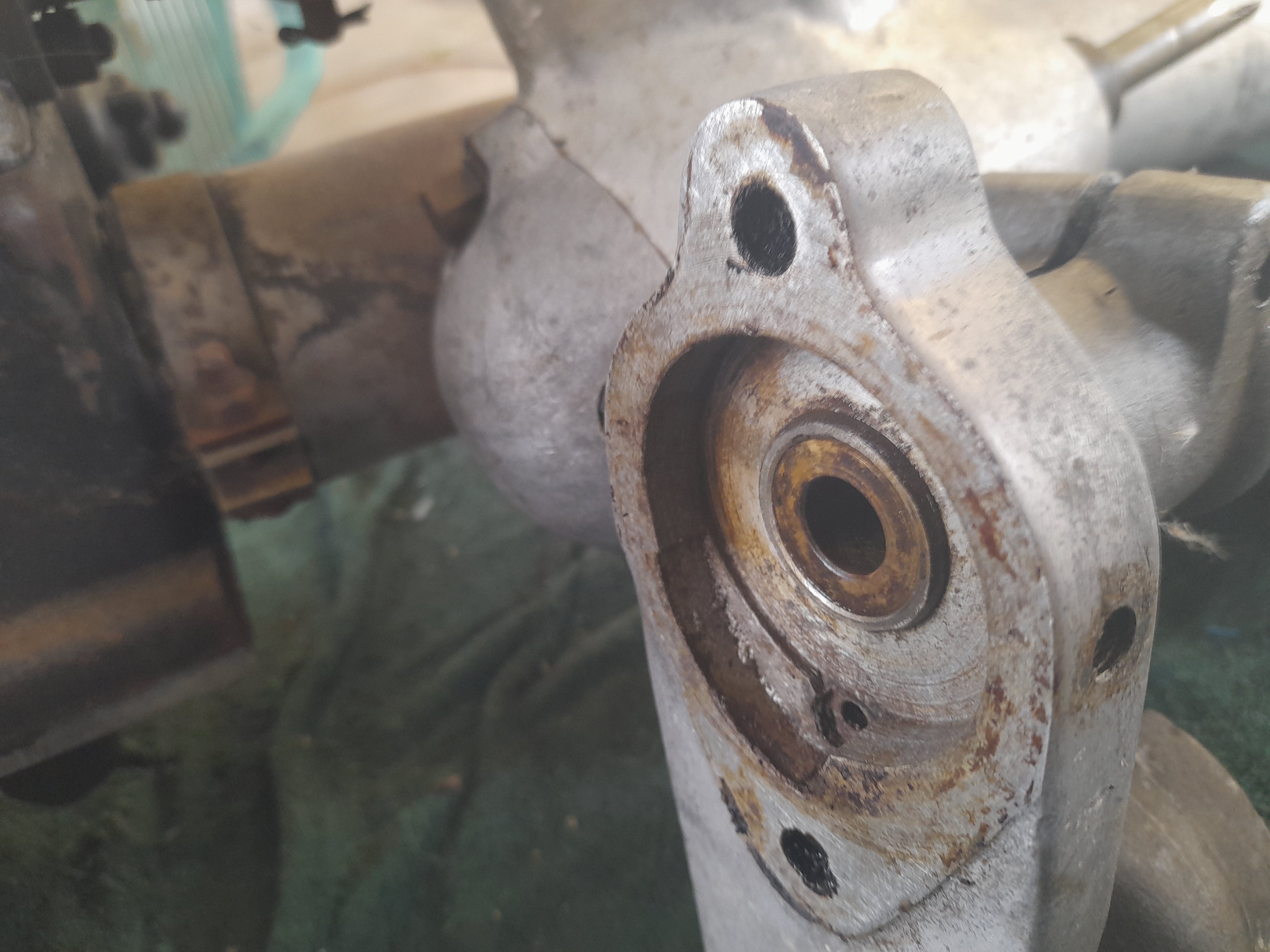

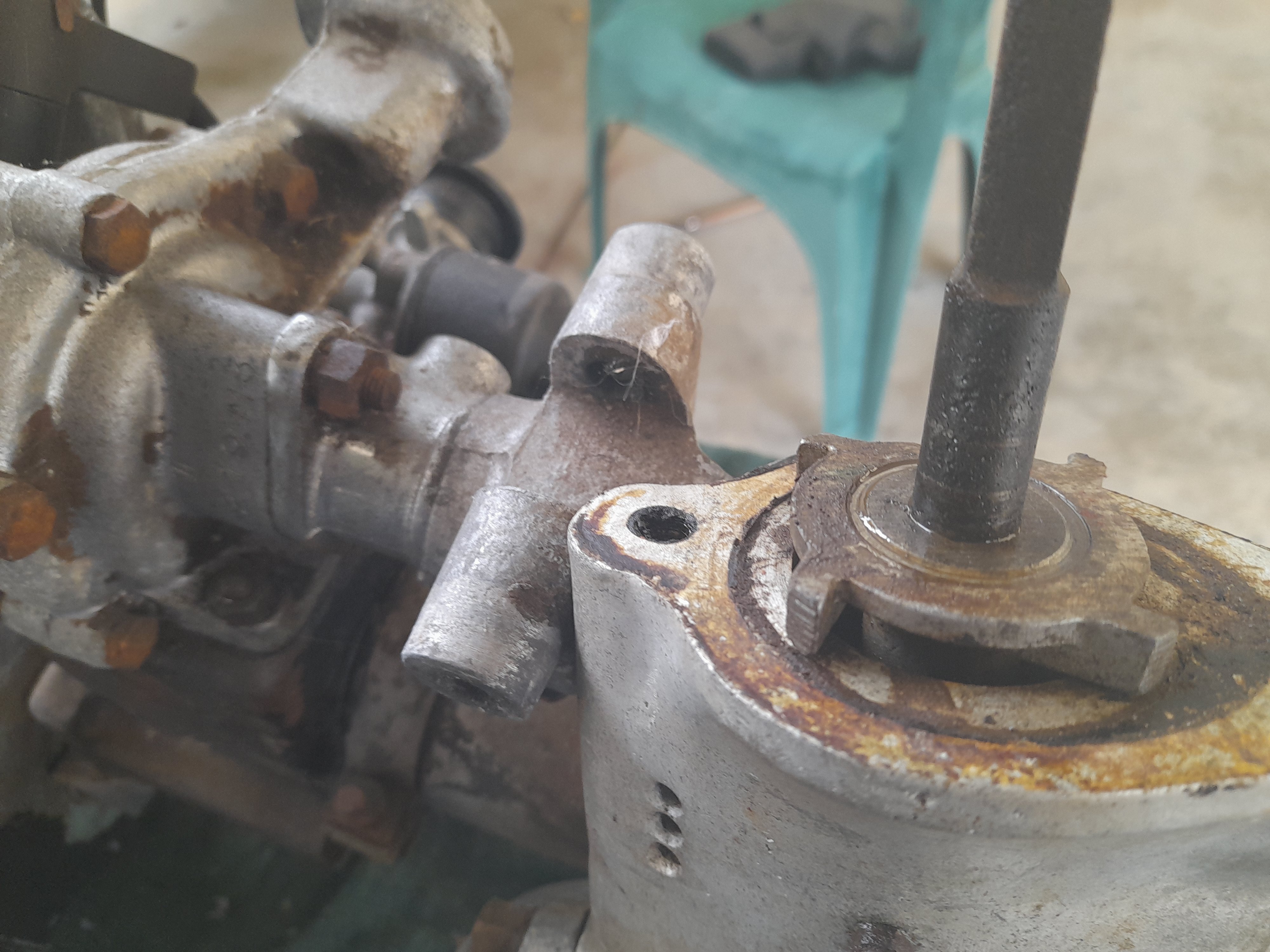

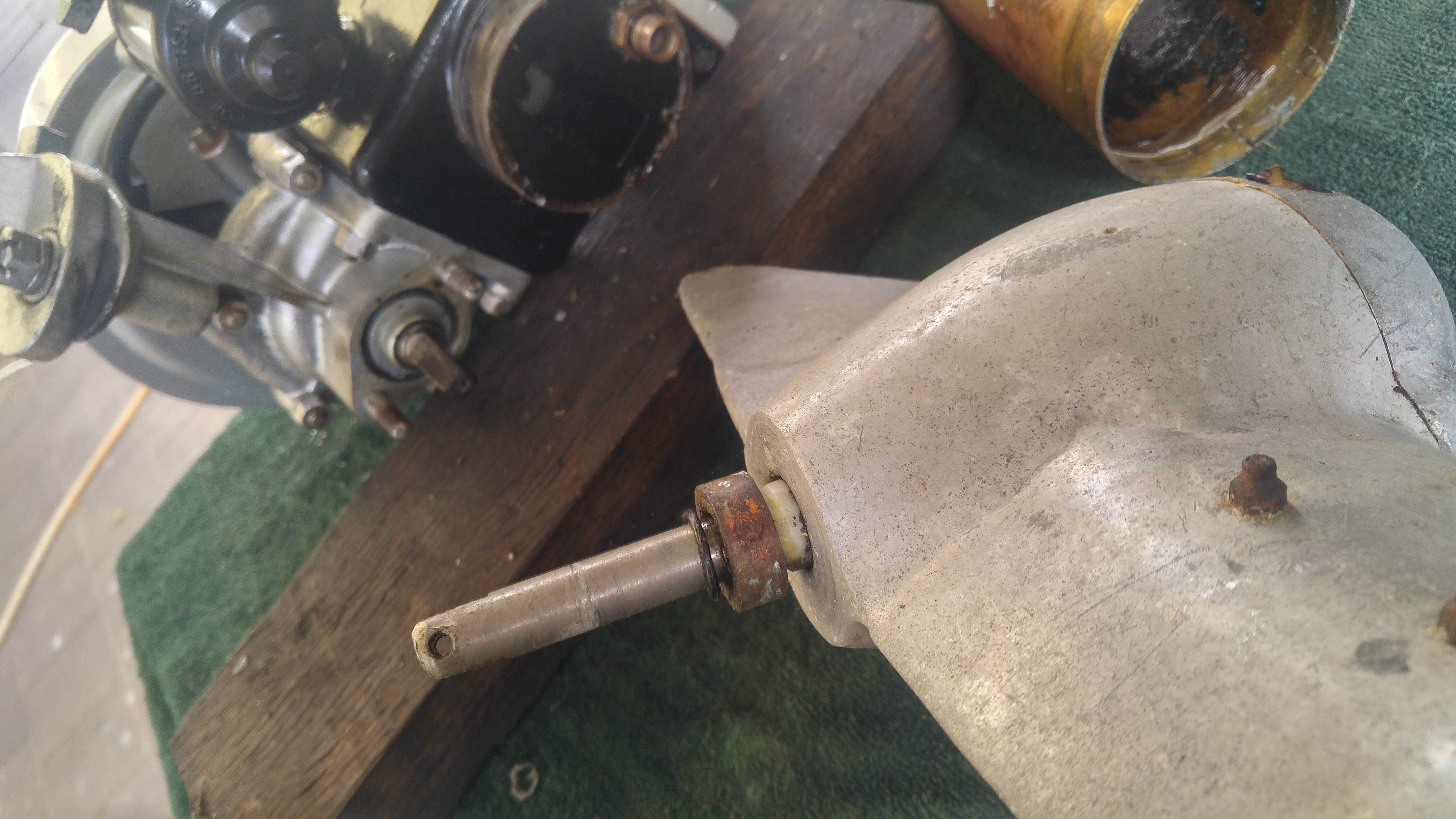

Nearly forgot... The white bush (or something) staring me in the face.
All coming apart soon for inspection and will find out I expect.
Any info appreciated in the short term.

Interesting! Wonder if just a spacer added at some point? To what end no idea.

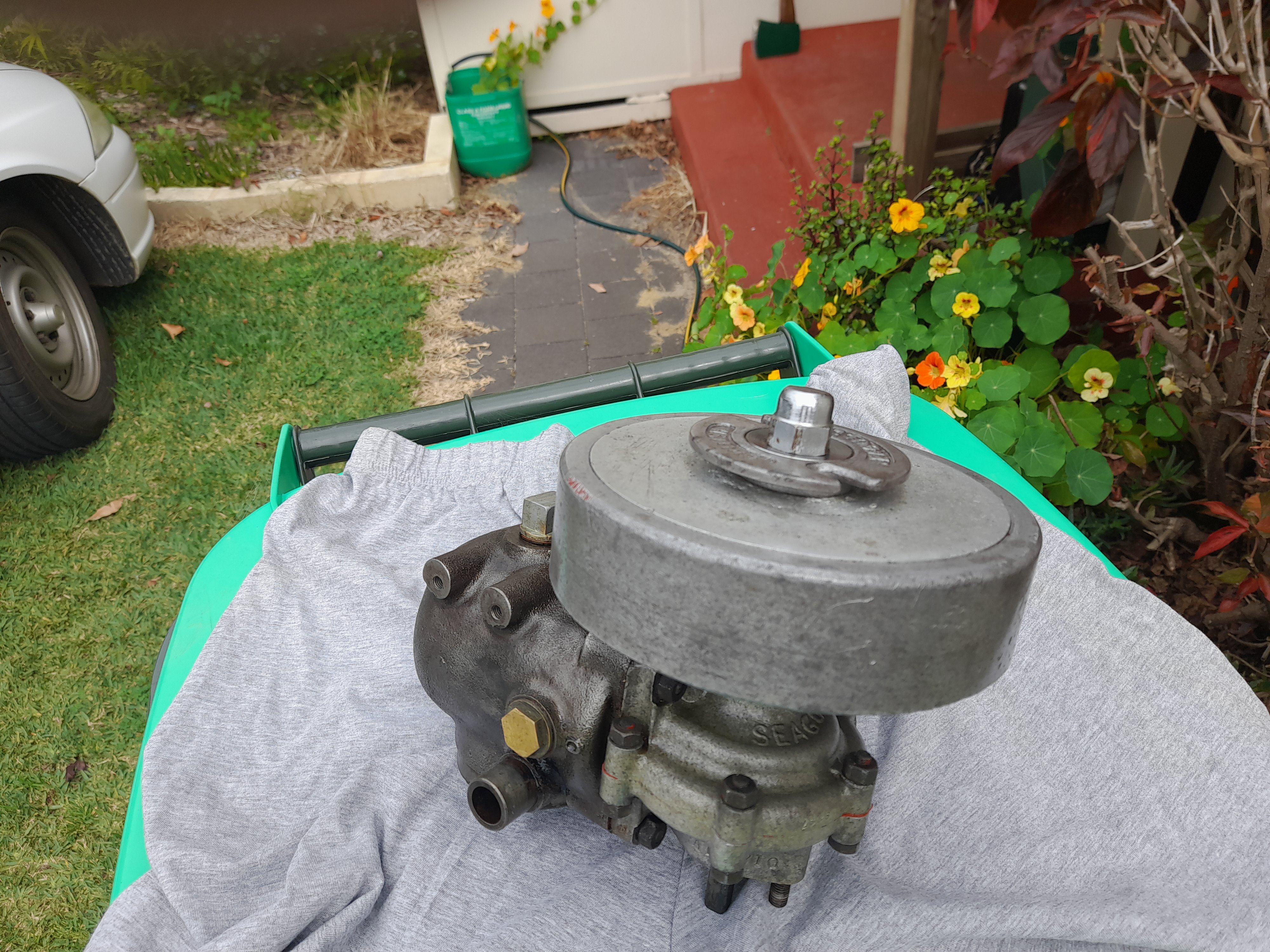

Coming along nicely.
andrew
Site Admin
Posts: 180
Location: ..
Re: AD2710
Post by andrew »
Looking very nice. A great feeling getting the power unit back together!

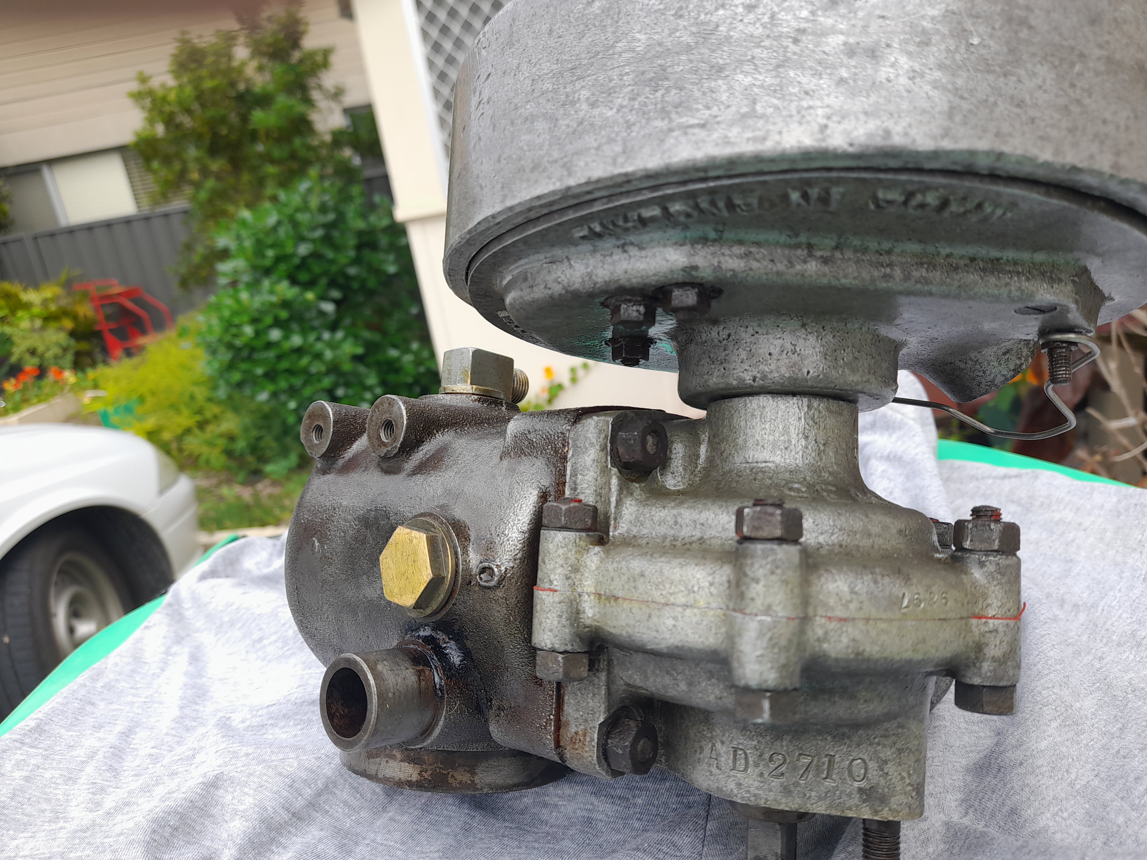

I see an upside-down 9897 stamp on the upper crankcase half. Not sure I’ve notice a stamp there before on other motors. Is this normal for the AD range and/or others produced around that time?
Posts: 4202
Re: AD2710
Not too sure that crankcase number but have seen similar random.
Usually a factory refurb job has matching stamps.....the gearbox has matching stamps.

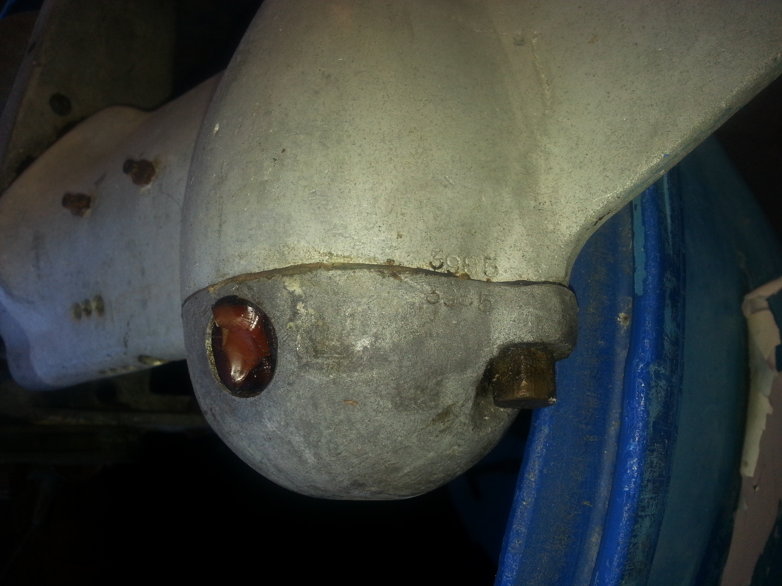

Edit; There is the same number of the cases on the prop......interesting.

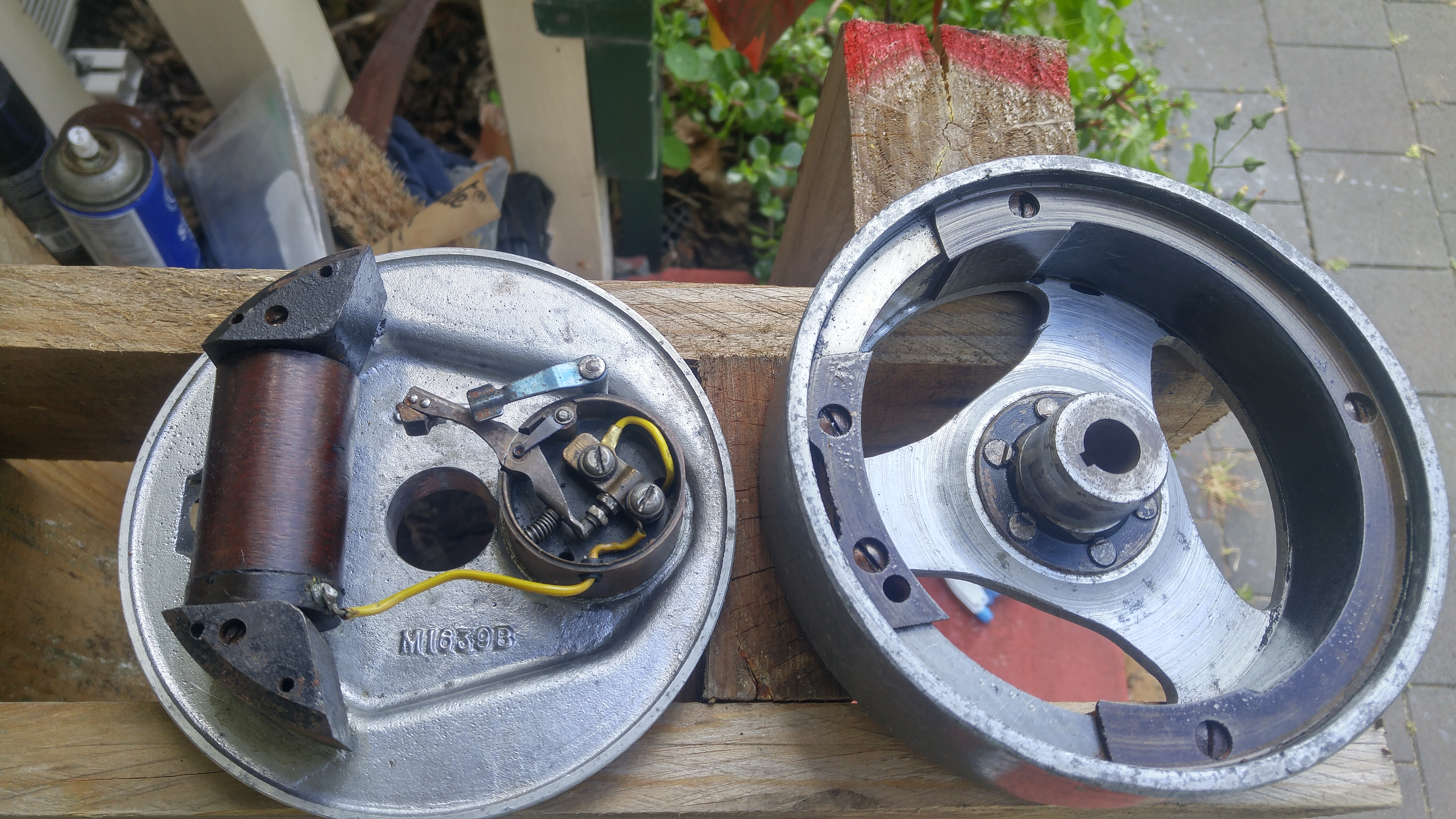

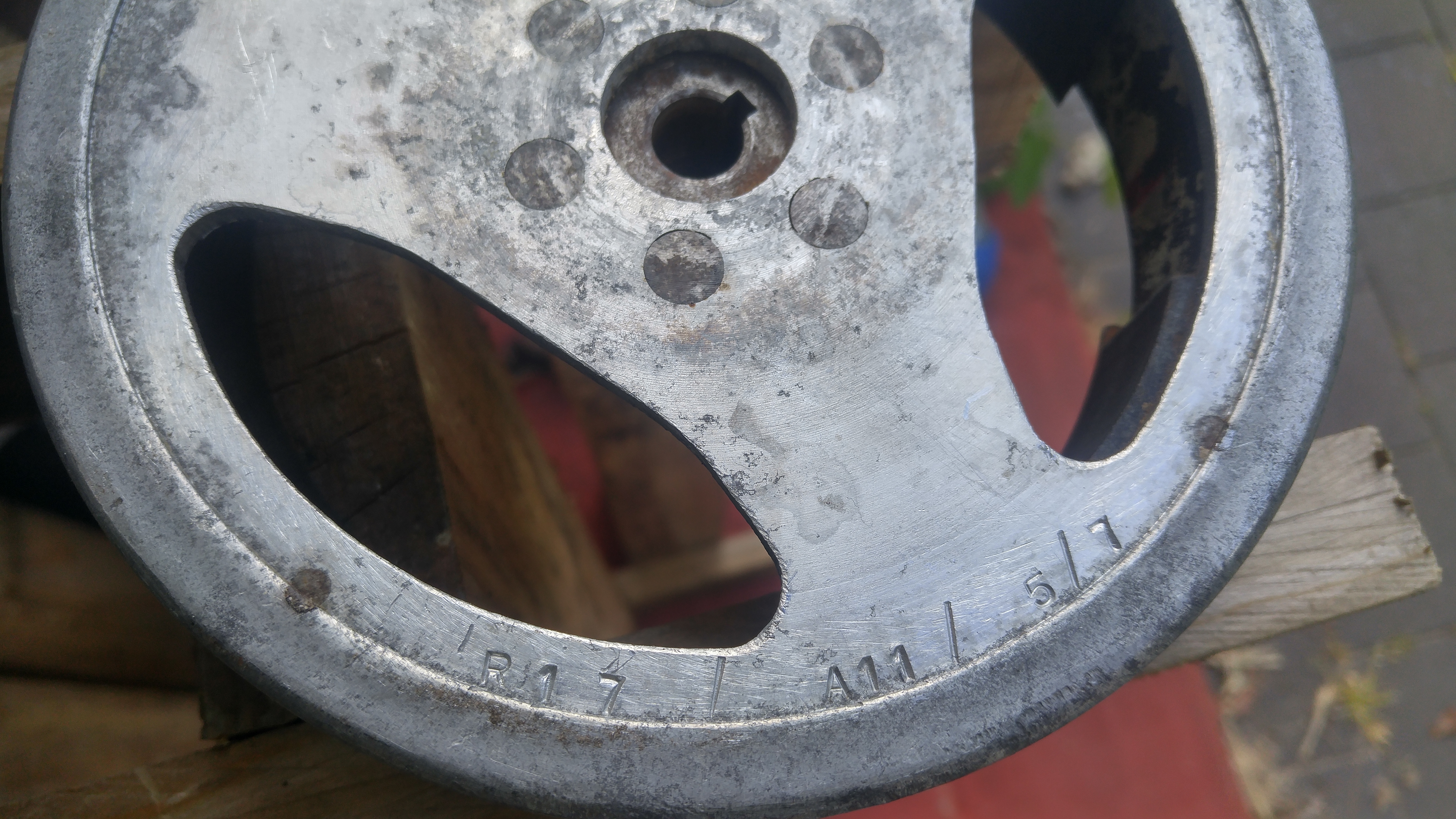

Re: AD2710
Continuation.
Starting to find a bit of "other's involvement". So far nothing of detriment.

Gearbox is very cool.
Bush in torque tube needs some attention however.
