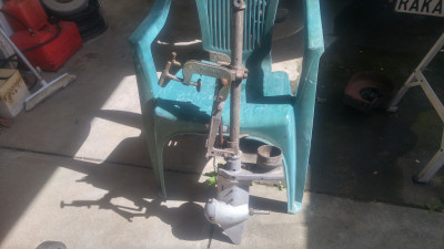

Which parts will you varnish? Casings, cylinder? Have never used varnish on a seagull but understand it can help protect their finish for quite some time.
- Posts: 4196
Re: AD2710
Well the whole thing actually.andrew wrote: Sun Aug 27, 2023 2:09 pm Looking good!
When I say varnish it is boiled linseed oil...old fashioned base for all sorts of paints and coatings with good reason.
I use BLO on old hand tools restoration. Wood handles and blades like axes, shovels etc etc.
When I say "oven" I do not mean bake the poor thing...just enough to form a skin of oil wiped on thinly with a rag. Below 120C. Drying not cooking aye. I have an electrical oven which is a drying heat...I have no idea about gas? Final hardness in sunshine (yes Perth is getting some now). Another light applications over say twice in 6 months should protect from anything except my local council but that is off topic
The finish is a satin look. Too thick and gets patchy glossy.
Just a wee bit every now and again.
This use of BLO is for something that should be preserved as a well cared for survivor.
Then again each to their own. I have done "shiny restos" before.

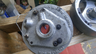

Somewhat different?
Seen these come thru occasionally. It works aye.

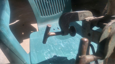

The hard bits about to be attended to. Wash down with ATF and kerosene. then a couple of towels soaked in same and into a black plastic Sulo Bin liner.
Leave in increasing sunshine for a week, maybe two, and apart it will be.
The transom clamps will be brought back to dogleg with some reverse brazing after that.
Having fun aye.
Having fun aye.

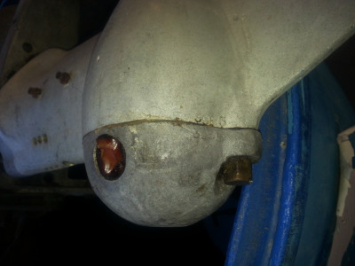

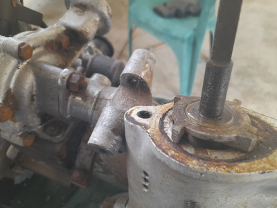

Nearly forgot... The white bush (or something) staring me in the face.
All coming apart soon for inspection and will find out I expect.
Any info appreciated in the short term.
Re: AD2710
Interesting! Wonder if just a spacer added at some point? To what end no idea.

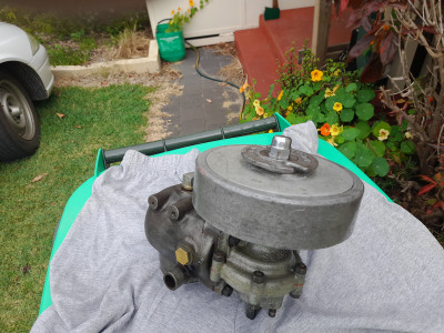

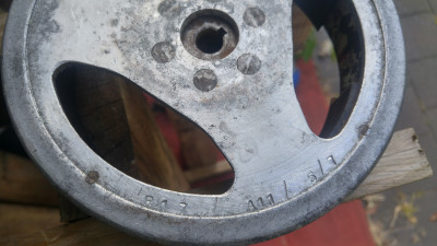

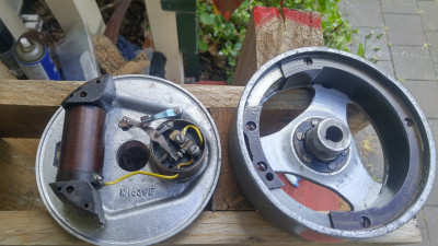

Looking very nice. A great feeling getting the power unit back together!
I see an upside-down 9897 stamp on the upper crankcase half. Not sure I’ve notice a stamp there before on other motors. Is this normal for the AD range and/or others produced around that time?
- Posts: 4196
Re: AD2710
Not too sure that crankcase number but have seen similar random.
Usually a factory refurb job has matching stamps.....the gearbox has matching stamps.
Edit; There is the same number of the cases on the prop......interesting.

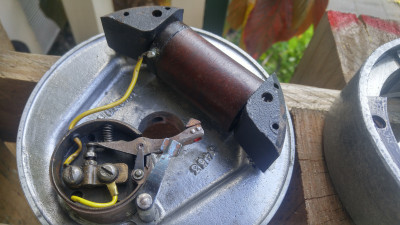

Continuation.
Starting to find a bit of "other's involvement". So far nothing of detriment.
Somethings you just can not unsee however.....is that proper English...sounds wrong but never mind.

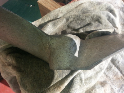

How interesting looking into gearbox...
BnS
BnS
- Posts: 4196
Re: AD2710
Gearbox is very cool.
Bush in torque tube needs some attention however.
