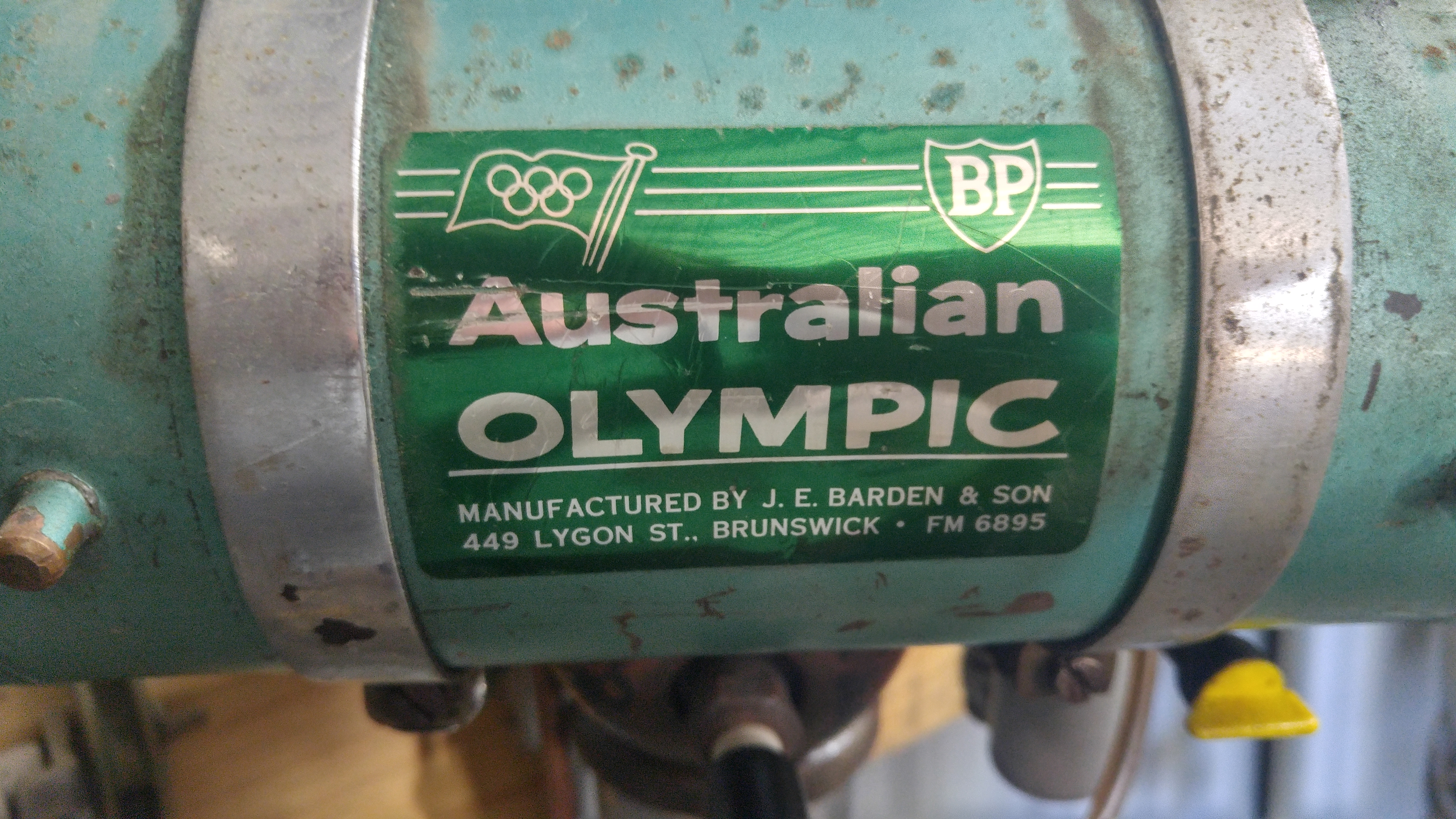

Are the fuel tank and tiller arm on your "Tiller" Light Blue or Light Green? I am seeing different colors depending on lighting conditions.
For the record, I have noted a mix of Light Blue and Yellow on the drive shaft from # 103 and am wondering if the Light Blue might be same as that on your Tiller. I need a reference to color match.
Also, if you could you please confirm whether the crank case assembly, water-pump housing, gearbox and propeller on your Tiller are painted a light silver hammertone, that would be appreciated.
And finally, dimensions for the decals please. I am speculating same widths, different heights (mm).
Thanks in advance.

Braved the red-backs and the smell of mice! I will shut Cello in the back shed overnight with a bowl of water and no dinner. No litter tray either because that will piss her right off........goodby rodents.
OK
Main Tank Sticker is 85 x 57mm.
Lubrication sticker is 84 x 32mm
I had a good look for an engine number (or any number at all) and nothing.
The cases, gearbox and pump housing have no paint at all. Bare cast aluminium. The gear box and pump housing have been linished but not looking "Polished" sort of deal. The transom clamps have frosted over bronze.
The colour is indeed Green under which has the yellow primer we all know so well.
There is the usual red lead primer under black on the barrel..........No sign of any plating.
