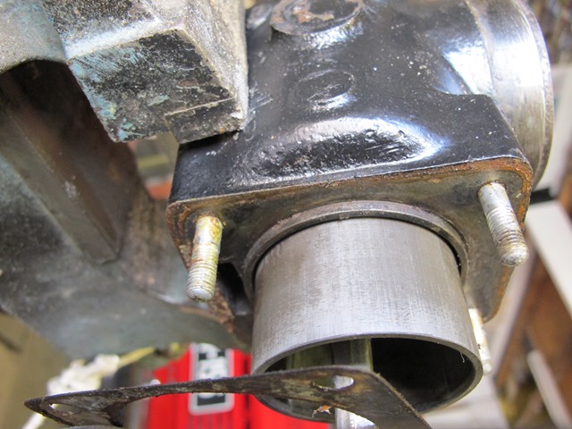

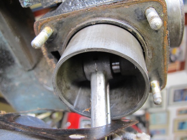

With the gasket pulled out of the way the block can be viewed, I see no sign of a crack, the piston has stuck though and I cannot move it further out of the bore.
Some heat on the block may be required?
This motor did not need cleaning, the alloy and the black paint on the block look really good.
Whats, next, this is my first Seagull piston removal ( attempt )

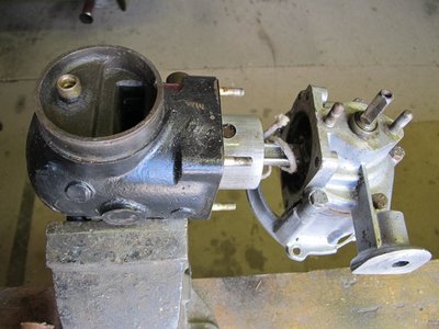

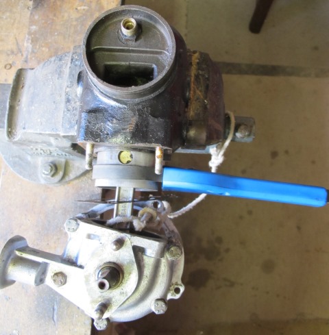

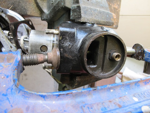

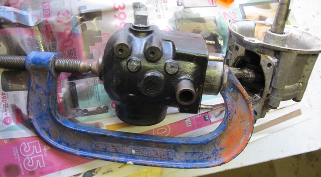

Moving the piston back in required the use of a large G clamp, even then it was tight, it slackened off as the piston reached the top.
I may be able to fashion a press tool using the thread in the plug hole?
The assembly i.s now back in the vice and I have used the soft obeche wood tool to knock the piston back down.
It will be possible to place a protection pad down the exhaust and on to the top of the piston to prevent damage?

If I could remove the pin in the piston I would but the piston needs to come out another 3mm to allow me to do that.
I prodded up the exhaust but felt nothing stuck in there.

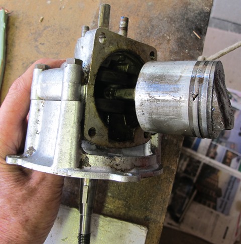

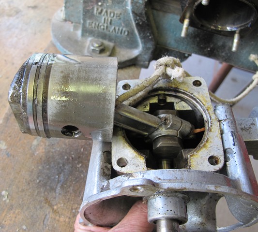

I have removed the piston, it was not any easy job, I will post the pictures in the morning :P

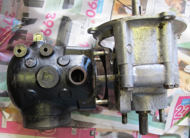

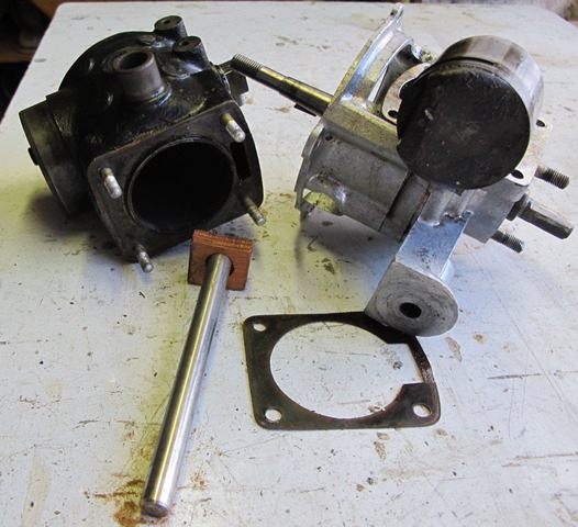

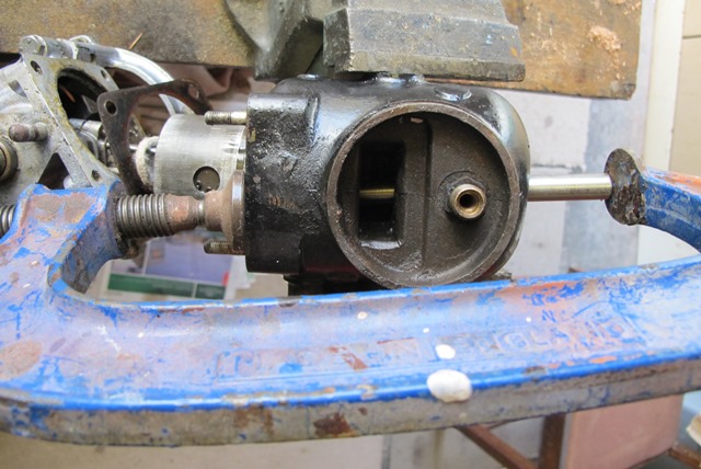

It was clear to me that only a controled physical force would move the piston, banging the top of the piston with a rod and a hammer would break the piston?
I used a piece of plywood with a socket hole in it as the cushion pad on top of the piston, then a 13mm 316 stainless steel rod as the pressing tool, the G clamp was the required pressure I needed.
It still took a fair amount of winding up the G clamp, far more than I expected?
Then right at the end of the process out it popped, the line that was tied around the con rod stopped the piston assembly from falling on the floor.

The rings are the problem, I still need to remove them and test the bare piston on the bore, a spare piston I have slides in easy enough.
I had worried that the bore was a taper? wedge shaped, open at the top anc closed at the bottom, how I could not work out?
The spare piston I have slides in with ease, so I guess I am ok?

The small plywood push pad worked a treat !
I used a flat bit drill 15mm in size and removed a 3mm section of the ply to give me a socket that the stainless steel push rod would locate in.
