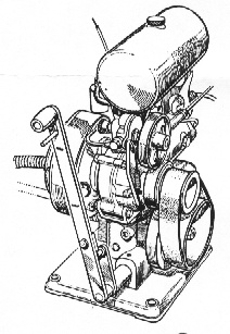

Inboard motor. How extremely interesting Keith.
I knew that it must be Anzani because of the crank build. The cranks are made by JAP for British Anzani.......with J.A.P. ground from one side of the rod. 99% were anyway.
The other taper indicated some form of put put or similar power coupling end.......starter or chain assy etc. That stumped me. Well done.
SOS has an advert for one with a belt drive.......once I committed to googling just now. 8)
Extremely impressed that you are working an inboard Aye.

Its no actually that model, the one I have has a, or should I say had a square fuel tank and the exhaust above the cylinder, not below like this model, the one I have is from around 1953, I believe that picture is from 1951.

The only 'outboard' that I've seen with a double tapered crank like that is the Tas / Sea Hawk. The upper taper is of course for the flywheel magneto. The lower taper is for the cooling fan which blows air from the underside of the cylinder, ducted for improved efficiency via a fan cowl assembly.
From what i understand, double tapers like that are not uncommon on stationary engines.
