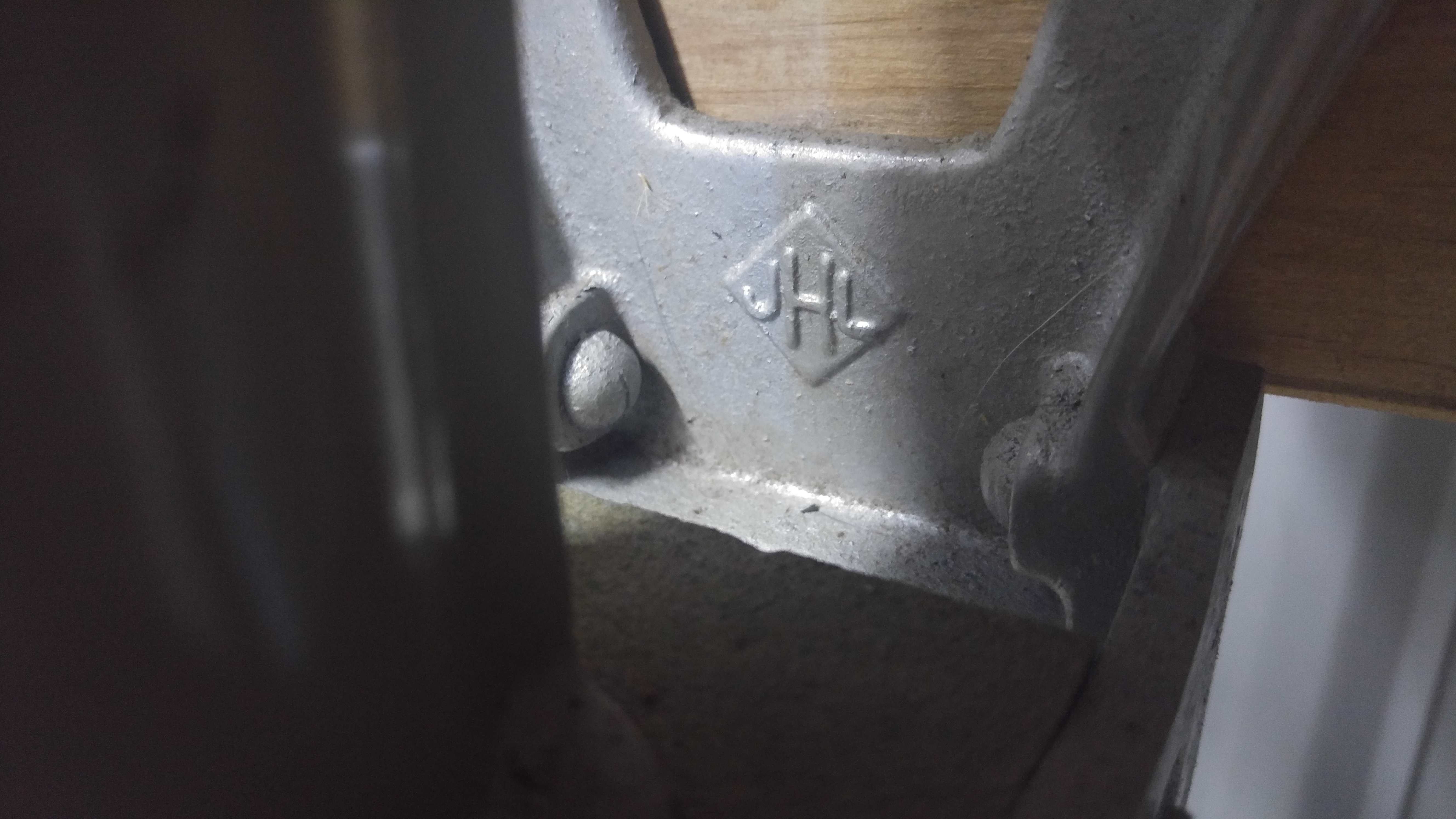

Stripping an old engine down today, pretty simple I thought, Now which end had a flywheel on I wonder. :oops:
Lucky enough I didn't remove the piston, as it only goes one way up, both crank ends have a keyway, but 180 degrees out.

Looks like that was made by JAP?
Re: New project.
It could be, but its not, I will give you a clue, JHL.
Re: New project.
When you zoom right in there are not many clues, Hepolite deflector piston, steel conrod, big end pin threaded/bolted in, so the chances are it's English & it might just be older than it's owner.

J.H.L. is for the foundry parts. They are still in business.
This cast mark appears on other outboard brands as well.
The only thing I can not place is a double end taper.......
An I said that the CRANK assy looks like J.A.P.

No it's not a jap, what other brands have that foundry mark, other then Jap, Bruce?

Keith.P wrote:No it's not a jap, what other brands have that foundry mark, other then Jap, Bruce?
No not a Ferrier, even though I do have one or two.
Anzani have that foundry mark for one.
I did not, once again, say it was a JAP. Just the crankshaft kit may well be. In saying that, please post pics both sides of rod for me?
