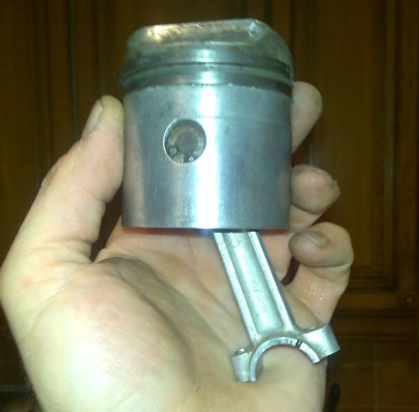

1952/53, that's as close as it gets. My guess based on the number being late in the series (same as you probably) is 53,
Make sure you get the rings quite clear of muck.

It is a runner
, power head done. now time for the polishing, painting, panel beating.
She will go to the race (if enough time for Thames trials, to make sure it is reliable)
Has any one made brass split pins, or are they readily available?
The gods of piston freeing were on my side.
P.S. will now see how easy or hard it is to get the ends off a 102 tank.
Will post video on Youtube next to my fantastically popular first video(watched by 121 people) what it is to have such a niche interest.

Running but have found a few probs, on closer inspection crank bearings will need replacing (hope John has some).
Can't see that they will be hard to change, turn up a stepped drift knock them out, knock new ones in ream job done.
Anyone know what size reamer to use (crank dia +)?
Also have noticed that the back plate has been slightly distorted, probably someone tried using a screwdriver to lever off the fly wheel.
Will mount on a piece of bar in lathe and try to straighten it up a bit with a rubber hammer.
The spark is good, strong and blue, but when spun up with a drill you can see it is a bit hit and miss. With backplate distortion and worn crank bearings the points housing just touches the flywheel, would this contact be enough to upset the spark?
Have checked compression, it is about 55 P.S.I, Is that normal ? look like it is a bit low to me.
Thanks
Thanks
