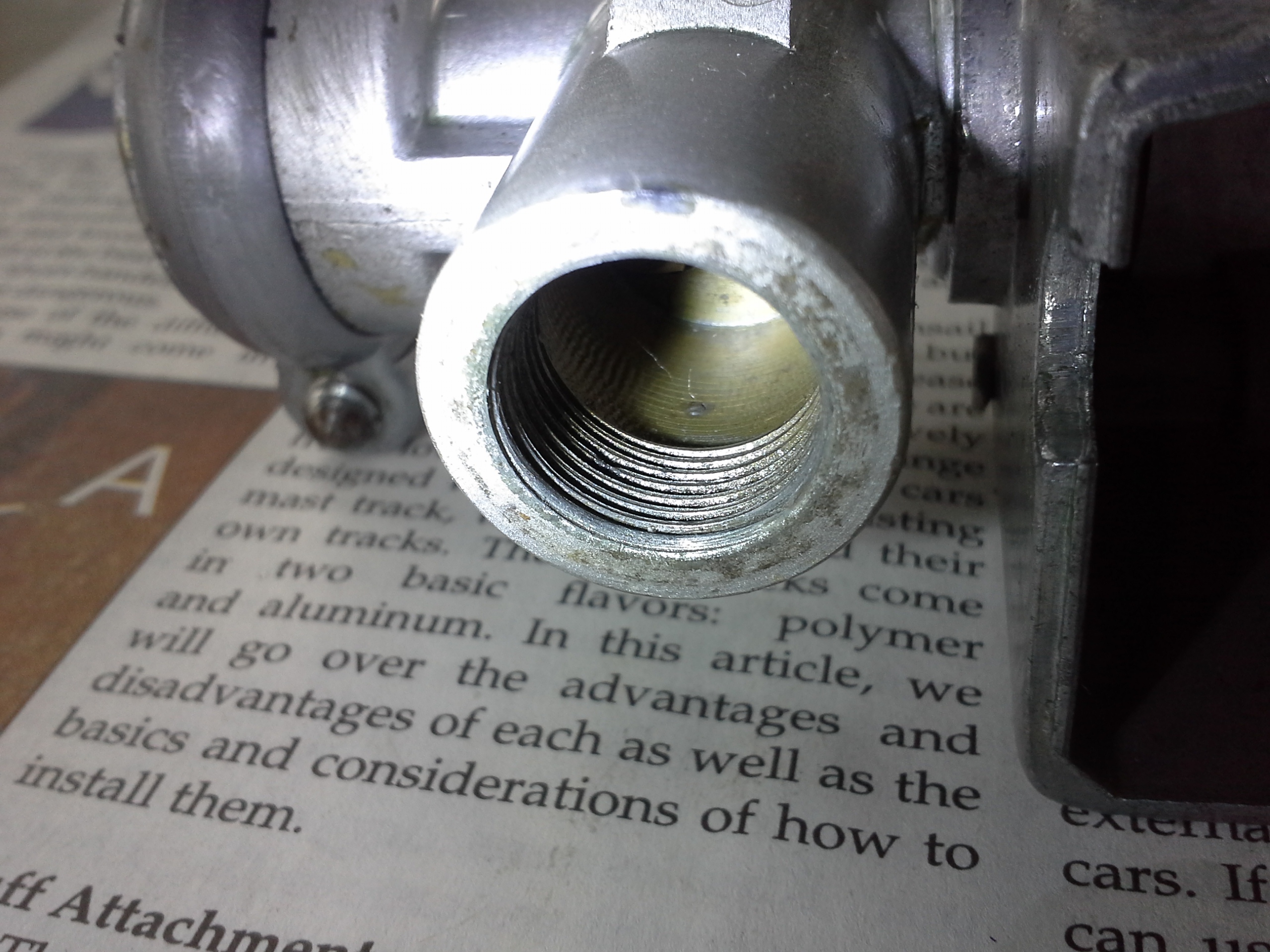

I've had 2 over the years that came to me for thread repair inserts, I machined, tapped & fixed the inserts only to find that when I went to machine the protruding insert & corroded throttle slide base, the base of the throttle slide body had been raised so the banjo bolt could reach the last of the threads, one I managed to repair with Loctite Hysol 615 epoxy & one was scrap, a lot of work to throw something away.

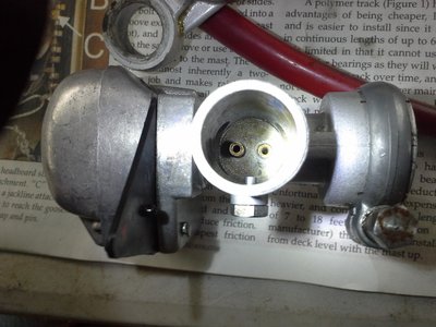

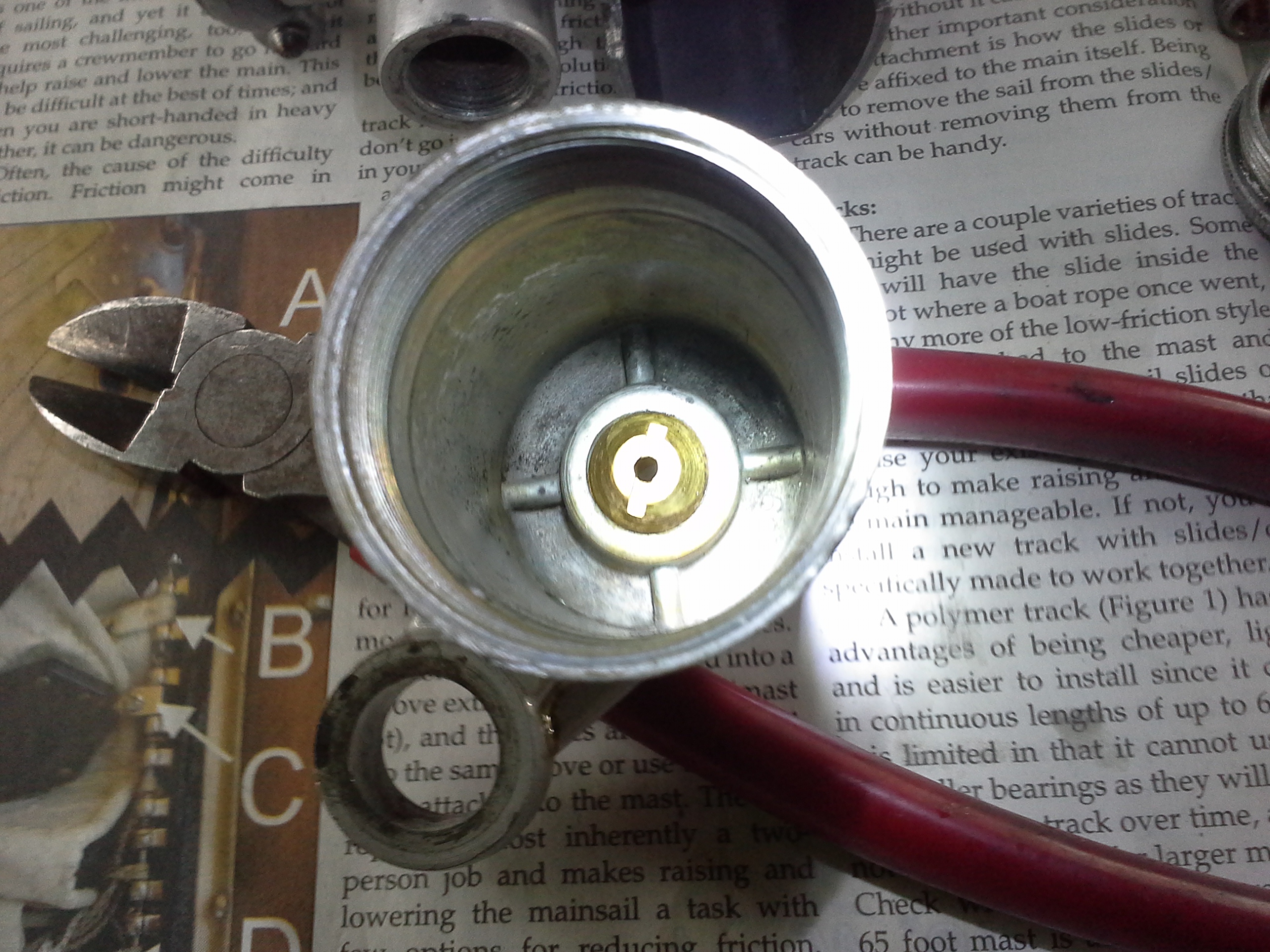

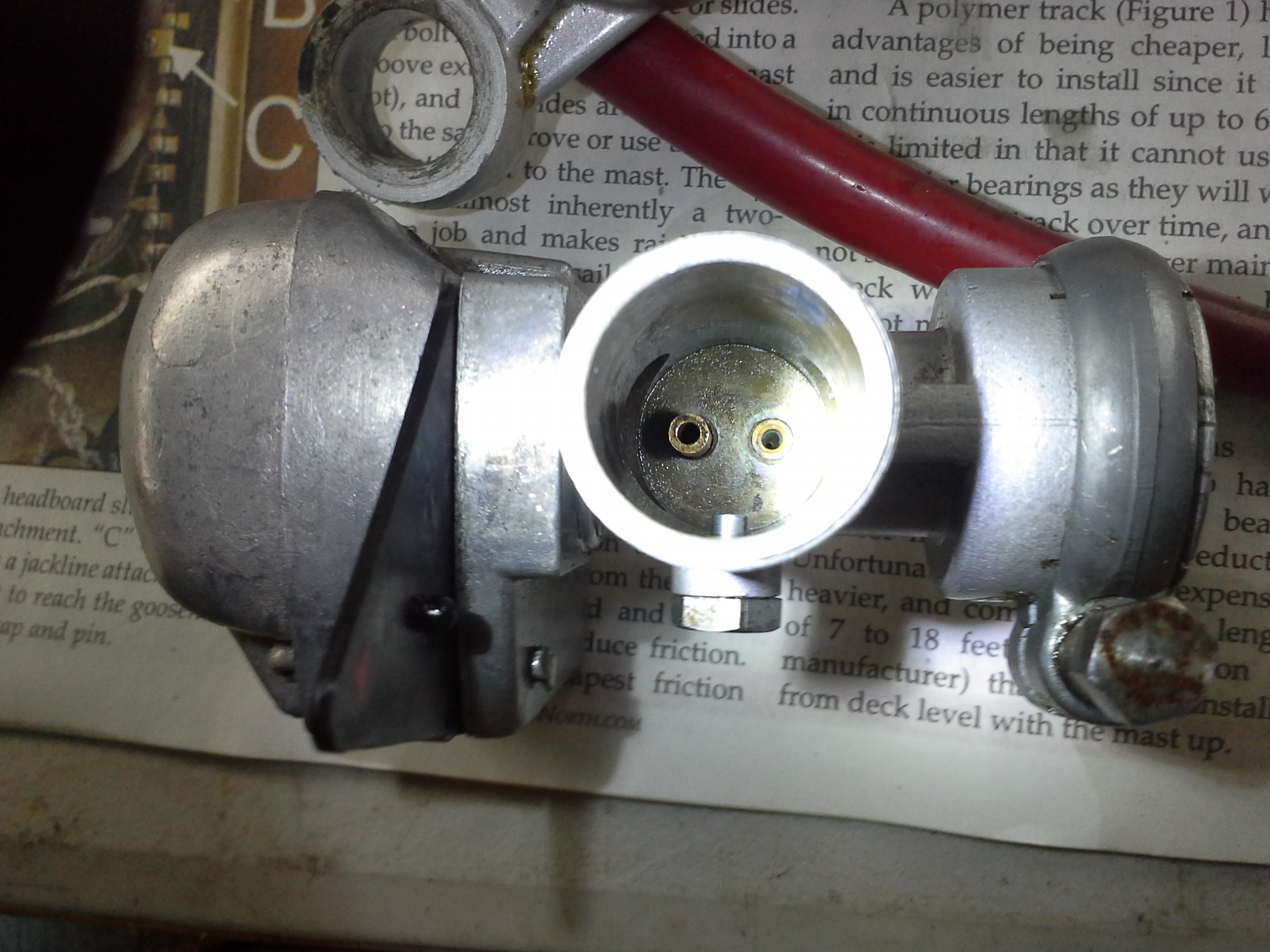

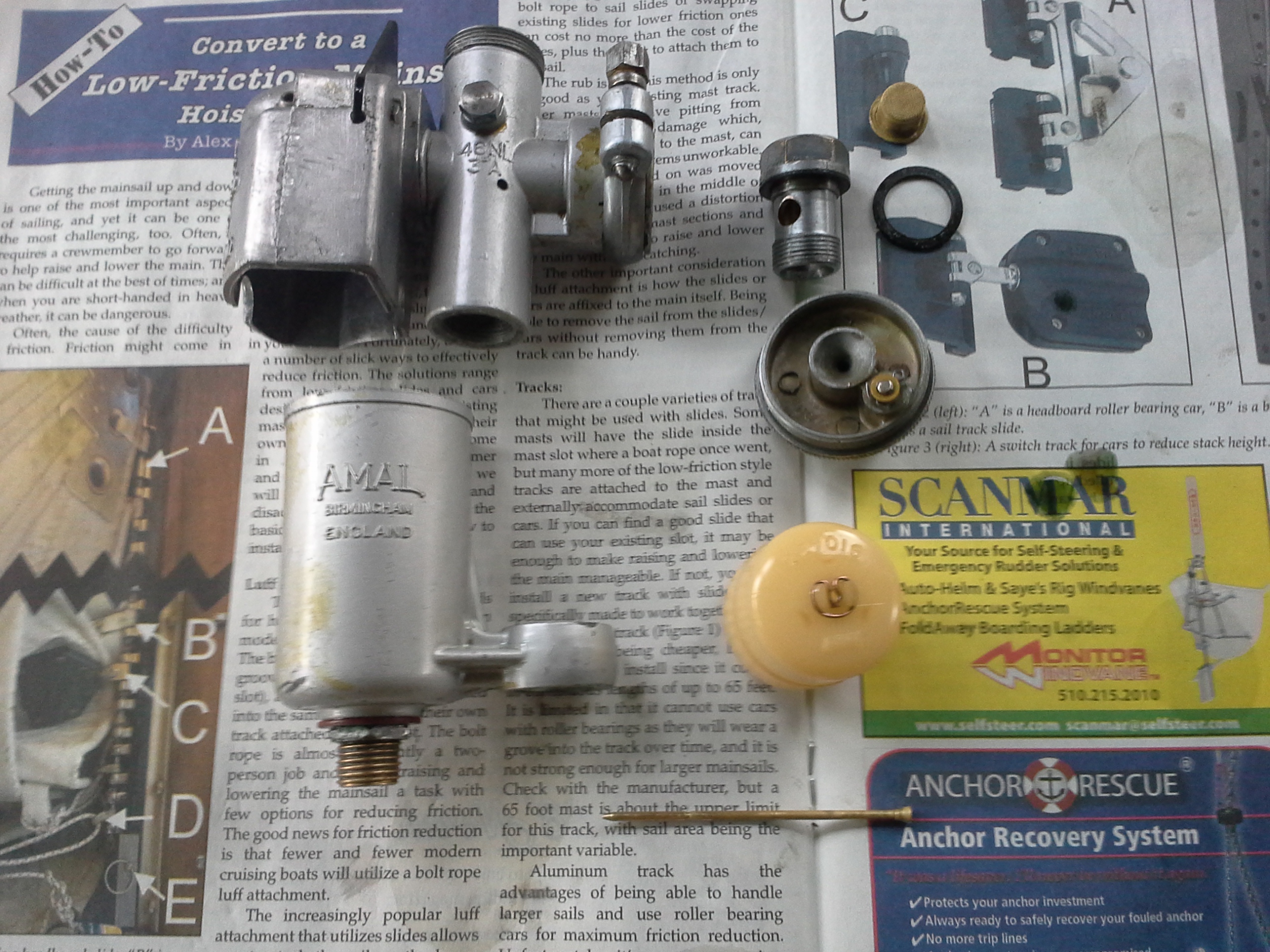

Have it apart again, here's a couple of pics. The darn thing shows no evidence of being cobbled-up or even rough use. As you can see, threads, etc look good. I apply a very small amount of "EZ Turn" fuel resistant lubricant to the threads as well. It's kind of an old-school slightly waxy grease that seals and protects threads, use it in aviation, especially the old stuff.

How many banjo bolt fibre washers can I see in your picture?
1 above & 1 below, float chamber banjo.
Carb looks perfect!
Can you measure the thickness of your fibre washer? (Seagull ones are normally red).

I see 2 BLACK washers, 1 above and 1 below at the banjo bolt. (they're not rubber are they?)
I concur that seagull ones are normally red in colour, but.....

It's the thickness that's important Jon, as the level in the float chamber is exactly the same on the jet, raise that level & the venturi effect from the passing airflow over the emulsion tube, portion of the power jet will suck more fuel or less if you lower it!
Even you, the resident carb expert will agree that carb looks to be in very nice condition!

There's two...in the picture one is still on the banjo bolt.
Both black washers on the banjo bolt are fibre, measure .034" and .036" thick and are of the proper id and od.
Additionally, there's a red fibre washer under the locknut on the bottom of the float chamber that measures .032" in thickness.
