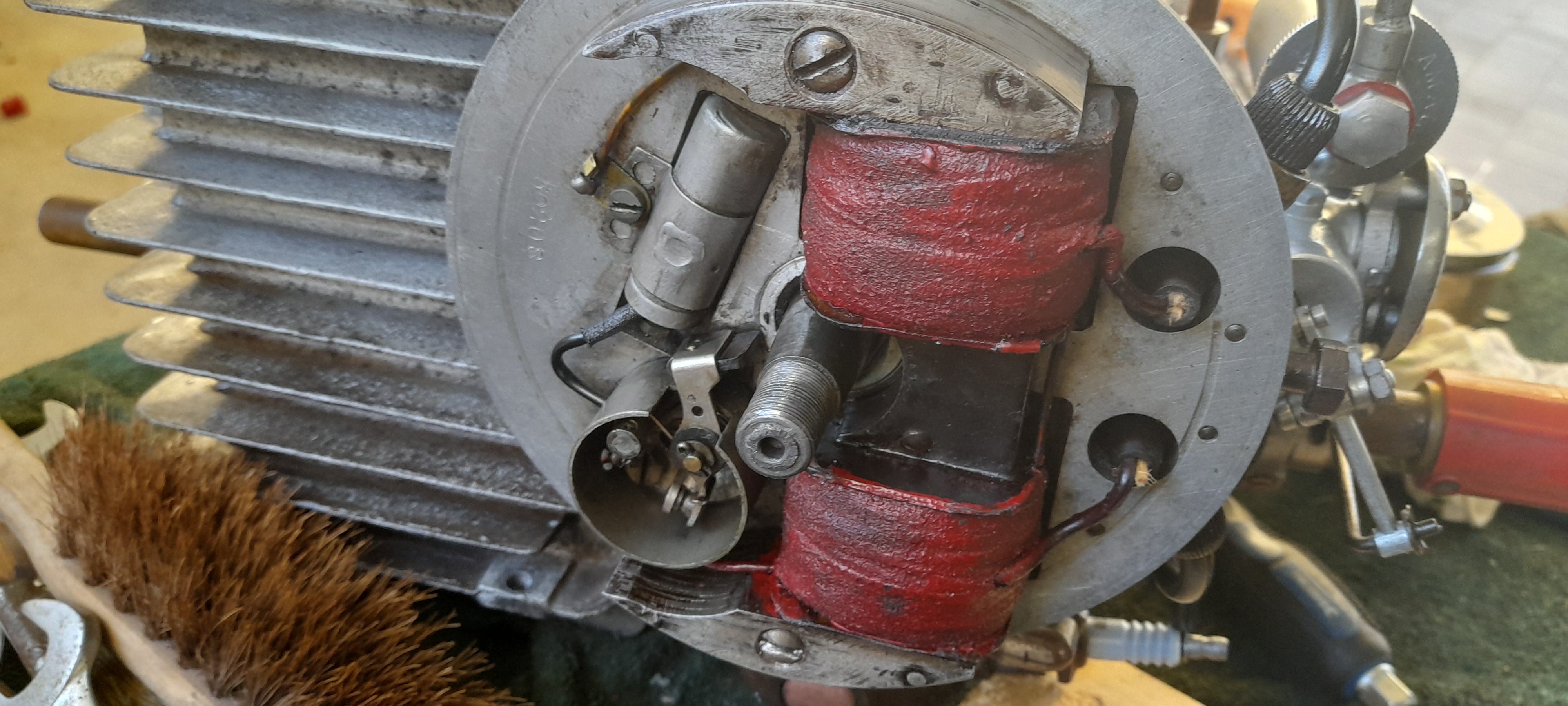

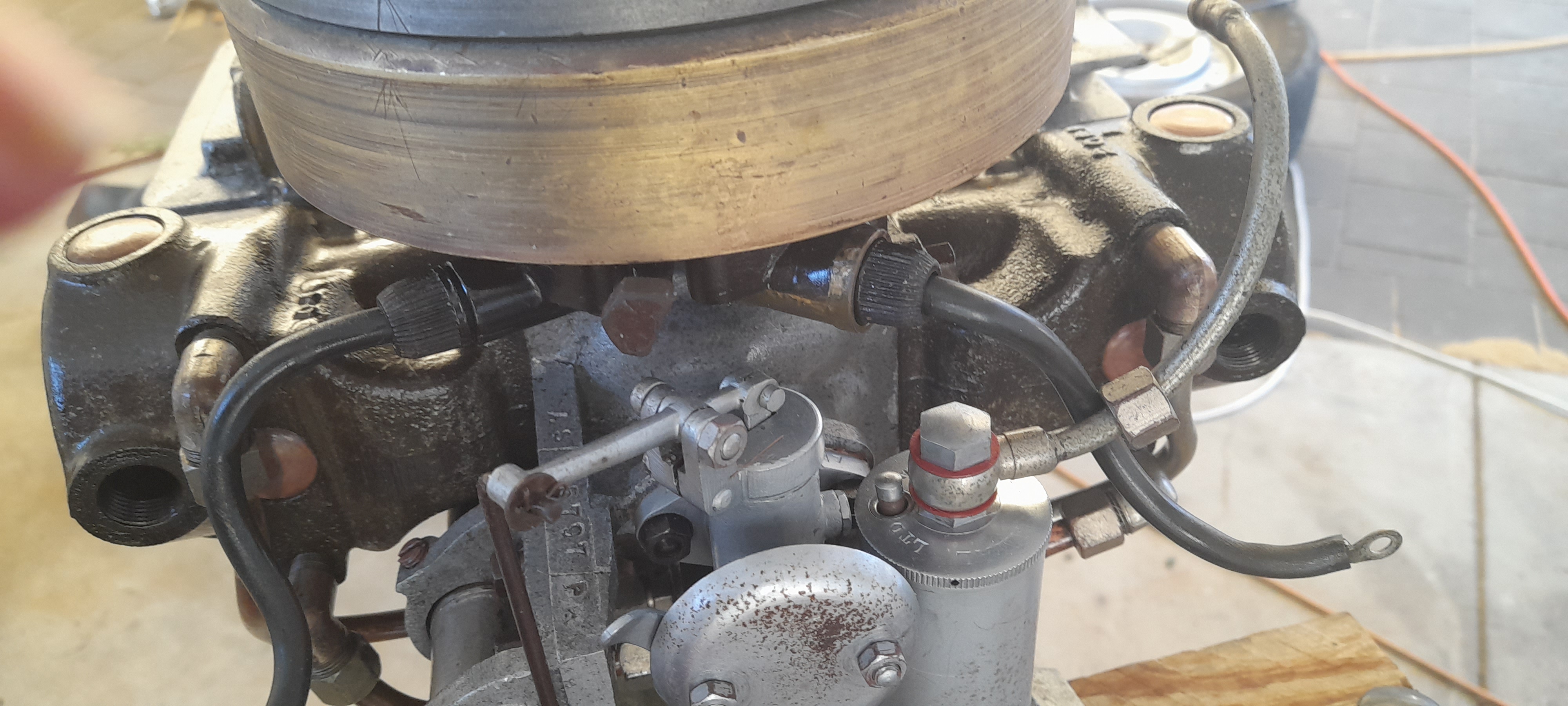

Has been under my workbench for bloody years........Between projects so decided to show some love and clean it up.
Really easy but consuming doing a gentle freshen up. Everything works so basically a service as well......and paint the tank.....
Some Pics (You all love pics aye)

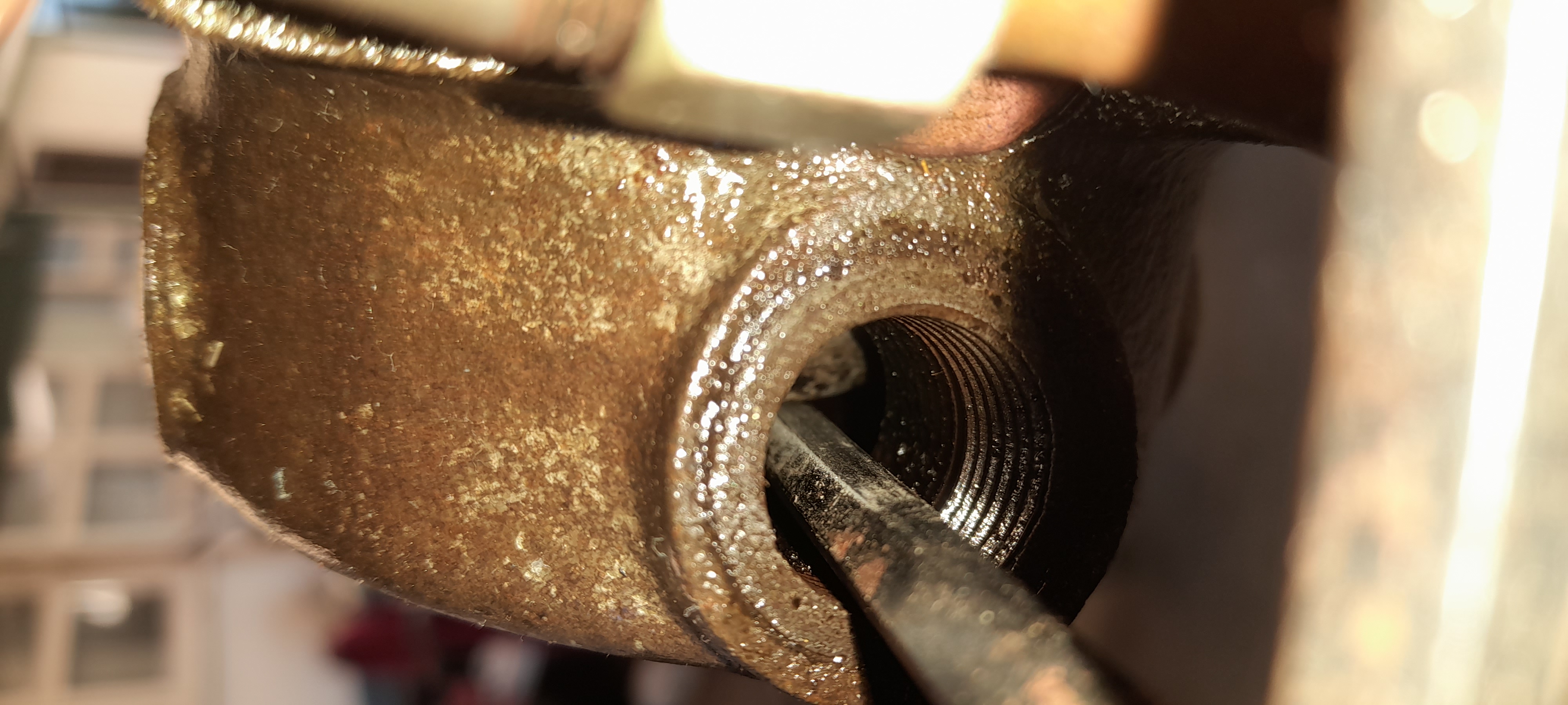

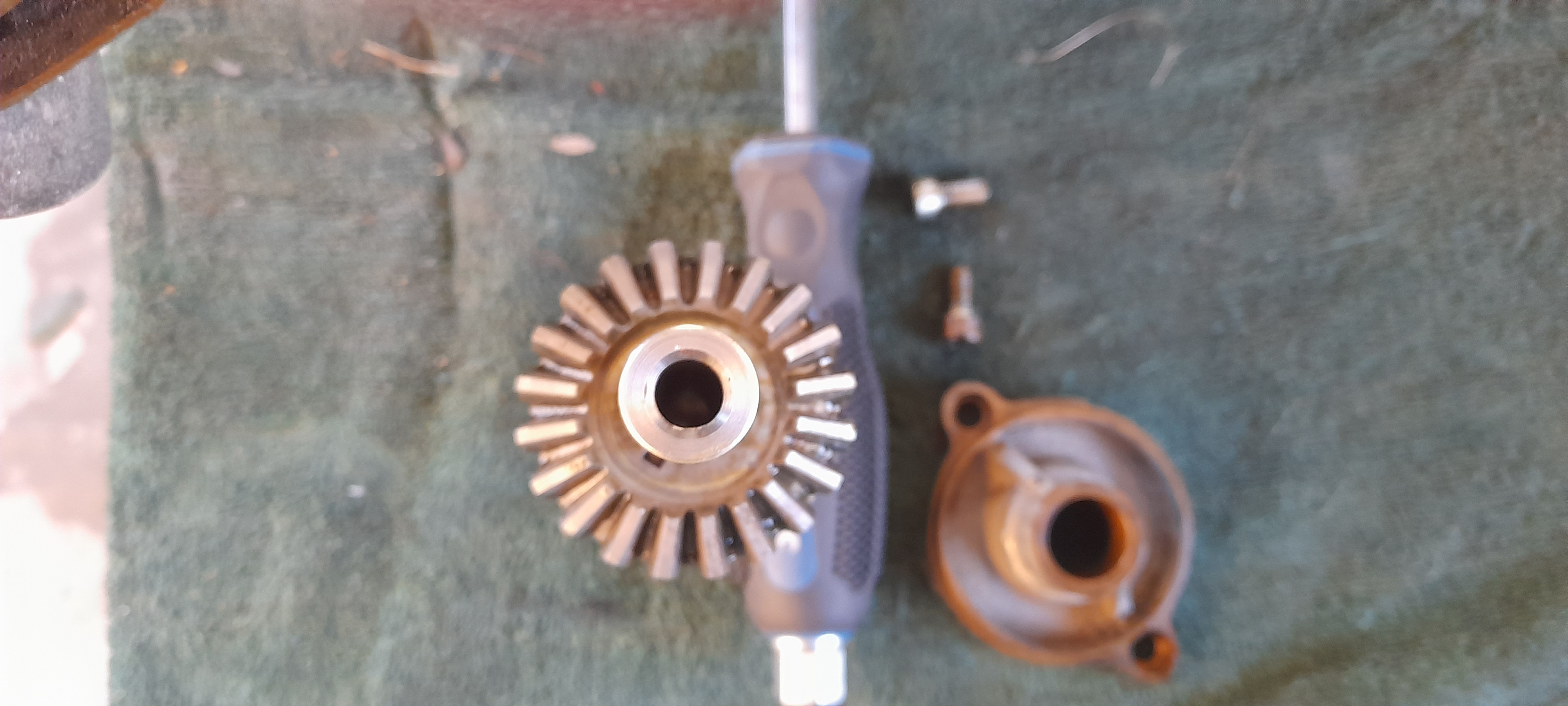

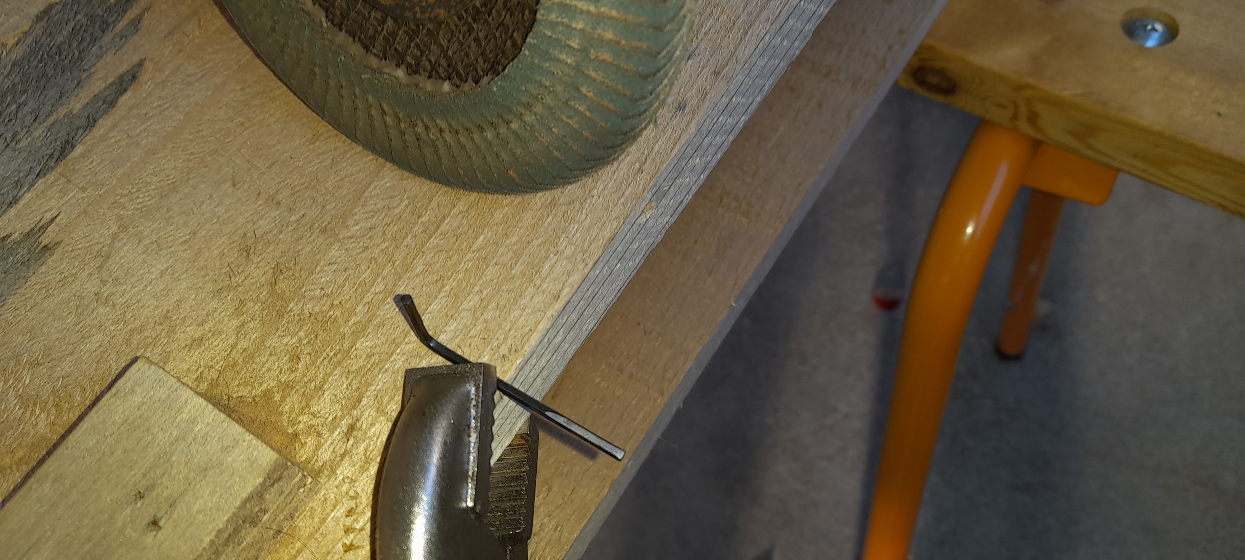

And.....maintaining momentum. Grease gearbox.
There is a detail pic of key replacement of gear pin. The pin went through the water gallery....easily blocked.
Also see seal ring on new shaft. Very clever......I think something like a steam/lubricant concept?

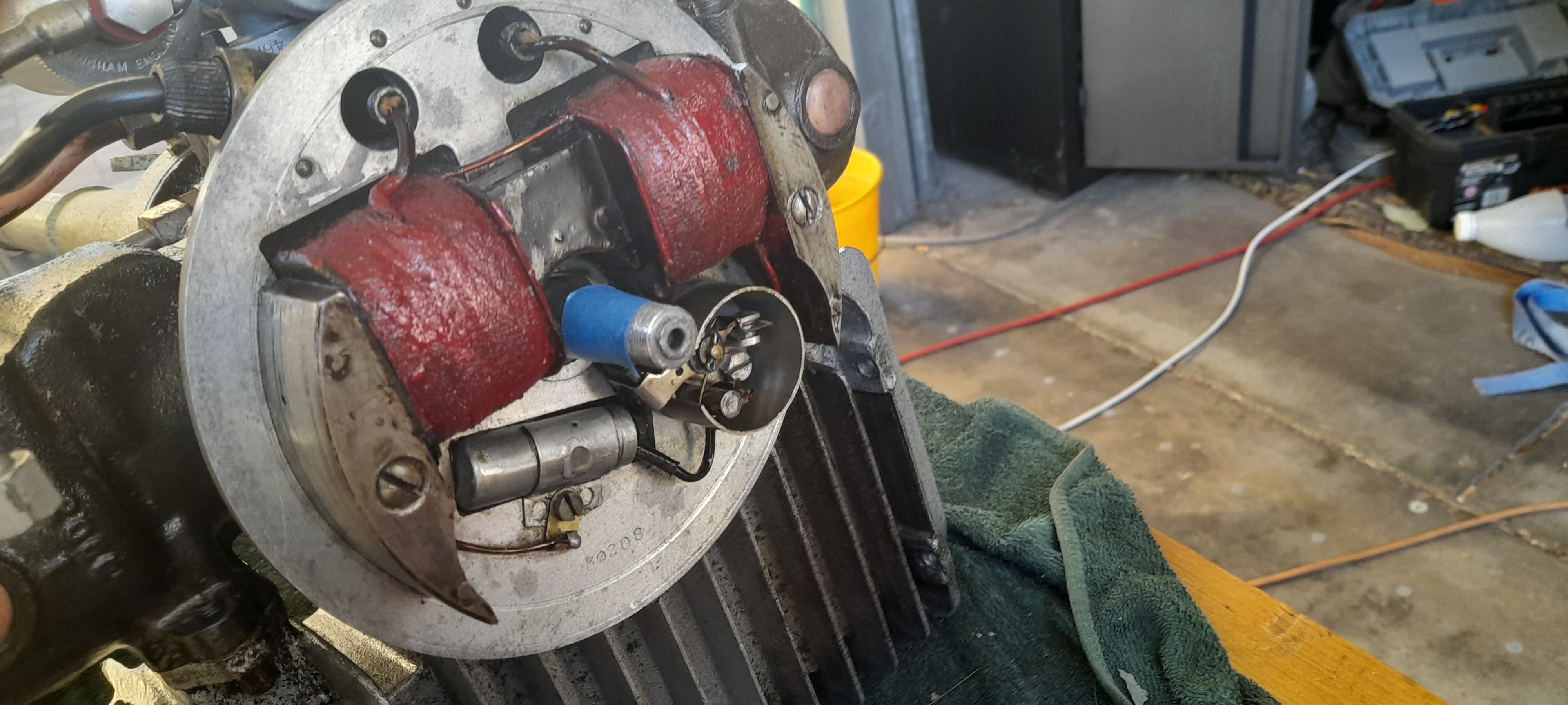

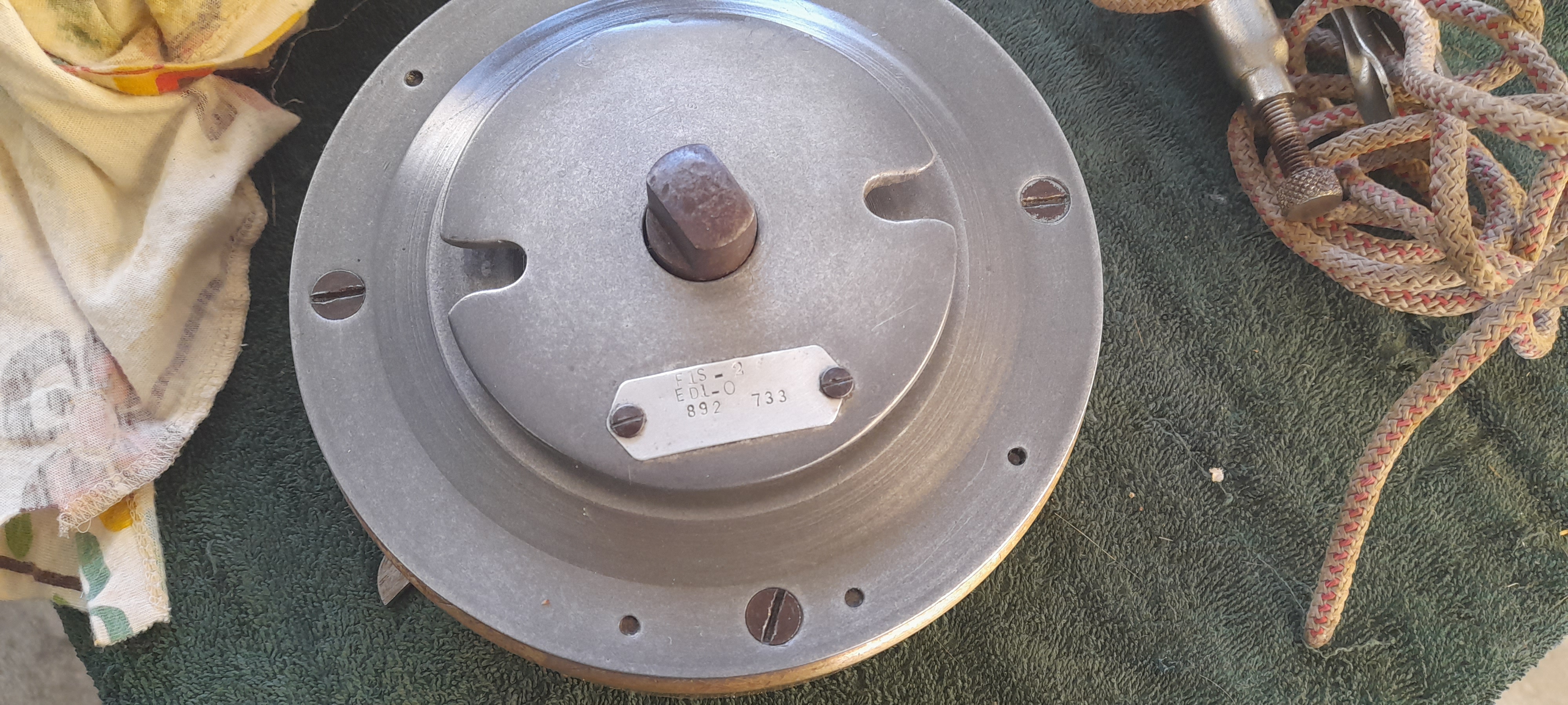

Ok, magneto done.
Next thing is to mix fuel and drown it for an internal soaking....going to be messy when I put it on a trolly.
1/4 pint to the gallon straight SAE 30 mineral oil...it has never run with modern two stroke so why change.

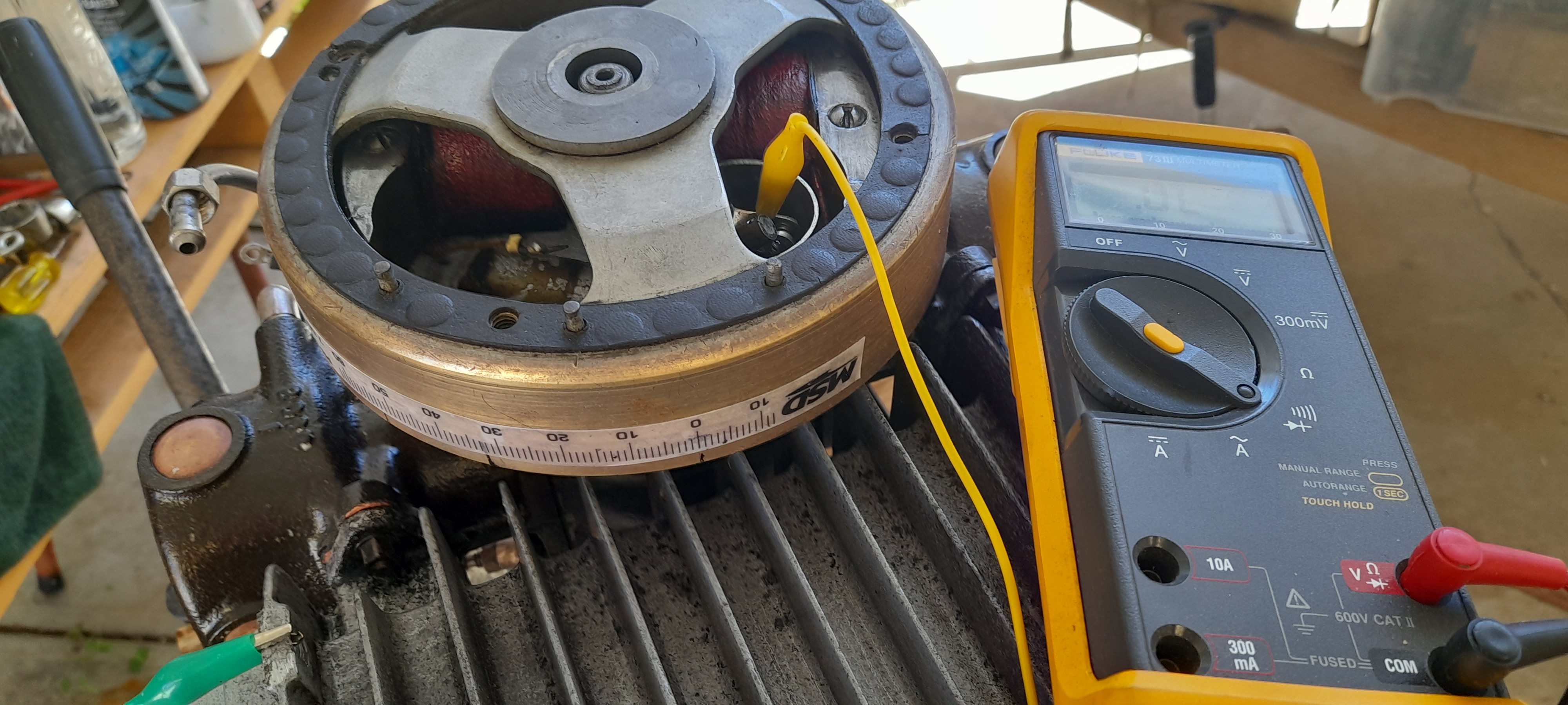

Now for the really fun bit....Ignition timing.
PART ONE:
Apply a 7" diameter tape to flywheel. By my mark 4mm (5/32) BTDC is 32 Deg.
Fit to motor.
Isolate points and check condensor...usual value used on everything. Being so old I will not trust it in the middle of The Indian Ocean though.
I checked the timing as found. 52 Deg....WOW no wonder it ran ragged last time Mike used it. Very hard to start and sounded unhappy. Also would not run with the exhaust bypass closed. The isolated points with a multimeter (Beep setting) to confirm that. The point gap was totally out there as well.
See part 2 below for the rest...

Ignition timing.
PART TWO:
Fiddled about for ten minutes. The base plate would not centre around the top of the carby which puzzled me....no good. I have no idea and, never played with one of these before so I went backwards. Can anyone tell me the maker of this?
I turned to the 32 Deg mark after centering the plate close to over the carb. That is where the points should open. So adjusting the points to just open and locking off.....ended up at exactly 0.020". No real surprise really. In doing it backwards both the backing plate is in a reasonable position and the timing is set.
So...the timing is correct, the point gap is correct and the piston BTDC is correct.
Every component is in outstanding condition so seamless and smooth adjustments really helped.
