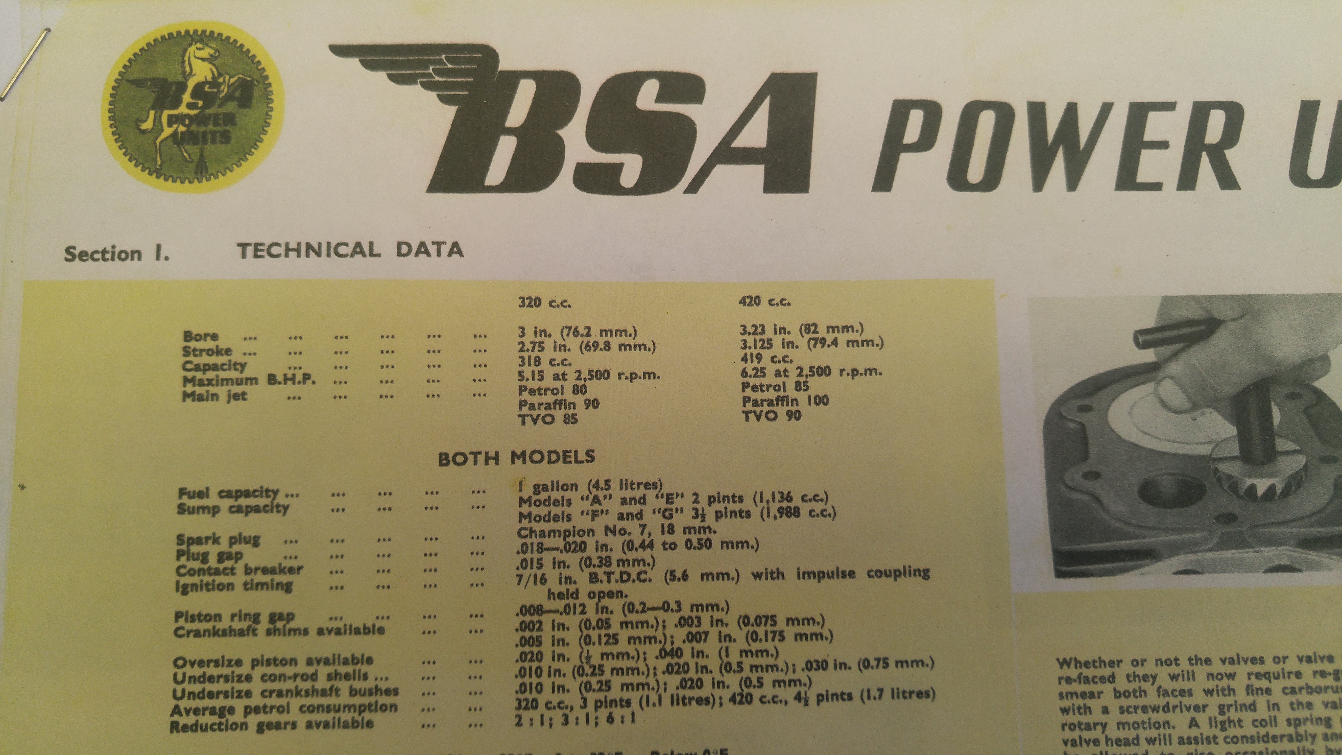

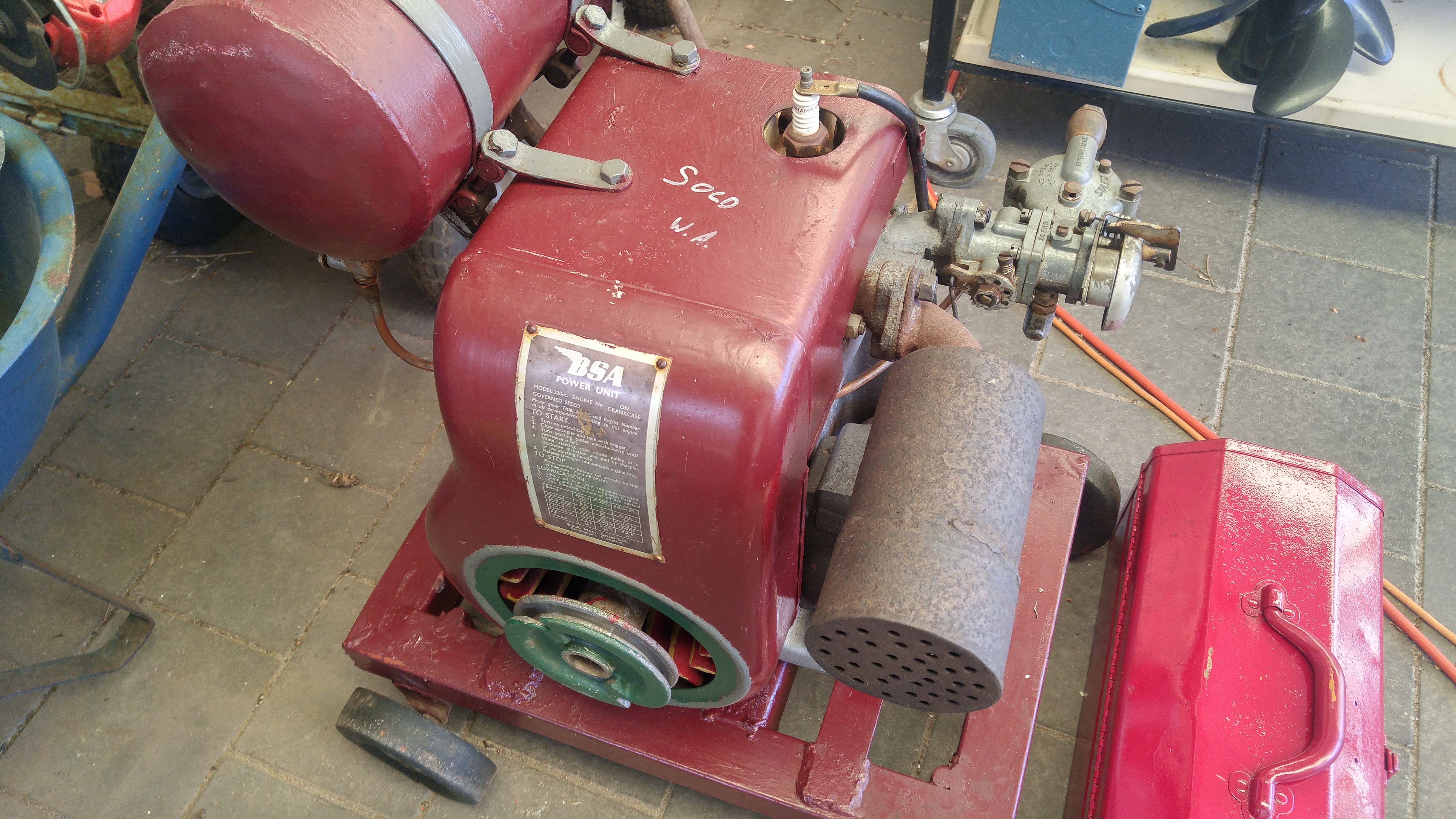

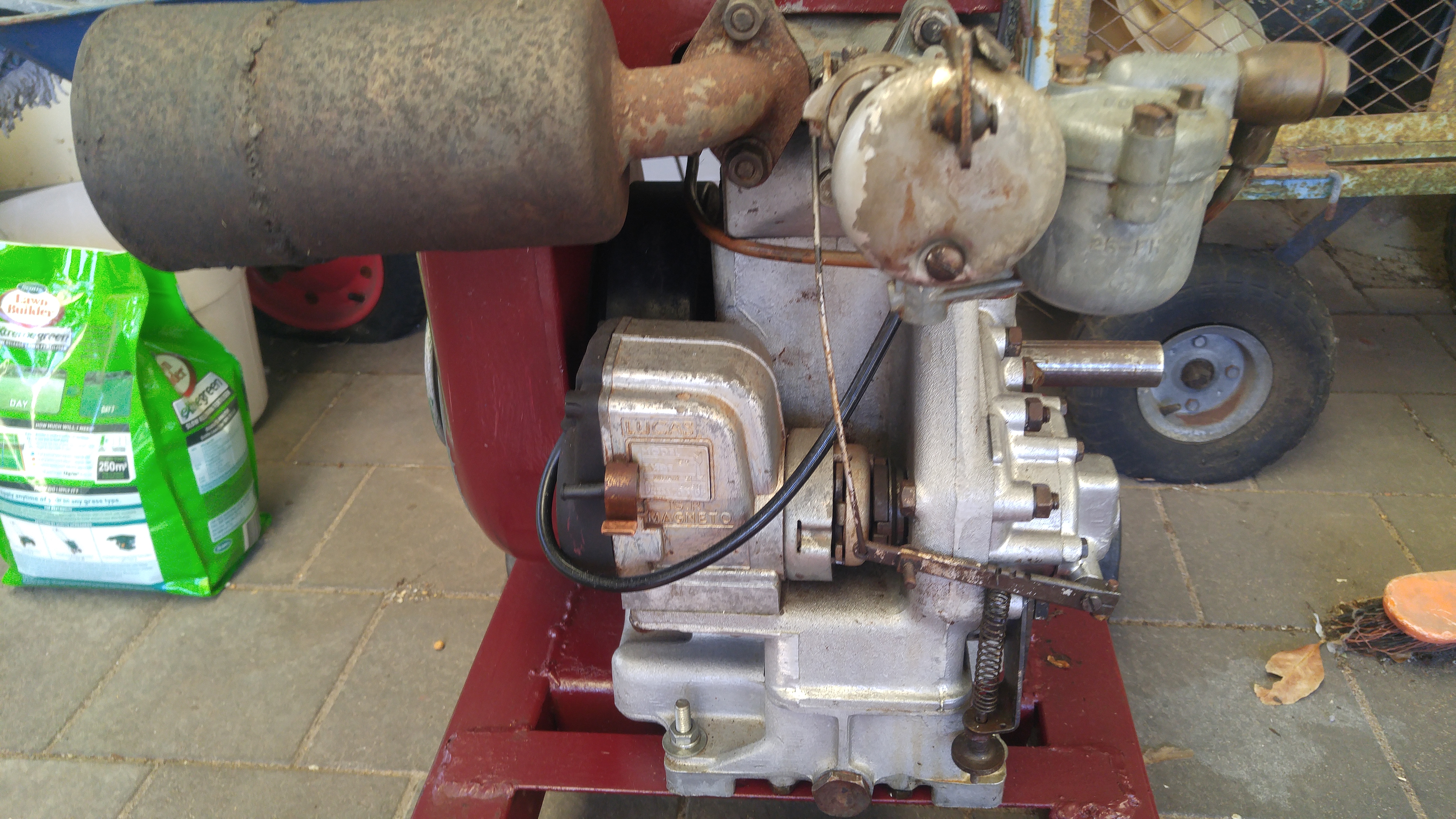

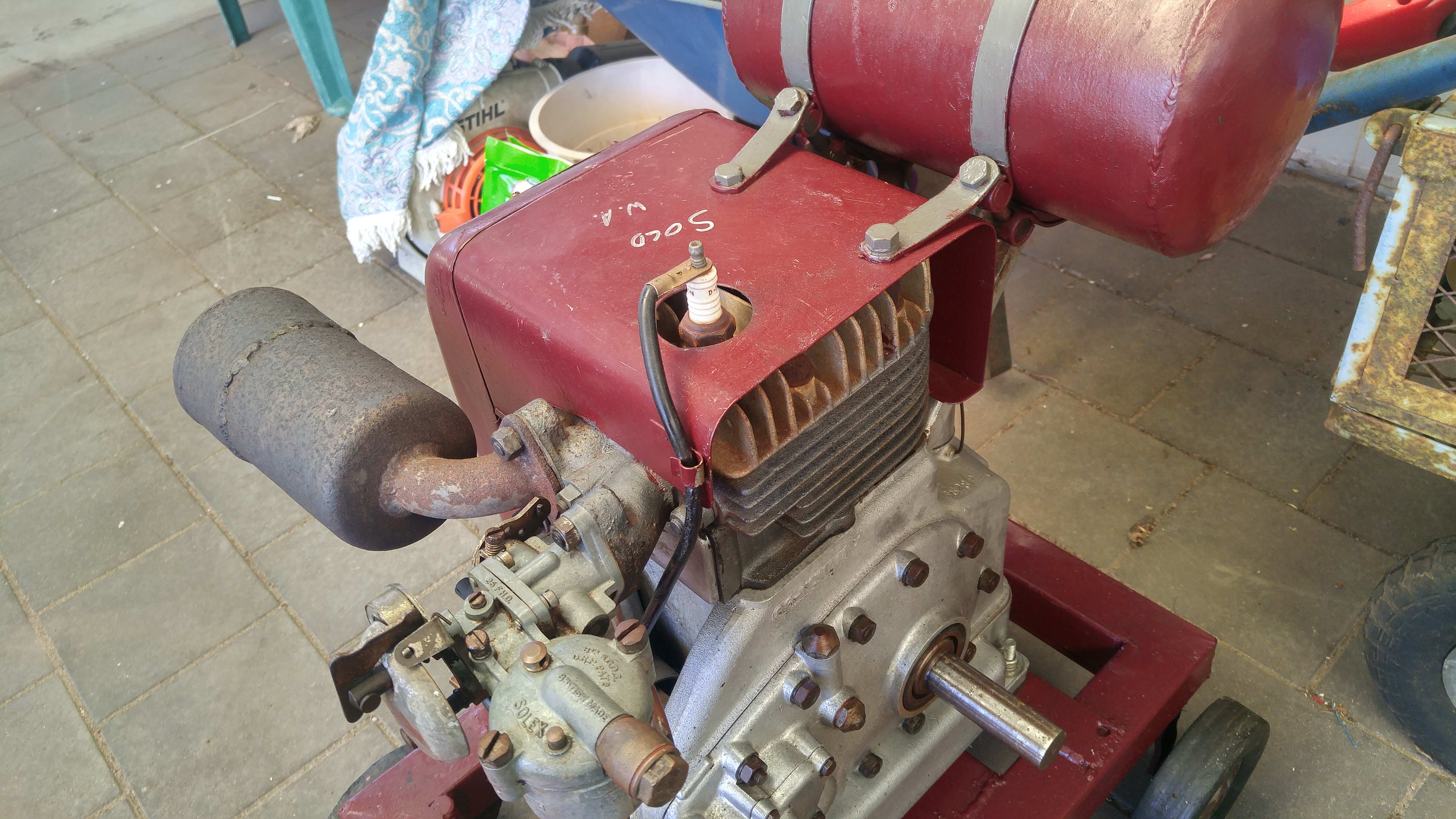

1963 BSA Power Unit (had it for years) dragged out and full service. Runs kinda perfect.
It has both petrol and paraffin jet specs.
I do not plan to use this fuel but would be thankful for any info here'

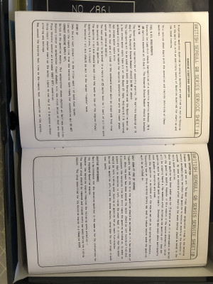

I found the kingfisher paraffin reference in the QB service manual “Lit13” available from sheridans.
Note the twin tank arrangement and the mention of a dual float chamber carburettor in the “normal operation” section.
