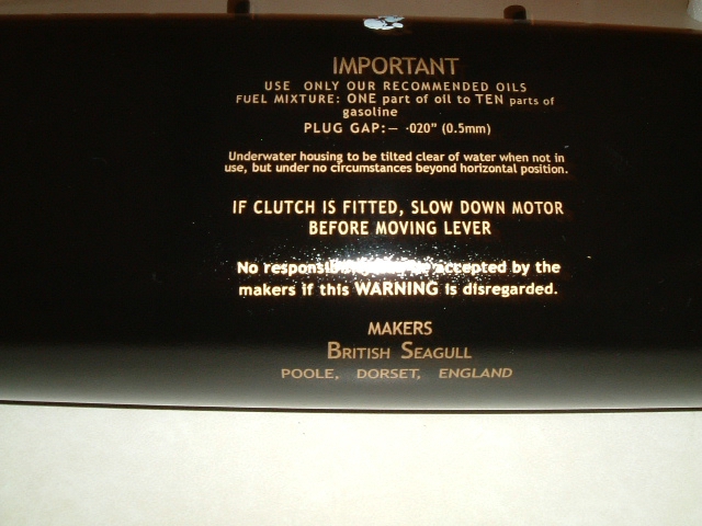

There are quite few little differences in decals over the years, here are the ones John sells at SOS.

Thanks—I actually have one of his to use. It is the one I see on most motors. I was curious, though, whether British Seagull gave a number to use for mixing up a gallon at a time. That is mostly how I do it.

The answer your looking for is 0.8 of a US pint to 1 US gallon.
Re: Missing Word In Old Decal
Thanks, agreed, that is the accurate answer. I have mostly restored Johnson engines in the past and don’t remember ever seeing a decimal on an instruction sticker before. They are always fractions. Of course, old Johnson outboards are either 8:1 or 16:1, so that works out better. I have been scouring the internet for a picture of a late 50s or early 60s Seagull sticker, but no luck. Since John’s appears to be the only one made, it has become universal!
