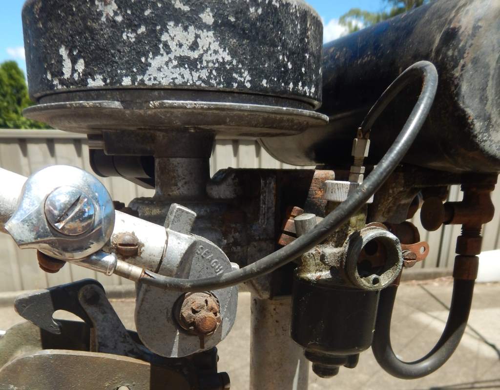

This picture is of course prior to cleaning.
