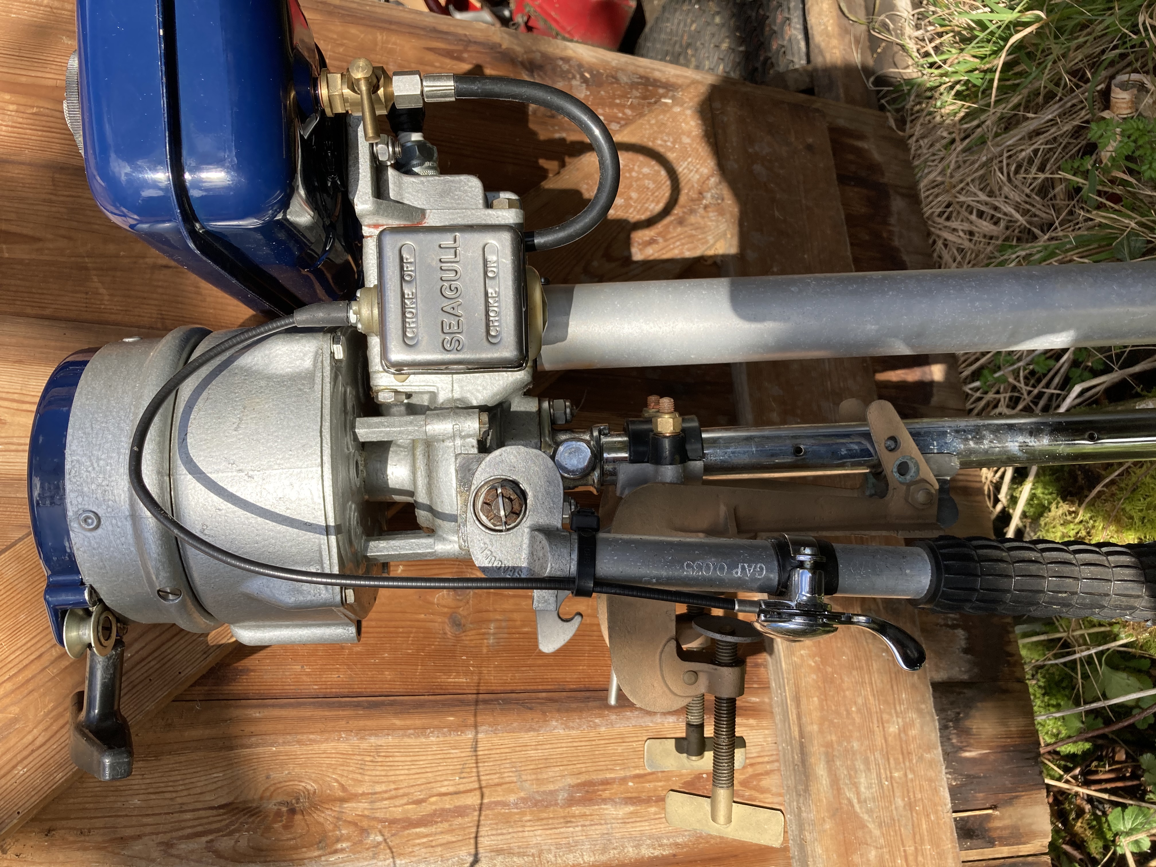

Wow your motors are in great shape, what sort of boat are you planning to use them on?
Posts: 4971
Re: Mks 2 and 3 ignitions voltage
Interesting fuel taps where did they come from?
So if it sparks at A can we assume 10 KVA, if B = 20 KVA, C = 30 KVA, 40 KVA, isn't that what I implied?
Most owners don't fasten the throttle cable to the tiller arm as you run the risk of kinking the cable outer.

HA that is a very kind and generous comment, if I may say so, which I value greatly, having seen your photos of what you do! The only thing that still doesn’t look right is I couldn’t get a proper gloss on the black tank - I tried a large number of sprays with clear from the local automotive supplier but it didn’t work- perhaps I was too tentative about not putting it on too thickly in case it might run - which on a smooth surface it does only too easily ....

Oh and I missed out that the Petrol tap comes from George at Villiersparts - sorry about it not being original, but I wanted something that would not leak, looked ok, and had that rather unusual thread on one side, for which I could not get a tap or die....
I also put a longer screw at the bottom of the drive shaft leg, with a locknut on it- after all it’s all there is to stop the whole lot dropping off!
