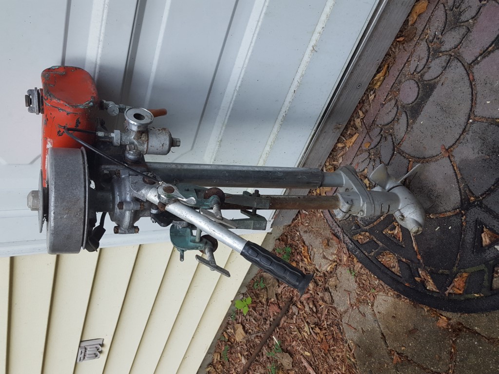

Saw this Forty Minus on Facebook Marketplace about three weeks ago but put it off for a while since I recently bought a Century 100. Did I really need another one Seagull since I have two others that don’t run? Decided to bring it home last week anyway. The seller was local and was only about 20 minutes from my house.

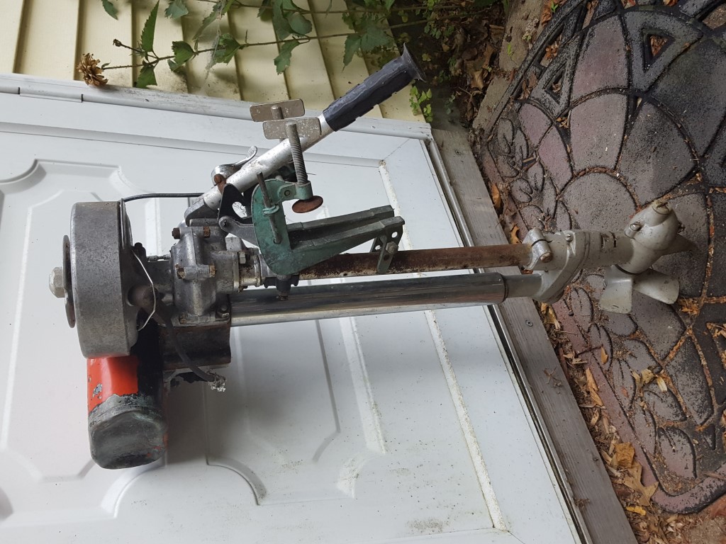

Have to go with what I have.

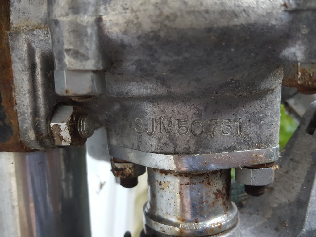

The serial number is SJM 50761.
There is an alphanumeric string impressed lightly on the flywheel “R82A80 9/61”. This Seagull appears to be complete and only missing the (plastic?) thrust block. The biggest problem is the motor does not turn over. Took out the spark plug and poured some Kroil inside the cylinder.

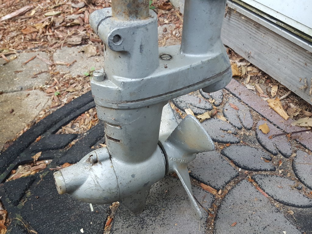

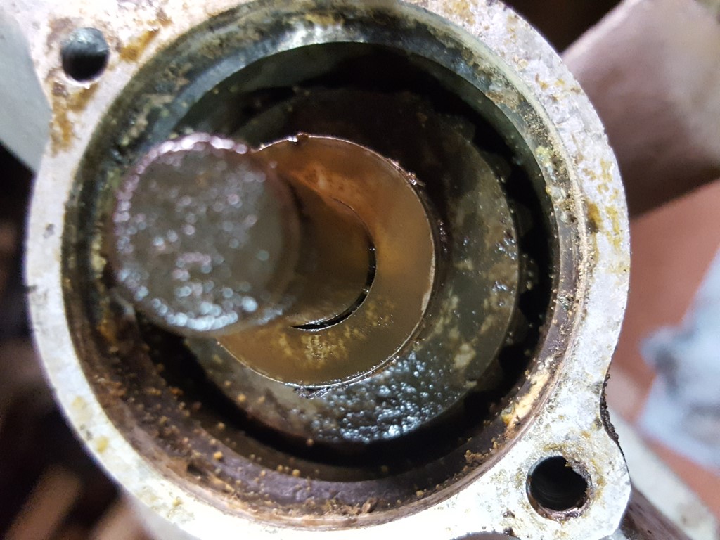

Started the disassembly from the bottom up. The two front end cap screws came off with no problem. Removing the end cap revealed an oily interior and nothing poured out like I’d expect. At least it wasn’t dry and rusty so that's good.
Gearbox looks clean
So far the gearbox is looking hopeful.

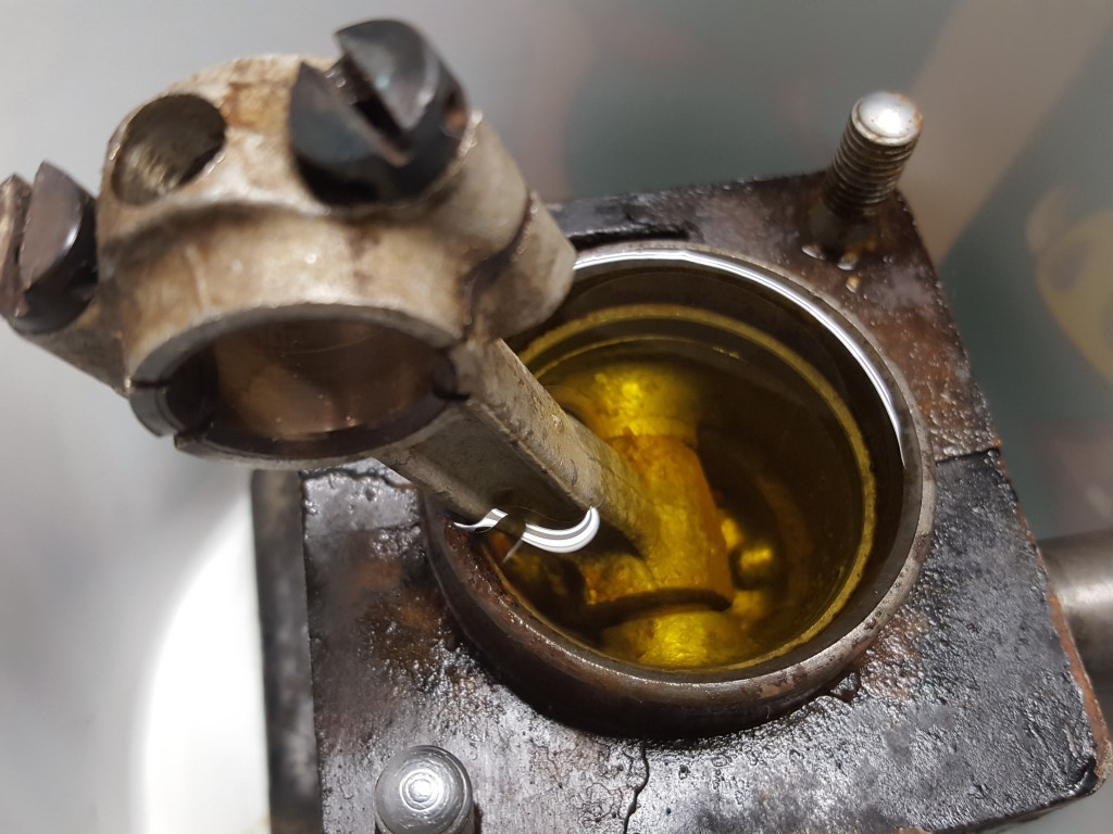

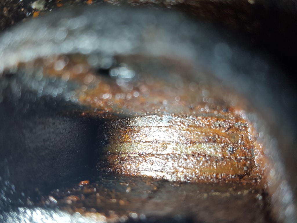

Got the drive shaft off the crankshaft and found the pinion turned but it is stiff. Poured some Kroil penetrating fluid into the drive shaft and put it aside to soak. Also removed the silencer tube to get a closer look at the piston rings.
Not looking good

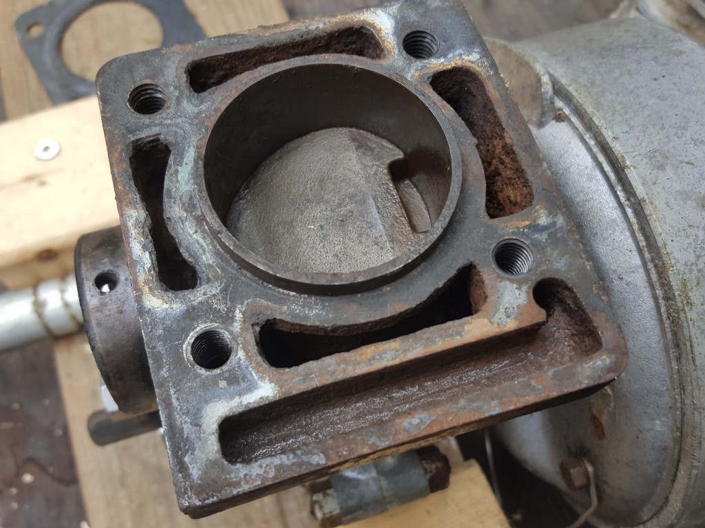

A number of heat cycles and the head finally came off. The water jacket wasn't too bad and cleaned out with a minimal amount of rust. Now I have access to the cylinder walls and the top of the piston. So far so good.
Cylinder walls have some rust but hopefully will clean up

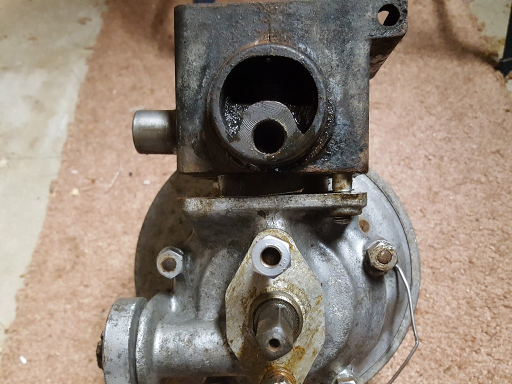

I was able to lift the block partially from the crankcase assembly.
The crank turned enough to give enough room to clear the two studs that attach the block to crankcase.

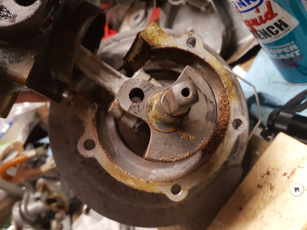

Open crankcase with access to the connecting rod screws
With the lower crankcase half open, I was able to remove the connecting rod screws. Made sure the connecting rod cap spacers were put back into their original location.
Now I have the block free and can work the piston problem without risking damage to the crankshaft. Soaking the lower cylinder in Evapo-Rust to clean out the surface rust as this will be (hopefully) the piston exit. Doubt this will be the last soak in this area. Next I'll do some scraping and more soaking.

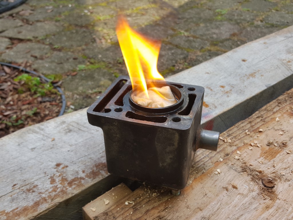

A few days ago I poured some kerosene in the block and used a section of a shop towel as a wick. Let it burn for about 30 minutes.
After it burned off, took some ice and dropped it into the inverted assembly to cool the piston. Turned it back up and used a hammer with wood block on the piston top a few times. Nothing moved. Did a second cycle of this technique and it still didn't move. The wood supports under the block began to break up so I stopped.
