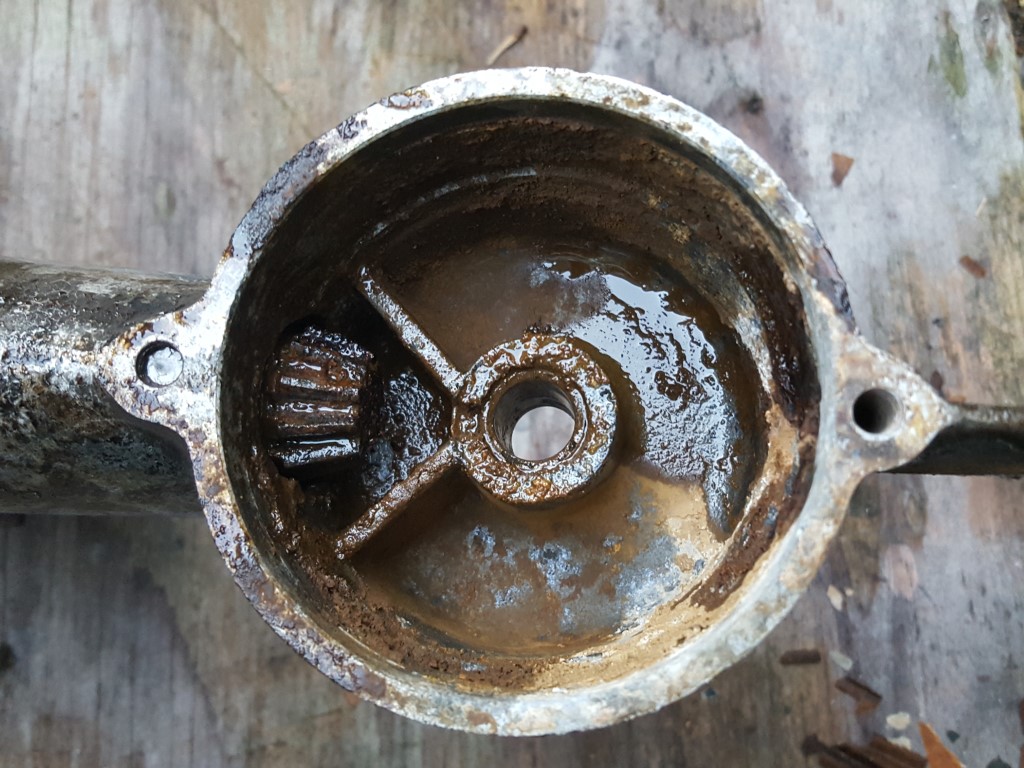

Quite a few YT videos have come out since 2006 and earlier this month I got inspired to have another go at my Dad's old Seagull. Removed the power head and found the motor turned over nicely. Put a torch on the end cap screws. Got the lower screw out but the upper screw that also locks the pinion assembly broke off. It did move slightly but I unfortunately rushed it. Think I can still get out the broken section but will have to assess the rest of the housing.
The end cap came off and I found the inside was dry and corroded. Not a hint of lubricant of any kind. I'm not sure if the gears can be reused. Got the pinion gear to turn but it is still stiff. The crown gear is in a tub soaking to get the rust off and can post a picture later. The other challenge is getting the gearbox fastener out that is between the tubes. I've applied heat but it is stubborn.

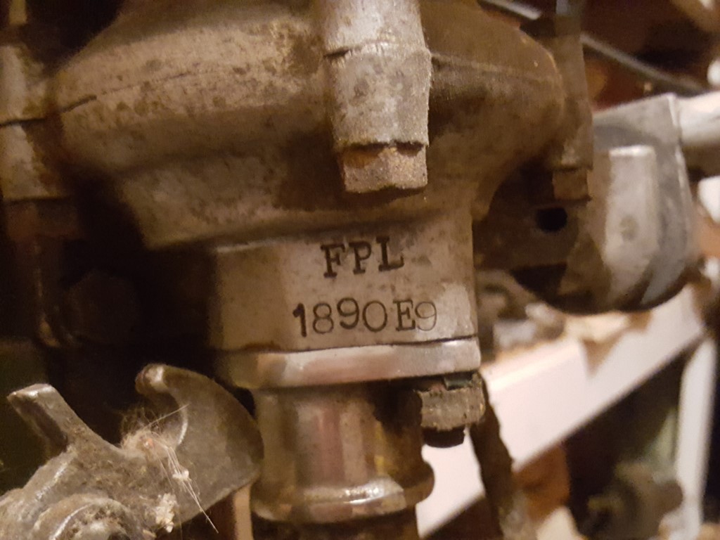

The FPL Serial Number
Gearbox Internal

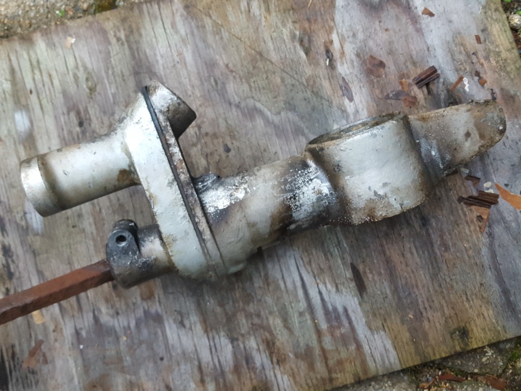

Forty Minus - SJM 50761
Forty Plus - FPL 1890 E9
Century 100 - LLS 624 A5
